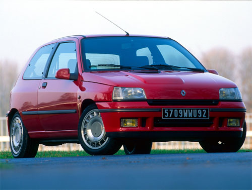

Those steelies are from a 1991 Renault Clio 16s (1st gen), we call them "Clio Cup" rims and they are common and cheap here.
The size is 15x7 and 4x100. My friend painted them in pink after the photoshoot :roll:
His other set of rims is from a Clio 16s to :
