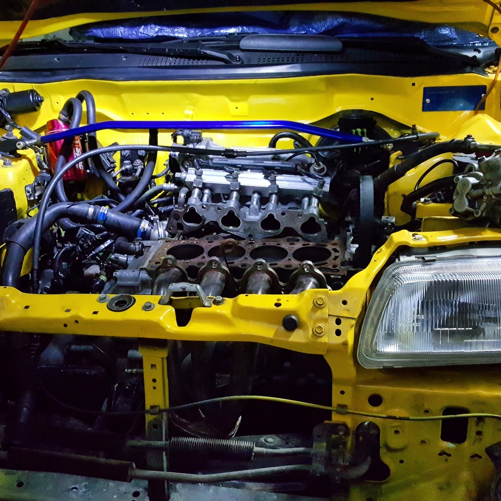

So, you probably know that last summer my engine overheated, because it was 30C+ outside, I got stuck in a traffic jam, and I had a leaky radiator hose.
Head gasket blew, head got wiggly.
The time came and now I took the head off the engine.
Current plan is to get the head milled off and sent to a porting specialist.
Furthermore, I will have a custom intake manifold made, add a comp cam 59300 camshaft, BC racing stiffer valve springs, and maybe an adjustable cam gear.
Lastly, I will order all new radiator hoses as well as a slim fan, and have a custom radiator made, so that overheating would never become an issue again.
After I solve these problems, I will have the car back on the dyno.
I will also do some little things, such as rebuilding LMA's that cause ticking noises and other minor things.
I might even take and post pictures of all this if you guys want to see me back at work!

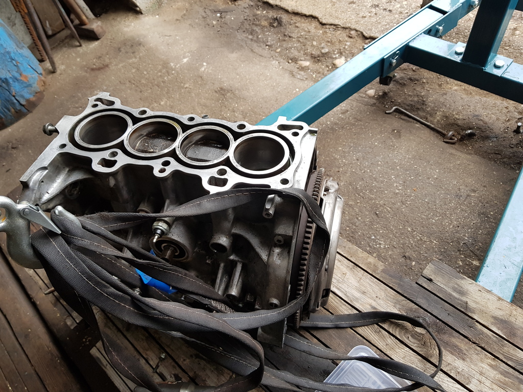

So, I encountered a problem. Right when I was starting to get ready to put the head back on, I spotted that MY FRIKKIN SLEEVES STARTED TO RUST after standing for this long.
This might have to do with a fire that happened during the winter, hot and cold mixing or whatever the case was. But I have no choice but to redo the whole engine again.

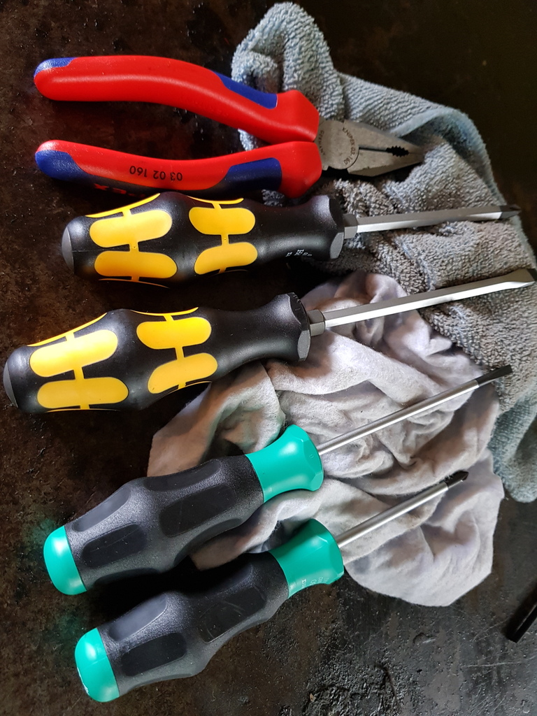

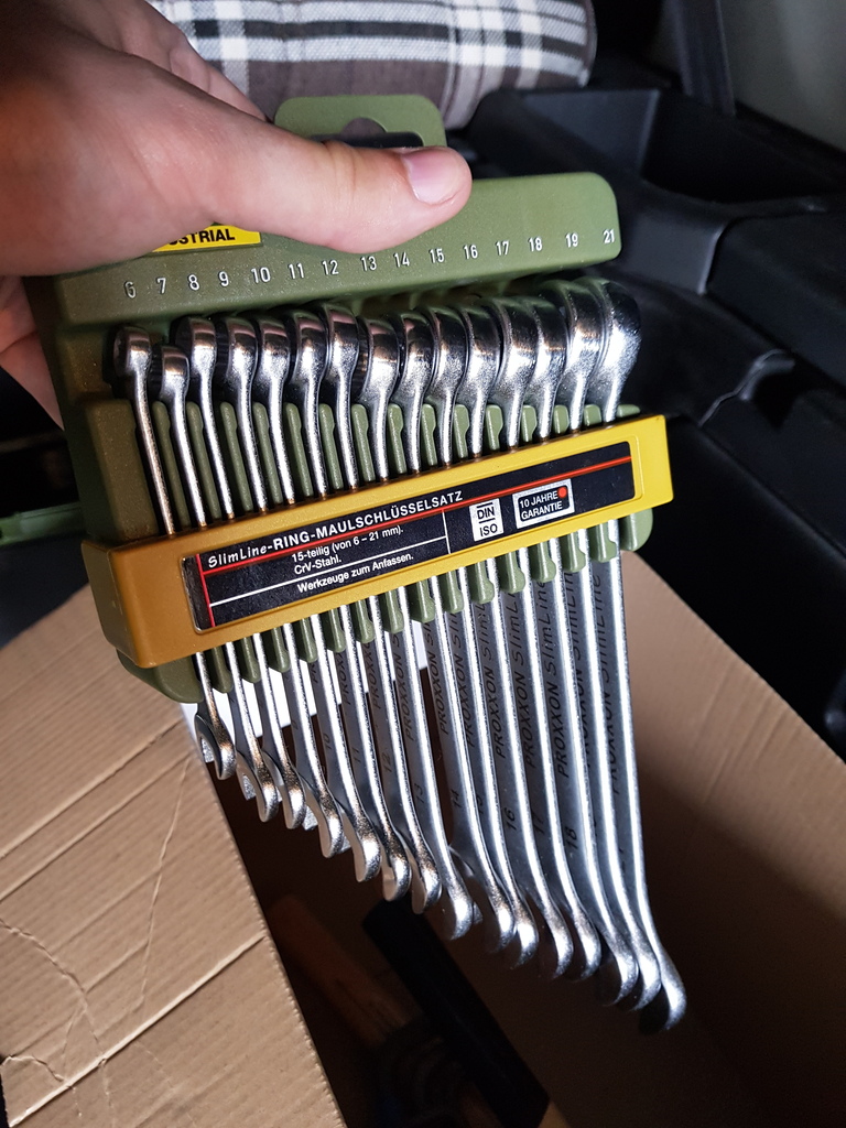

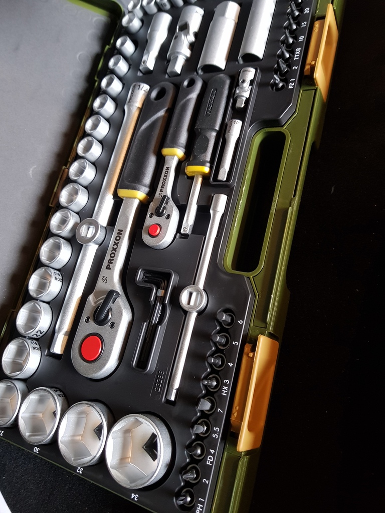

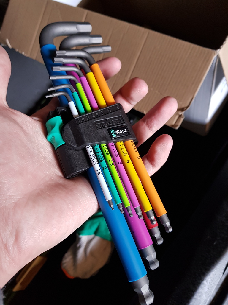

First things first, I spent some money on new wrenching tools:

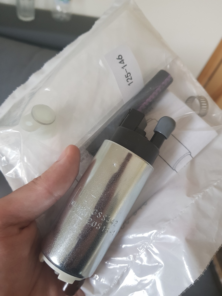

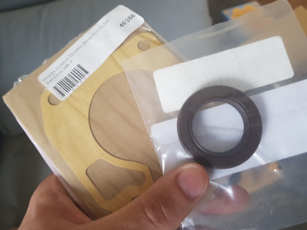

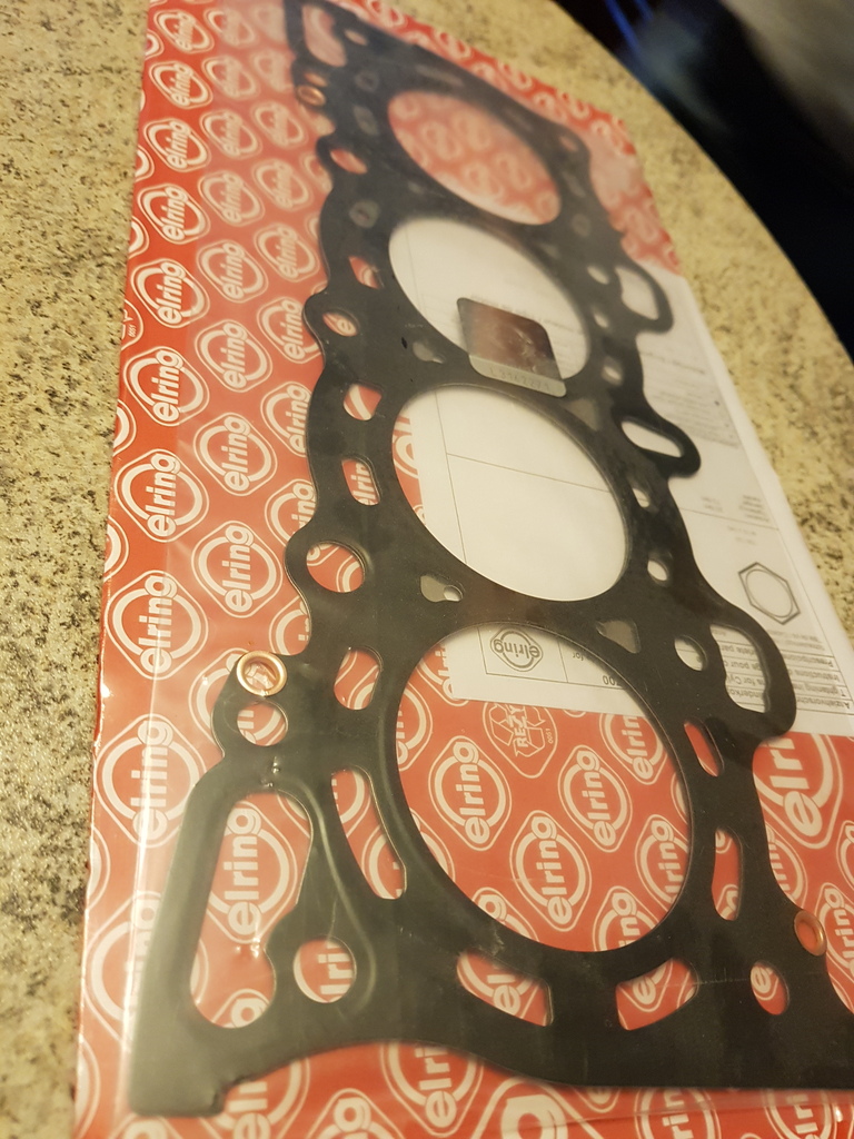

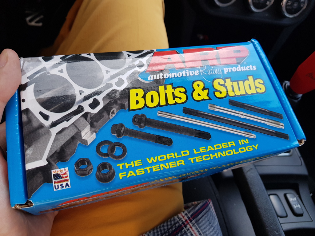

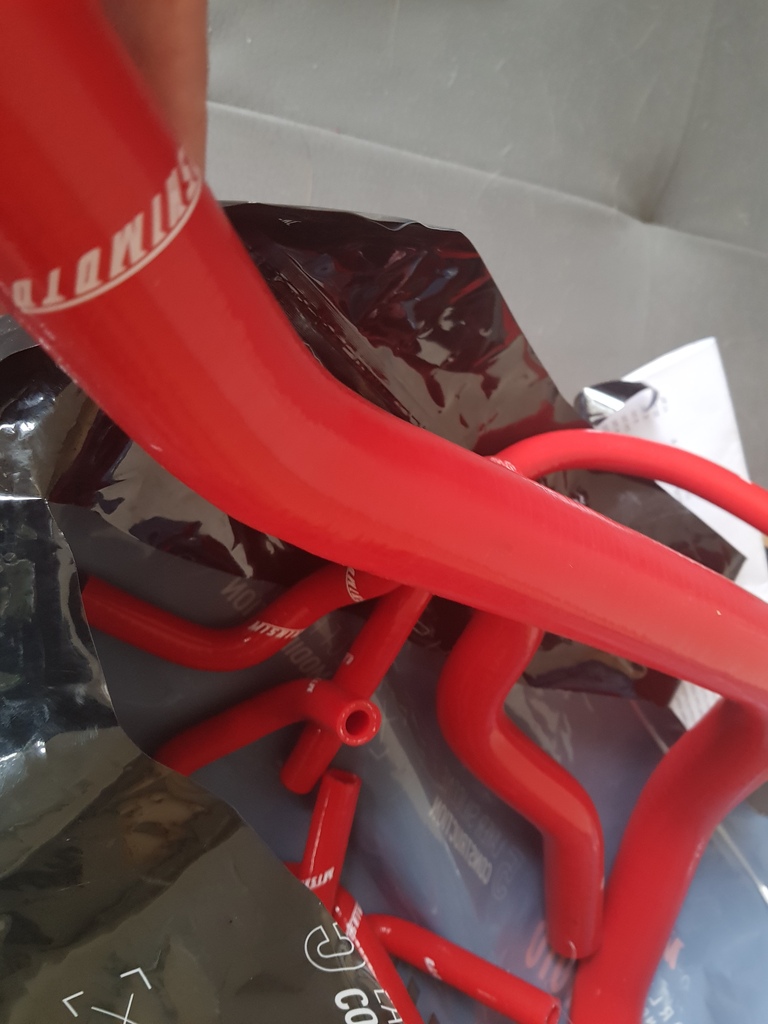

Then here comes the new parts:
And also all kinds of additional gaskets rubber bands and so on.

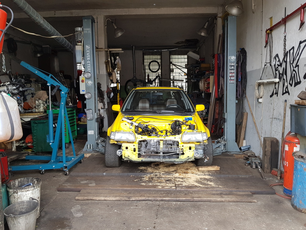

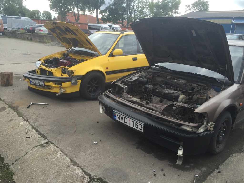

Further! We go to the engine removal. It took me frikkin 3 days to get the lower arm to get unstuck in order to remove the axle from transmission. But I did not give in.
I also got the head of the d16z6 properly ported flowed and matched with exaust and intake manifolds. Got the BC valve springs installed and the valve job too.

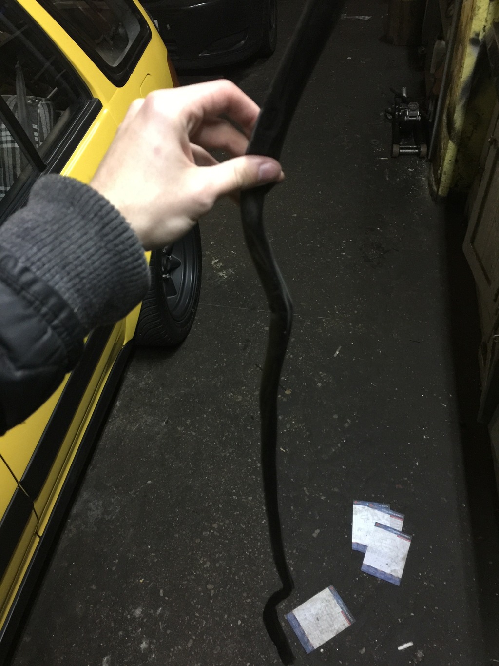

First, I have run into problems, my coolant leaked through an old hose and the engine kinda sorta overheated.
I did sort out the problem I think, but I will still have to change the head gasket, and that means I will probably be adding a 59300 comp cam, springs, intake mani and ported head.

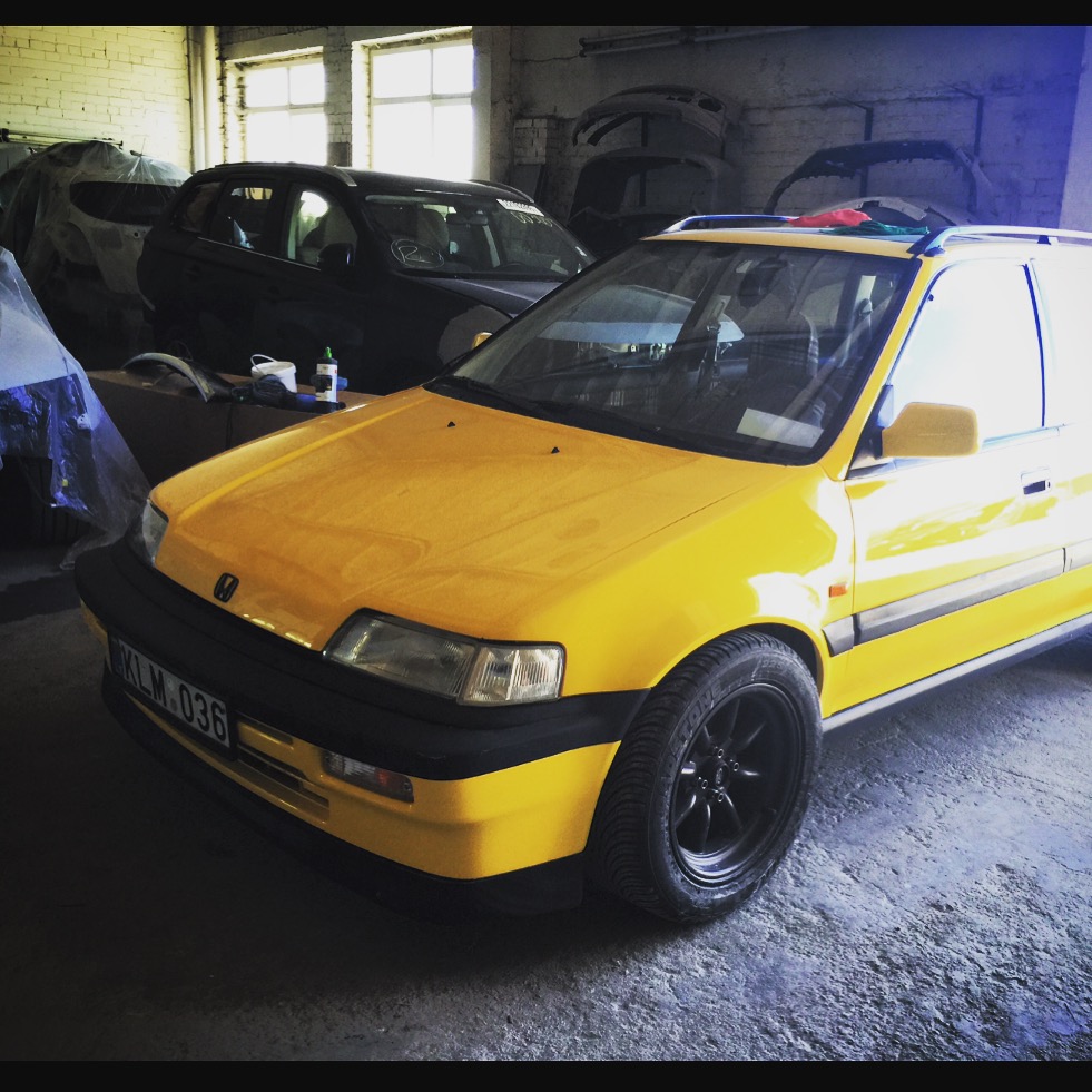

He already said that the painter didn't want to do it.
Correct! I do however plan on doing the job myself.
Also, today I took out the headlight out of my sedan and put it in the wagon. They look much better.

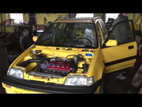

Here is a shot of work being done:
It is always good fun to work on the car on sunday.

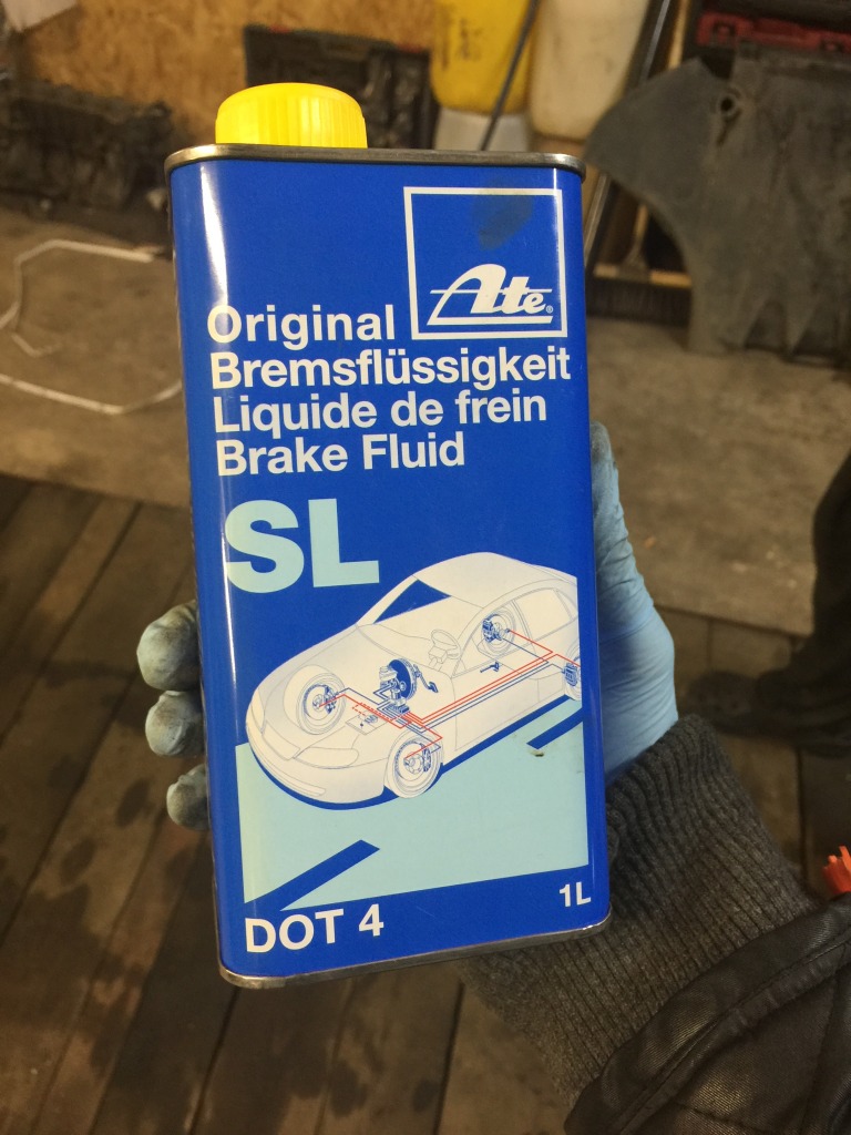

So the brake fluid got changed yesterday, and it seems like it makes a world of difference in stopping power.
Pedal feels firm and confident now.
For anyone not having changed their brake fluid in a long while I really recommend doing so and getting this fluid.
Also, ds2500 ferodo brake pads help a lot.

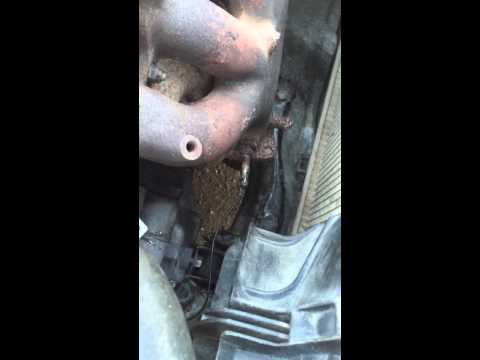

Oh and a video,
Tell me what you think about the sound. It is all motor sound, no exhaust.
[video]http://vid1315.photobucket.com/albums/t596/tadasbartkus13/Mobile Uploads/IMG_6854_zps32abe325.mp4[/video]

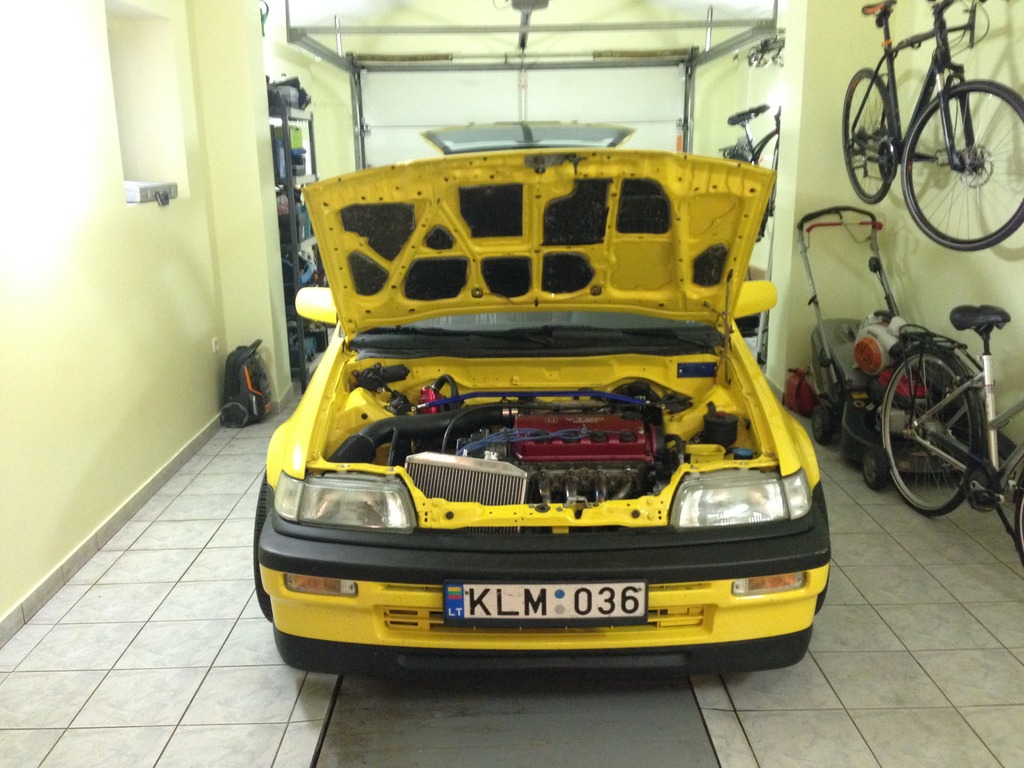

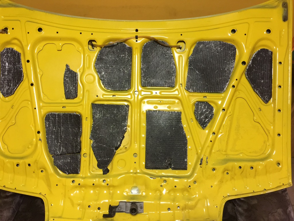

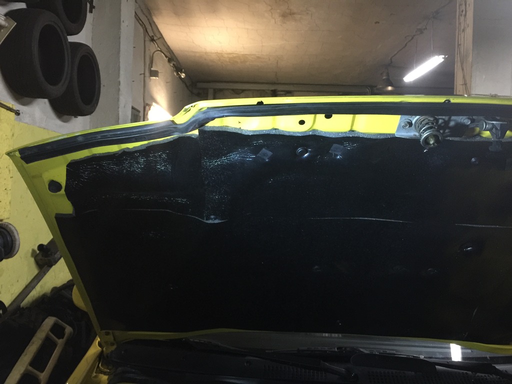

Hood with a bit of sound insulation

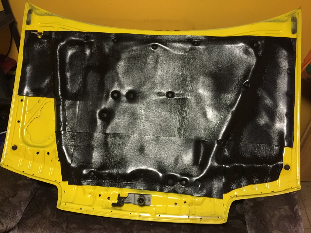

hood with full on sound deadening material that is heat resistant. It was a b*tch to find.

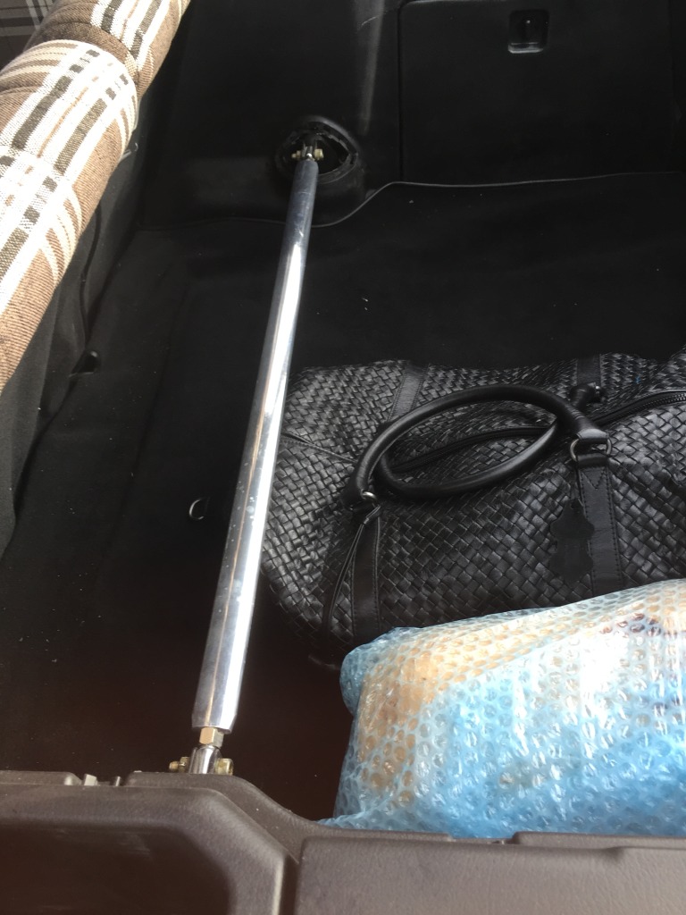

Custom rear strut bar that is a perfect fit for Shuttle.

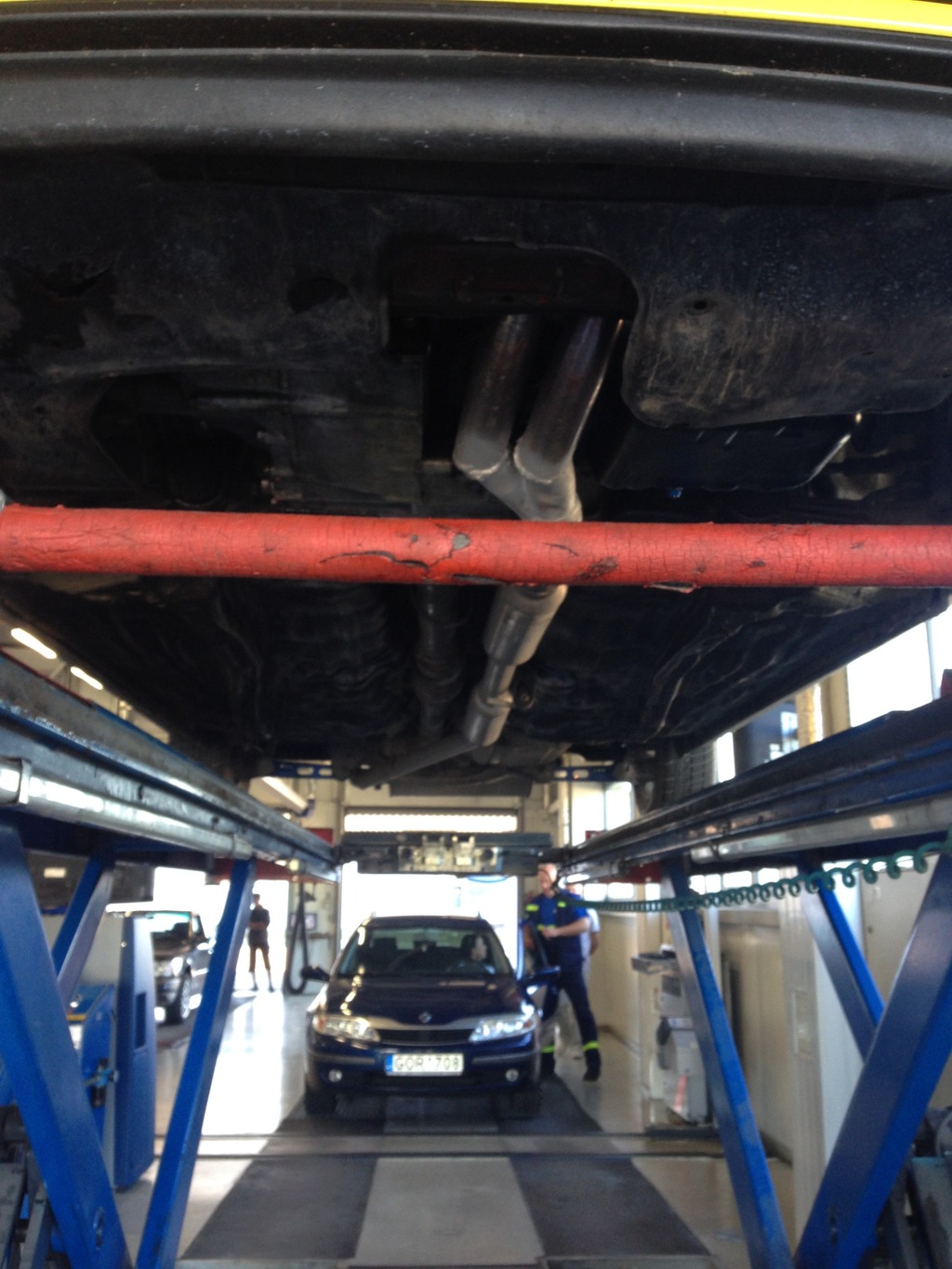

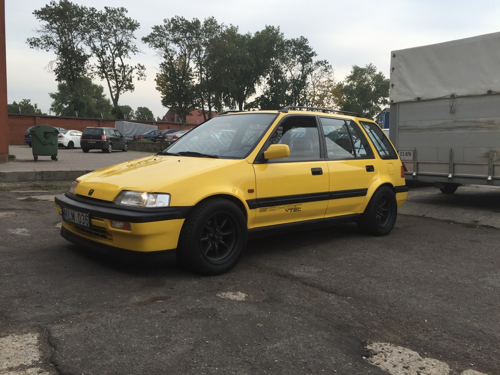

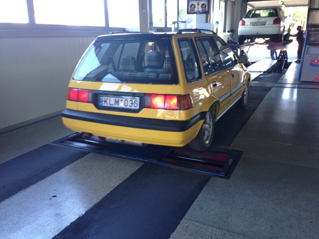

First and foremost I have passed the technical inspection and have gotten all the paperwork restored and completed.
What a joy it is to finally drive the wagon legally!
Oh, but I had to slap stock wheels on the wagon to pass the tech, because my tires still stick out of the wide fenders.
Here are the pics at tech inspection:
And a pic of completely new exhaust, it is 2.25" all the way, from 4-2-1 header.

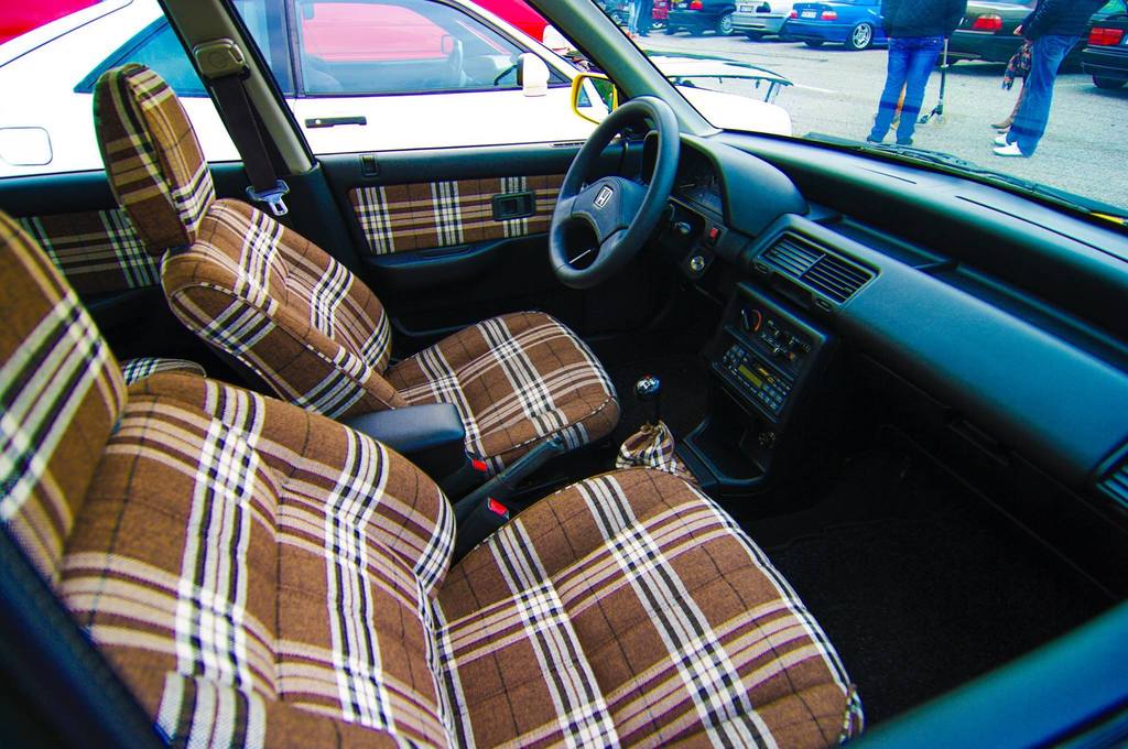

Interior pics for the show.

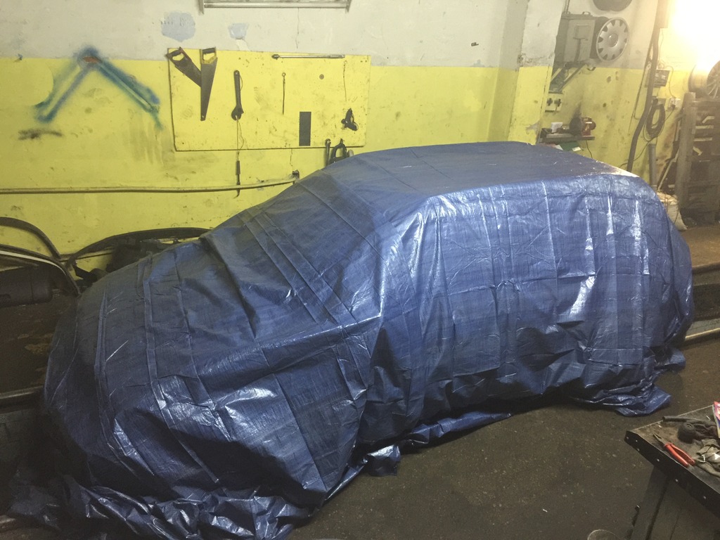

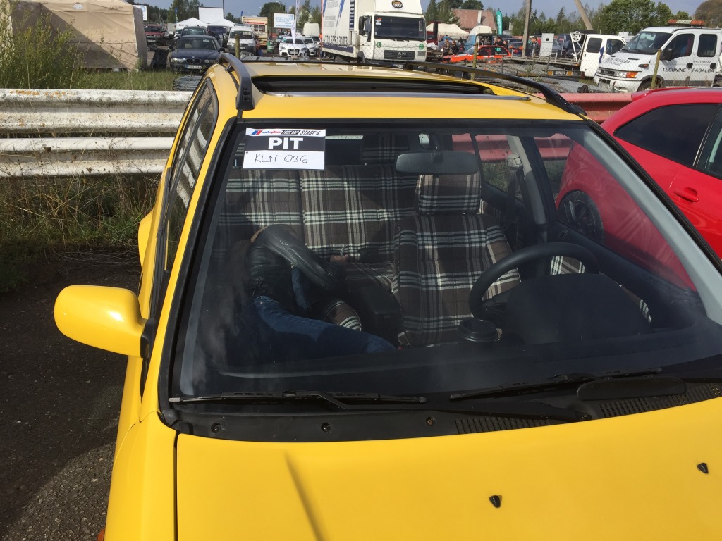

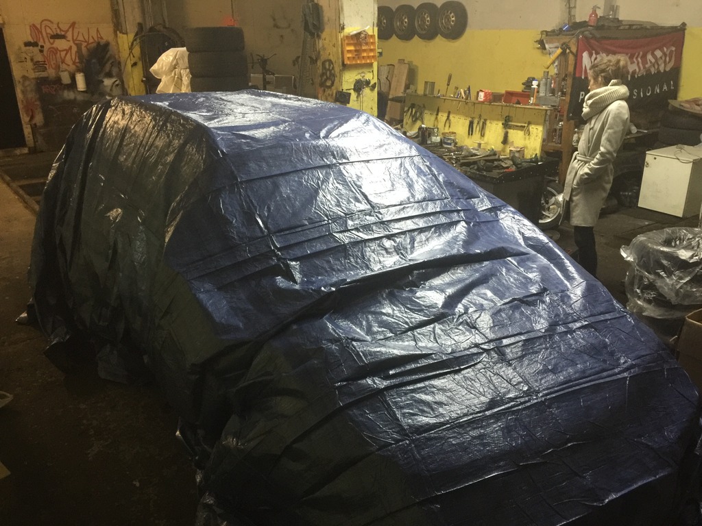

And one more pic before I put my wagon away to the garage for the season.
I will post the rest of the pics from the 2 shows I attended next time. Oh and to do list for the winter. For now I wanna look for a car cover.
I've always wanted to do this - cover my project car and put it away for the winter.

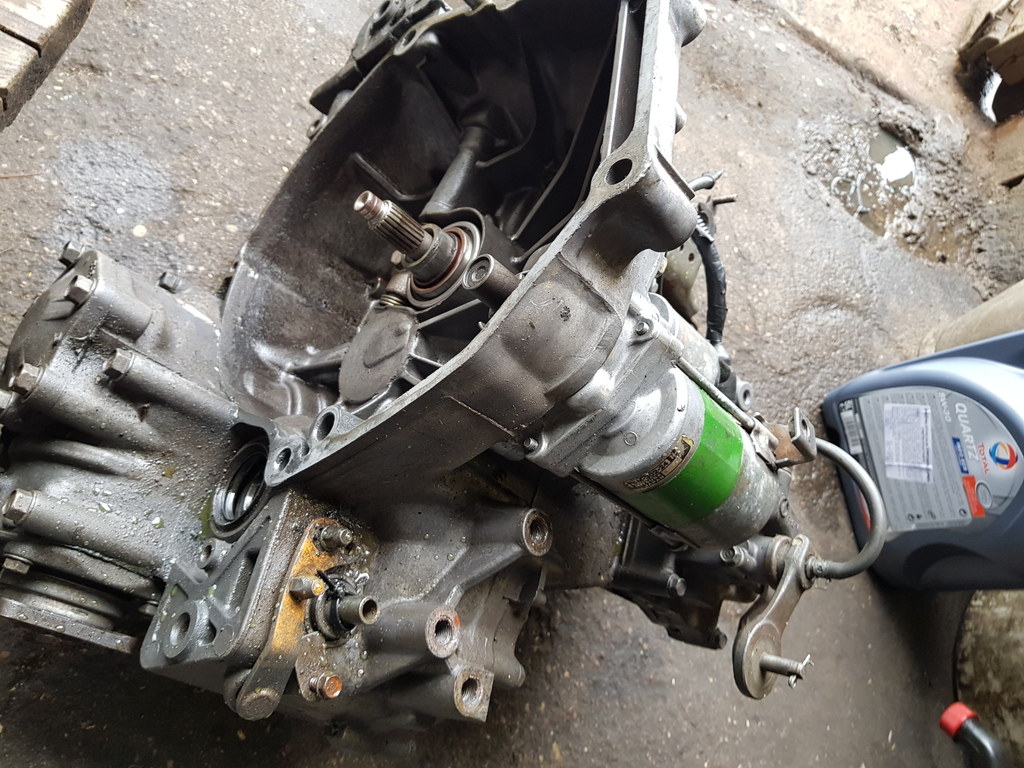

Here is the news - I bought another civic wagon rt4wd just to take all the little bits and pieces that my wagon is missing.
Also, to have another working gearbox and viscous couplier just in case mine gives out.
These things are getting much harder to find, and the one I got had all the little details I need.
P.s. it did good on the snowy lake!
That is exactly why I got another whole wagon, to make sure all the little bits and pieces of it are there, and nothing is missing. It will be as complete as possible.

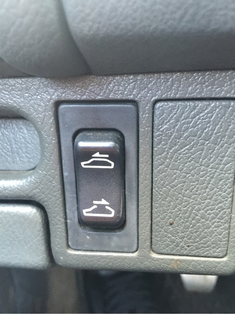

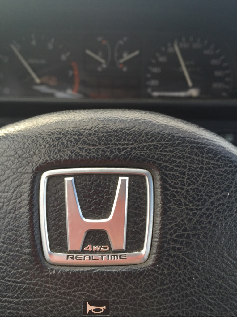

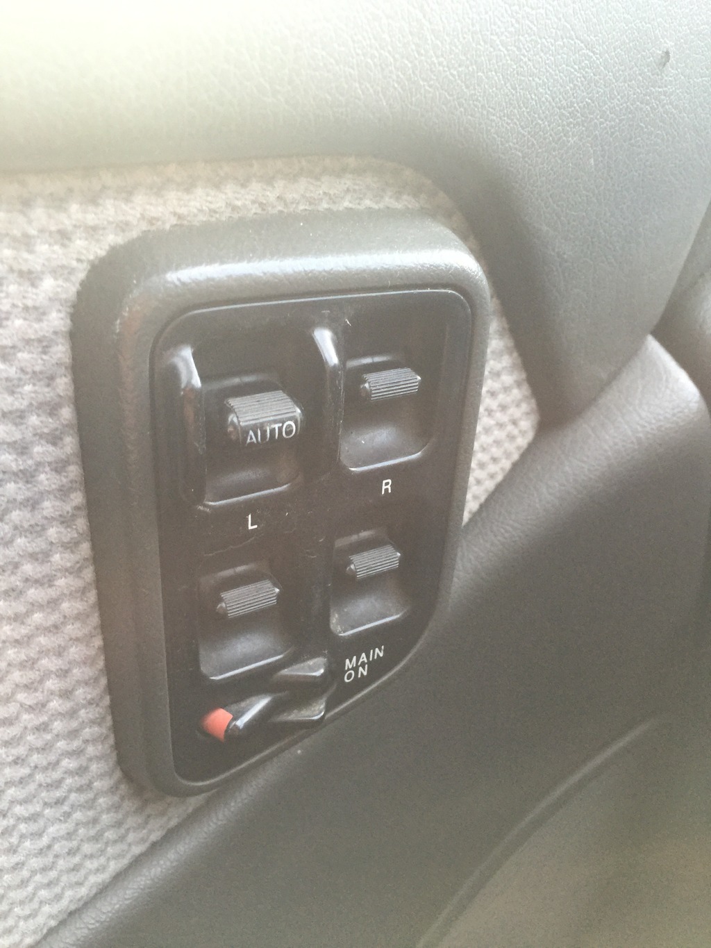

My plan is to swap most of these to my main wagon!

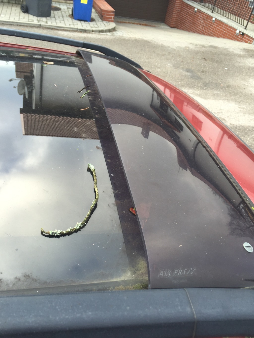

My personal favourites are the 4wd steering wheel badge and OEM sunroof visor.
I have been looking at the stock car, and realized mine has so many small pieces and bits missing.
So yesterday I did a little removal and install.
I also installed 4 hood stops, I bet it will make a world of difference!

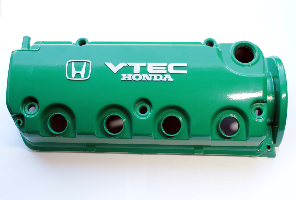

I am not a real honda red guy, so I went with turtle/mint green!
Tell me what you think!!

And here is the new and planned additions:
- Head milling to flat.
- Valve cover color change.
- ARP cylinder head stud kit.
- Head porting and polish (professional).
- Port matching to Intake/exhaust manifold.
- Comp cam 59300 camshaft.

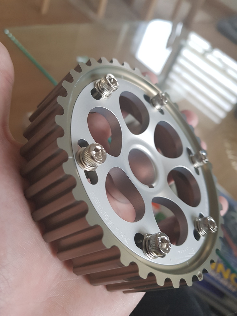

- AEM adjustable cam gear.

- Mishimoto radiator hoses.

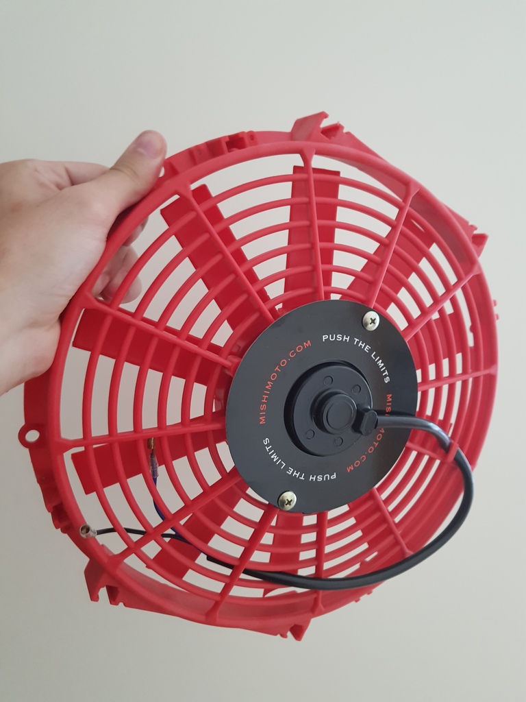

- Slim radiator fan.
- Walbro 255 LPH fuel pump.

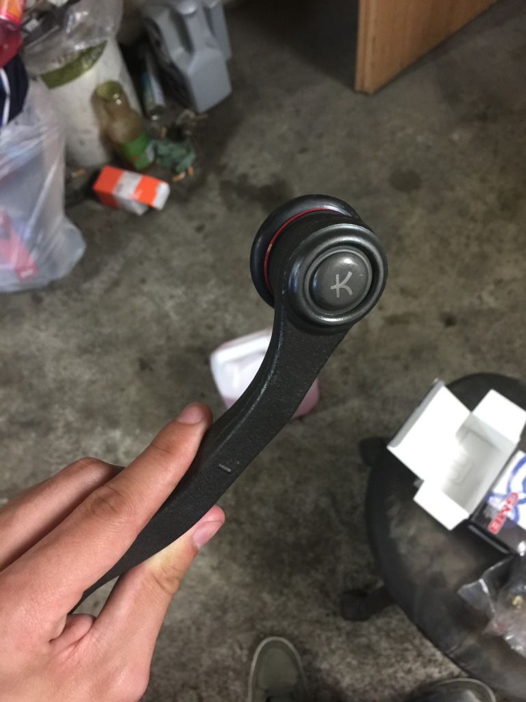

Next update will come with new and restored engine parts. Also, the old taiwanese bearings got rekt because some trash got into the engine somehow.
