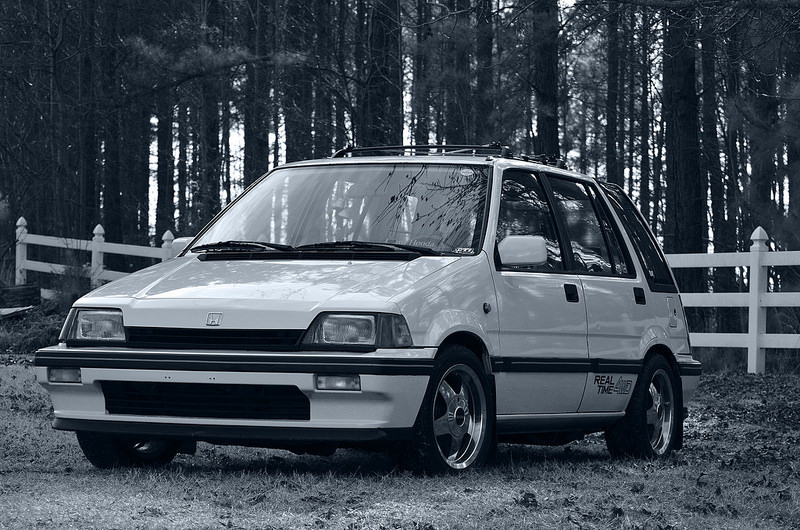

Highly modified 1987 RT AWD
12357
  • VladiVladi Senior Wagonist
    That wagon must be breaking necks man, so amazingly clean.
    LOL thanks Vladi, People rarely even know what it is..

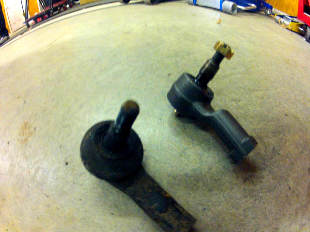

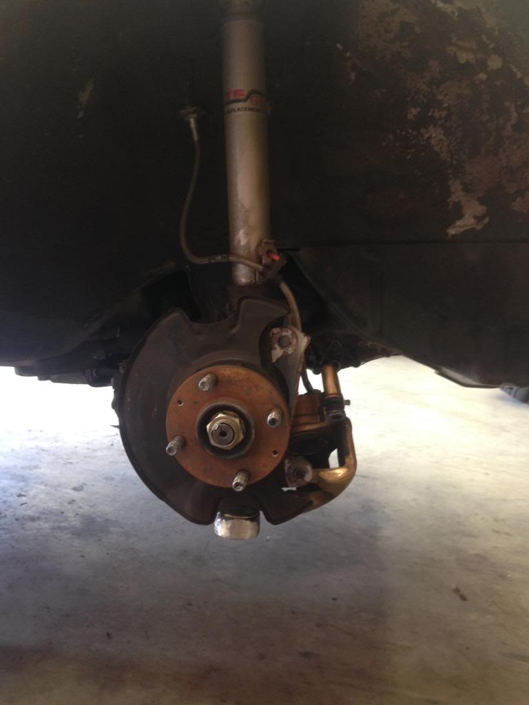

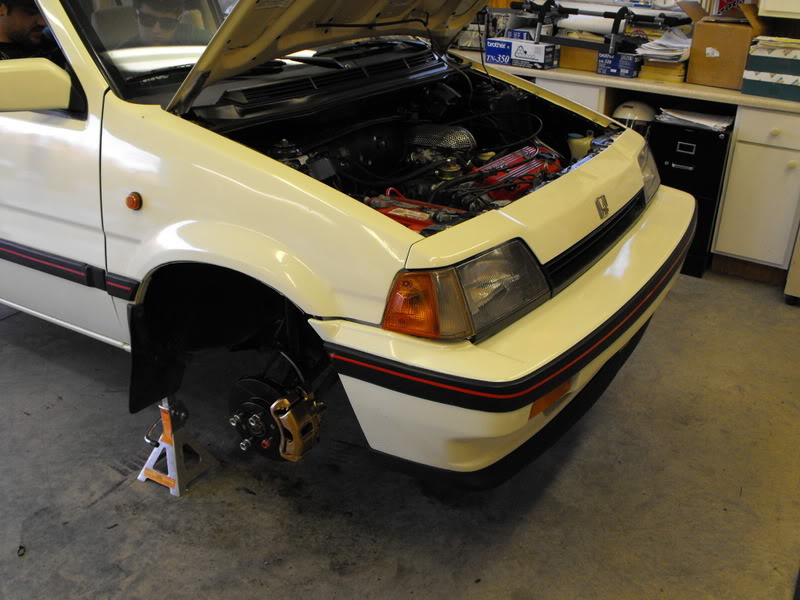

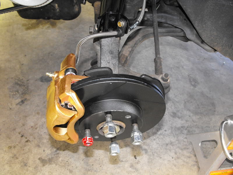

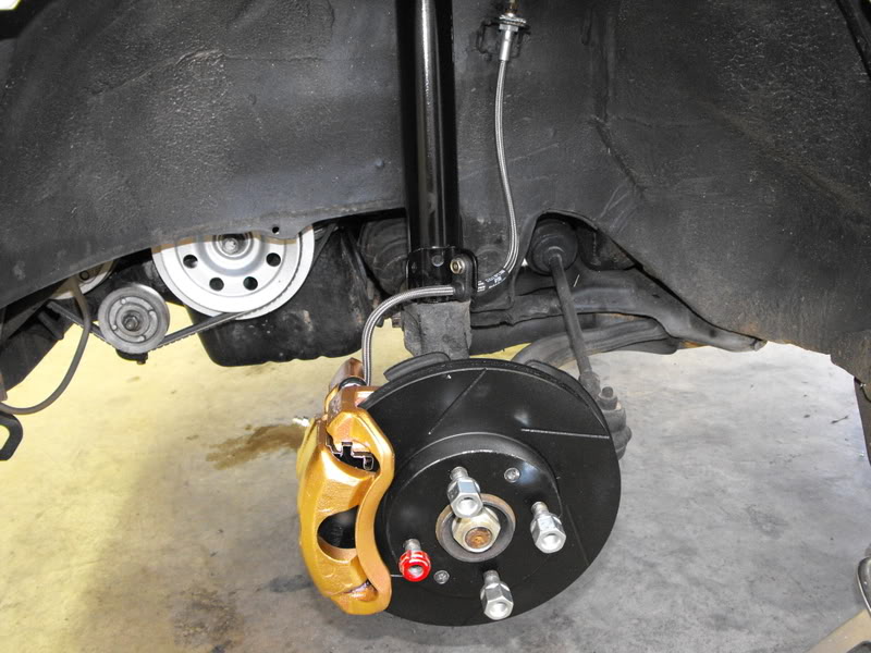

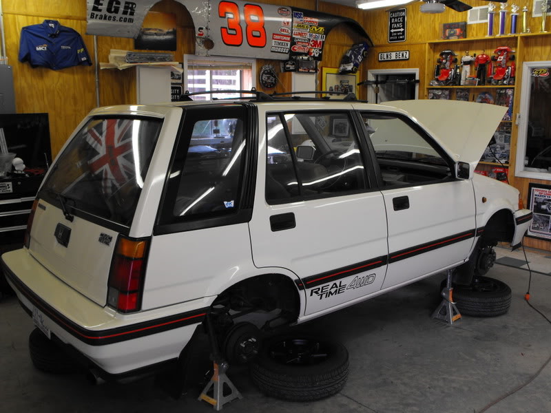

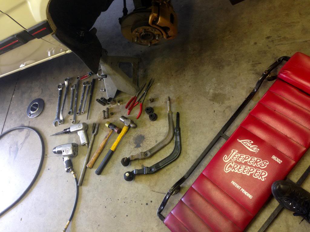

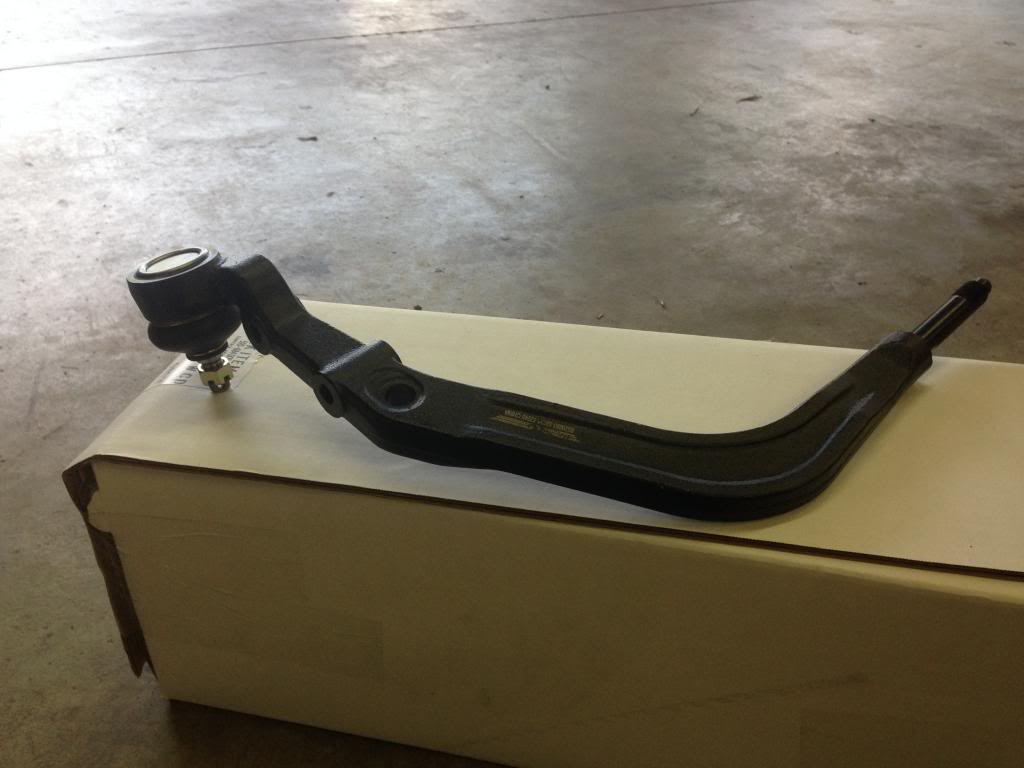

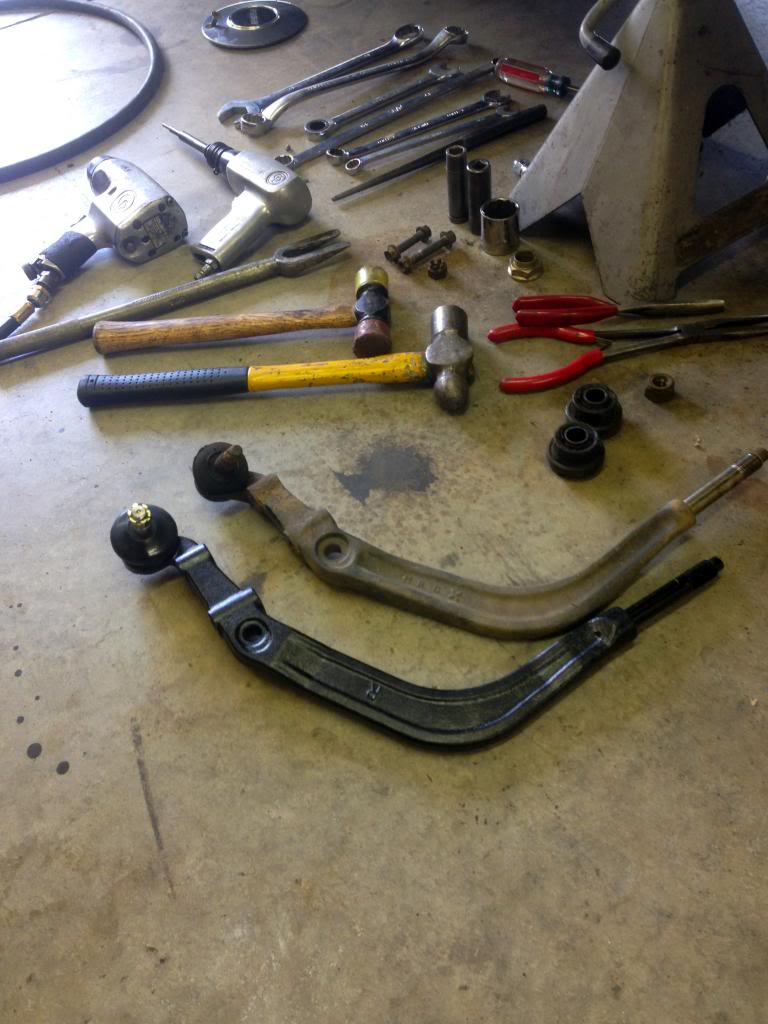

    Some parts are here. New Dorman Control Arm w/ the sealed ball joints.
    Gotta purchase the entire lower control arm to replace the ball joints on 3rd Gen.

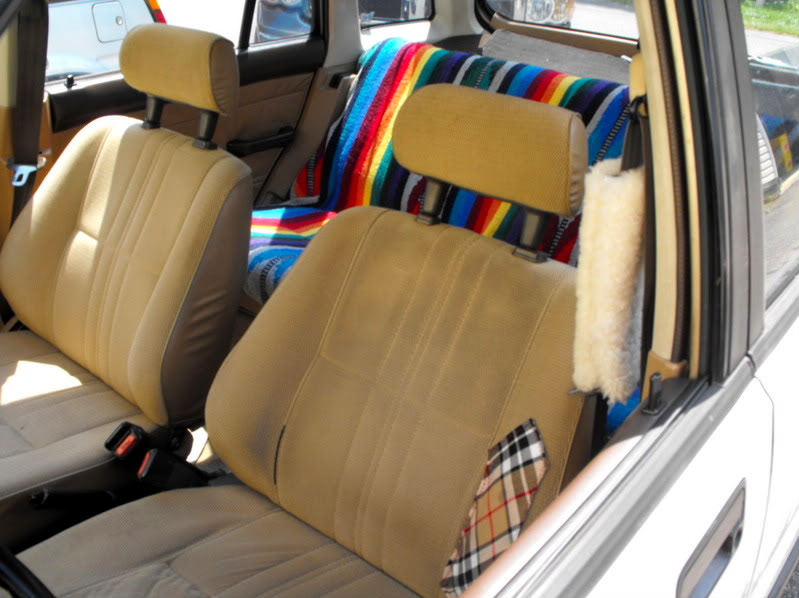

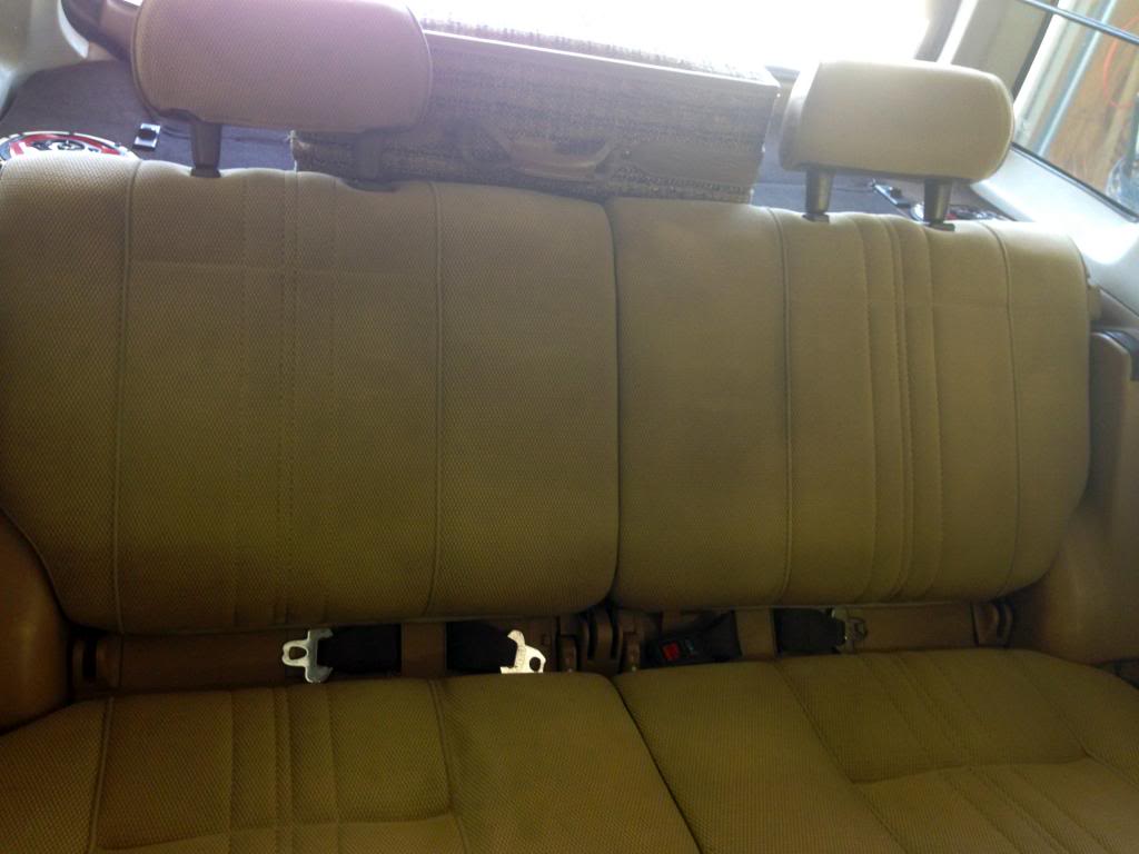

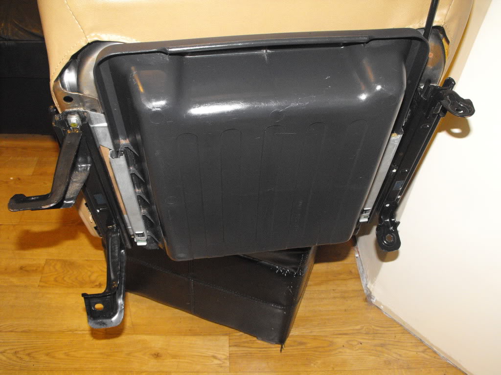

    New configuration for the rear seats. (back to factory/ stock)
    Comparison between new and old.
    I'm so messy ;)

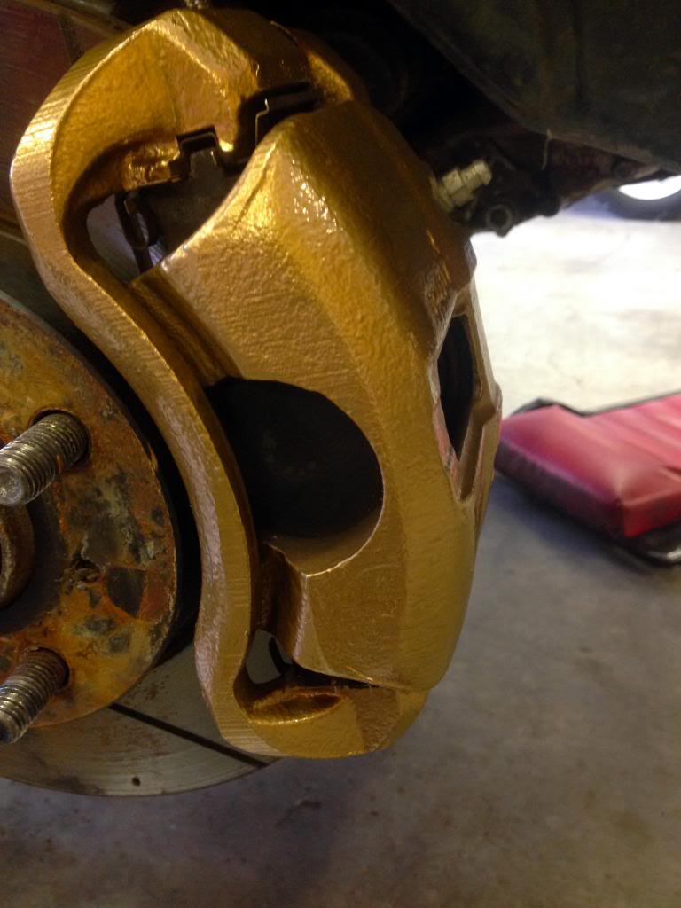

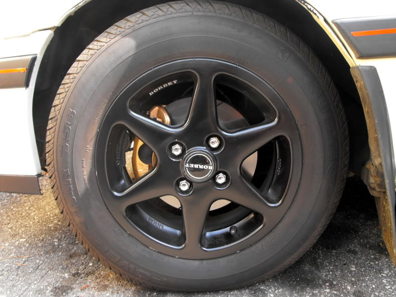

    Also brushed on some paint to touch up the calipers in some places.
    Still requires test drive.
  • sick! Calipers look great man

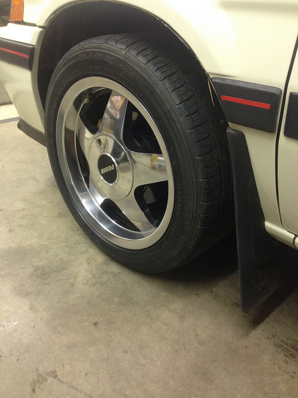

    My big EF RT rotors were coming in contact with my new LCA's.
    Had to shave the arm's end down. Rides super smooth and queit now.
    Here are some updated pictures.

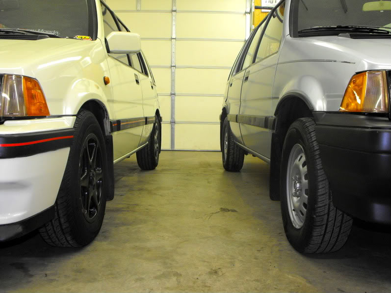

    I'm a little pissed to be honest, it seems those new front ball joints and arms have my front end sitting up about an 1/8th inch higher. FML
  • Still looks sexy as fuck though! That is strange that they would raise the height though...any plans to get the front back down?
  • AbideAbide Council Member
    had to do some of those on my roommates 86 sedan. His balljoint snapped right in half. Dont remember anything sitting higher afterwards though. maybe loosen up the nut. jack the suspension up then retorque it? It sure shouldnt be that much higher though. Still lookin good!
    I just love it so much... I want to impregnate it...
    I've played with it quite a bit, Abide and Skittlenips. Even shimmed under the ball joint's castle nut to see if I could get more bite on it. No luck.
    I went with the Dorman brand arms. I have noticed that the arm itself has far more girth in every dimension... This is all I can figure that it is linked to..
    Abide which brand arm did you guys use? Were you concerned with ride height at all?
    Because an 1/8" is a lil hard to detect with the naked eye on a stock ride height car (assuming your buddy's sedan was stock height)..
    But it caught my attention right away here. (as it is always my main concerns lol)
    Was hoping it would settle a tiny bit after running a few errands and putting a few miles on her...
    Not sure what else I can do... Time to Re-index the torsion bars I guess...

    his is such a pile that were were just excited to have it steer better. we didnt even notice if it was higher or lower. It was oriellys so probably dorman or beck and arnley or something.

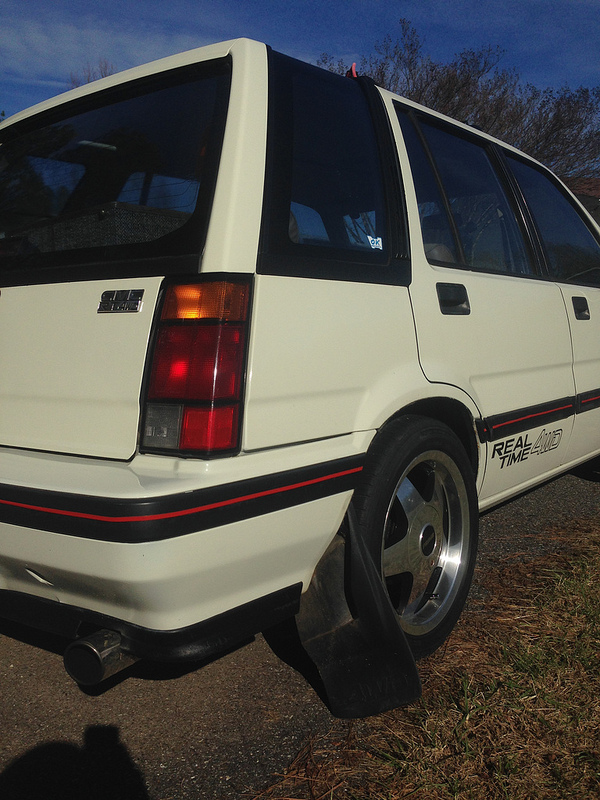

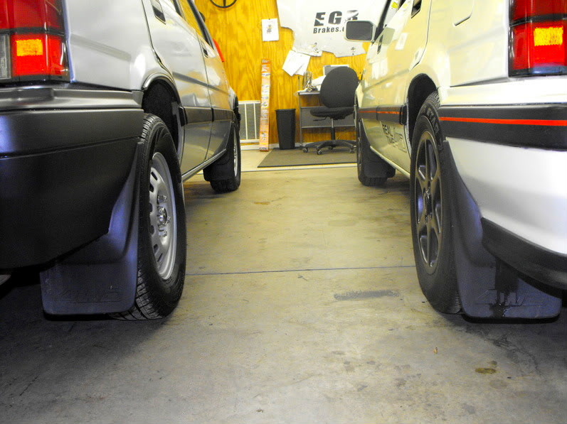

    Ripped a mud flap half off.. This caused me to shit a brick..
    It bent the metal tab inside the flap, but I beat her back straight and installed with some phatty 'ol washers to secure it once again.
    Back to Normal.

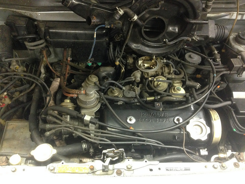

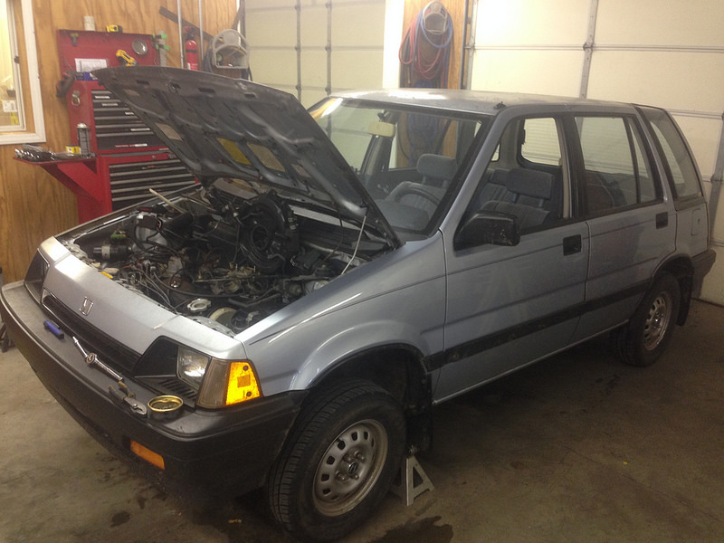

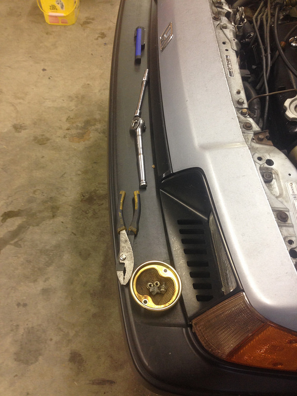

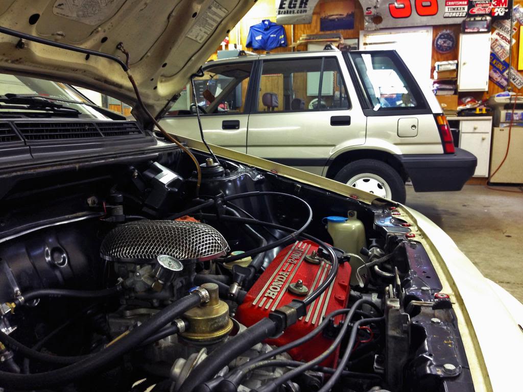

    After my '85 AWD started acting funny lately. I decided to inspect this wagon's cooling system. Also needed to address a clogged heater core anyway.
    New Thermostat
    New drainplug
    Flush system
    Flushed the heater core for a while
    Coolant
    The heat blows better than ever.. Feels cozy. I'm happy, it's 9 degrees outside...

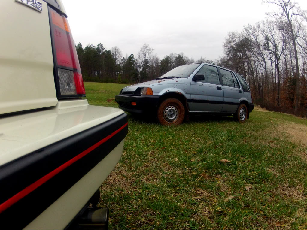

    This update includes a little feature of my '85 actually.. It's been my main driver lately..
    Did the same to it, except the thermostat had been stuck open for the last week or 2, not allowing the engine's choke to disengage fully. As it always read cold.
    Runs better than ever, the idle is at a steady 980RPM, forever. Left it outside runnin' for like 40 minutes.
    Oh and now it's heater will run you straight out the driver window... The fire of hell comes through those vents, I'm sure.

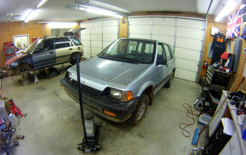

    AWD Comes complete with work-bench..
    They both need an inspection tomorrow.

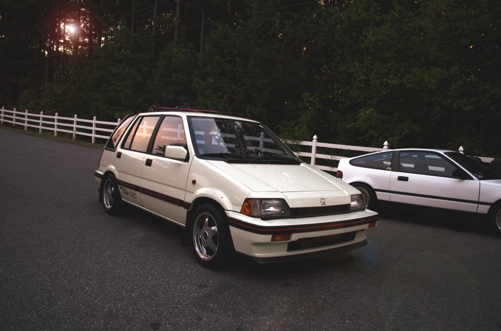

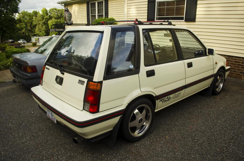

    I posted this picture of my '87 on my Instagram.

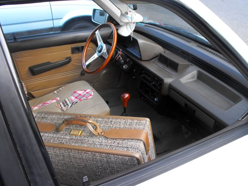

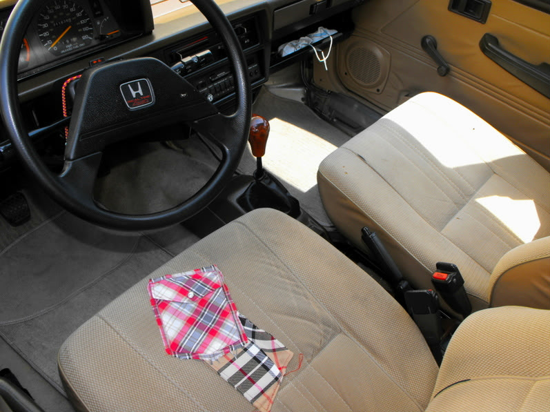

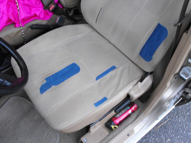

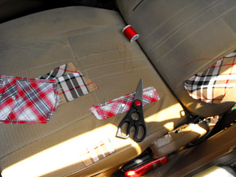

  • I love your wagons man, the '87 is so clean. I am going to have to use your seat patching method, and the stash pocket idea is a perfect spot to store a phone.

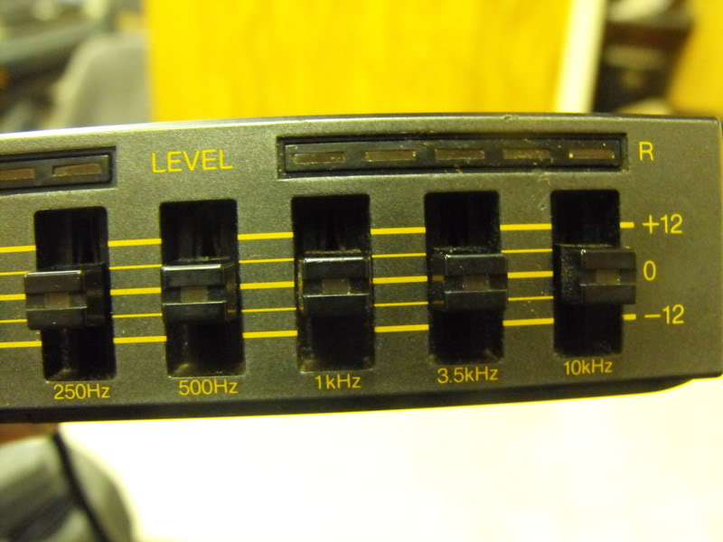

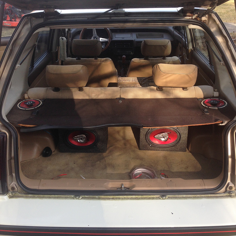

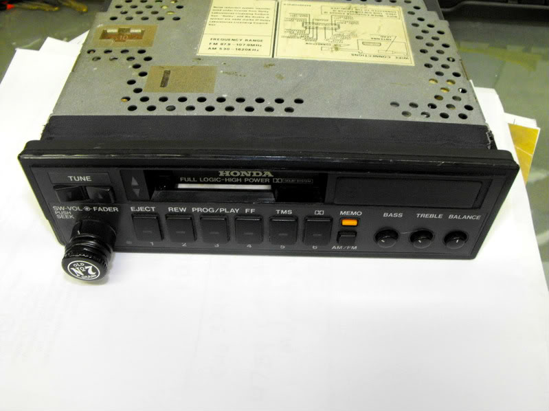

    And Cool, found these 6x9"s with little boxes in a junk car! Little extra kick in the trunk.
    Now I need to replace my deck speakers.

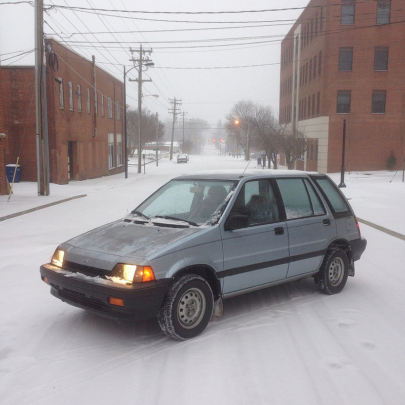

    Thanks everyone! As you might be able to tell, I've kind of let the 85's updates land here in this thread. And here's a new one.

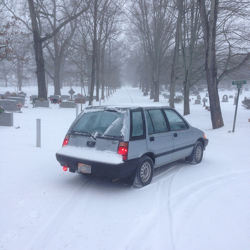

    SNOW!!! Took her out last night and carved a hundred doughnuts or so.. In NC, when it snows everyone panics. This means the street are bare and empty, no traffic, nothing.
    If I'm honest.. This was my very first time driving through real snow, as I am/ was a California native for soo many years. It was really cool and lot's of fun
    Also you might notice the Rat's little cameo, it is not sitting level. It's hard to see the new height, but it is certainly buried in snow.
    My buddy tagged along and his EF hatch did quite well! We had a blast, and one hell of a hoon session in our area.
