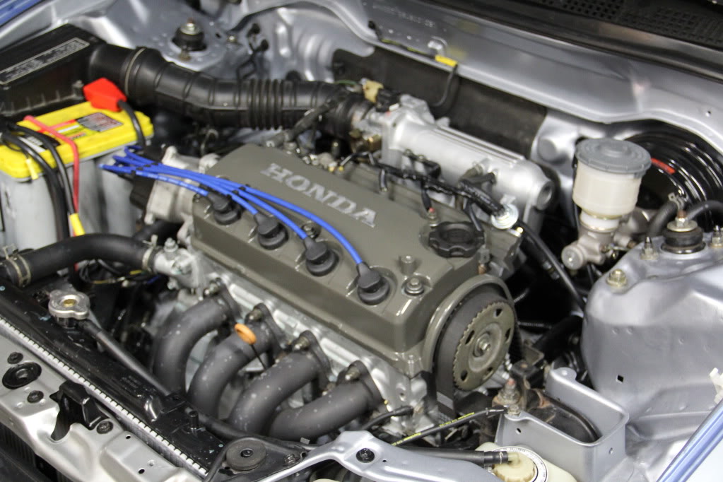

    Painted the valve cover and intake cover wrinkle black

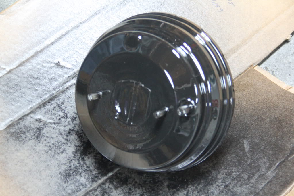

    Painted the heat shield gloss black
    And lastly used a 50/50 mix of water and Simple Green on the engine bay

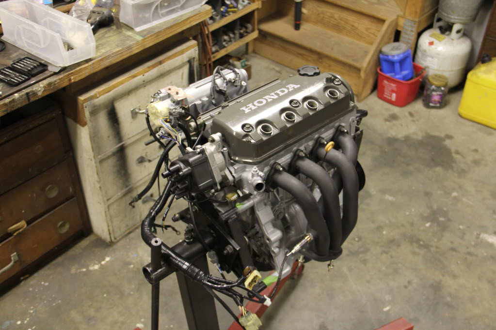

    Any who, I noticed your wrinkle valve cover, what all did you do to get it like that? I assume you used the wrinkle paint, but what steps did you take to get it the way you did? Layers, steps, etc. I just recently got my y7 swap, and I'm wanting to wrinkle a valve cover for it. :D Gotta make my car sexy for the meet. :D
  • GR33KGR33K Wagonist
    GR33K wrote:
    You going to the Carolina meet?
    Heck yeah, represent the meet! That's right!
    I stripped the valve cover down to bare metal with aircraft stripper. (Dont get that stuff on your hands! It burns!)
    Then I used the VHT wrinkle black paint (Rattle can). READ THE DIRECTIONS THOROUGHLY!
    You have to let it sit for 2 hours to see if it even wrinkles correctly.
    To do this you have to do 3 HEAVY coats all crossing eachother.
    Then let it sit for 24 hours before touching it.
    Then after 48 hours you can put it back together, but you have to cure the paint first in the oven for 1 hour at 200* F.
    I still need to sand the letters down though.
