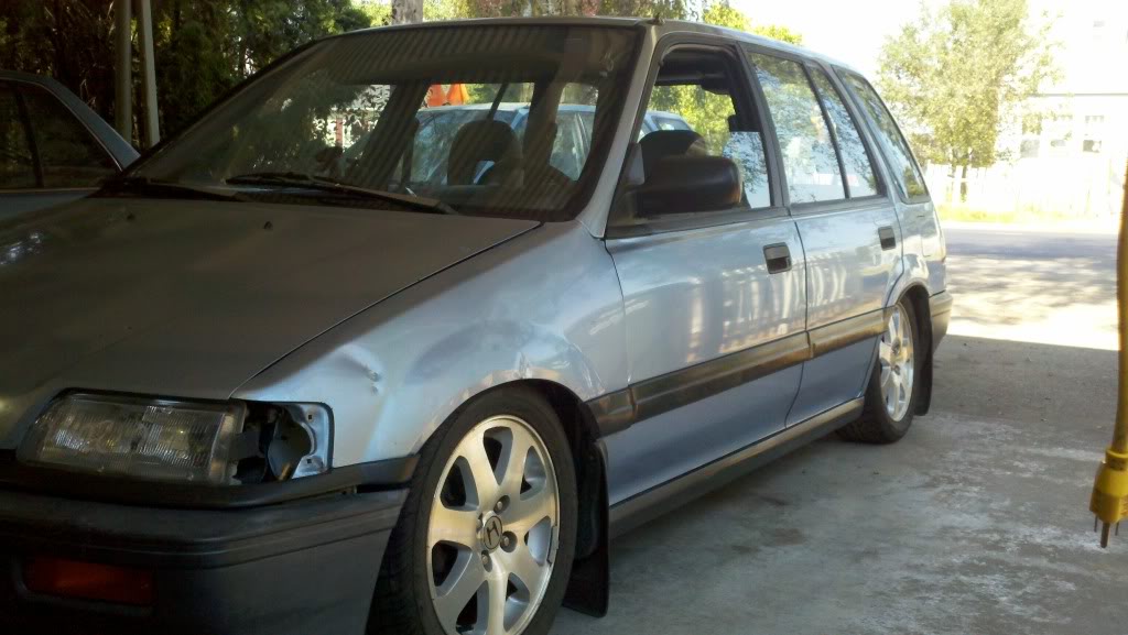

So the story goes, i picked his up from a family friend who bought it for the hood and fender non running 8 years ago.
732.jpgj

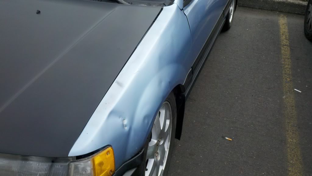

the passenger side headlight assembly was crushed in due to a wreck. fixed that with a slide hammer, vw bottle jack and alot of patience.

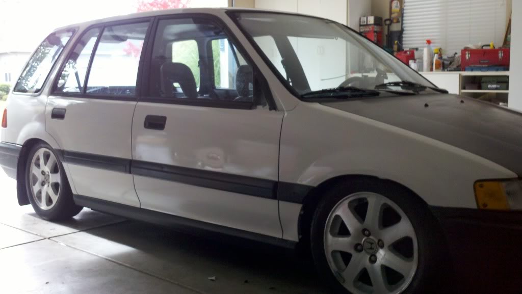

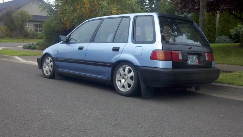

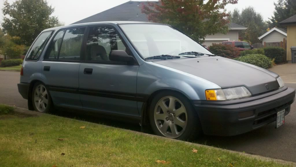

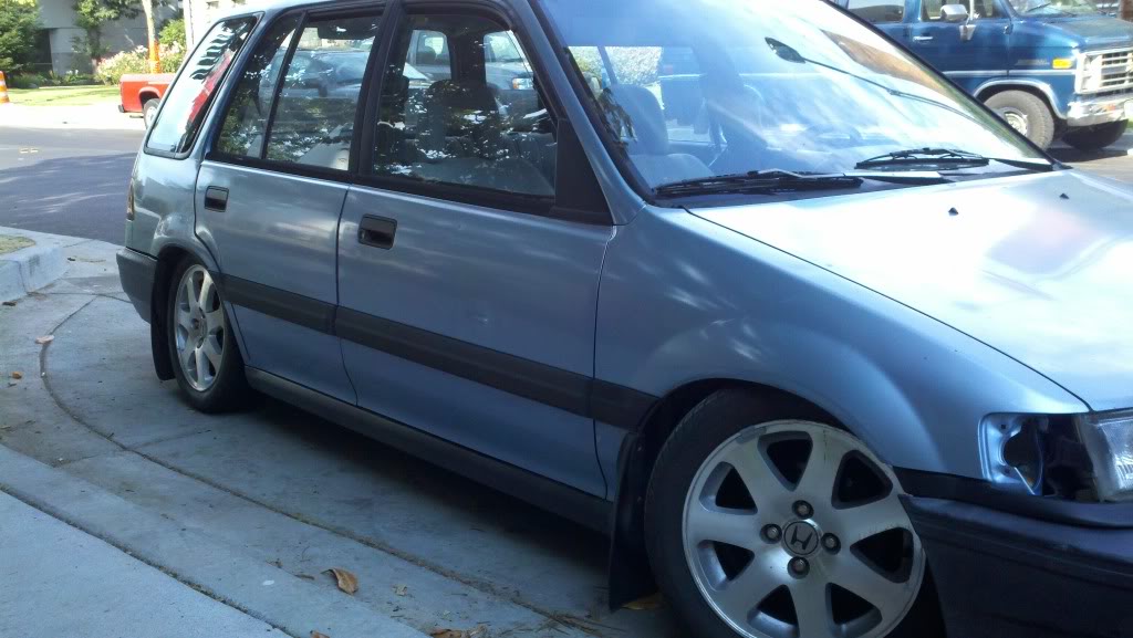

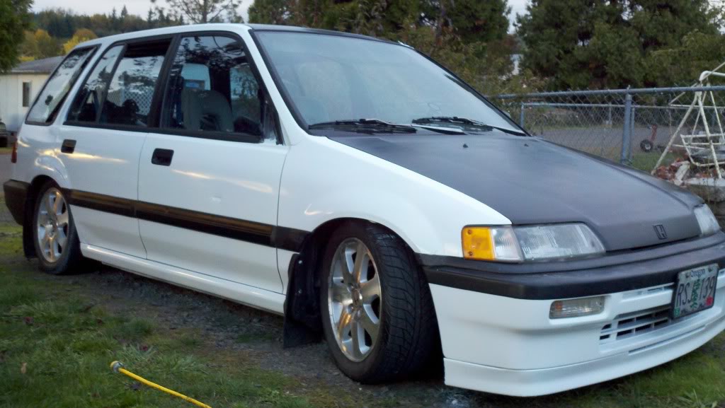

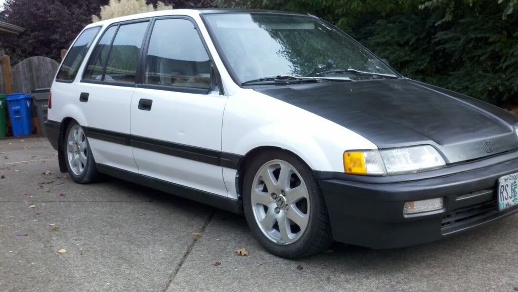

that here she is now after a month of work. !!
i really need corner lights :( and a bumper filler panel.
i also put in my wink mirror, blacked out my interior with dupilcolor vinyl fabric paint:wink: , put in a 97 integra console(still having mounting issues) did my outside plastics. Oh, and my si wheels :D
its getting lowered on option coilovers (with spring perch remove) next week with 2.5" extended tophats o& alignment.

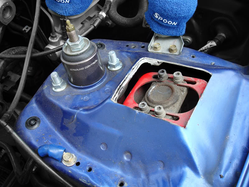

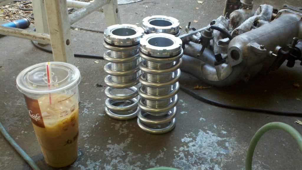

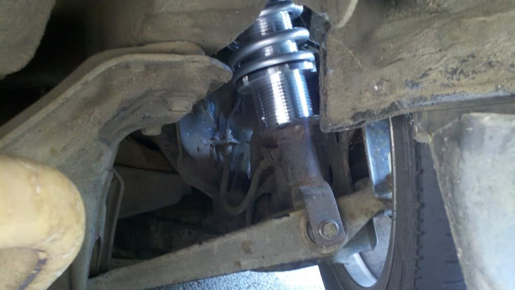

    show us some pics of the custom tophats, those are pretty tall!
  • heres a pic of the tophats.
    im sorry if it is flipped the wrong way, photobucket is being turd.
  • Car looks great!
  • CasiCasi Wagonist
    the idea with the integra console is great! i also have this on my ef sedan and i never want to miss my cupholder now..good job
    tophats are awesome man, is that with the option coils or???

  • Thanks guys :) the tophats are going on with the coilovers, and the Teg center console isn't fitted quite right, I used a dremel wheel to cut the bottoms center piece of the original wagon console. I may redo it using the one I cut up as a test template. But it'd ok for now, I also might put something behind the Teg and civic pieces and plastic epoxy the two together. But it was all just eye balled.

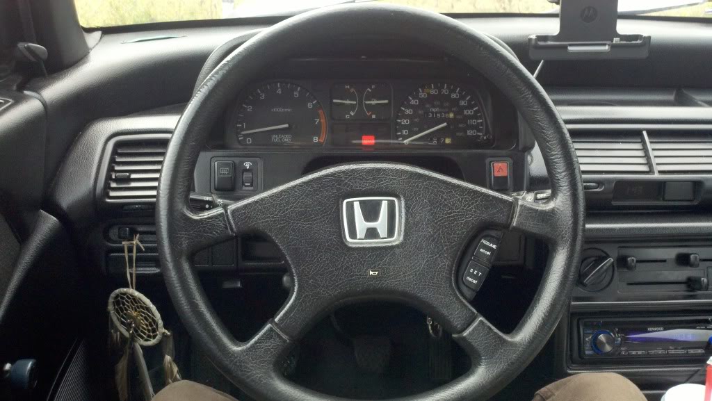

  • Didn't get my bezel or subie rails yet. Found something else Im saving for now.

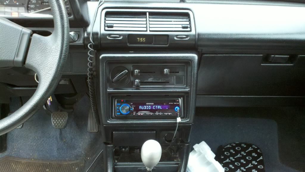

    But here a pic of my newly installed deck!

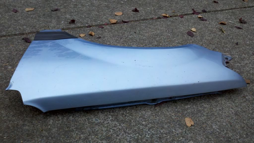

    Sending money tonight to get corner lights.
    And hopefully have a new fender on Wednesday as well. Hell yes! That'll put my project so much closer :)

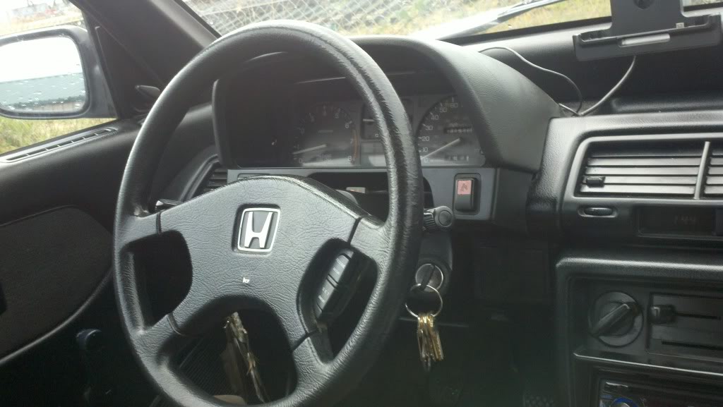

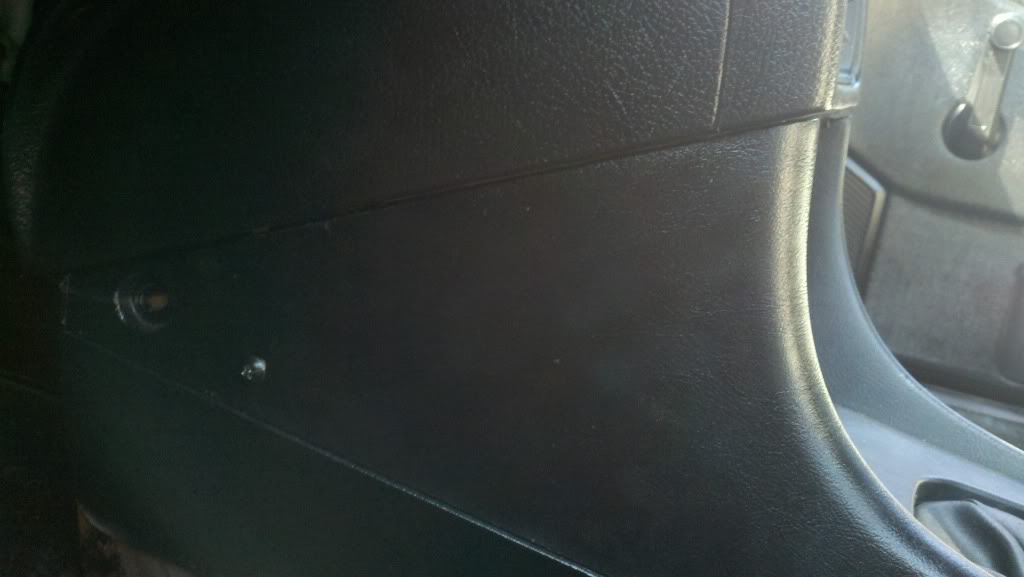

  • So I figured out How to mount the dc2 console correctly. The problem I was having was with the 2inch gap between the console and the radio housing.
    Apparently you have to lift the console so it fits up snug to the bottom of the radio housing and screw the dc2 into the holes that are there for the original lower piece. Which deletes the lower part of the civic console entirely. Im going to give it a shot after work and see if it works. I've seen it done to where it looks so Damn good, hopefully Ill have good news tonight.

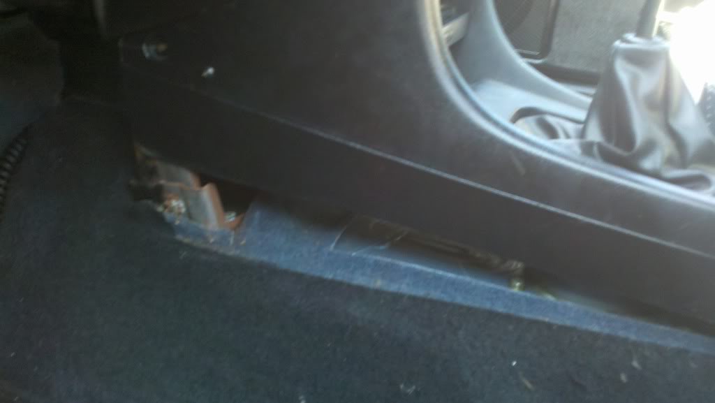

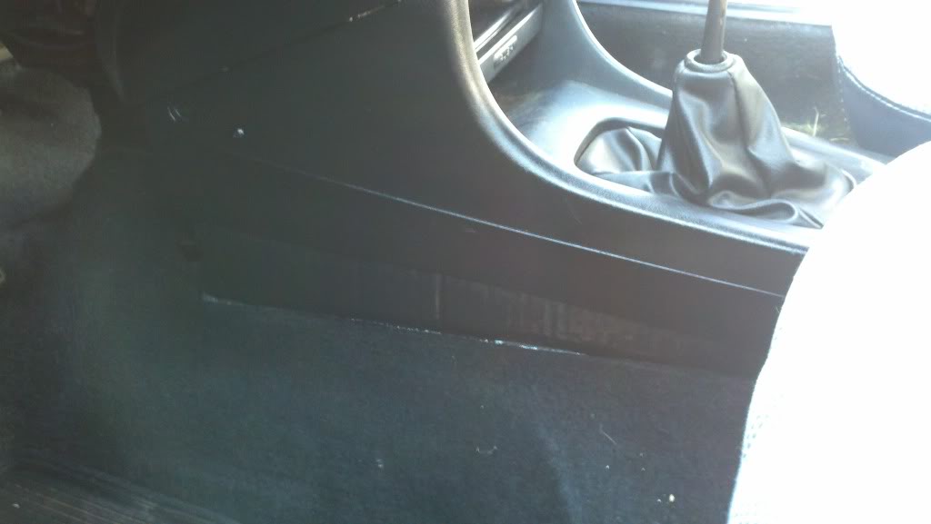

  • well...
    I sort of succeeded. basically I got the dc2 console to line up and stay in place.
    BUT, the 2 inch gap that was once on top is not on the bottom...
    my solution you ask? well let me show you.
    its sort of janky at the moment, but I used two pieces of cardboard and painted them to match.
    Ill use some abs plastic when I can get it, but for now it works.
    the OTHER issue is, since the front is lifted, so is the rest of console..
    hence, the center where the e brake is doesnt line up flush now..
    Im gonna figure this out. any suggestions?
  • oregon represent!!!
    I lost the link but a member on here had a pretty good solution.
    He left the gap on top and took a piece of the center console from an EF hatch and I think cut it to fit? I remember it looked pretty good.

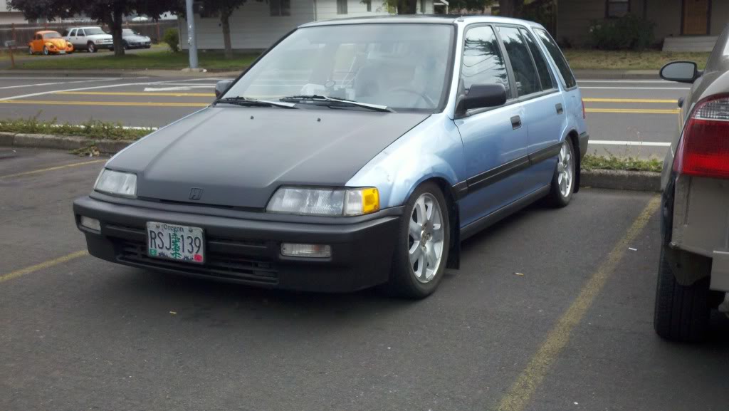

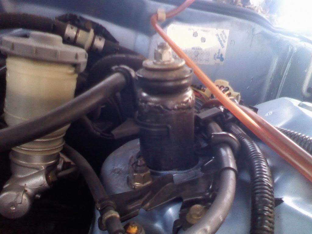

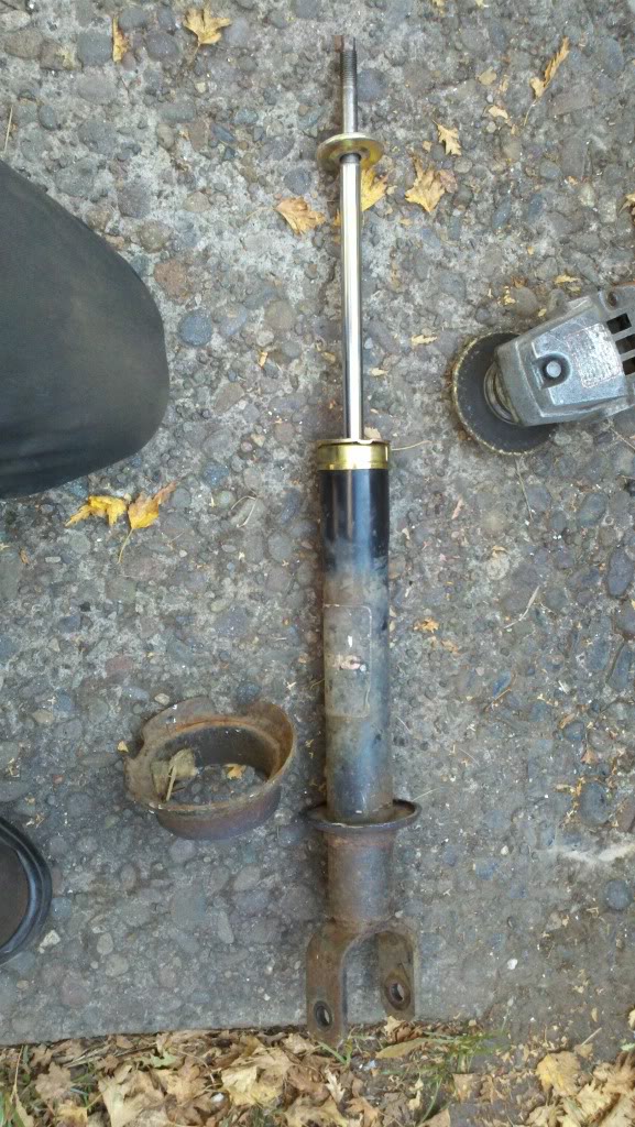

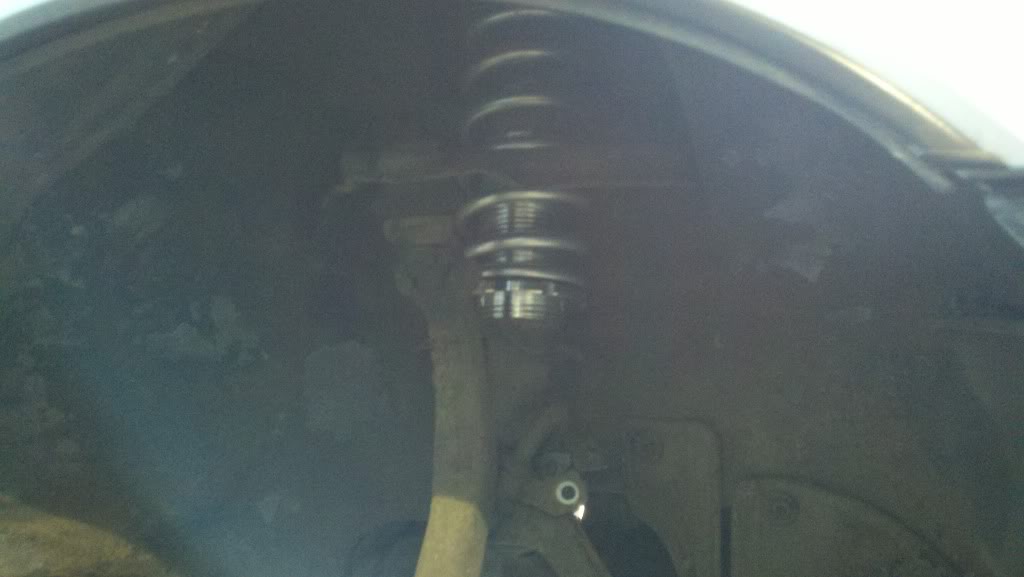

  • UUUUPPPPPDATE
    I did something today something very good
    Out with the old and in win the new exxxtended for your pleasure
    One down three to go
    Spring perches cut off equals extra dumpage
    DRUMROLL PLEASE
    TURNED OUT SO GOOD
    Haha twins

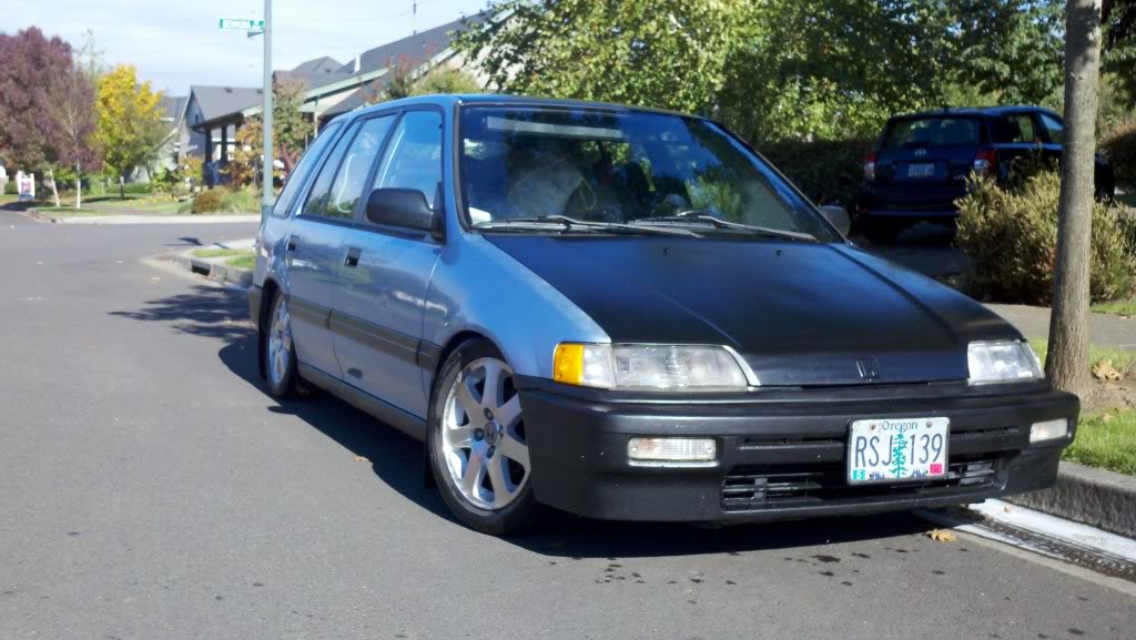

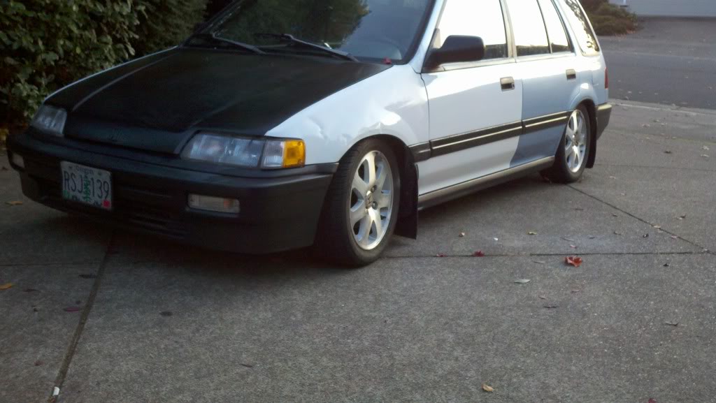

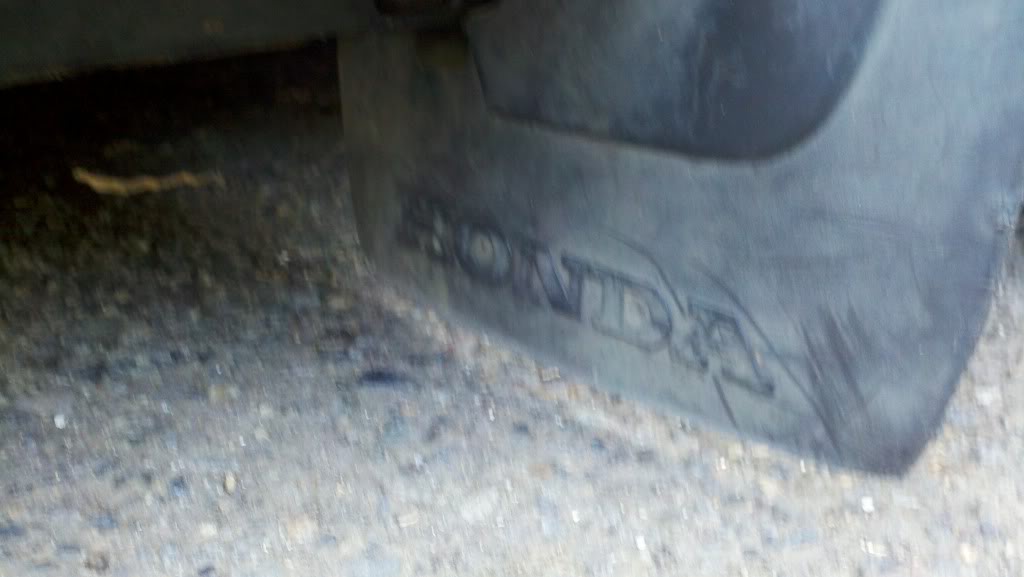

  • MOOOAR PIX
    Rubbing really bad haha I need to cut them down
    turned out great, did you end up going with your original struts?
    dont cut the flaps, let them wear on theyre own!
  • Yep original struts and OPTION Coilovers
    The ride is almost stock minus the mudflats grinding pavement
    The tophats are so nice haha
    Ill let the mudflaps grind themselves down
