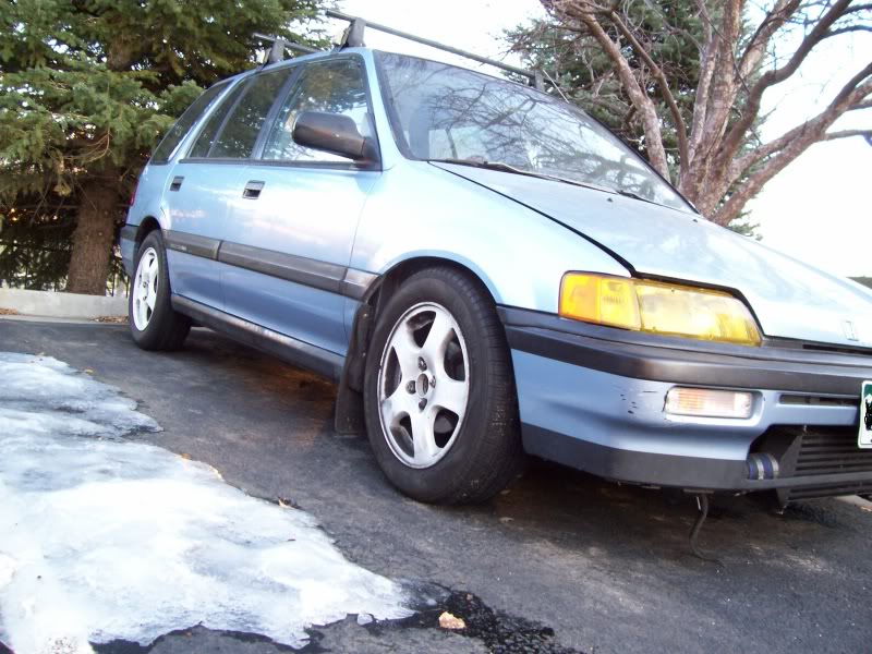

Ok so no drive shaft yet. But i will be comming soon, and i need it.
Running 450cc injectors. FMIC. Apexi VafcII. Stage 5 clutch. Gsr b18c1 with 250 miles on it since rebuilt (almost blew up during the first turbo tune) new rings, headgasket and rod bearings. CRV tranny. Traction bars!
Its all a really tight fit. the radiator sits at an angle. no washer fluid system.
The car runs good right now. Its tunned for the 500 mile break in period so it only revs up to ~6k and the vtec is disable. Running gas right now. but i'll be tunning it for e-85 after the break in.
Next additions will be.... Blow-off valve, drive shaft, and much much more.
Ill try and get back on more often to answer any question.

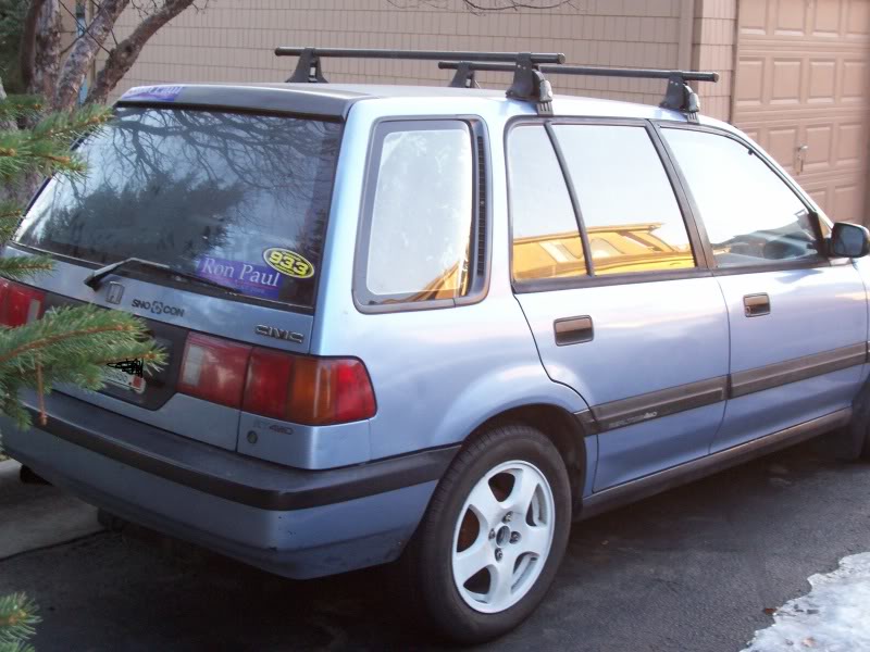

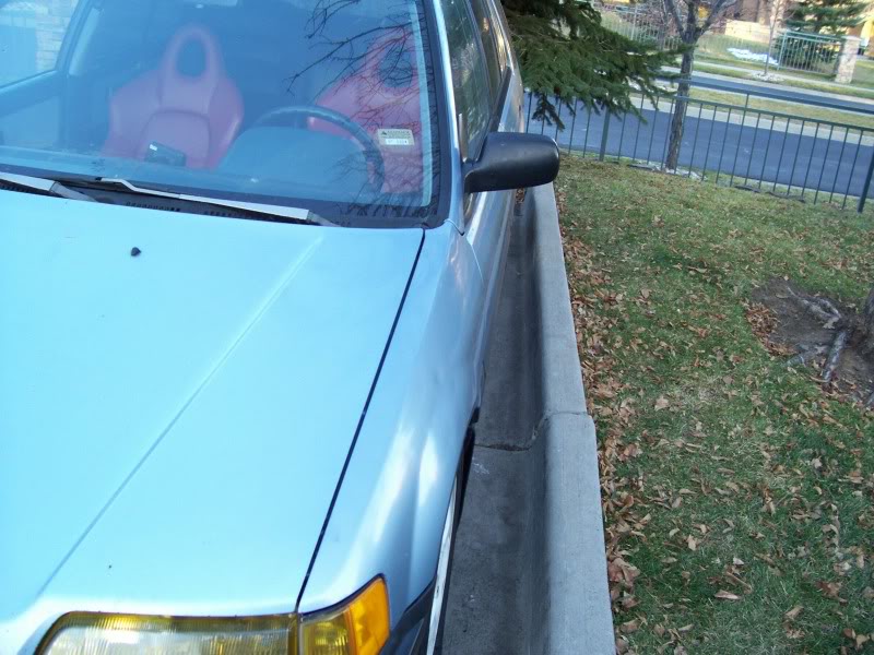

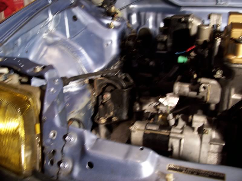

In the third picture you can see the traction bars on the right, they are horizontal and there is light going between the front bar and the bottom of the bumper. You can see the output shaft on the left. It also has a custom Hydro to Cable that was made using a pedal assembly
Have you thought about running the washer bottle inside the front bumper on the left hand side? Thats the stock position for an EF5 with headlight squirters.

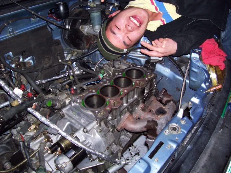

Well i finally got logged in. So ill be posting some more new pics. I blew the engine about 3 weeks ago while running ~27 lbs of boost. But i have some great photos of the engine mounts and such that ill get up here. Engine has been torn down and i've replaced the broken parts (piston landing broke out). So check back soon.

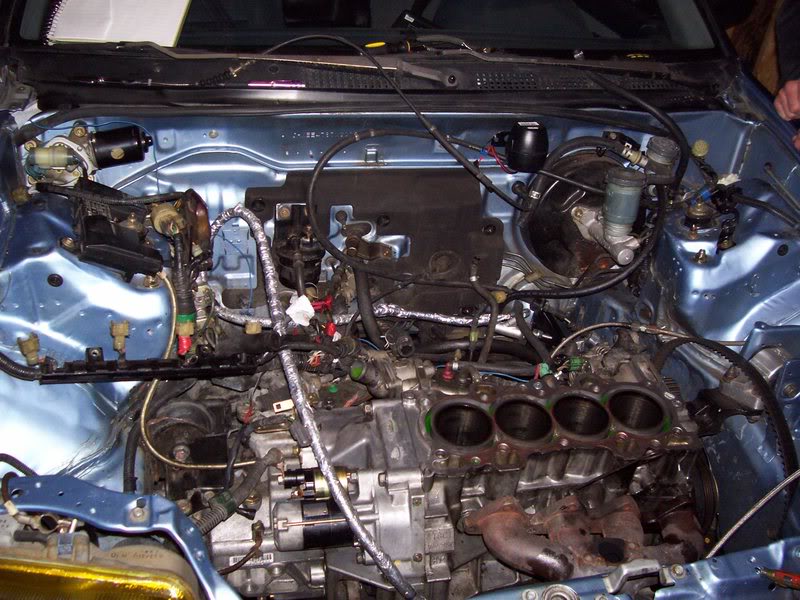

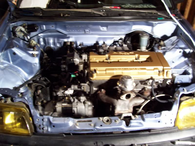

I shaved the engine bay. It was pretty easy with good results. There are a few harnesses that need to be lengthened to pull the fuse box thru to the passenger kick panel. If you want some more pics of that i can take some.

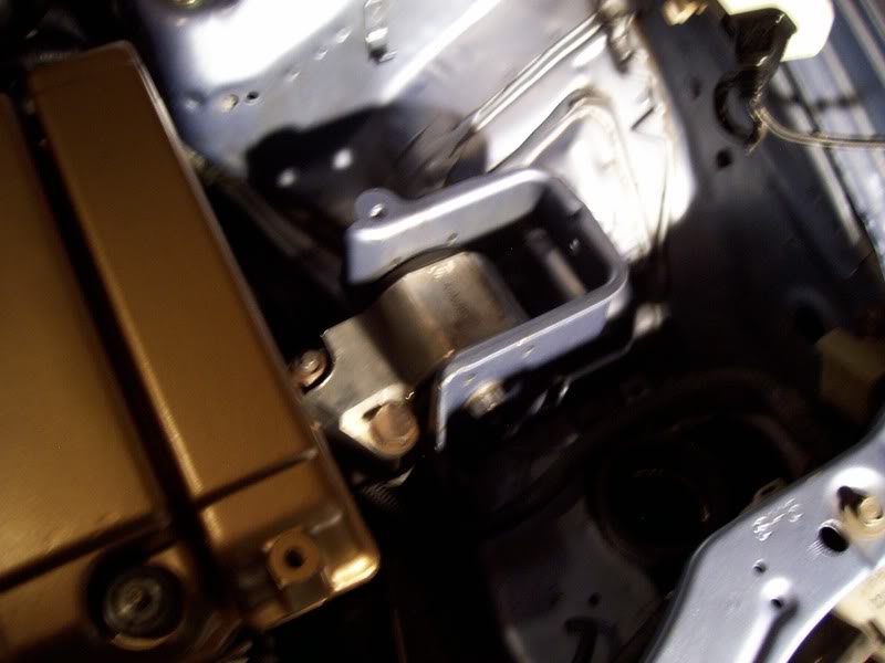

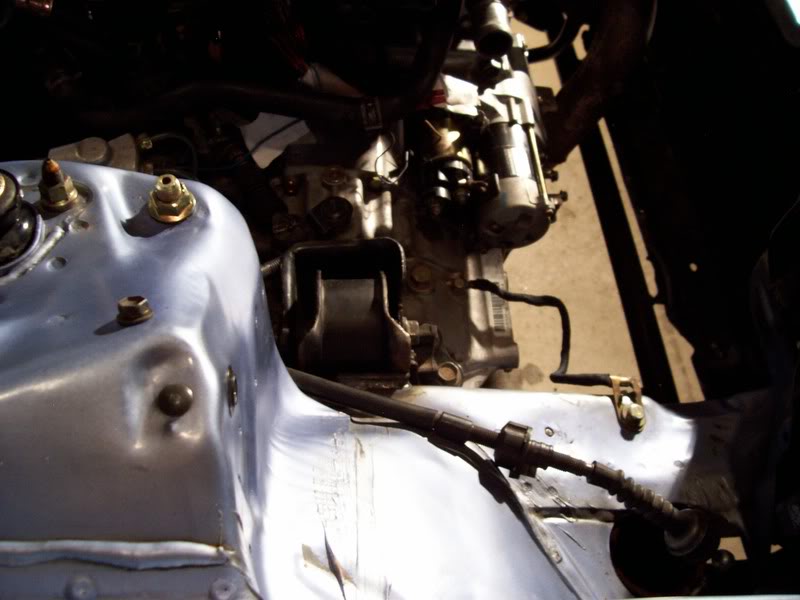

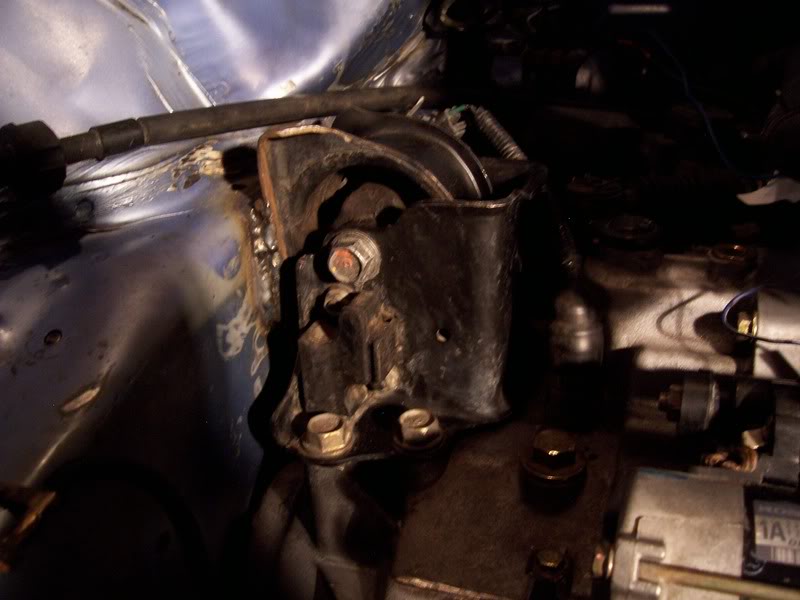

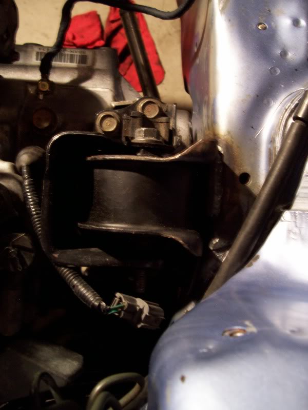

Here are some pics of the front engine mounts I can take some better pictures so you would be able to get the perfect location of the passenger side mount because that one had to be removed and replaced
heres the passenger side mount has to be welded on. camera is right above where the radiator goes (if you need a point of reference)
And again with the camera a little further infront of the car
This pic was taken from the passenger side of the car looking downward look (notice the side of the shock tower on the left of the photo)
Looking straight down on the mount. Shock tower in the bottom left
Ill try to get some pics of the tranny mount tomorrow.
This is the Drivers side mount. Using a DA "engine to engine mount bracket" makes the mount sit at a weird angle so i used some washers between the mount(Aluminum Hasport) and the DA" engine to engine mount bracket" to level it out
why did you move the pass. mount?
