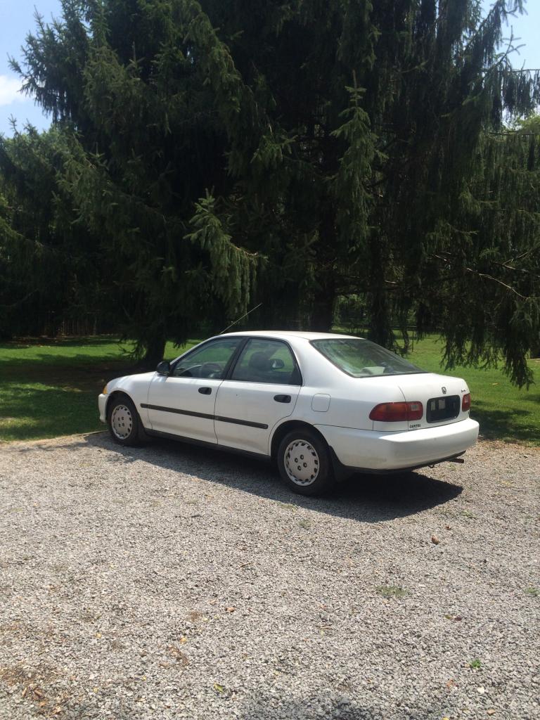

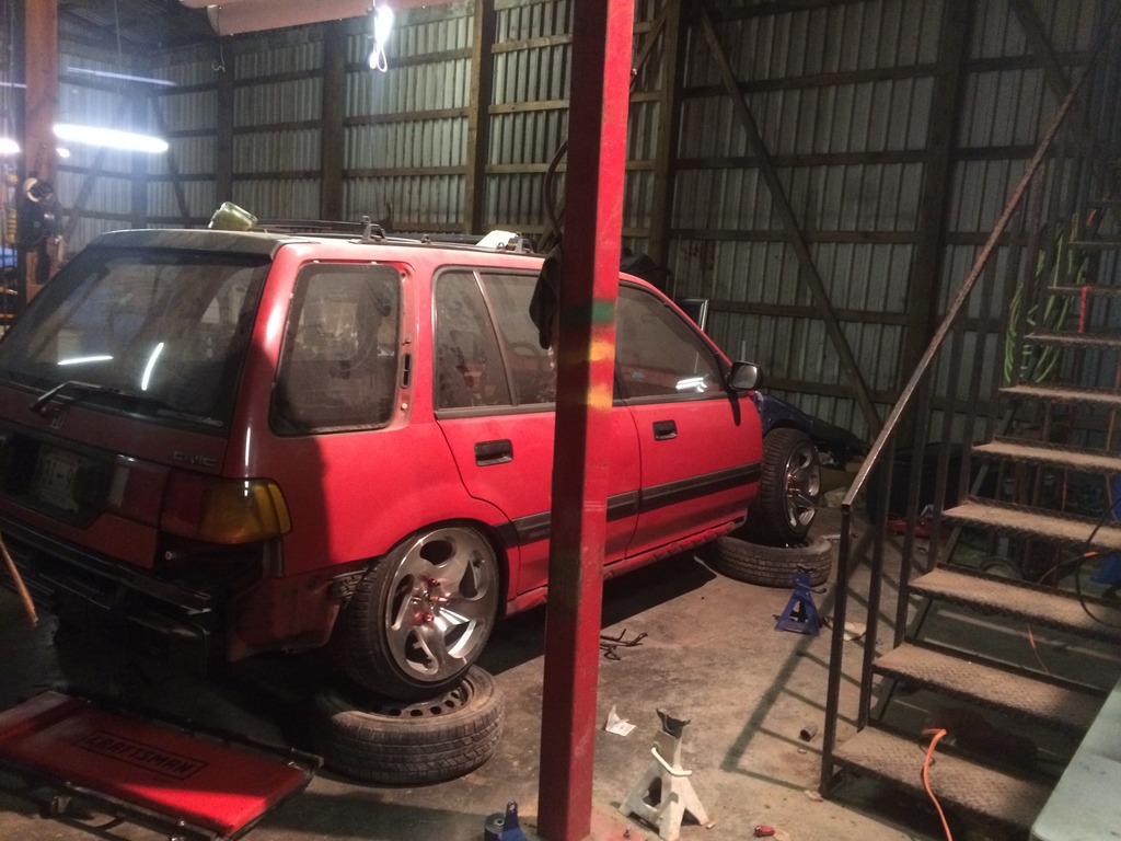

Well I have had a couple of "build threads" but they never really took of because I would end up selling them. Now I am on my 15 and finally car. The one and only RT4WD Civic Wagon. After searching for a couple years I finally found one in mint condition and only 4 1/2 hours away.
Here she is
She is in mint condition with one quarter size bubble of rust and like a handful of dings. Also has 147k on original motor. With this being my last car for awhile I want to start a build thread...a slow one at that...but I will be doing work to it and have some plans for it

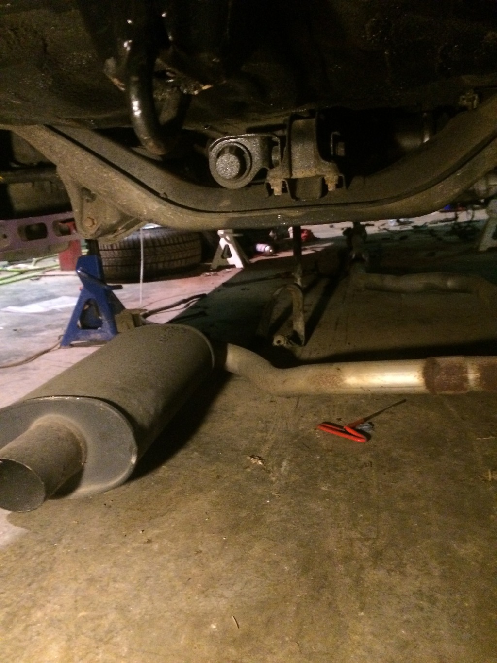

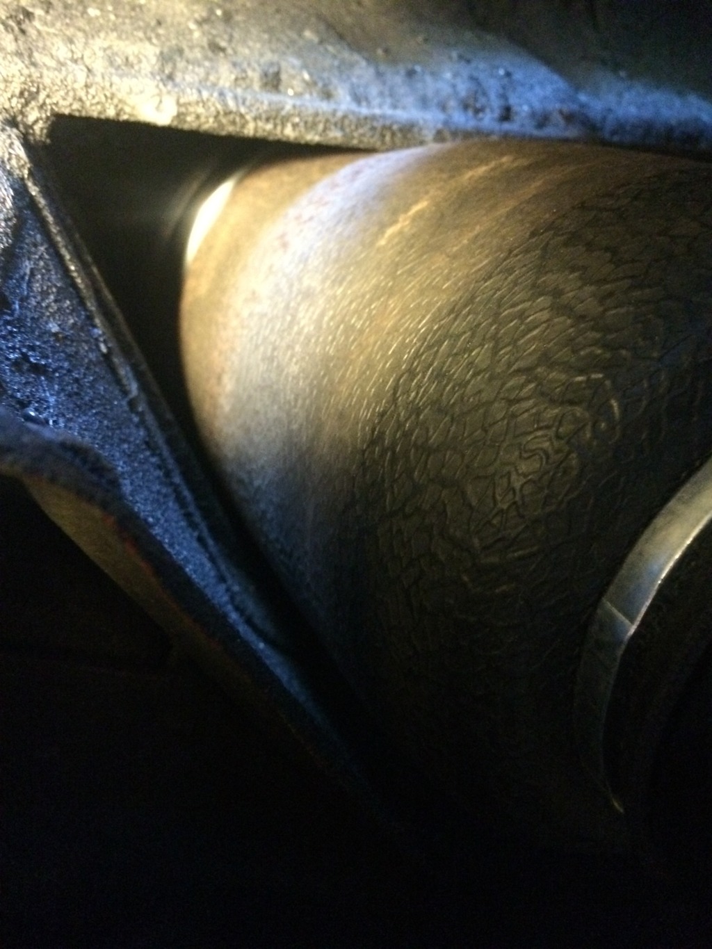

I hate this exhuast..it hangs so low and there is no cat. One thing on the list of many to replace.

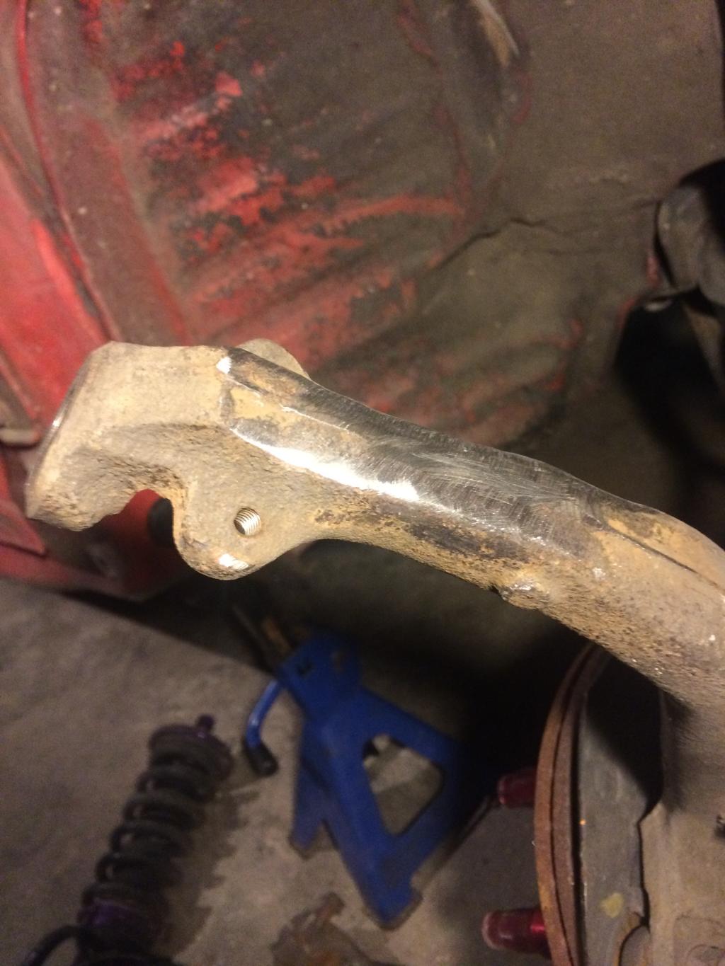

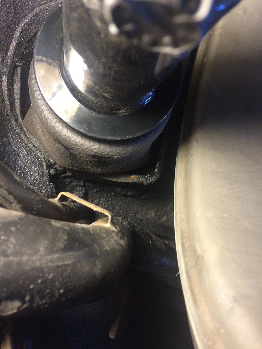

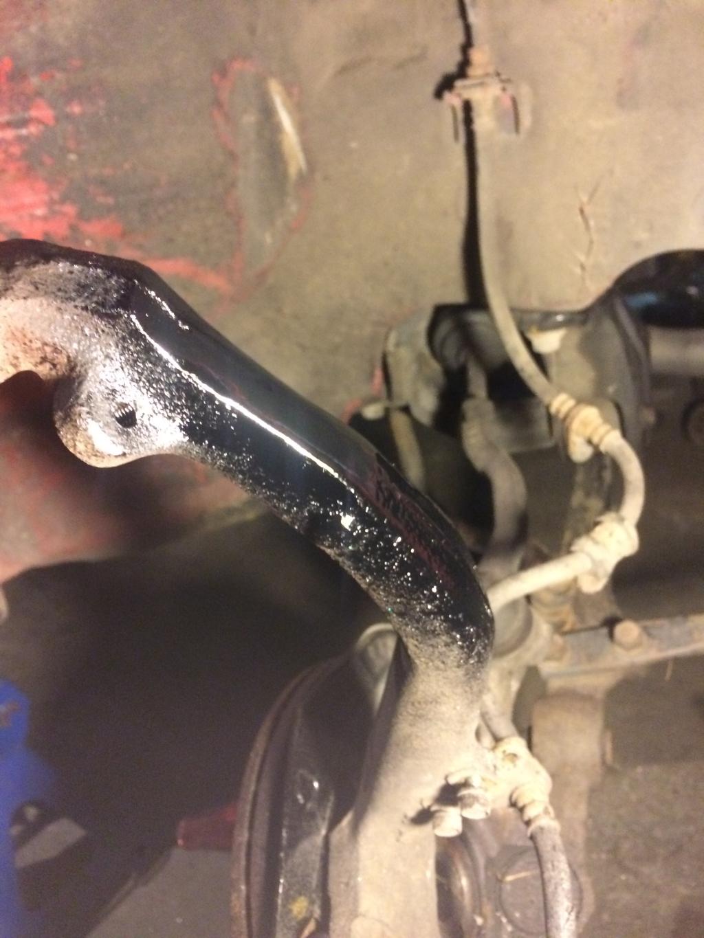

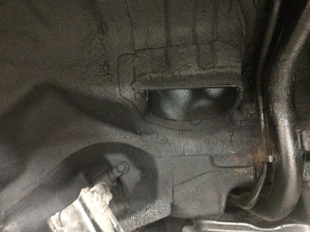

Passenger side Trailing arm bushing #1
Passenger side Trailing arm bushing #2

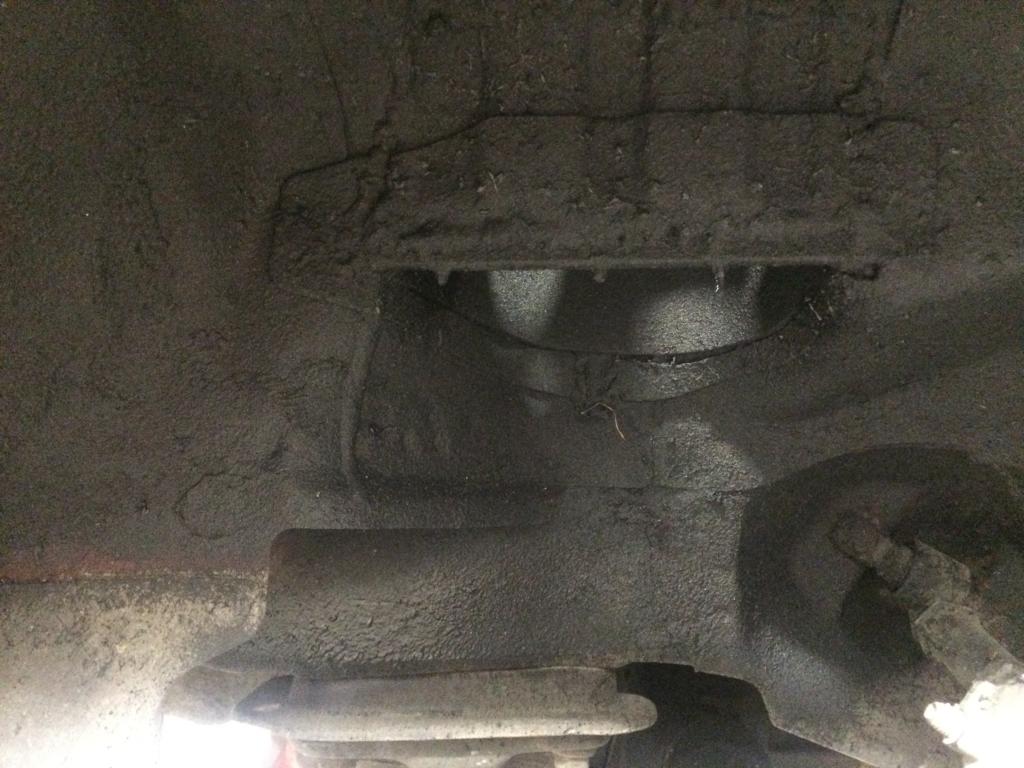

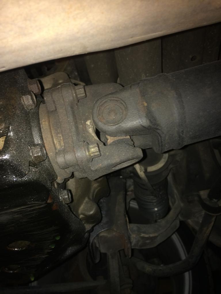

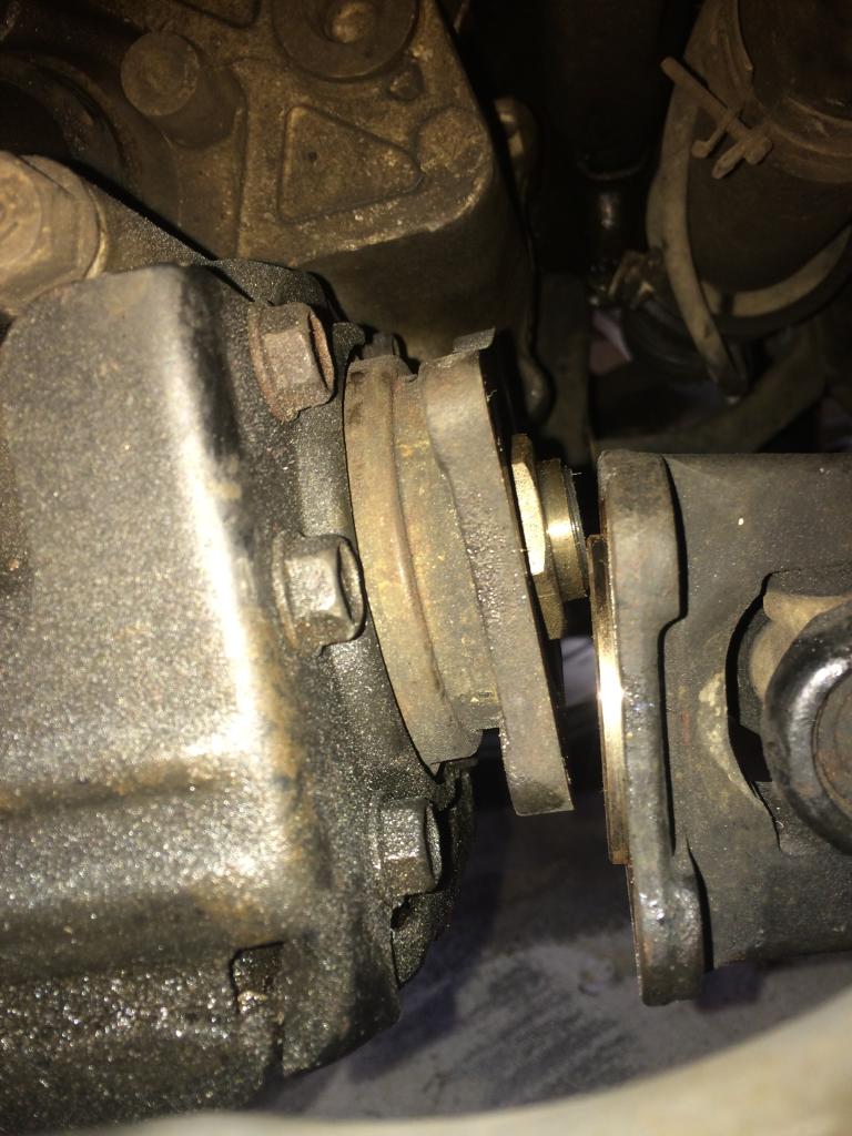

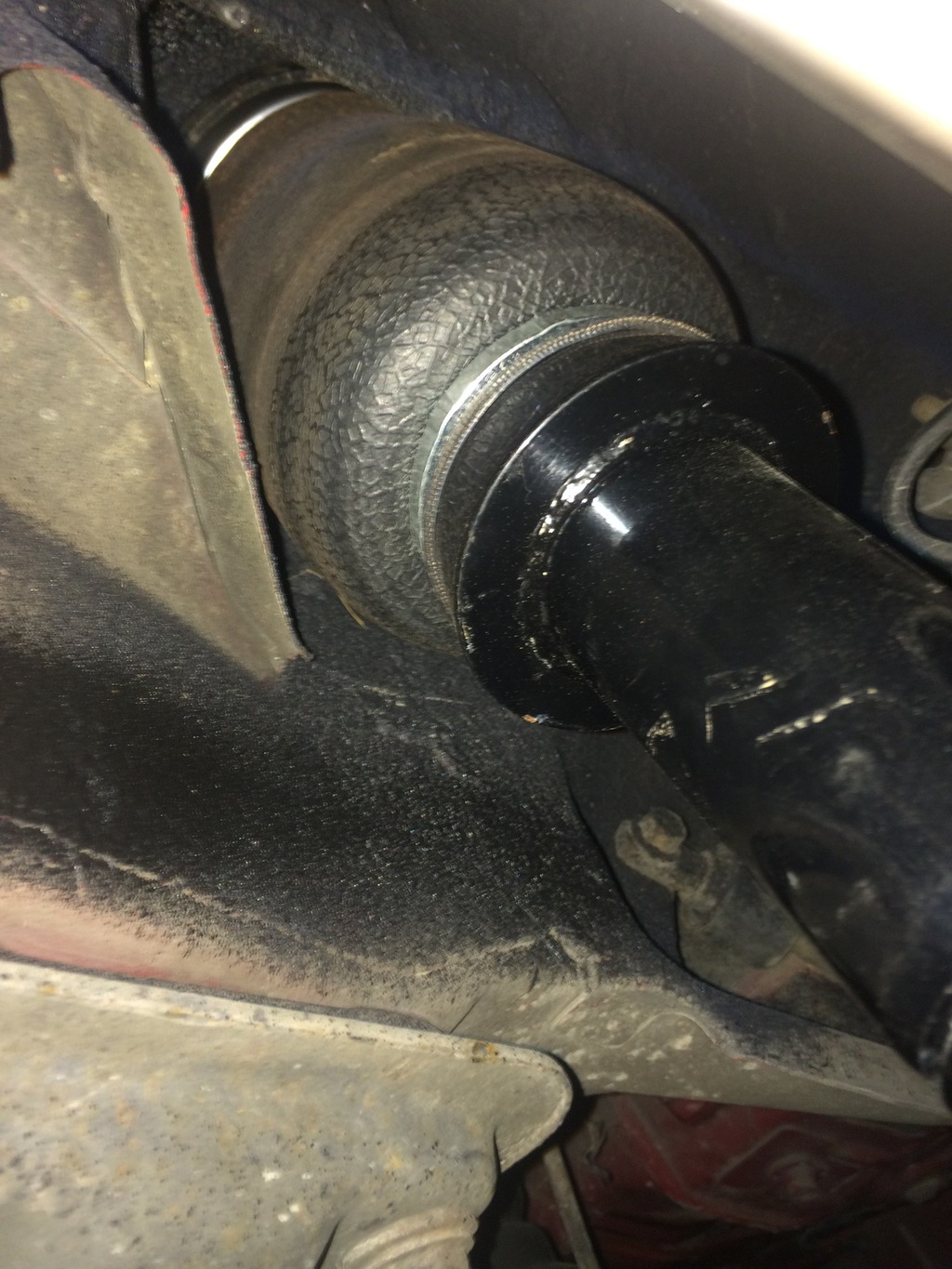

What is this? I am able to move it around freely
And this is the mount for the rear differential
As you can see I can move it around freely? I'm pretty sure it is called a vibration dampener or something like that.

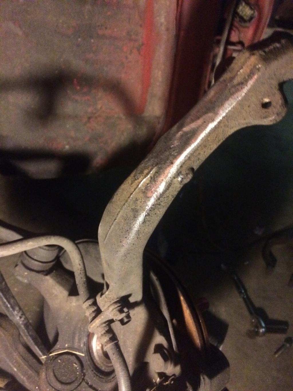

Driver side trailing arm bushing #1
Driver side trailing arm bushing #4
Driver side trailing arm bushing #5
So I have been hearing a decently loud clunk from the rear end when I am disengaging the clutch pedal after shifting gears. I am trying to figure out what has went bad and needs to be replaced. Thanks for any input y'all can give me.
Its the rear diff mount, common problem on RT wagons. You can get a new one from majestic honda or your local dealer.
Number 10 in this diagram.
Thank you very much man
what is #4 called? And it's purpose? I saw it while under the car. Is it considered a rear dif mount also?
Thanks man.

That is a vibration damper. You can remove it. I took it off both my Wagon and my CRV.
is it not worth replacing?
Trailing Arm Bushing
Vibrant 2.25 Muffler
Vibrant 2.25 Cat
Vibrant 2.25 18" Resonator
And Rear Dif Upper bushings
