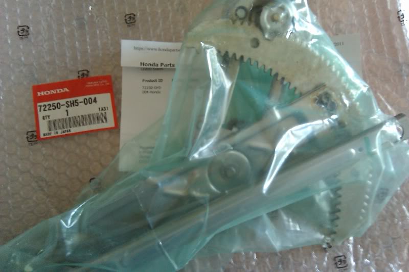

    With the last of my 'wagon fund' I ordered a left front window regulator. I was told it took extra long to get because of the earthquake & tsunami has led to parts made in Japan being spread thinly over here. The outfit I ordered from had to order it in from somewhere else. Like a backorder I guess but that's not what they called it. Anyway, the big brown truck dropped it off today.
    Mine took a while when I ordered it. if I had known I would of ordered 2.
    Im gonna make another order and get a passenger on also.

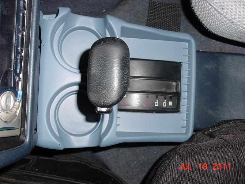

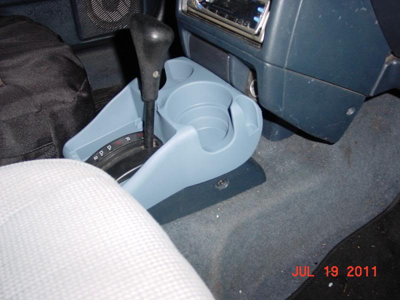

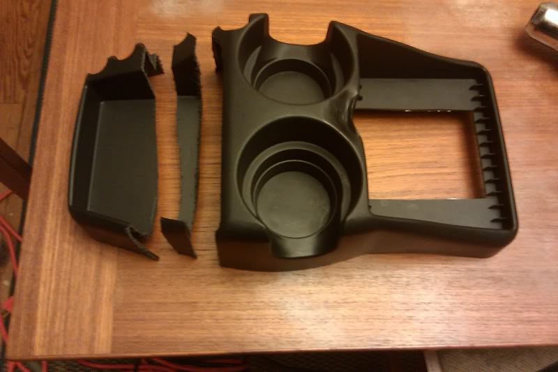

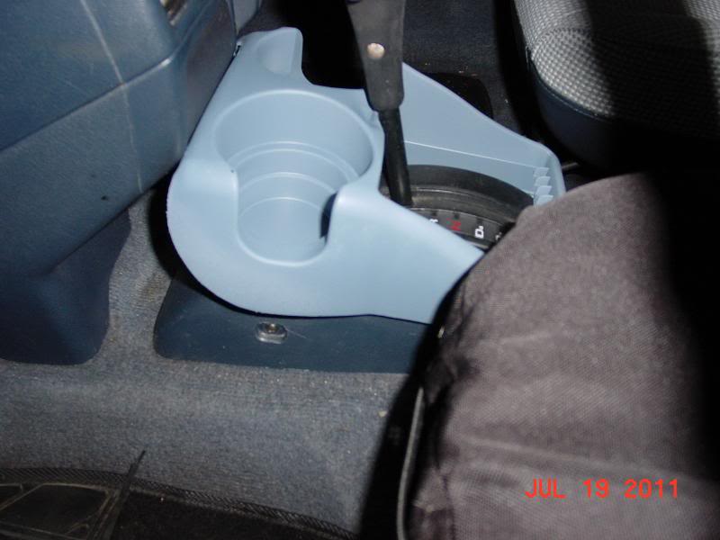

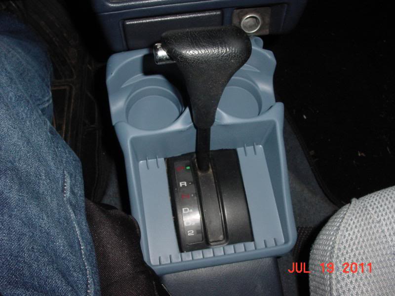

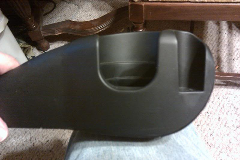

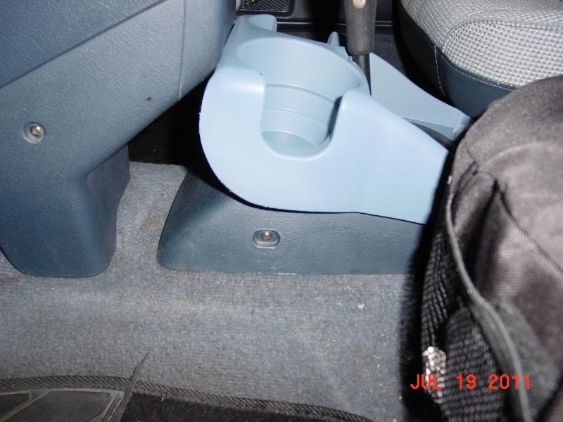

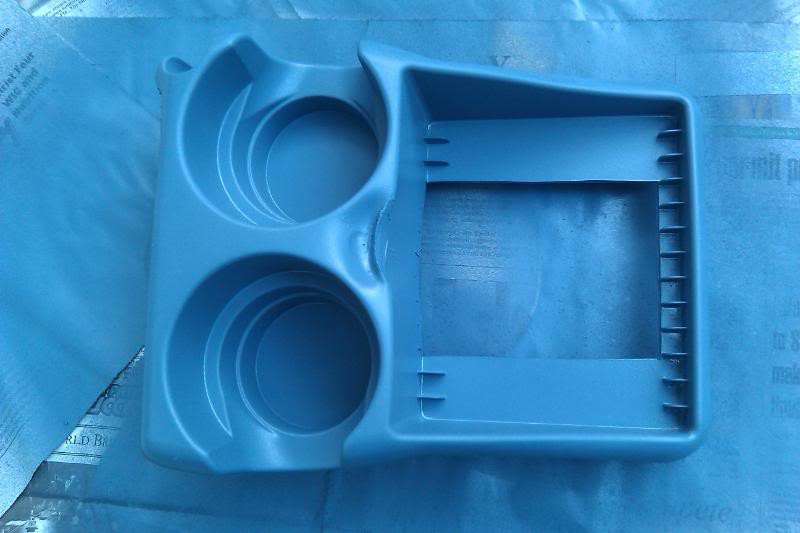

    Due to my of broke-osity I decided to try fitting the cupholder into the wagon. This one is similar to the Wal*Mart cupholder but I couldn't find one there ...I think this one came from the OtterZone.

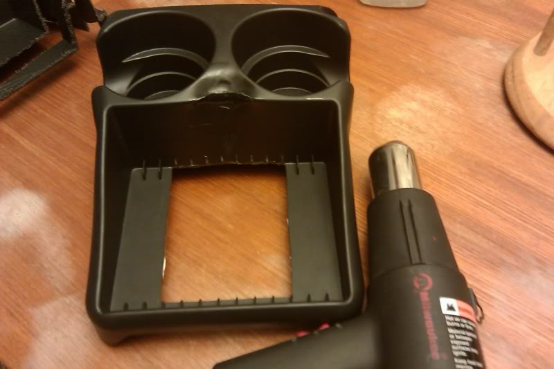

    I took the front off in sections with a hacksaw. My thought was to preserve as much structural integrity as possible - turns out I didn't need to; the section where the cups go is still stable. I bet it would be as long as you didn't cut into the actually cup-holding part.

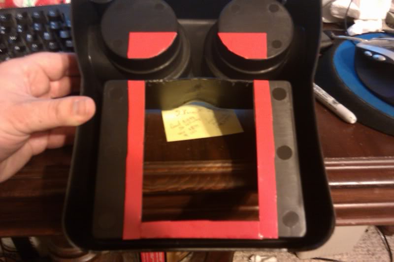

    The other thing I did was mold the inside of the box so the shifter could go all the way forward into Park without bumping. First I got it warm enough with a heatgun and pressed a 2xD cell MagLite into it until it would clear the shifter. I was left with an unsightly ridge that I might've filed off with the half-round file I was using to smooth edges but it would have broken through the plastic and left an even more unsightly HOLE.

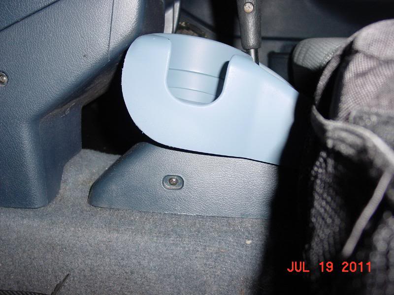

    To make sure it doesn't fall off once it's in place I put some 2-sided tape (3M 4011 Permanent Outdoor Mounting Tape) on the underside where it would sit against the console. Although it's "permanent" tape I've peeled it off of other projects after prolonged periods without leaving residue. That'll be handy if/when I find a solution I like better.
    I wanted a curved edge at the front bottom so it wouldn't snag on things like pants-legs. And so it would look cooler. I traced around an old (almost) useless CDRom for a nice wide round curve then cut it along the line with a pair of heavy duty scissors. Might've ruined the scissors but hey, they were $2 at Northern Tool so I can probably manage to replace them if I have to, huh? There wasn't a good line to cut the quarters slot off the cupholder so I kept it. Of all the coins to keep in the car quarters are probably the most useful.

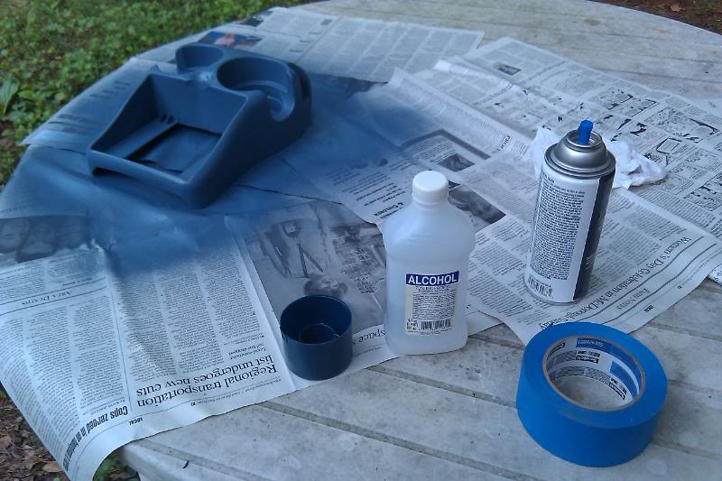

    I broke out the DupliColor Interior Vinyl & Fabric paint I used for the speaker pods, rubbing alcohol, and Norton sanding pad (like Scothbrite) rated as "000" (like steel wool) to scuff it up enough to get the paint to stick. I wiped the piece down with alcohol to get the gunk off, scuffed it, then wiped it down with alcohol again. I let it dry then applied the paint according to the instructions on the can.
    Observations: In Park 12oz cans, .5 liter bottles and 20oz bottles fit well. In Drive a larger cup will fit but gets kind of smushed if you don't remove it before shifting to Park. The cigarette lighter is accessible but with the USB adapter to charge my phone the right cup is obscured. Since it's usually just me in the front seat one cupholder should do for now and I'll look for a lower profile USB charger adapter. In retrospect, it probably would look better painted black with something like Bumper Coat. Directly against the actual Honda blues this blue is more obviously different then both.
    O.K. Cup Holder is Cool.. Color Match is Not Cool..
    Keep working & showing, I am enjoying your build..
  • blue wagon madness because i got one to. great work bro great ideas for the future
    Thanks, I agree & will do! I will probably repaint the cupholder when I paint the bumper & trim. I may do a little more heat massage - the cigarette lighter socket isn't quite as unobstructed as I thought. After using it a couple days I've found a rub-spot there.

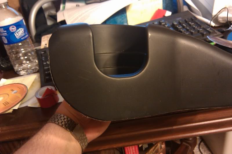

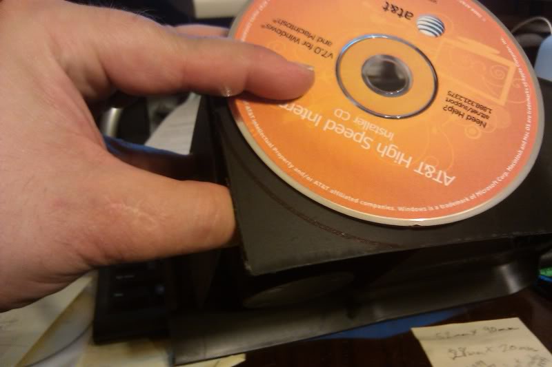

    so when you "removed the section in the middle" do you know exactly how much you ccut off? and can you post a pic of how it came out?
    .JoshuA. wrote:
    so when you "removed the section in the middle" do you know exactly how much you cut off? and can you post a pic of how it came out?
    I didn't really talk about that did I? I measured the width of the plate at the bottom of the shifter then found the center (width-wise) of the CD-holder part of the cupholder. I found that the width I needed to remove was about seven CD slots wide so I cut out that width with a razor knife / utility knife. I made it intentionally a little narrower at first and then test-fitted it to see if it fit or if I needed to remove more plastic.
    If you look at this pic you can see that I ended up removing the front row of tabs in the center of the tray that would hold the CDs vertical. I did that after test fitting and discovering that I needed more room for the shifter plate-thingie front-to-back. Sorry I didn't take more pics of that part; it was getting dark out and my phone take really crappy low-light pics.
    OR... Were you talking about the speaker pod mounting bracket-thing? I can elaborate on that if you want.
  • .JoshuA..JoshuA. Wagonist
    yeah i was talking about the speaker pod bracket thingy hhaha i should have been more specific sorry but if you could elaborate on that and post some finishing pics would be nice
    This is what I started out with. (That black bag is covering a an old CRT monitor that was going to a friend in need. Laptops are nifty but when the LCD screen breaks it helps to have some old tech to hand.) At the top is the sheet metal stiffener/mount for the Isuzu pods. It is bolted to the body above the headliner in the Rodeo. At the bottom are the painted pods. The gold-ish sheet metal doo-hickey is what bolts to the stiffener below the headliner with the headliner sandwiched in between. The pods themselves bolt onto the doo-hickeys. This was what I was trying to replicate transplanting these parts into the wagon in the same configuration.
    This is as far as I got with the stiffener. I started out by cutting it in two just to the side of the foam cushion that's at the center. Again I was cutting long at first with an eye toward measuring it against the place I wanted to install it. Shortly after this I abandoned it for the method previously outlined (without pictures). bam-bam is still planning to use all of the pieces in his next build ...and judging by how that wagon will be used it will prove useful to have EVERYTHING inside the car bolted up as securely as possible, lol!

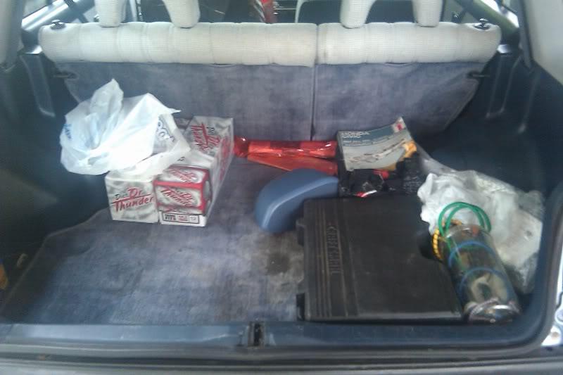

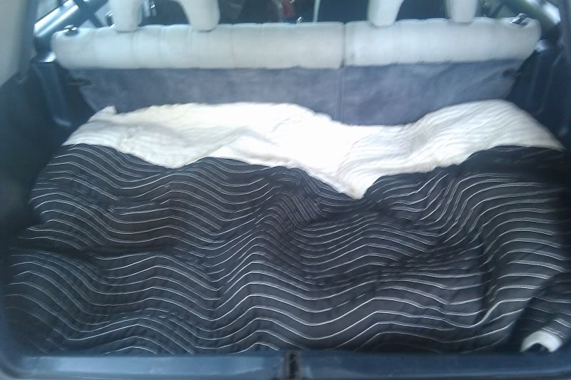

    This weekend working with materials on hand I fashioned a custom cargo cover. It's inspired by bam-bam's.

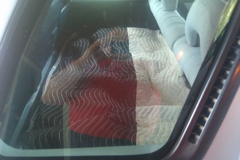

    Here's the view before. Not much worth stealing but who knows the mind of thieves in parking lots?
    ...and... done! Okay, so yeah, it is an old moving pad / blanket I found in the shed. But it does cover the cargo area!
    from every thing I have learned, covering things with a blanket screams really loud "break in and steal the valuables under the blanket!"
    I just roll with everyhting showing back there!
    Surprisingly (for me) I did think of that. Still thinking about it. It's a good point. Tint is on my wish list.
