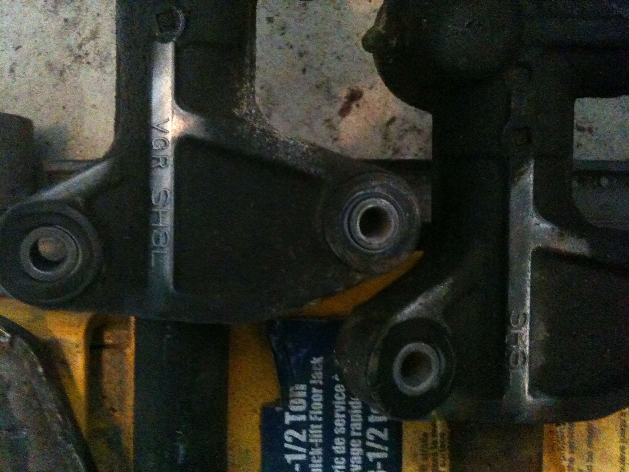

  • Did a little work on the car yesterday:
    - Swapped in CRX Si steering rack
    - Installed Energy Suspension Radius Rod Bushings
    - Installed Energy Suspension Shifter Stabilizer Bushing
    The rack was a bit of a pain due to the engine, exhaust, shift linkage, etc being in the way, but after pulling down the shifter & exhaust @ the collector, i was able to wiggle it around such that it slipped out.
    It was about time i changed this rack. The boots were hooped, especially the driver's side. The other advantage is that the CRX Si Rack that went in is progressive, and should be a touch quicker, lock to lock.
    Externally, the racks are the same.
    Different part numbers (VGR is from CRX Si)
    Almost back together ... just have to fix the carpet in place
