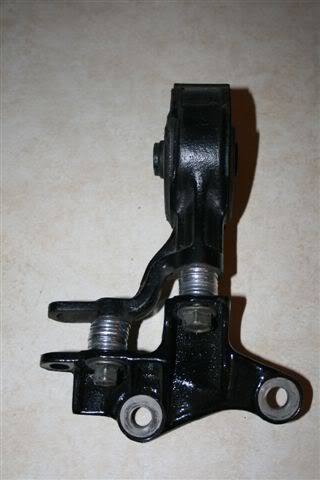

    I've lowered my engine in the bay with washers under the bolts. Temp measure, I want to extend the bolts a bit for more thread.
    Pass tranny mount is very short on spare thread.

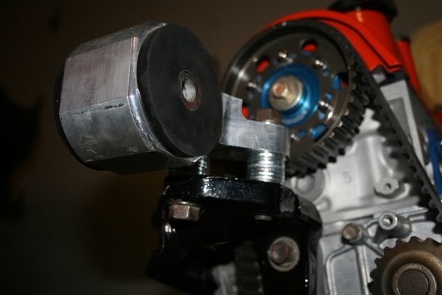

  • Do you mean like these:
    I simply unscrewed the studs from the mounts, and used longer bolts instead.
    Exactly man. But god damn. How you got those ones out...
    I've been seriously trying but mine just wont shift for nothing. :(
    I got two washers in for max. I need more tho.
  • I had no trouble getting them out. I used Vice Grips, and simply unscrewed the studs. You could clamp the stud in your vice and unscrew the mount from the stud, or you could use some heat to persuade the stud to turn.

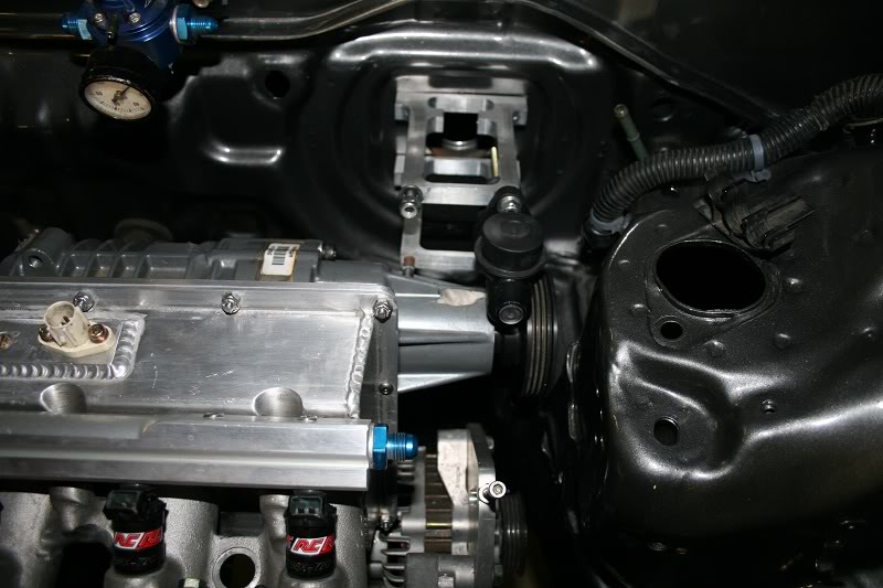

    I was lowering the engine for 2 reasons:
    1 - to gain clearance between the blower drive snout on my supercharger and the bottom of the master cylinder, and...
    2 - to align the u-joint angles on my 1 piece driveshaft.
    I may be in a position to remove some of these washers soon. I will no longer need as much blower/MC clearance, as I'm going with a balance bar dual MC setup, so I won't need the rear of the motor to be quite so low anymore, and subsequently the front of the motor will be able to come up as well, and still maintain the correct u-joint angles.
