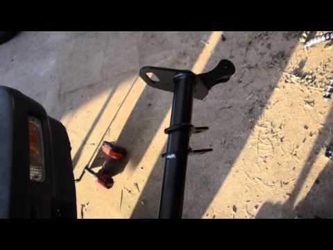

  • It's been a bit since my last update. Not much going on, had to do a new head due to a timing belt mishap.
    Ordered a traction bar from JHPUSA.com they were having a sale on the innovative bar, which Lowflyin' says is a good one.
    Did a little video of the install, or at least video of the steps. Once I have my garage more set up I'll be able to properly record actual guide videos.
    Let me know what you think, I know this video isn't that fantastic but any guides on what I should be doing in the future would be greatly appreciated. I'd like to film and photograph as many of my updates, modifications as possible just to help distribute that knowledge to the community.
  • bkmc24bkmc24 Senior Wagonist
    Man, I am a little butthurt that JHP sent you extras. I have spent thousands with them, sometimes in an entire order of a grand or more and all I ever got was a fuggin sticker......butt is hurt!

    One thing to note is after removing the front mount when installing the traction bar, it got rid of nearly all the vibration I was getting transmitted throughout the car. I had that mount adjusted as far as it would go but I guess it still wasn't enough. If things get too wobbly I'll just cut out some new brackets to weld to the traction bar and reinstall that mount. Probably don't need it now, but what about when I have he built up D16Z6 and a turbo?
