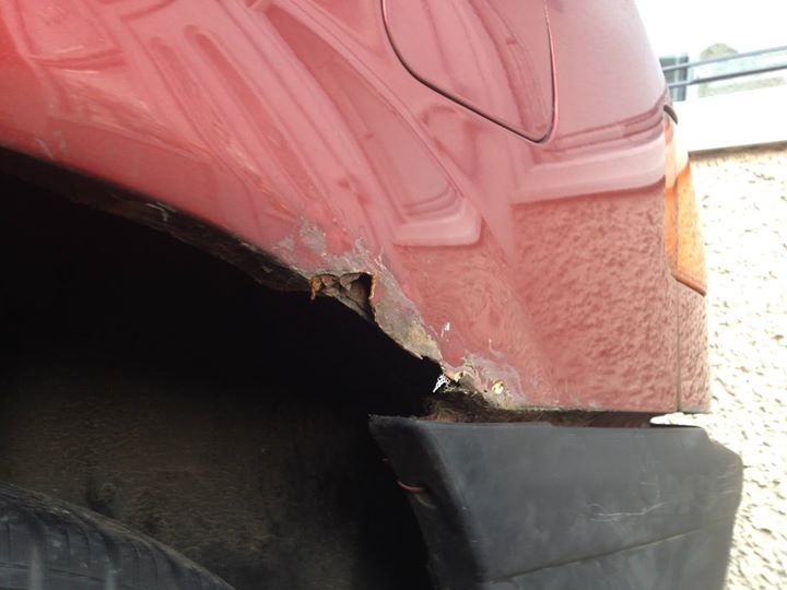

    So popped down tonight to check on progress. Passengers side its 90% finished.
    BUT. also found a major issue...Only managed to get this shot, some AIDS on the underside :(
    Entire suspension mounting point for the RTA Bush is Rotten. So now the arm has got to be removed in order to gain access.
    So, looks like an extra couple weeks and more £££ :cry:

    So, this is a picture of the aids i mentioned above, on the passengers side.
    Drivers side has been started.

    More rust. Found under a good 2-3mm of body filler
