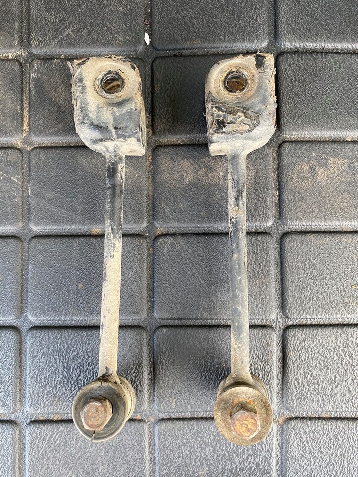

Si/Integra and 87-88 accord end links for ID.
Accord link with mounting shaft attached through the eyelet.
Cut the shaft from the sway bar eylet mounting bracket at the weld between the two parts.
Grind/remove the excess weld around shaft and bracket. Grind away the weld on the surface of the bracket until you see the circular outline of the shaft. This small section of shaft should either drop out or you may have to use a punch to gently knock it free. The arrow points to the hole left by this section.
Check for fitament of the shaft into the bracket hole.
Remove the powder coat from the link bracket and shaft. Adjust (test fit)
the length of the shaft and trim excess.
Two links ready for welding. Prior to welding position the bar bracket and LCA mount stem eylets so that they are oriented at 90' to each other.
The two modified accord end links welded and ready for installation.
They could now be called honda wagon end links.
