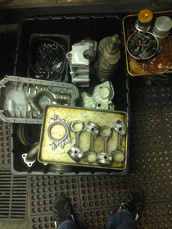

Got to start to get things cleaned up and ready to assemble. My parts pile grew fast.

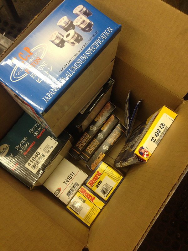

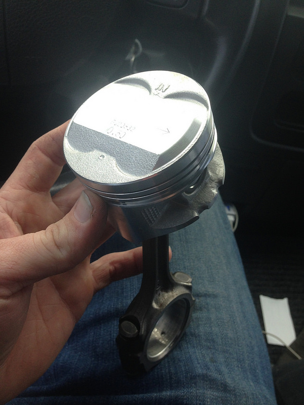

I ordered some fresh YCP 75.5mm P29 Domed ZC Pistons, 0.50 over, I'll be using all D16y8 stuff.

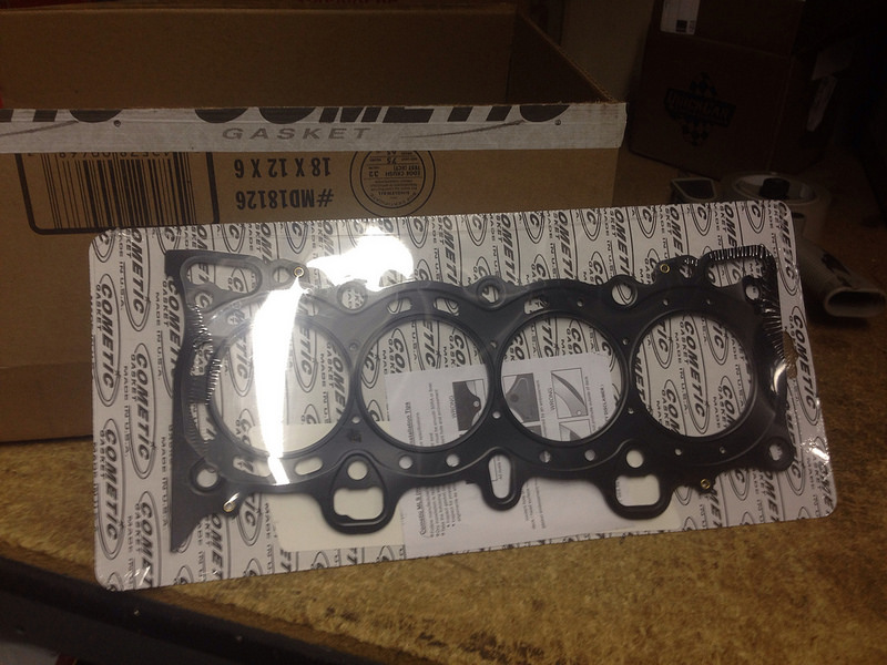

Cometic head gasket, Custom MLS

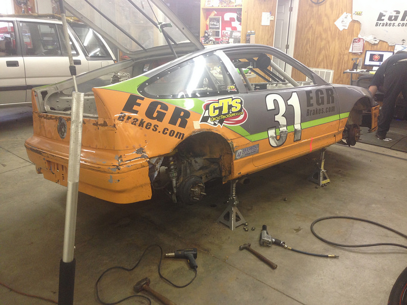

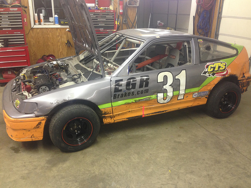

Today I got started on revamping this old race car.
Flushed trans
Fresh motor oil
Drained Fuel Cell
Rolled/ Pulled all fenders

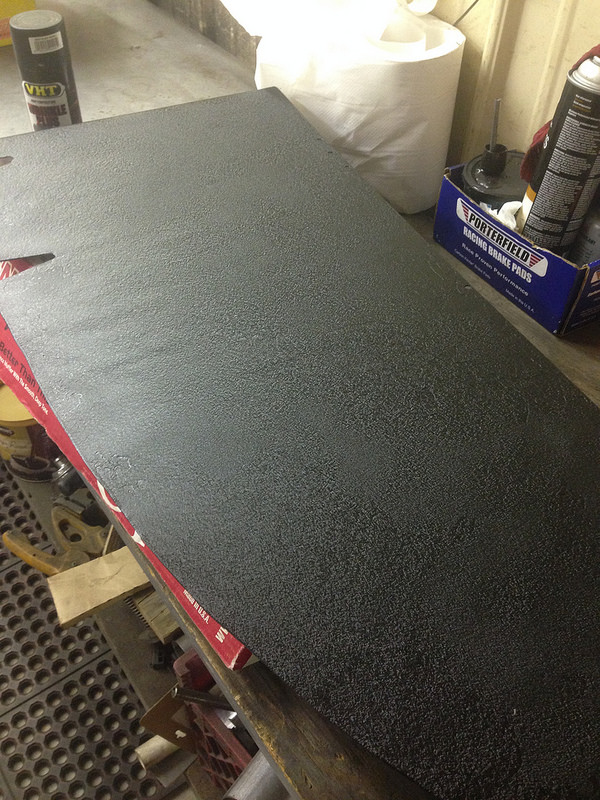

Refinished the dash with a wrinkle coat to stop the sunlight from bouncing off it and into your eyes.

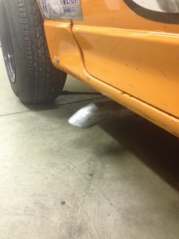

I built a full exhaust after acquiring a factory tubular manifold from a D17. My buddy was gracious enough to port the header while I fab'd up and hung the Exhaust system.
This factory manifold should mask it's actual performance.

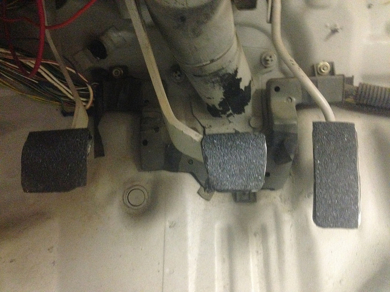

I also bent the gas pedal a bit so that it was closer to the brake pedal for more easy & fancy footwork.
Added one of my favorite signature features... Grip tape pedals!

Nice! can't wait to get her out in a wide open space to see what she feels like now. I should mention that I also stripped the car of 155lbs of lead that I was running to comply with the old sanctioning body that I competed with. Bet that EG is fun to pilot..

He bead blasted the Con Rods
and pressed the new P29's on with new Pins
He also heat treated the Con Rod's actual connector.
I simply asked to have them pressed on, the rest he did as courtesy. :encouragement: Right on!

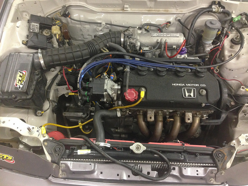

Question: why the A6 intake manifold?
Stock, 200,000+ mile worn out y8 cam... lol for now. I just can't fathom blowing the money on full titanium valve-train to gain 10-15 HP... All because I wan't a 'lopey' single cam idle really.. haha
The high compression should make it idle in an awkward enough fashion for me. But, We shall see.
Ha, Thanks Brudda Mane! Feel free to. :encouragement: More powerful shit to come!
In the case of choosing the A6 manifolds, (for both these cars actually). I do that for ease of tuning, I always match the intake manifold to it's stock ECU and factory wiring harness. When doing swaps. Unless of course it's a chipped PR4 or P28 or something along those lines... Then by all means run anything.. (Like the blue CRX) If that makes sense.

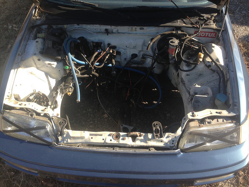

So right after the motor blew all those years back I added this. 1,000HP capable positive crank case vent that sniffs from the header's collector for it's vacuum source.

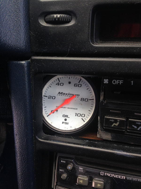

As well as this oil catch can. Here is a shot of the bay cleaned up too. Also the Y8 is notorious for oil supply issues, so I run this oil pressure gauge in place of the old shattered heater knob in the climate control area. Just to keep an eye on things.

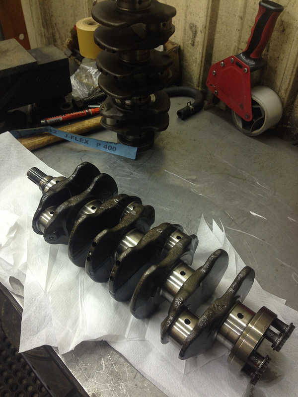

I hand polished my crank journals with some crocus cloth last night. The final set of ACL bearings came in. Now just waiting on custom Cometic head gasket.

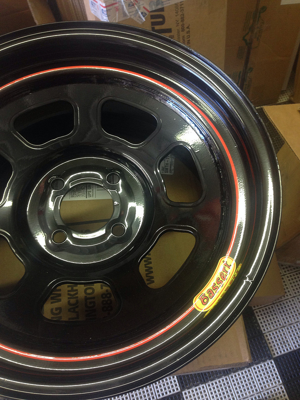

New wheels and tires ordered as well. :encouragement:
Y8 Crank laying flat
Cleaned, Bagged, and lubed.

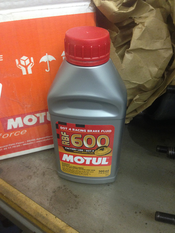

You are correct my friend. This MOTUL 600 is amazing stuff. Love the pedal feel after a fresh bleed.

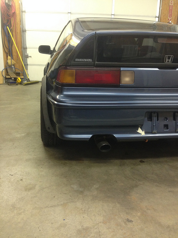

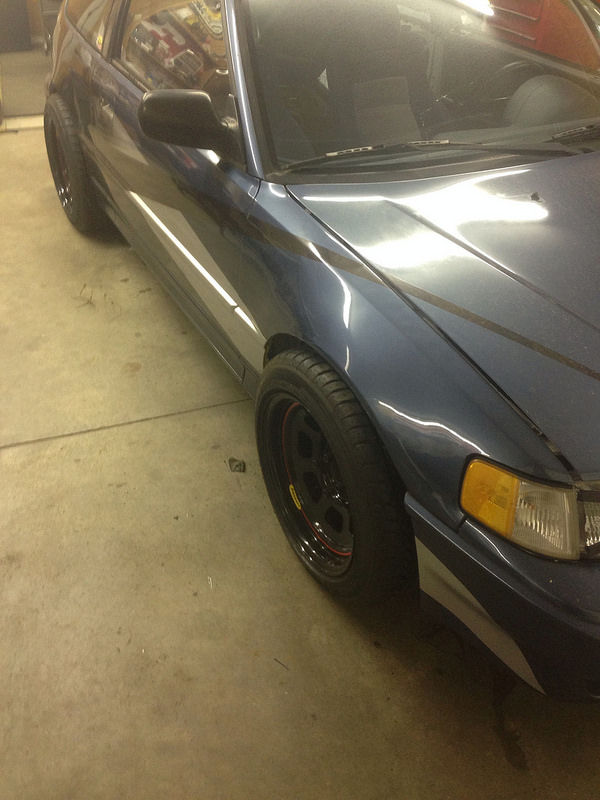

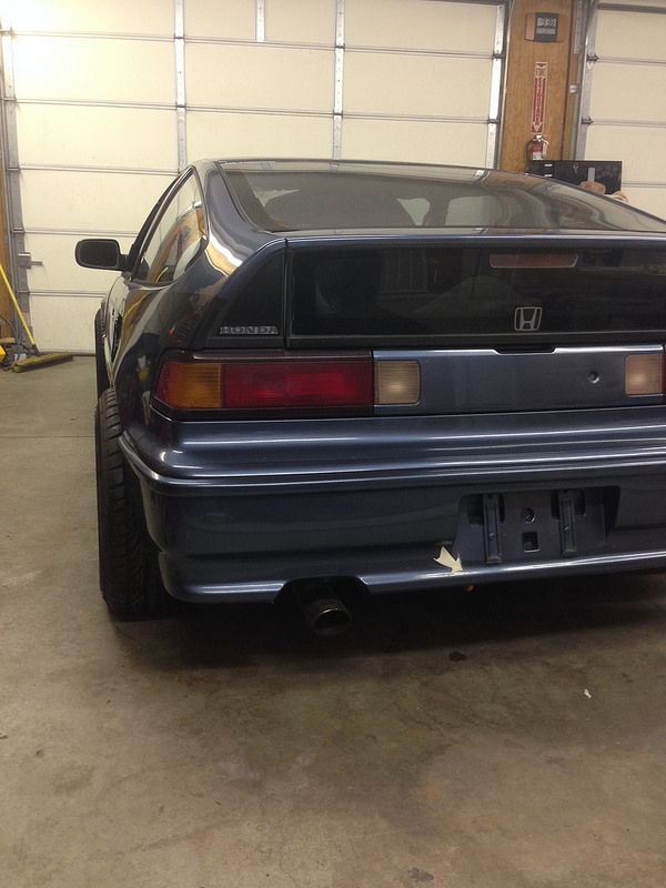

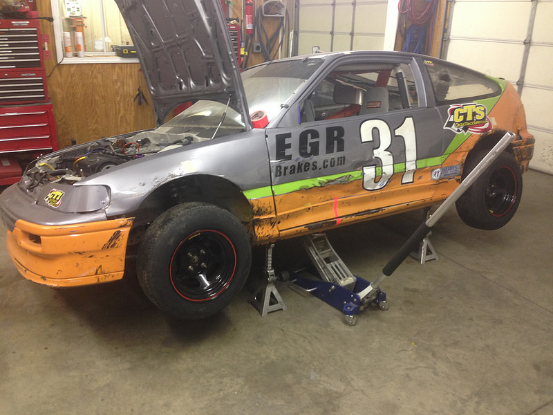

Tires are here and mounted. 205/50/15 Alpha. Fooled around with fitment a bit.

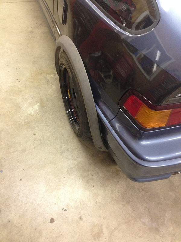

Flared & rolled the front fenders. Still need to sort the rear.
I also raised the ride height a bit.
Too much meat?
Ta-da! (Some VW flares just sitting on the tire.) I definitely like the look..

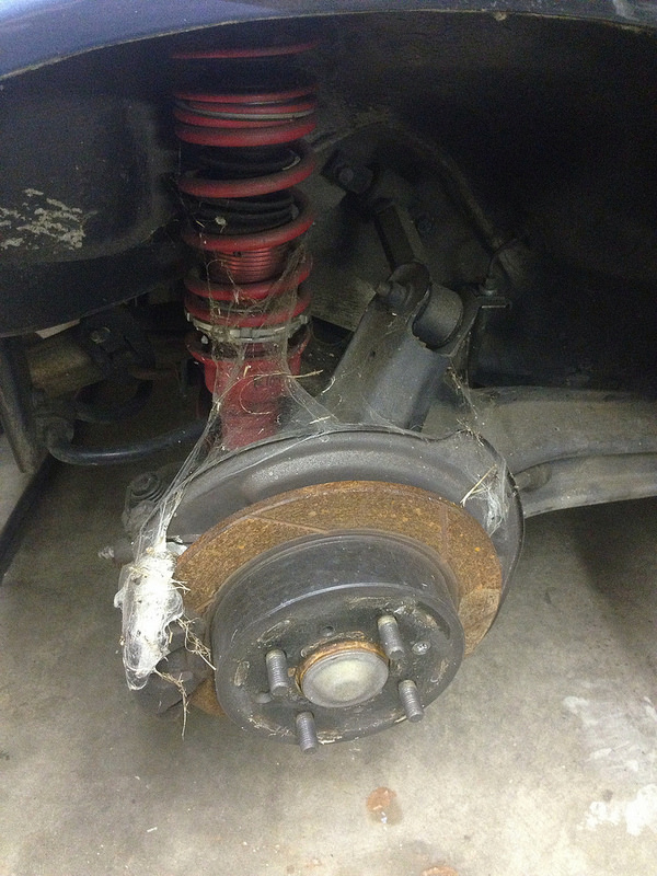

Haunted wheel well... haha Here is a shot of my shock and spring setup. Pretty unique...
Old school 2-stage style packer springs w/ a slide separator on 4-way KYB AGXs.

as for that spider web was this spider hangin around
