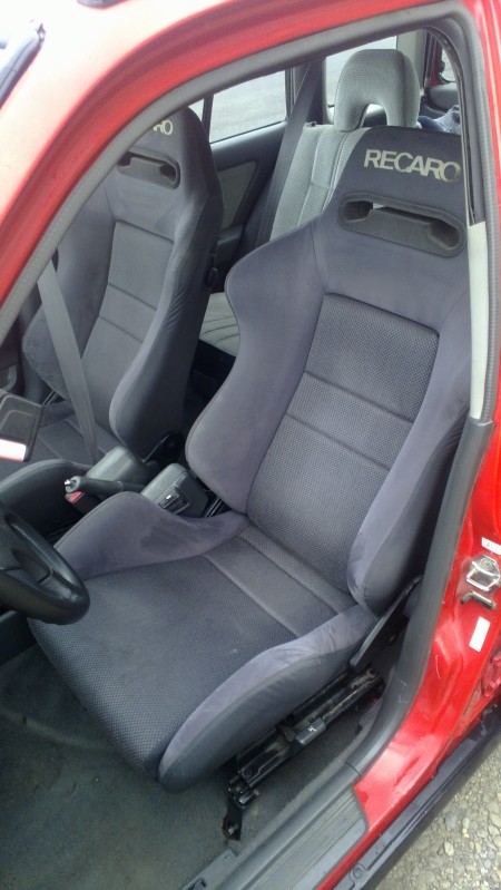

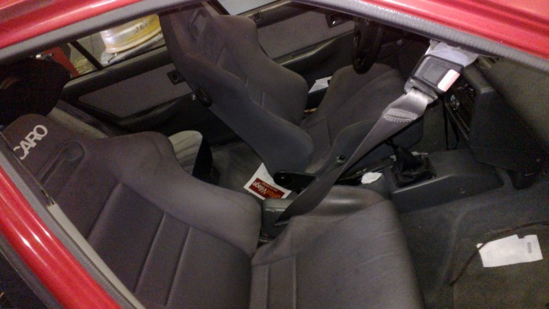

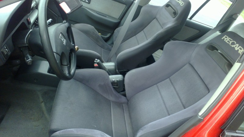

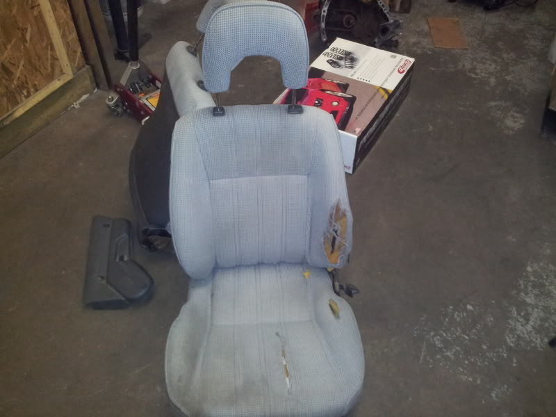

    Here's a little bit more info on the CRX Si seat swap for those interested.
    I re-used the Wagon rails on both inner and outer parts. The inner had to have the rear mounting hole to the seat elongated a bit and that was pretty much it. The outer rails required a lot more work. I ended up drilling all the spot welds out and removing the front and rear mounts right off the rails. I bolted them to the seats and installed the seat to the car with only the inner rail attached to it. I then positioned the outer rail and tack welded it in place before proceeding to move the seat back and forth on the rails to make sure it was lined up properly. I took the seat out again and finished welding the outer rail and painted it. I also re-used the CRX plastic cover on the lever. It looks awesome and it's a lot more comfortable than the original wagon seat. I'm also really happy with the lower driving position :)
    Here are some more pics:
  • gavingavin Band Wagon
    Agreed, crx really work in a wagon, nice idea.
  • BCwagonBCwagon New Wagonist
    those seats look great man! how long did the swap take with the work you did to install the pair?
  • lecoqlecoq Wagonist
    Took about 3 hours total for both sides. They sit a little closer to the center of the car but I don't mind.

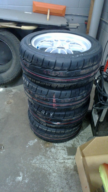

    Here's a little something I picked up today...
    Yes they are REAL Advan SA3R in 16 inch with Almost new Falken 452 tires. Hoping to have them on the car as soon as the suspension setup is ready.

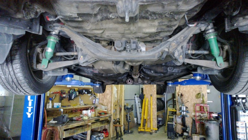

    Update! Finally got my Tein Super Street coilovers installed. Also installed my Advan wheels today. I'm gonna drop the rear more once I get the fenders rolled later this week. Wheels are for sale if anyone is interested. I'm looking to get a set of 15 inch wheels since 16 is a bit too big for my taste.

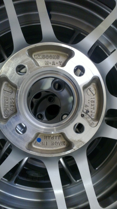

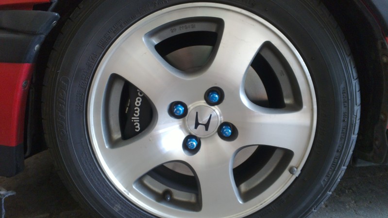

    Took the Advans off and I'm selling them. Got myself a set of JDM Fat Fives and some new Falken Ziex 912 to roll around on. Also lowered the suspension another half an inch in the front and a full inch in the back. Went to the local junkyard today and got a spare valve cover, an EF hatch spoiler (to experiment with) and a EF Si front bumper with lip. Here's what the car looks like now:
    The top of the bumper is shiny and I don't like it. I'll go back to stock wagon bumper with a J's Racing replica front lip as soon as I can find one.

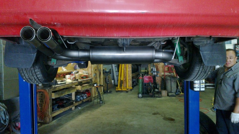

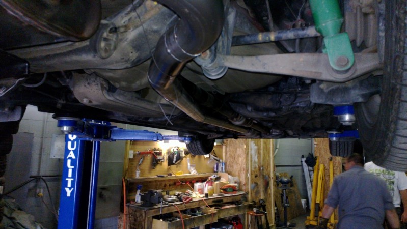

    No updates for a bit...

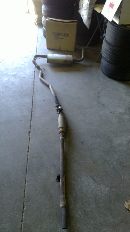

    Exhaust broke right in the middle of the B pipe. I parked it in the garage and won't be looking at it for a few more weeks. Heading to Florida for holidays soon and I will start working on the bodywork and paint when I get back.
