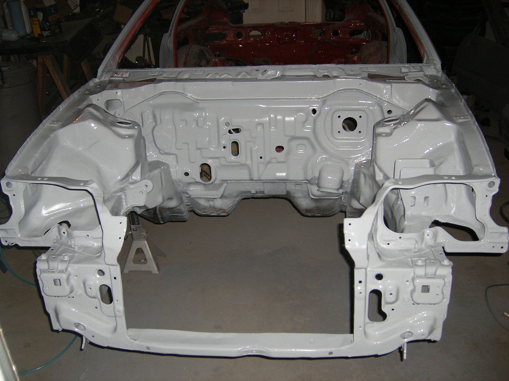

and for the update ive gotten almost all the smoothing done under the hood and it should be painted this weekend .

ive gotten 90% of the shave done and i started to paint but then i ran out of primer so ill have to wait till i get to the store for more
but heres a few pics of what ive painted
primerd
for the actual paint i went with the same cream color the some wagons come with the pics are kinda f 'd up the color doesnt look anything like it does in person after its all painted ill post more pics and try to light the room dif or someting so u can actually tell
primerd

im not 100% happy with it yet gotta go back and touch up a few spots with some sanding but it looks ok so far
