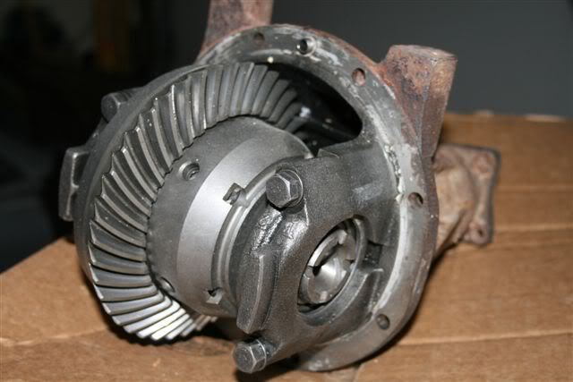

    You can't easily use the rear end from the S2K or Nissans because the FD ratio (ring and pinion in the rear diff) will be out of whack for the CRV or Wagovan transmisssion. The internal gearing for the transfer case of both Honda 4wd trannies is set around the 2.529/2.533 ratios of the Wagon/CRV rear diffs. You'd end up running in 3rd gear to approximate the speed you'd get in 2nd with all the Honda stuff.
    The Wagovan RT4WD rear diff will easily accept the OBX and most other LSDs with a few modifications. The only issue will be the inner joints of the axles. The FWD D series LSDs have a slightly longer spline on the driver's side than the passenger side, and the Wagovan rear axles are the same length. So effectively, the Wagovan axle on the driver's side will not be long enough to seat the clip on the end of the inner joint. I had a custom set of axles made by DSS for a couple reason:

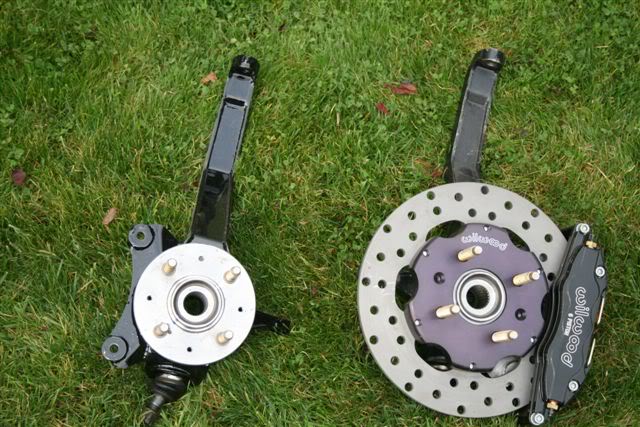

    I am using CRV rear bearing/hubs on the Wagovan trailing arms (bolt on) to accomodate the larger spline on the outer joints (Civic/Integra outer joints). There was some minor mods necessary to bolt the part of the Wagovan casting that goes to the inside of the trailing arm.

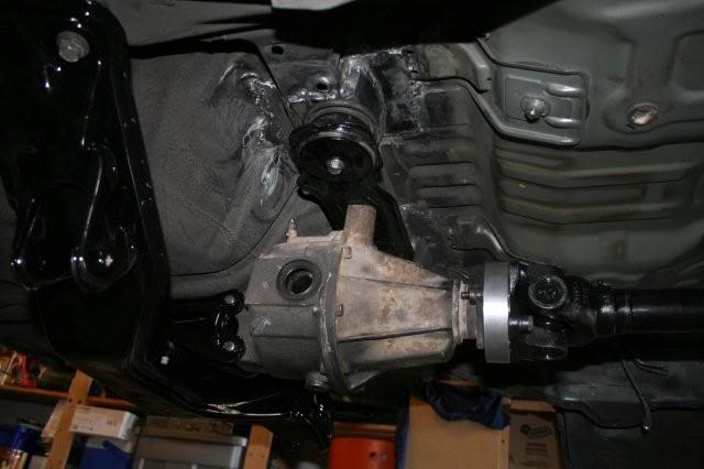

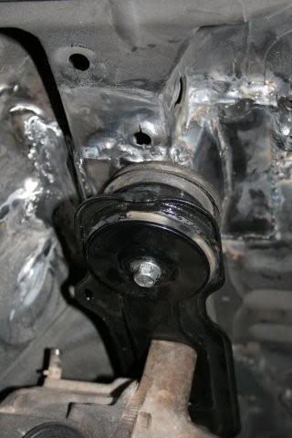

    I am using a 1 piece CF driveshaft (86 1/4 inches long), as my chassis is a 2WD, and I did not want to deal with mounting a center bearing (only way to do a driveshaft this long in anything but CF).
    My biggest concern is also the transfer case. I am not worried about the rear diff. The way I see it, the FWD drag guys are putting 600+ horsepower through gears that are very similar in size to the gears in my rear diff (Wagovan stuff), and my diff is held in with iron caps into an iron housing. Theirs is mounted in an aluminum housing (transmission case).

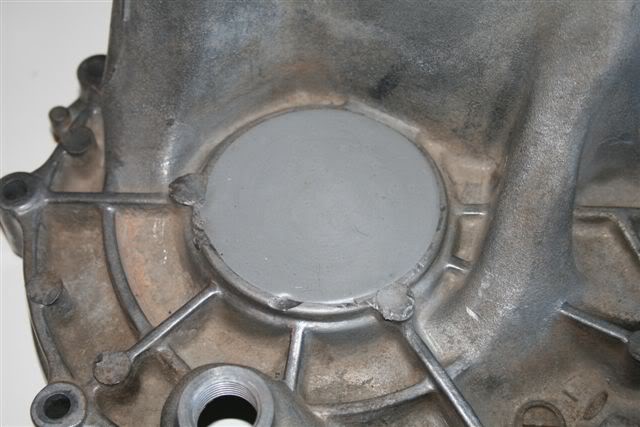

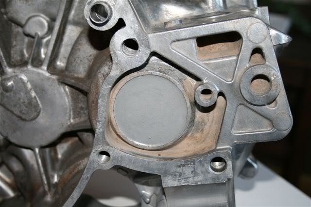

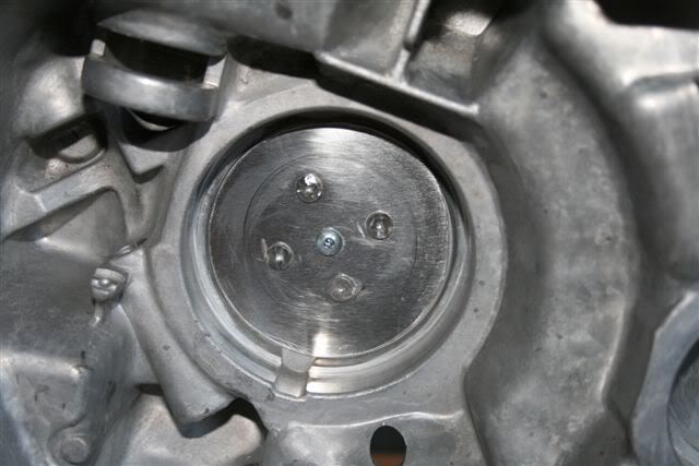

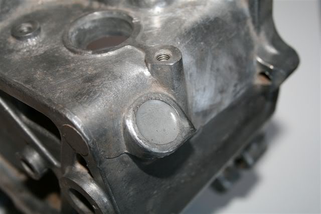

    When you're doing RWD there's a couple things that can go bye-bye in the Wagovan transmission. I had absolutely no need for the SL gear, so out it came. I had no intentions of ever disabling the 4WD (that would mean I have no wheel drive) so out came all the guts for selecting 2WD/4WD. I also did not need any spider gears in the front diff, so out they came as well. This lead to 14 lbs of gears/shafts/bearings, etc... gone from the transmission. 106 lbs now.
    As you already mentioned, I sealed up the holes in my transmission where the driveshafts come out, as well as the hole where the 2WD/4WD selection shaft goes in. I used an aluminum plate on the inside of the case with a couple screws going in from the inside for the axle holes so I effectively had a little bowl with some screws in the middle of it, and then I poured Devcon Liquid Aluminum (2 part epoxy like aluminum compound that has very similar properties to aluminum when hard) into the bowl and let it harden. This seals up the holes very cleanly and semi permanently should I ever decide I really do want to go with 4WD.
    The shaft that carries the gears for the output to the transfer case, as well as where the 2WD/4WD selection takes place was also modified. The selector sleeve is just like a regular gear selection sleeve for say 2nd or 3rd gear, except that there are no synchros. The sleeve engages little teeth on the gear, and the total output of the engine goes through these little tiny teeth. I was not comfortable with this. I had a professional aircraft welder weld the gear to the shaft so there would be no possibility of the little teeth failing under the load.

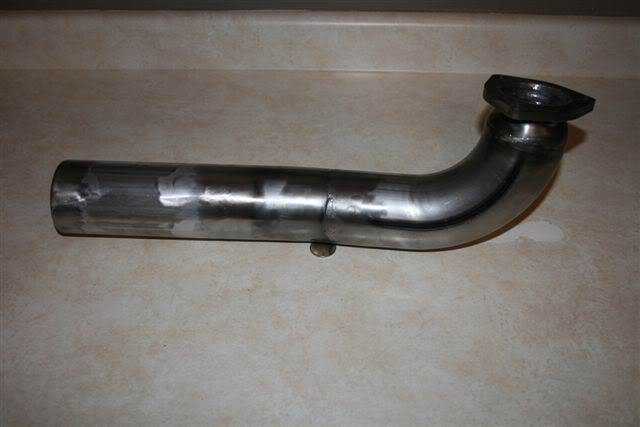

    The exhaust is next, but I'm still in the planning stages there. I have all my supplies: 3" tubing, both stainless and regular steel, straight pipe and mandrel bends, 3" cat, 3" Coast Fabrication lightweight round muffler for resonator duties, 3" in/out oval Magnaflow muffler for the back, 3" ball/socket setup for the flex joint at the OEM location, and some V-band clamps for everywhere else. I will also set it up with a section of straight pipe to replace the cat and resonator for sites that don't have noise limitations (our local site has a sound limit of 92db). This is where the V-bands will come in really handy. I can't start welding up the exhaust until I have the motor/transmission/driveshaft/rear diff in the car. I may even wait till I've mocked up the rear sway bar so I don't have to do anything over gain once I know for sure if I'll need a rear sway bar or not.
    I've had my shocks rebuilt by Ground Control (Advance Design aluminum bodied coilovers that are seperatly rebound and compression adjustable) and I had the rears re-valved for softer springs. I'm starting out with 550lb front springs and 350 lb rear springs. Rear wheel drive typically needs softer rear springs that front wheel drive. I have about 4 different rear spring rates to try and 5-6 different ones for the front. I'm also starting out with a Suspension Techniques 24mm front sway bar with the possibility of a couple other sizes depending on the handling, and I'm going with no rear sway bar till I've had the chance to drive the car in anger on an autocross course to see how it handles.

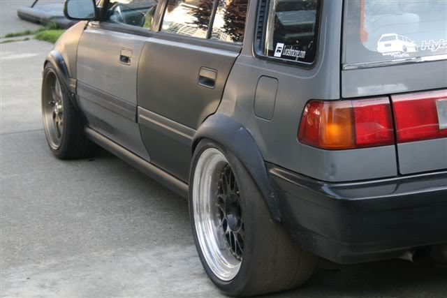

    Enjoy some pictures:
    Rear Tire

    helped me out so much!! also in the pics your running drum brakes for the
    rear correct?! will it be ok to slide on drums in the rear?!
    where did you buy that set up?1 and or get your studs extended that long

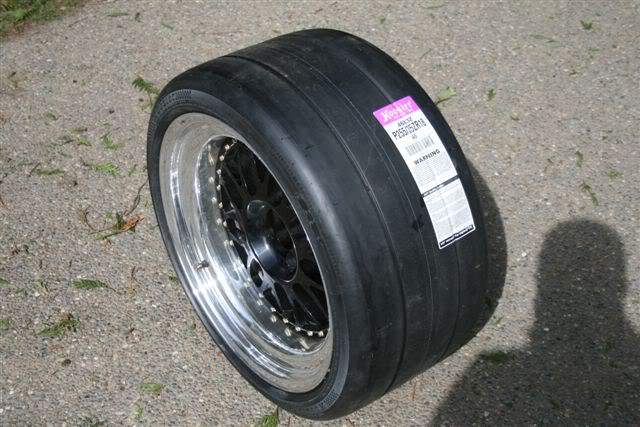

    i will be running a 16x10 +38 bbs rs 3 piece wheel with im guessing a 1 inch spacer to clear
    all components in the rear.

    The studs are ARP extended studs for Honda/Acura. You may be able to retain the drums brakes in the back with a little fabrication/manipulation of the CRV or Wagon drum backing plates. I considered doing this, but had worries about the offset of the backing plate versus the hub face and didn't want to deal with it. I am going with discs in the back. You can look here for more info and pictures of how I'm doing it:
    viewtopic.php?f=8&t=5748
    With that exact dimension of wheel (16x10, 38mm ET), you could probably get by with a 1/2" spacer. My wheels are 18x10.5 with a 6" backspace, and I'll be running them with no spacers.

    Still working on the header around the oil pan and transfer case thing. I'll be making a custom down pipe for my Kamikaze header. I'm sure it will be no problem. I have everything I need, except for time.

    Wow, I wasn't aware on how wide your tires are! That is all kinds of awesome! Are the flares metal or plastic?

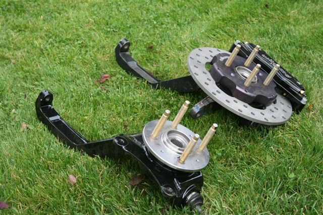

    Front knuckles and front forks were made by "Fabman" from H-T. No, they're not Ryane Motorsports drop knuckles. The flares are fiberglass, and they're made for a 240SX (S13). Didn't take much to make them fit the Wagon fenders quite well.

    Finally got my driveshaft. Made by ACPT in Huntington Beach, CA. 27 1/2 lbs, 86 1/4" long:
    Here are the adapters to bolt the North American Iron U-joints to the Honda flanges. Unfortunately they got them wrong, so they're re-doing them for me.
