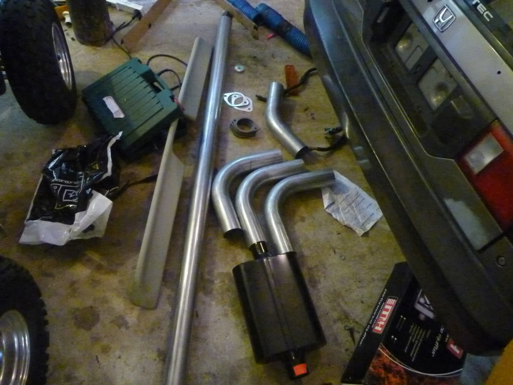

    Picked up the block and its all done. Got some gas for my welder so now I can make a start on the exhaust. Just ordered a new fuel pump and 3 bar map sensor so that should arrive in the next week or so

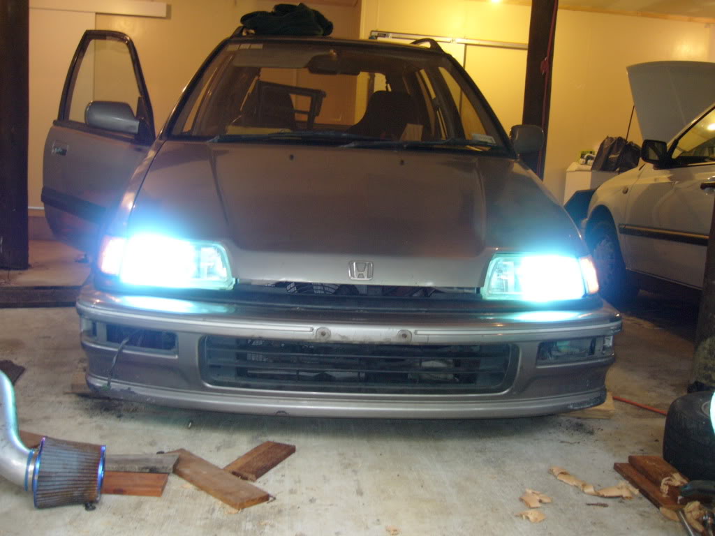

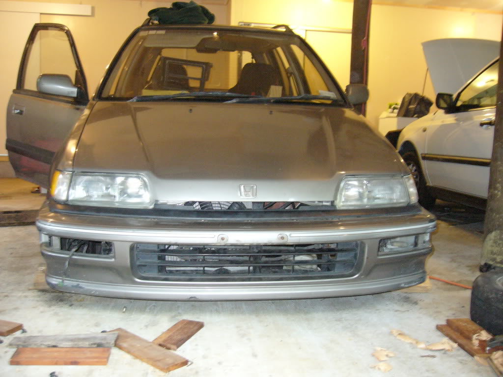

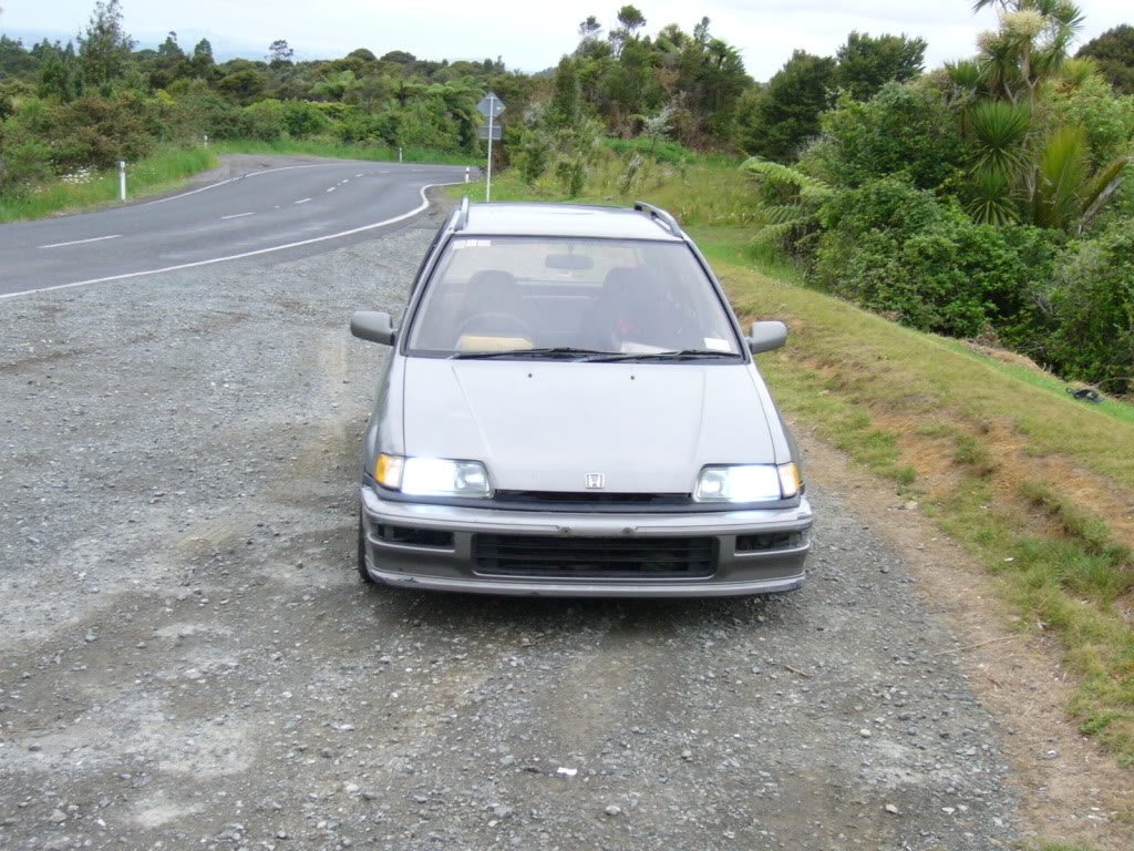

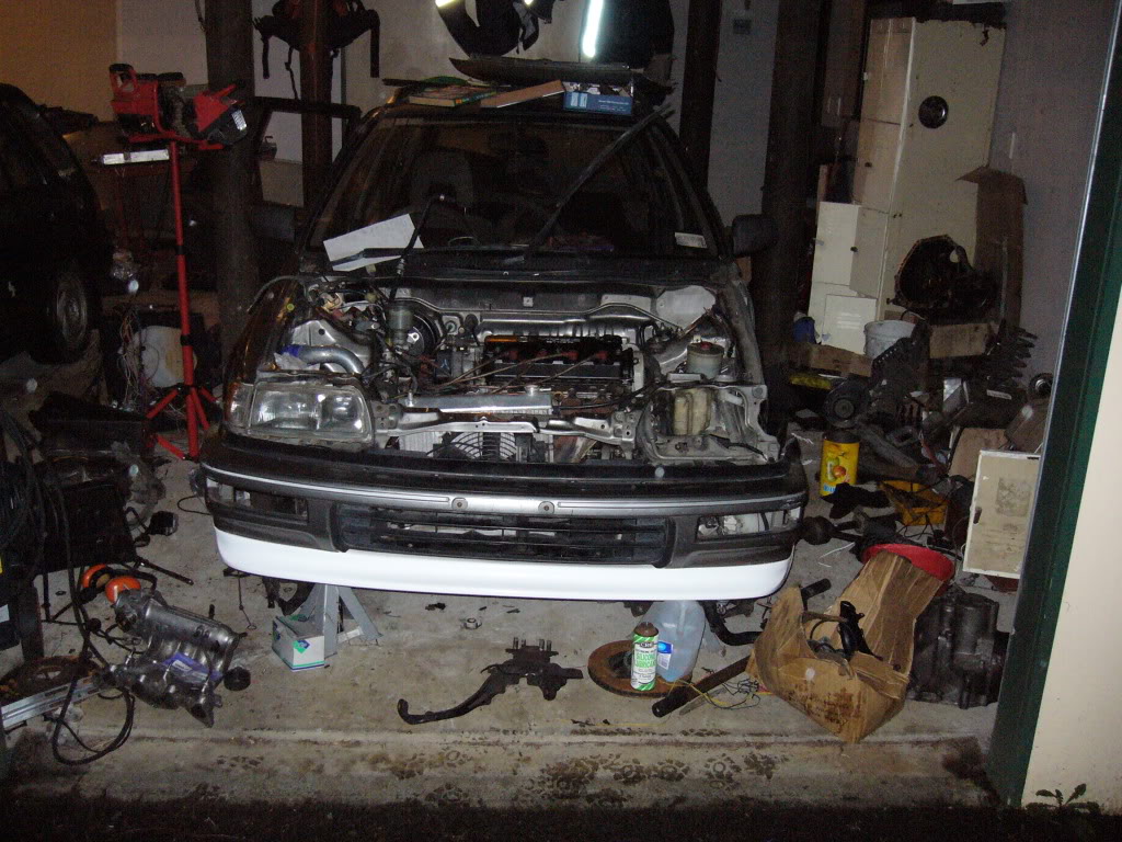

    Had a productive day today, got the 255lph fuel pump installed, put the wheels & konis from the crx onto the shuttle and temporary installed my hid kit. Just have to find some tidy indicators and figure out a way of filling the gap between the filler strip and bumper.
    Fuel pump nearly done
    All back in

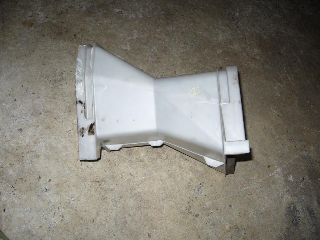

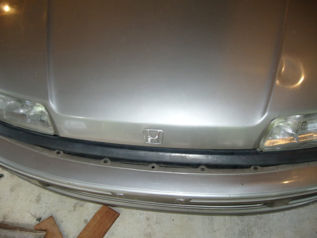

    The gap I have to fill somehow, anyone got some ideas?
    H.I.D lights
    Bumper/wheel shots
    what reinforcement bar did u use? if u use the stock one u need to cut off the ends n some of the metal that makes the bracket or the bumper light blubs... thats what i did to fit mines... and i only bearly have a gap it only shows the line part of the after the holes...
  • rti intracrti intrac Senior Wagonist
    I used the original shuttle support, the bumper is only held on by two screws at the moment, i'll have to sort it out properally
    yea mines is too... pretty much i turn mines into a jdm reinforcement bar... very small

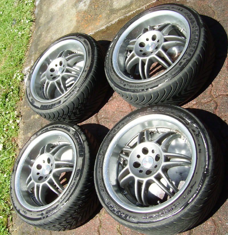

    Sorted out some indicator lenses and a set of 15" mr5. need a little tidy up but they are pretty good. Wihh be picking them up thursday

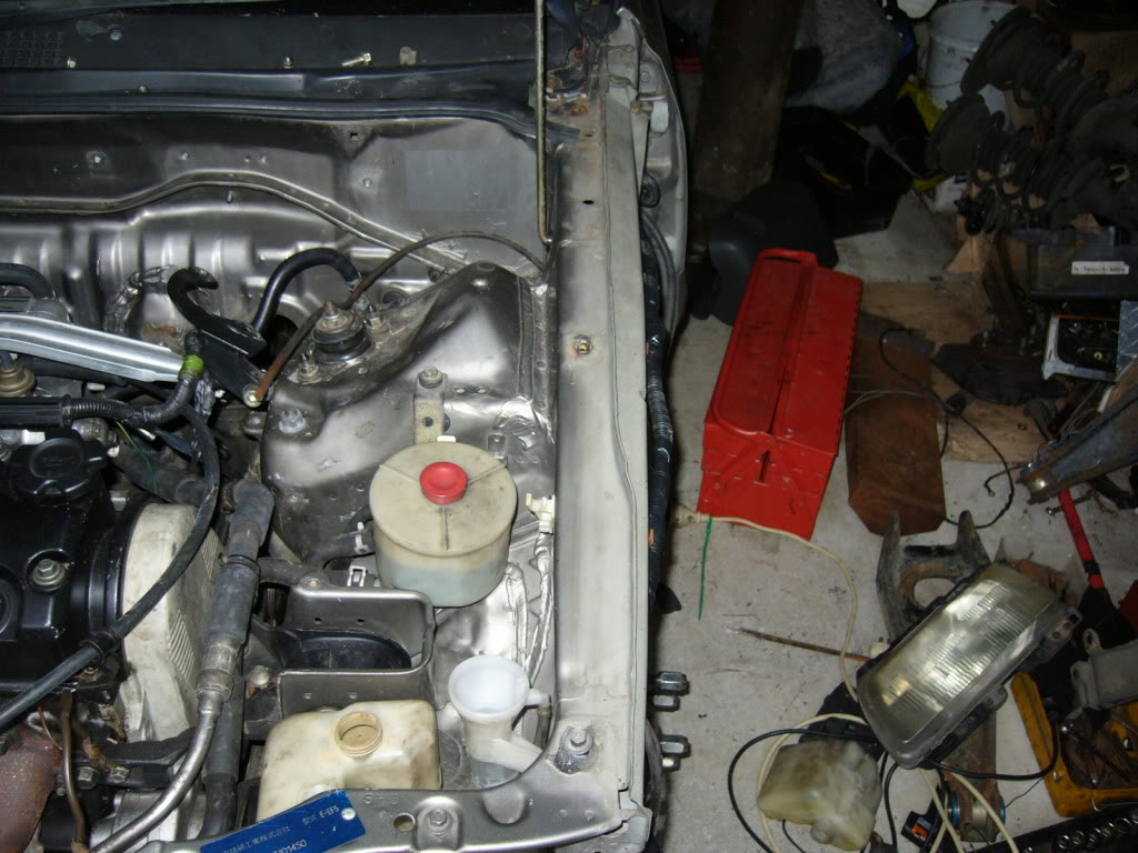

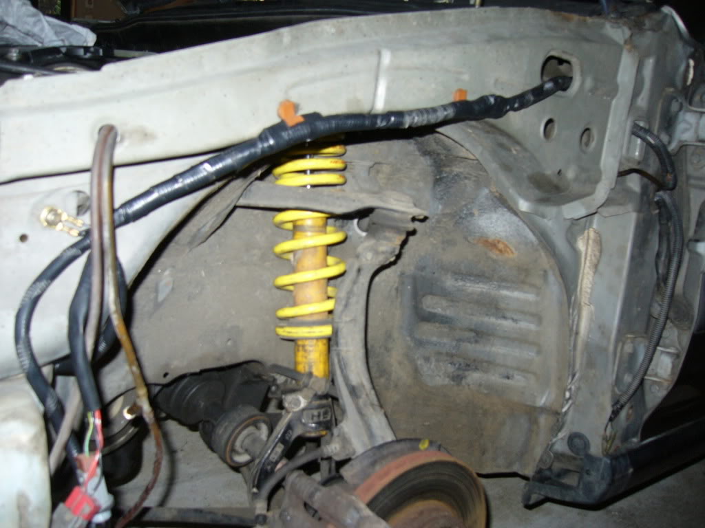

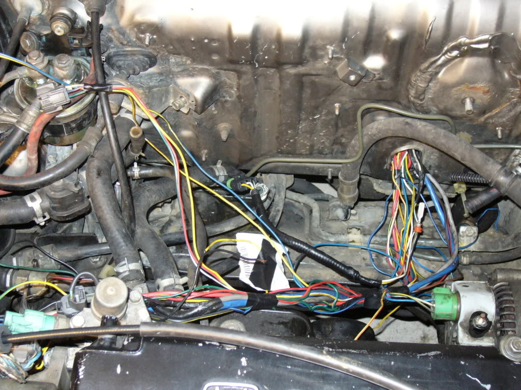

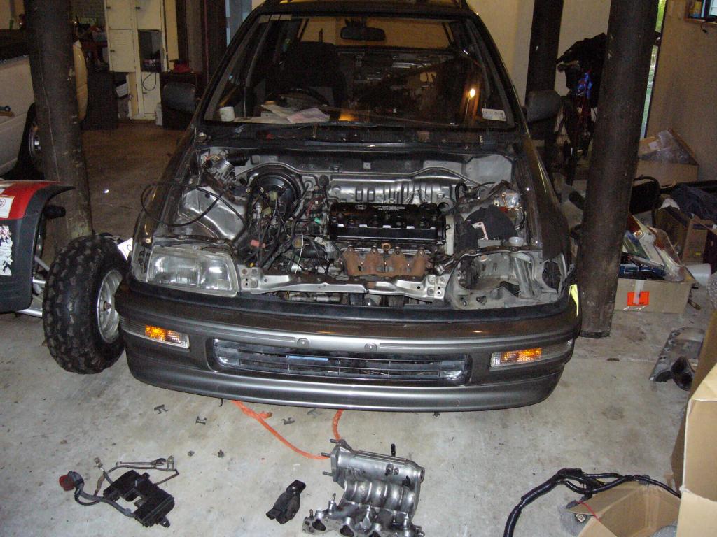

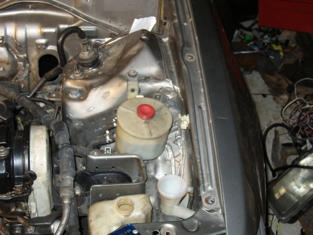

    Back from the dead. (no pictures yet) I've had a break from the car for a while and am now motivated to work on it again. I've done a wire tuck on the left hand side, made a new obd1 engine loom and am working on the right hand side loom.
    Making the engine harness, getting all the lengths right

    I'm not going to get rid of this any time soon. I'm going to do a manual swap on my other blue intrac in the next few weeks as the holden is way too thirsty for a daily.
    I've been delaying the right hand side with all the alb wiring. I cant open the drivers door atm because its on stands and there is a post in the way

    The easiest way would be to re use your zc or factory obd0 intake and loom on your obd1 engine, make up a dizzy adaptor harness that plugs into the factory plugs. (i'm not a fan of de and repinning plugs, If the wiring diagrams are different or you get a wire messed up its a mission to fix.) And a adaptor harness from the ecu. I have a spare ecu harness if you want to buy/copy it.
    I wouldnt recommend making a complete new harness or grafting a Eg harness into the car unless your patient and confident with wiring.

    I just repinned my ECU plugs to convert mine to OBD1. Along with associated engine bay wiring. Only took a morning in the foot well to complete, pretty easy to do as well
    If you use the harness that I made there is no need to mess around with interior looms. Its just plug and play if you re use the old intake (providing you are staying d series)
