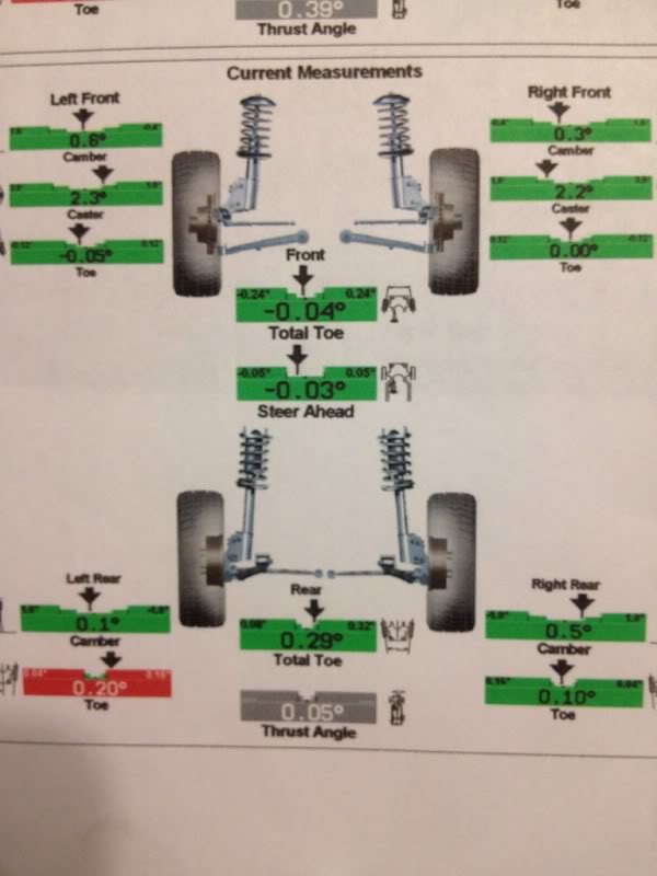

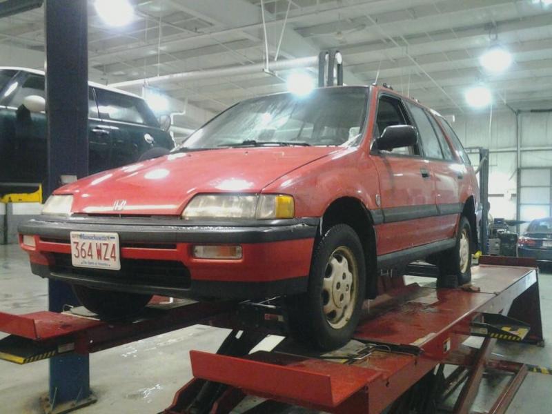

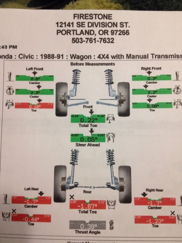

Updated with before and after photos. Some pix of Jane before the lift on regular RT wheels
And lifted with regular RT wheels.

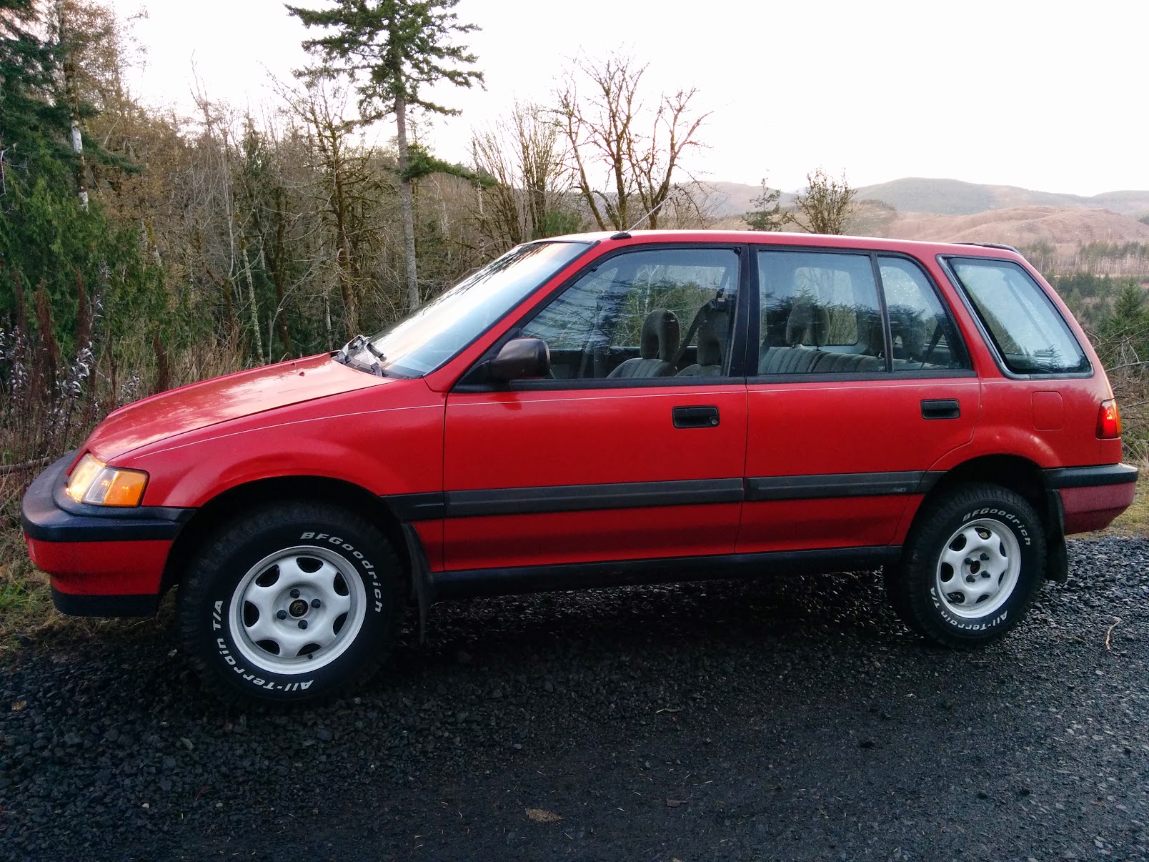

And photos with 15" wheels and 205/65 tires on her. I'd wager to say this is as big of wheel/tire combo you can do without rubbing.
