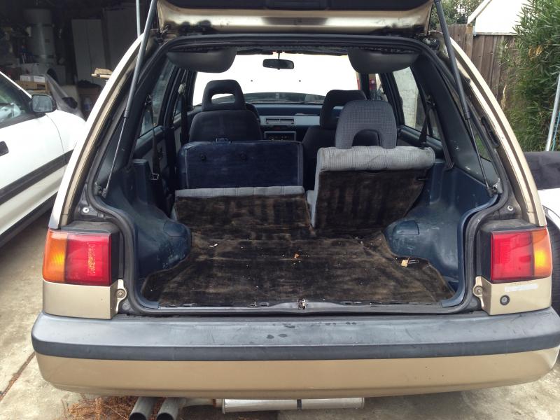

heres how it looked the next daylight after getting the car.

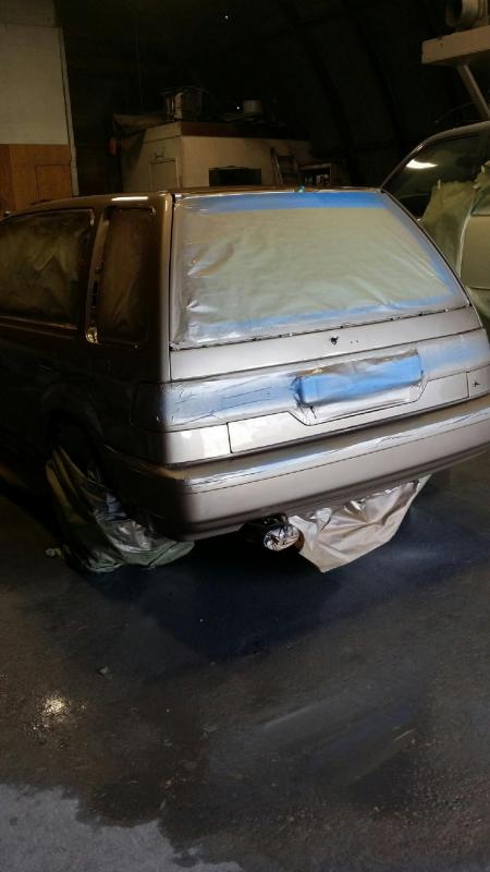

removed what i could. had the car sanded down with 400 grits. took it to a friends shop and he sprayed it for me. i bought 2 quarts of omi paint with activator, gallon of transtar clear and hardener and transtar sealer. YR87M Laguna Gold Metallic. 5 base, 4 clear
