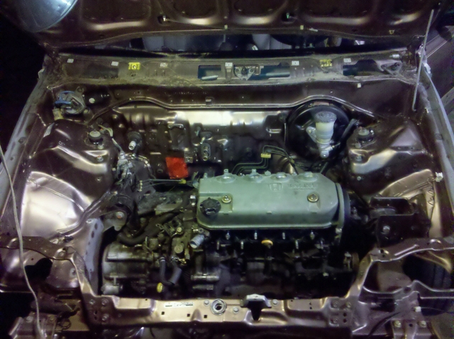

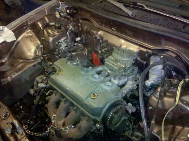

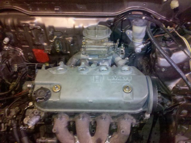

the intake manifold. the back plate will be folded to mirror the front plate that has the runners going thru it. the ends and top will be boxed, with the carb on top.

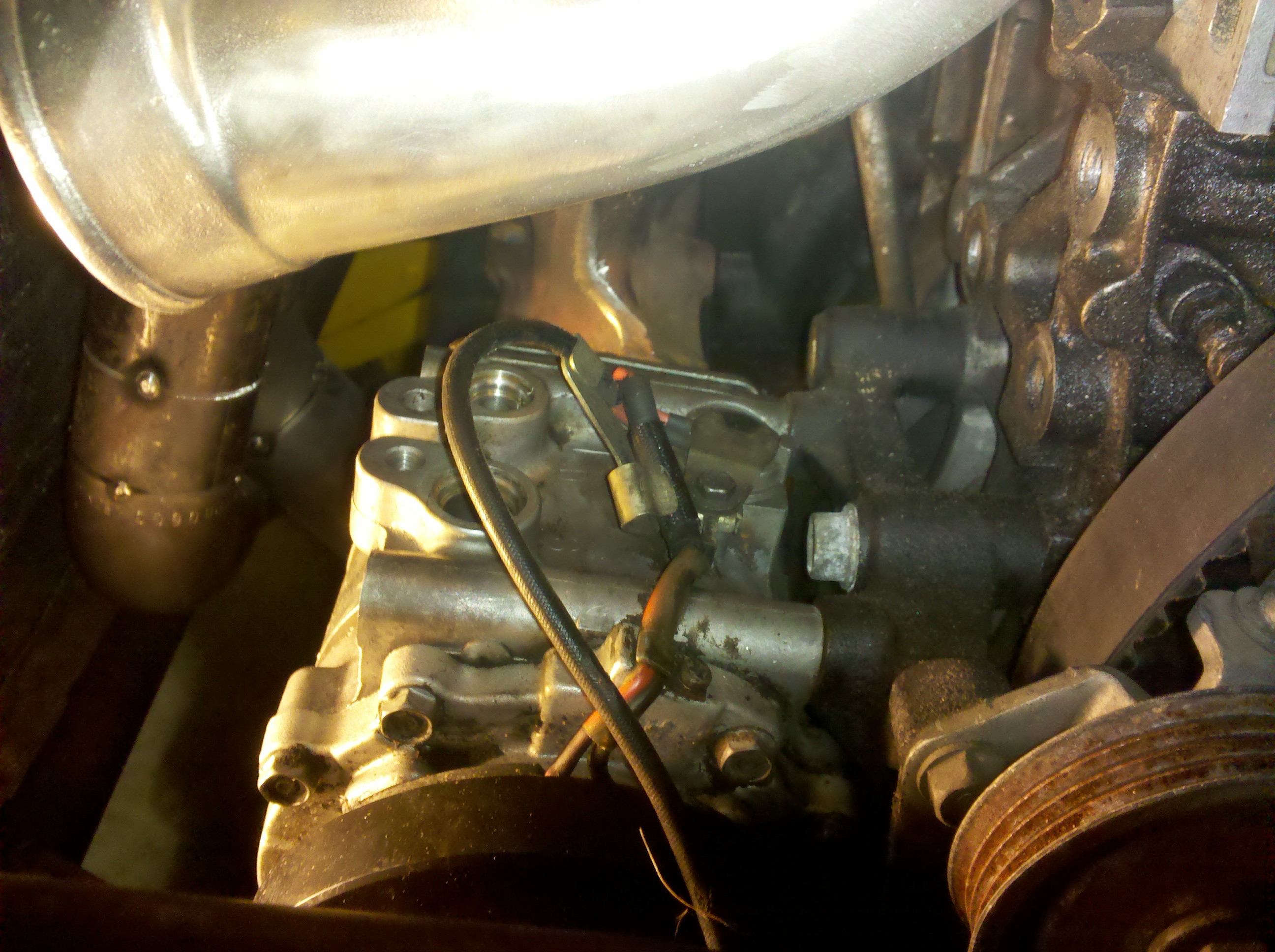

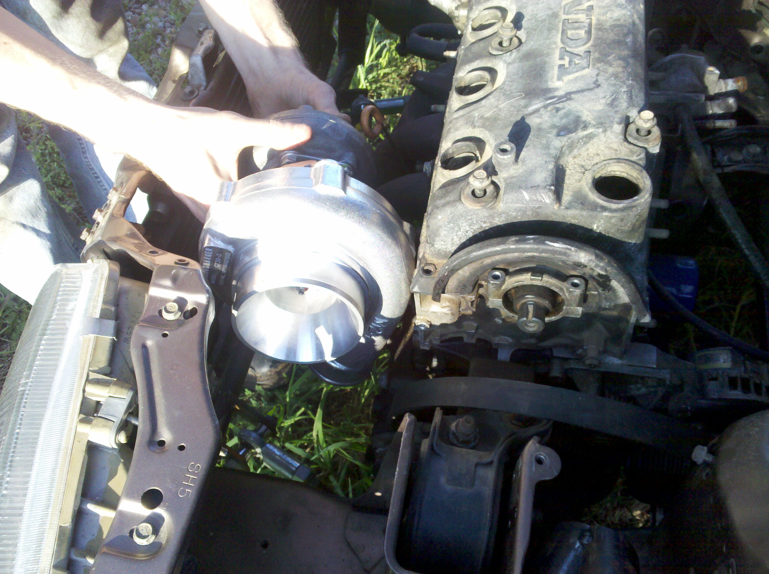

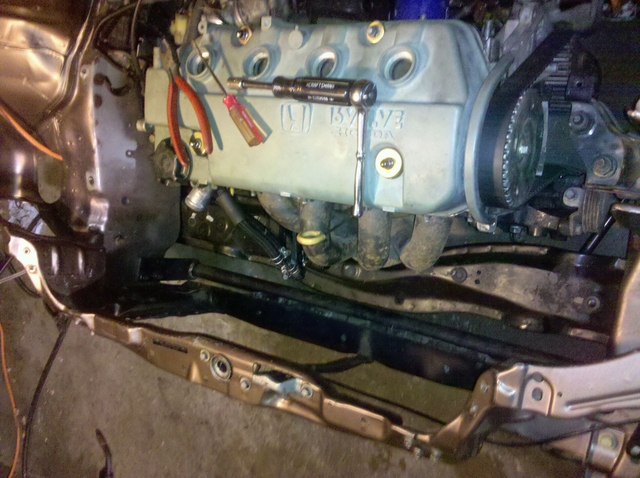

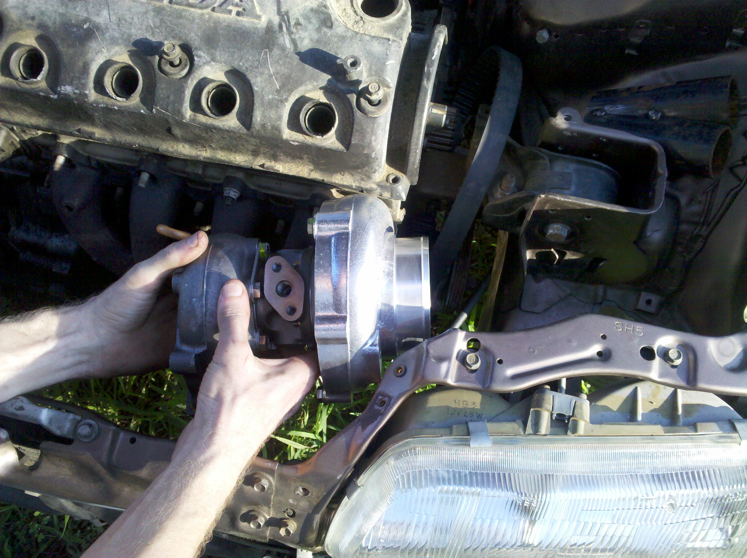

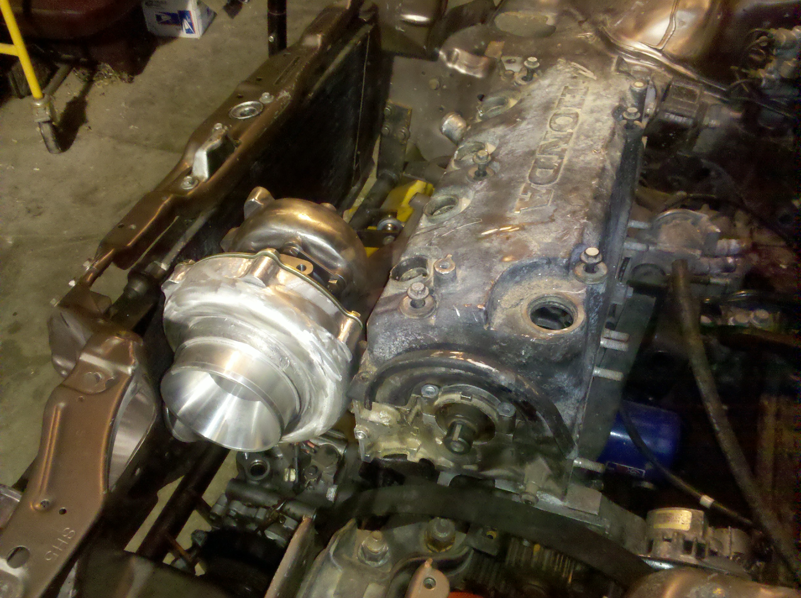

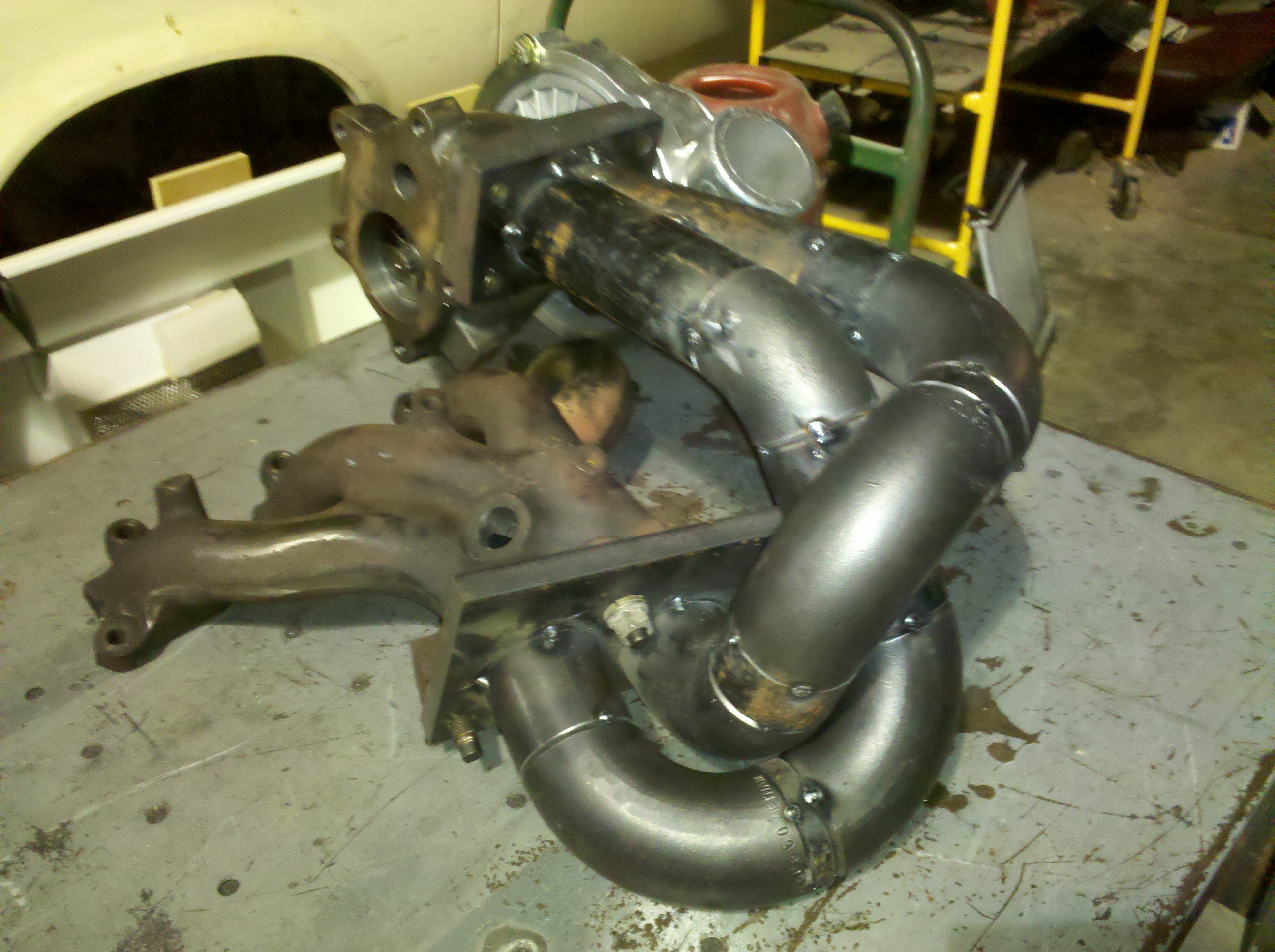

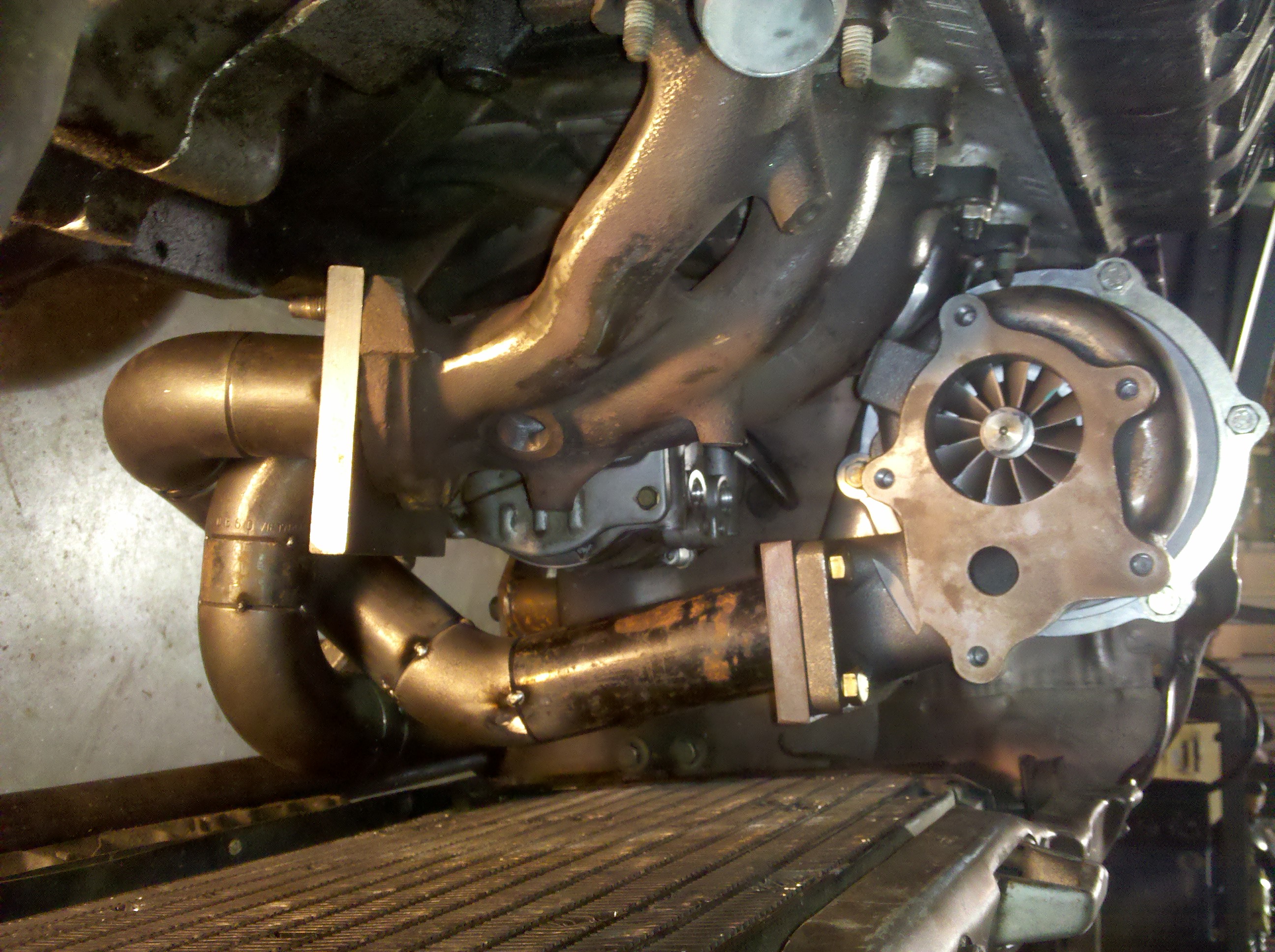

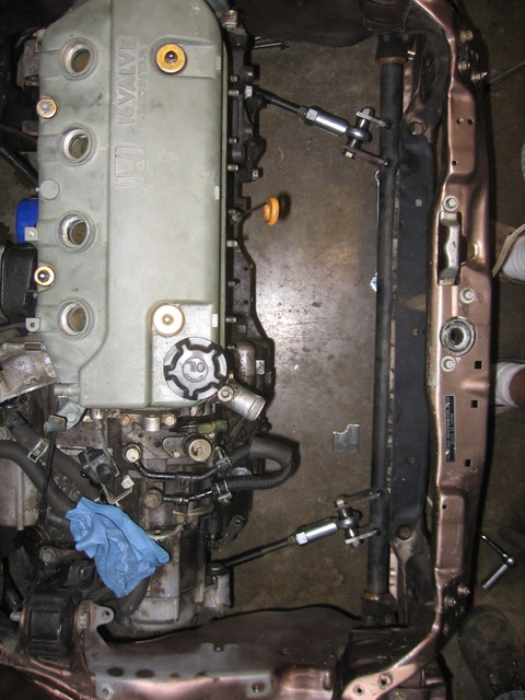

We talked about changing the angles, but thought notching the end tank made more sense with our situation. It also needed to go as far over as possible, since so much is being shoe-horned up front with the turbo stuff.

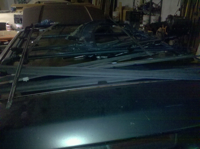

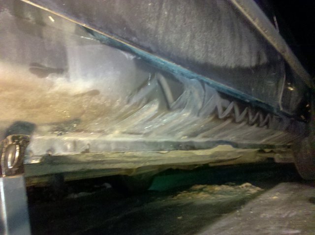

thanks... I wont be going back to the shop til next week, but I'll try to get some decent pics. they are 1x2 box tube, tapered ends, and they had 2 pie sections cut out to follow the rail contour. with the left front jacked up, right rear down, and the other 2 off the ground, the doors open and close like its sitting flat. I was surprised at how much it helped. yes, I was a skeptic...

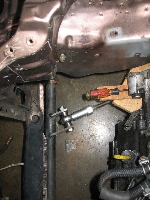

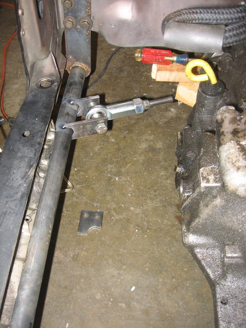

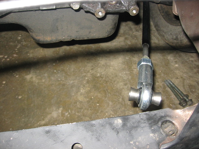

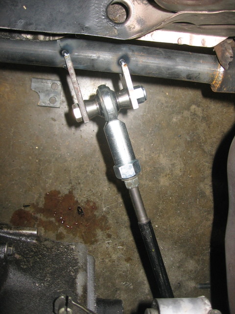

cutting thread on 3/4" rod for the toe bar/traction bar/radius arm/whatever ya wanna call it
milling reliefs for the lower arm mounts
the temporary next to the permanent

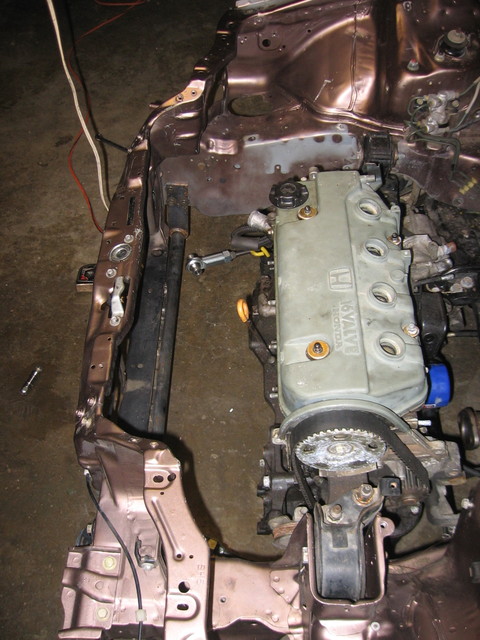

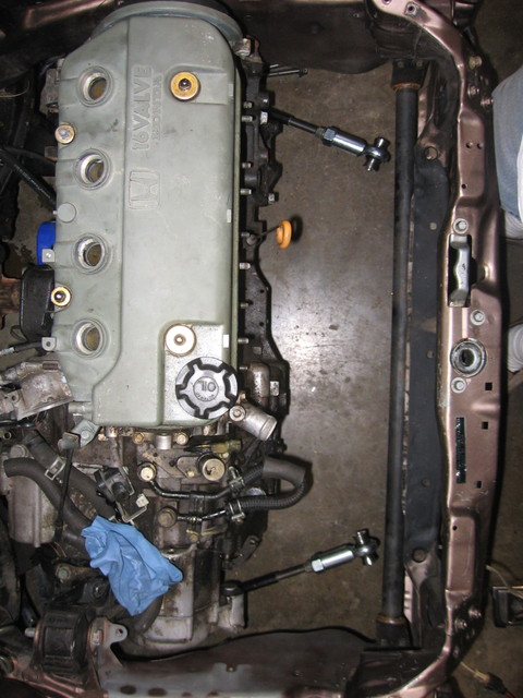

and what do you do when the traction bar set-up and the radiator want to occupy the same real estate?
darin is having the same issue with his traction bar in his wagon. we decided to make a new traction bar and build it around the rad.

this shows the clearance needed for the heim mount.

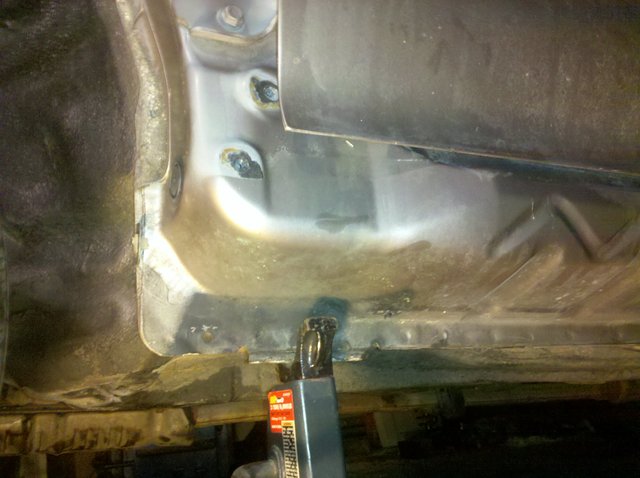

subframe connectors
more shaving, too many holes and contours. removal was the best method...
I'd like to see more detail on the subframe connectors, was thinking of doing something similar on my lifted project.

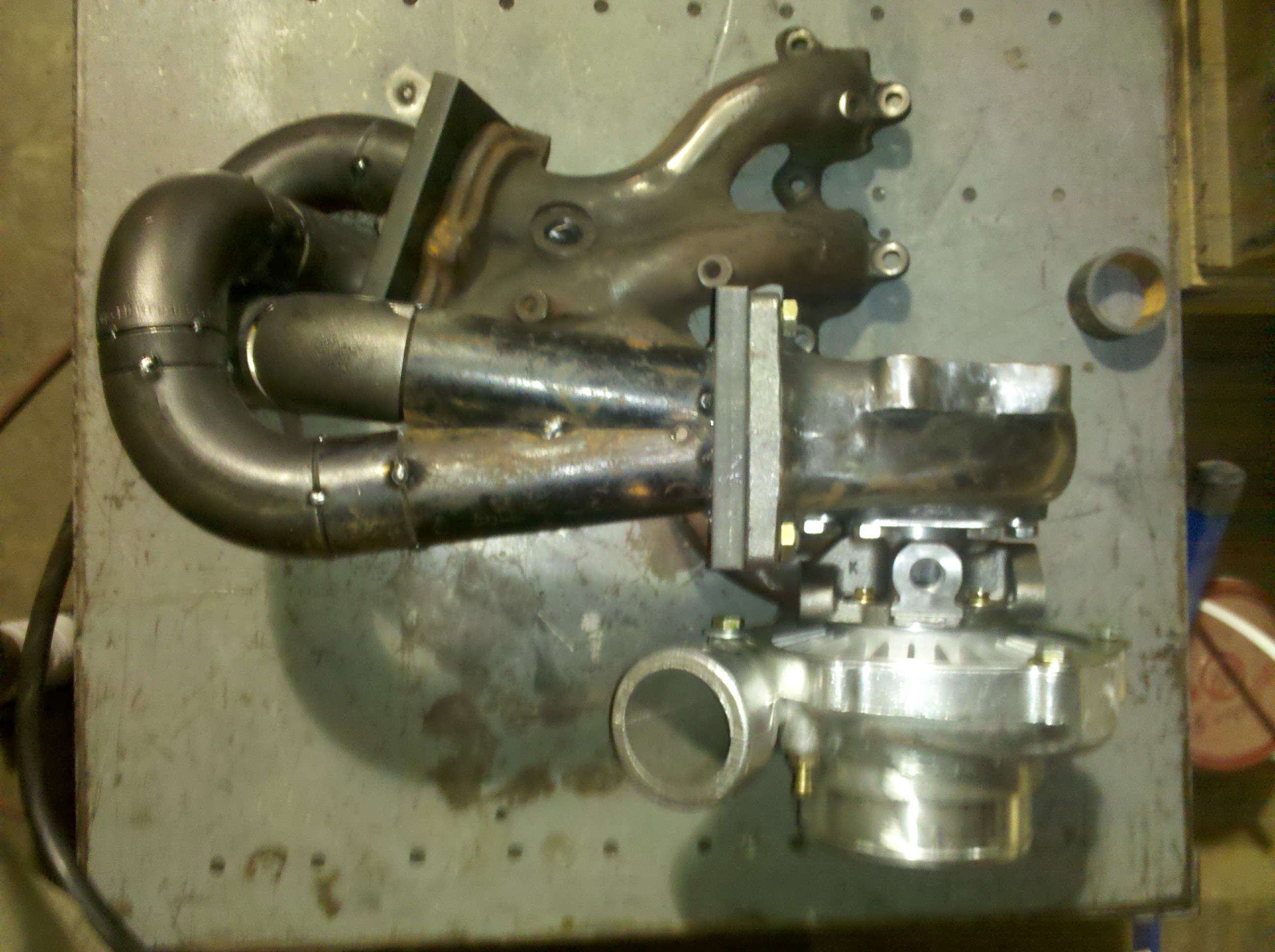

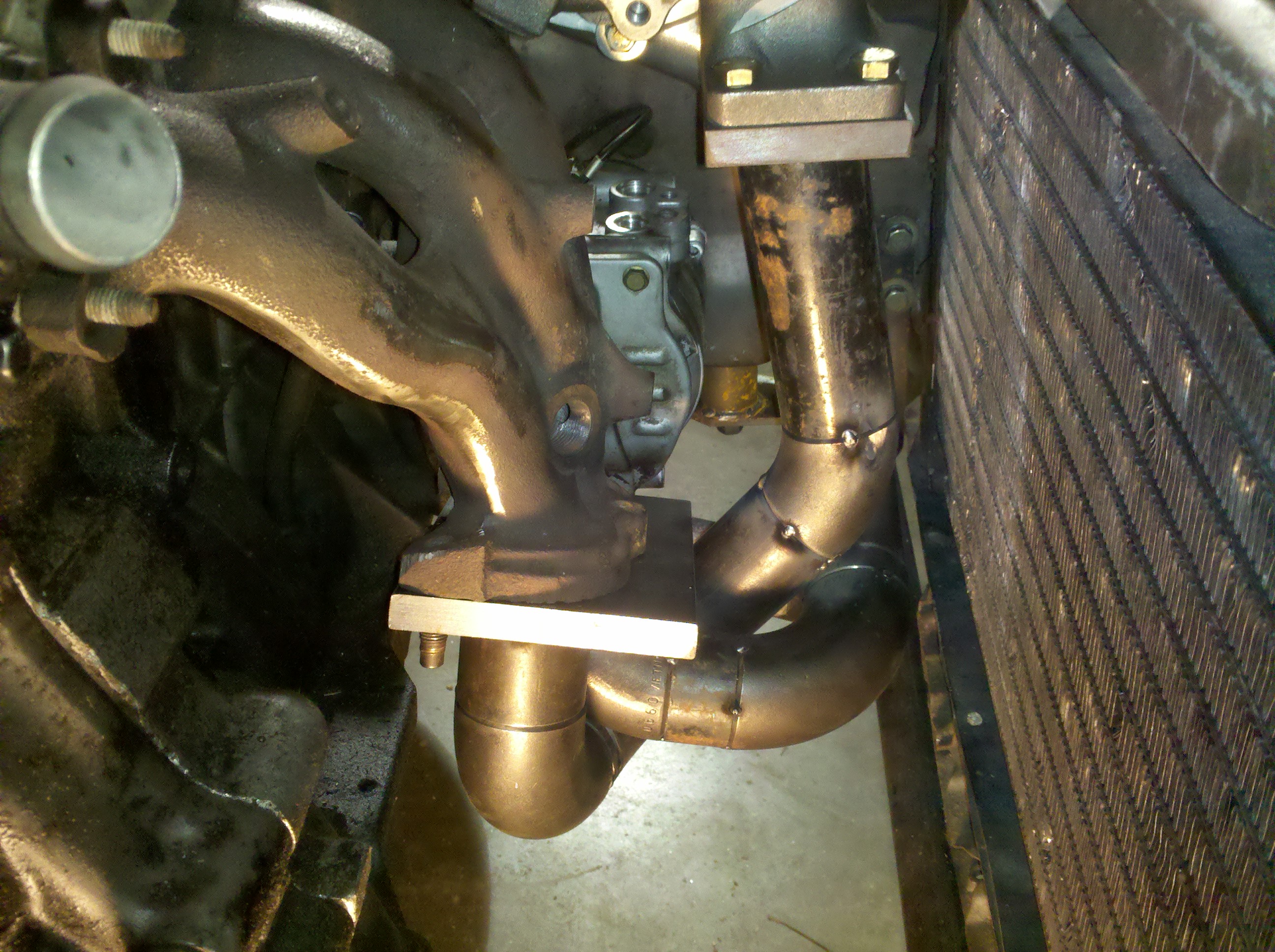

the 3" stainless downpipe is coming together.
