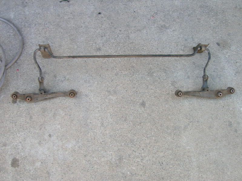

    Took some quick pics today after I did some work. Finally got my rear sway bar in!!
    Rear Sway Bar!!

  • man ur trunk prop looks a lot like mine lol
    did the crx sway bar bolt right up no mods?

    Haha im thinking about wrapping my trunk prop to make it alittle cooler or something:)
    The sway bar wasnt too bad. I used the arms,sway bar and links off my crx. I used DA integra mounts to attach it to the car. I just had to elongate one hole and everything bolted up after that :D

  • Any chance Bisi would let you throw your Wagon on one of the lifts so you could take pictures of the rear sway bar while lying on your back on the floor? I'd like to see an overall picture of the bar install to get an idea what clearance would be like in the back with rear diff and a Magnaflow oval muffler going through there.
    Thanks

    x2 i also bought the same sway bar and i was also wondering how you mounted urs
