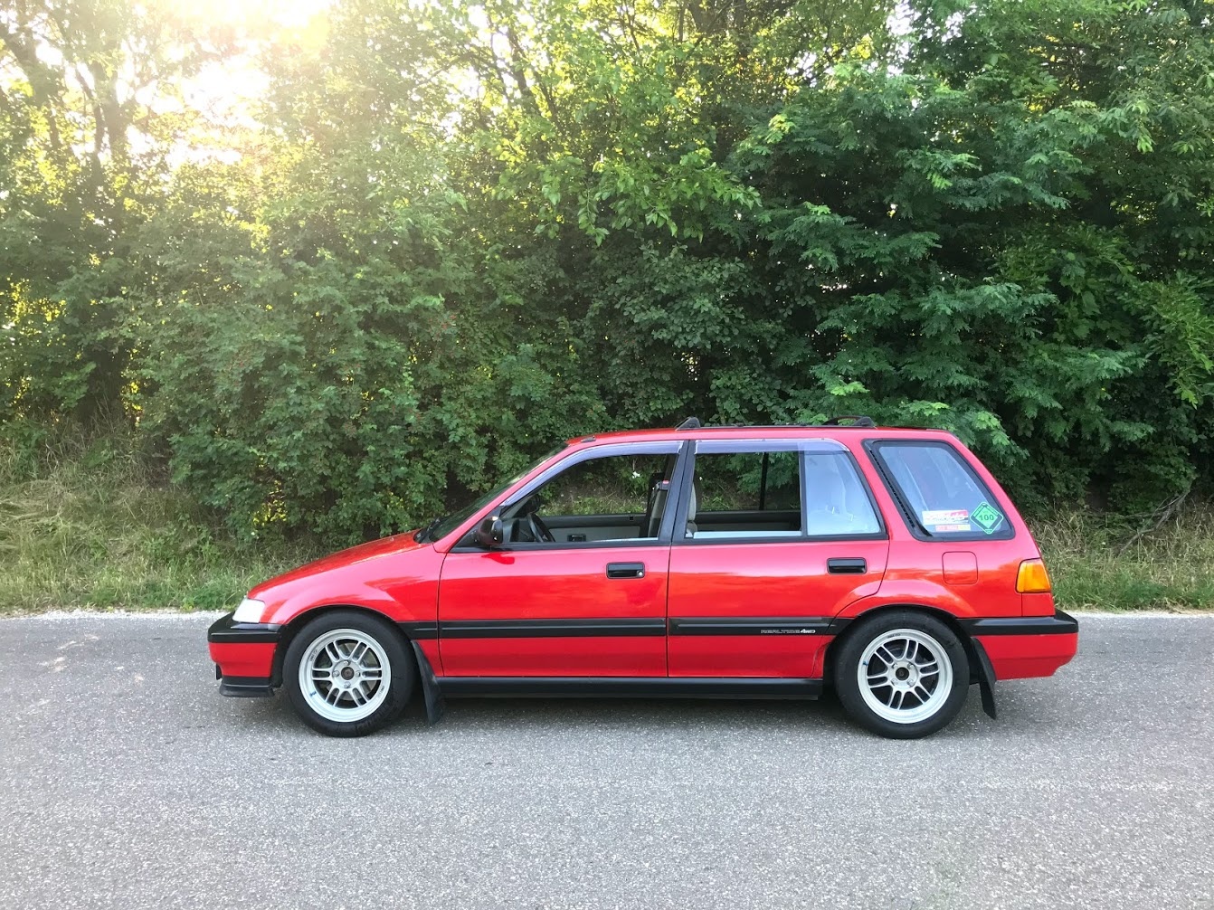

  • The issue with the RT is that it's suspension is designed to be higher than the regular EF line. So when you get springs/struts, slip on coils or coils you end up having to deal with those few extra inches. I've got some skunk2 coils for an EF Hatch on my car and the drop you see below is with the coils basically fully lifted.
    So I wouldn't trust a cheap coil and how it's going to look much less ride on an RT wagon.
  • This looks great I really like how the wagon sits to me it’s perfect not to low and the wheel gap is gone

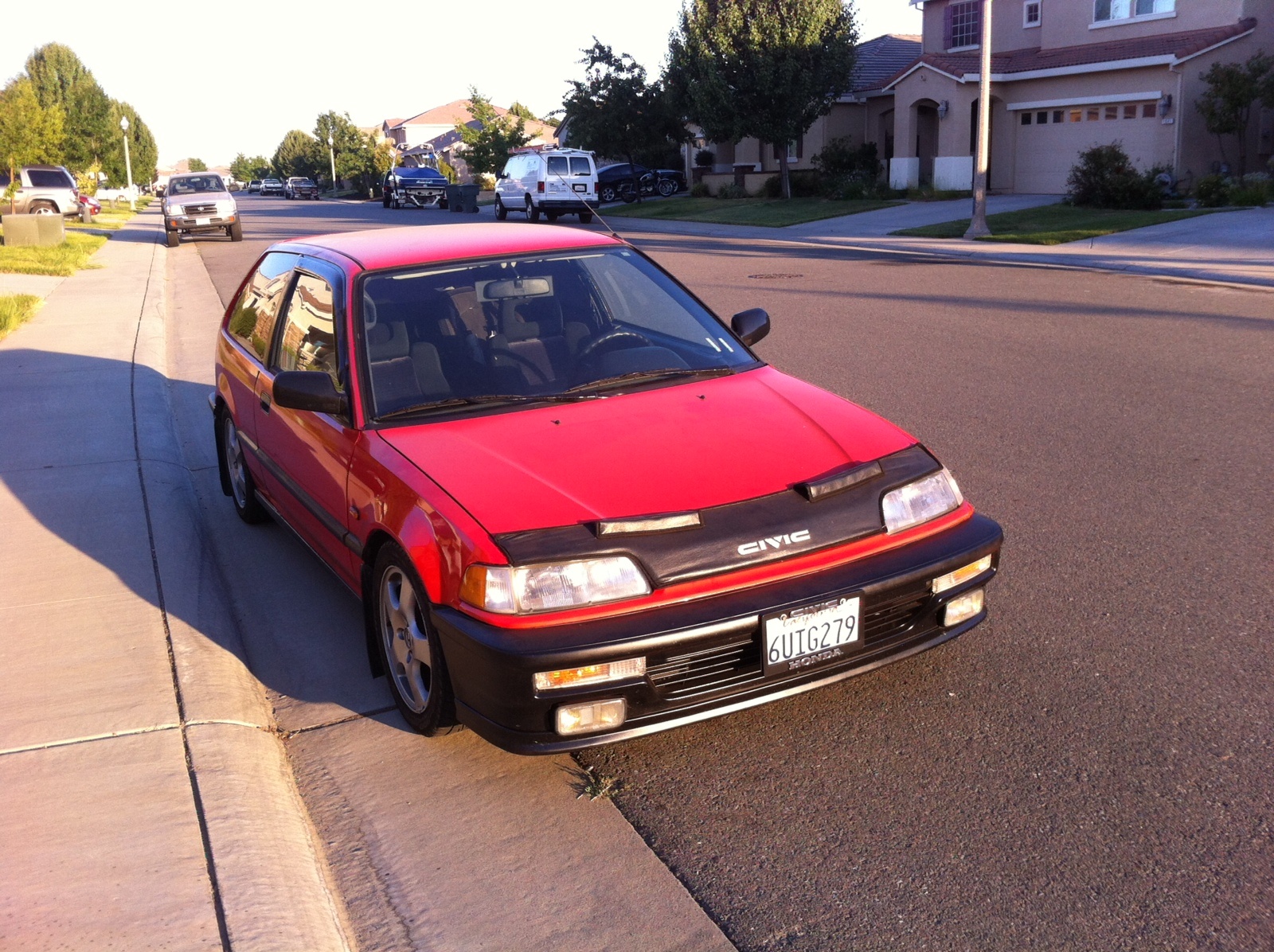

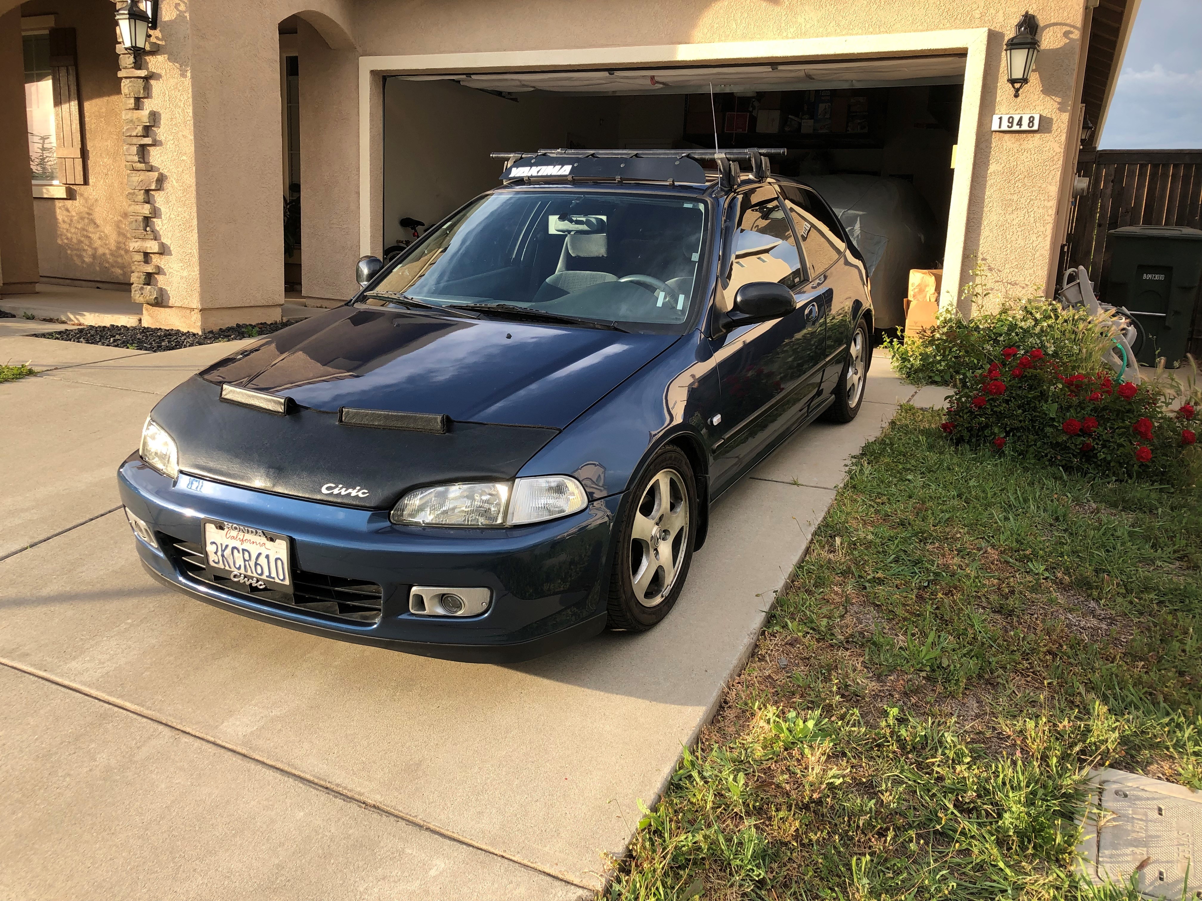

  • That is a very nice drop. I would definitely like a set up like that. I agree, a cheap set up is not worth it. I had Progress II coil overs in my EG and I was very happy with them. I am thinking about getting EF Progress II coils and putting them on the wagon. Pictured below are my previous 90 hatch and 94 Civic. Hatch had Ebay coilovers which I will never use again.

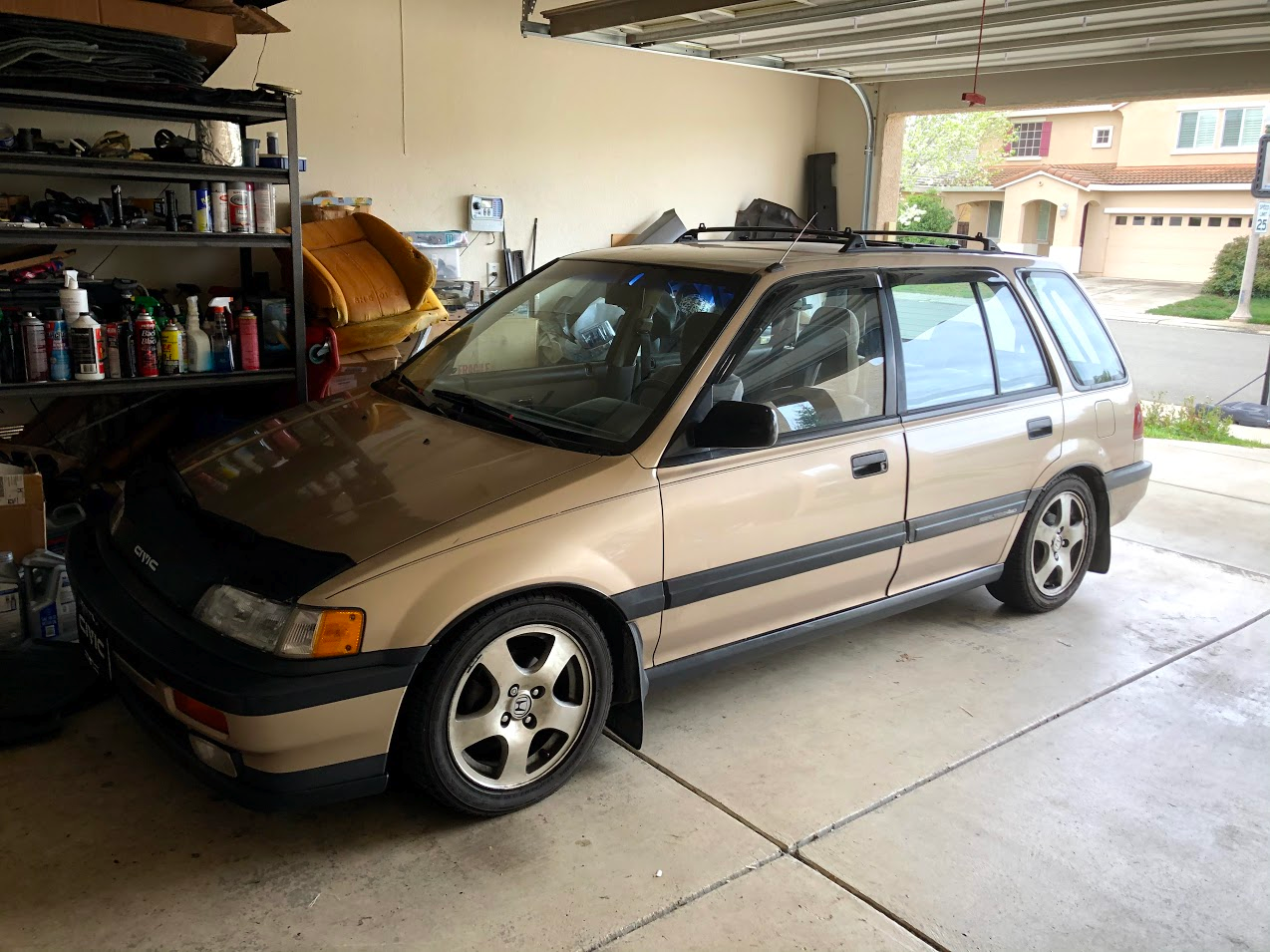

  • Just installed my Progress CS II coil overs last weekend. The quality is great and it is a lot smoother than my 1988 OEM suspension! Very glad I chose these coil overs!

    @cjwang2 That drop looks great! Did you buy the EF hatch coils? If so what were the settings like?
  • I did buy the EF Hatch coils at 250/350. Was a very easy install and only took a couple of hours. The ride is great, a lot smoother than the original stock suspension.
