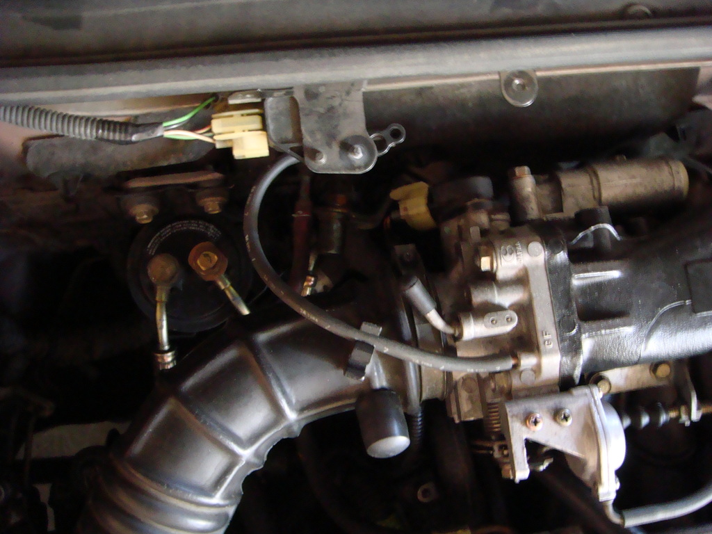

evol, could you do me a favor (or anybody with an RT4WD)... take a picture of the vacuum lines around the MAP sensor and intake manifold? i just want to make sure its correct. i used to know where a diagram of the lines was but can't find it. also pictures are worth more to me.
also going to change the fuel pump back to stock, soon as the 10 gallons i have in there are used up
This probably won't help you seeing how I don't use a charcoal canister or a purge solenoid, no emissions where I live. As you can see, one vacuum line from the top of the TB to the MAP sensor. The bigger red line goes to the charcoal canister but I don't have one so you can see its plugged on my TB.
Another thing about vacuums lines on Honda's, if they are the OEM lines then you can tell by the numbers on them where they go. The line I have going from the TB to the MAP says 7 on it but I think its actually a longer line I scavenged from somewhere else instead of the OEM MAP sensor line.
In this vacuum diagram you can see the numbers, there should be numbers that coincide with the diagram printed on the vacuum lines.
hmm, i do not have the purge solenoid control valve on mine (or maybe the dashpot control solenoid valve???)
also i have no 3-way joint A, or B.
here is a picture of mine...
i have the 21 line plugged into the wrong thing. i do not have a dashpot solenoid valve, also my dashpot only has one line going from it. so that doesnt matter.
i had the line going from the purge solenoid valve going into the TB and the MAP line going to the charcoal canister
anyways, its all hooked up correct. and it possibly *seems* better, could be a state of mind, but i just drove a lap around the neighborhood. we shall see in due time
