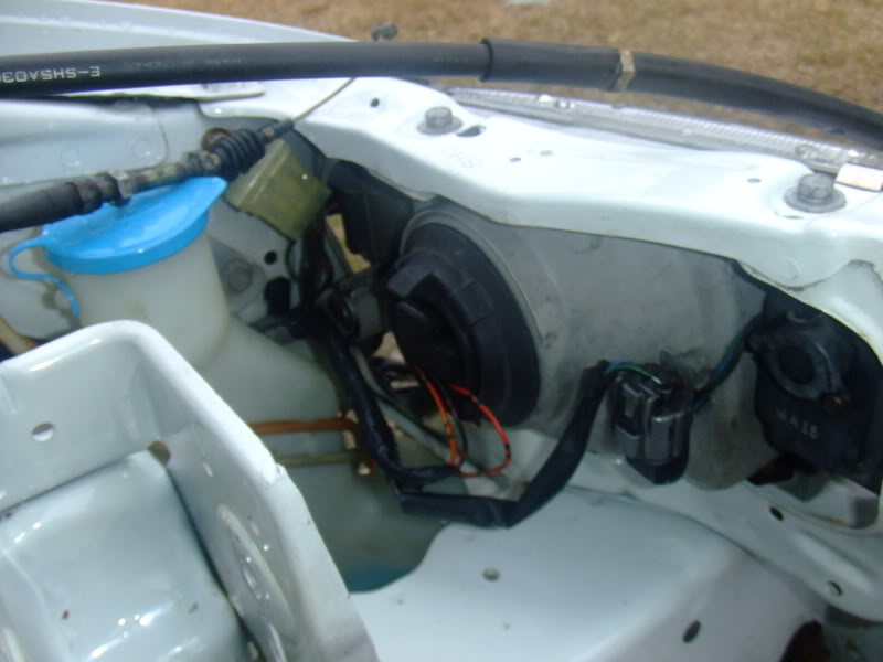

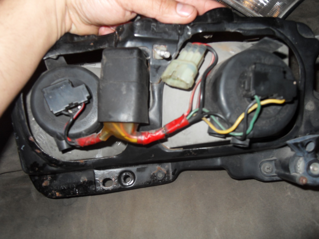

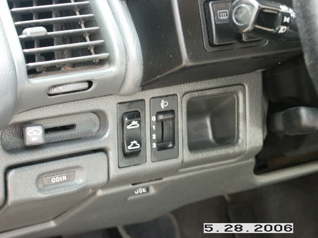

obviously, i have installed EDM adjustable headlights. this works by a small motor that moves the lens inside the headlight housing. the motor is controlled by a switch in the dash.
NOW.
the switch has 2 wires coming from it. on BLACK and one BLUE.
the headlight motor has 3 wires coming from it. BLACK, BLUE, GREEN.
so now the question is, who knows how these would come together?
my thoughts were that the black and blue wires connect directly together, and the green one is either a ground or a power source.
anyone care to share some knowledge?
NOW.

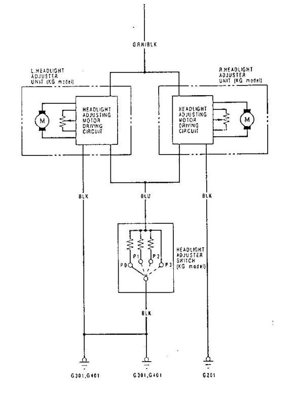

The green is green/black right?
If it is, mine is running to the fuse box which is 15amps.

This adjustment is a REQUIREMENT here in Germany for any car newer than a 1990. Your car will fail inspection if they are not functioning.

all my relatives' cars in Europe have the manual leveling switch, including every rental car we have ever had lolz

also schematics...
