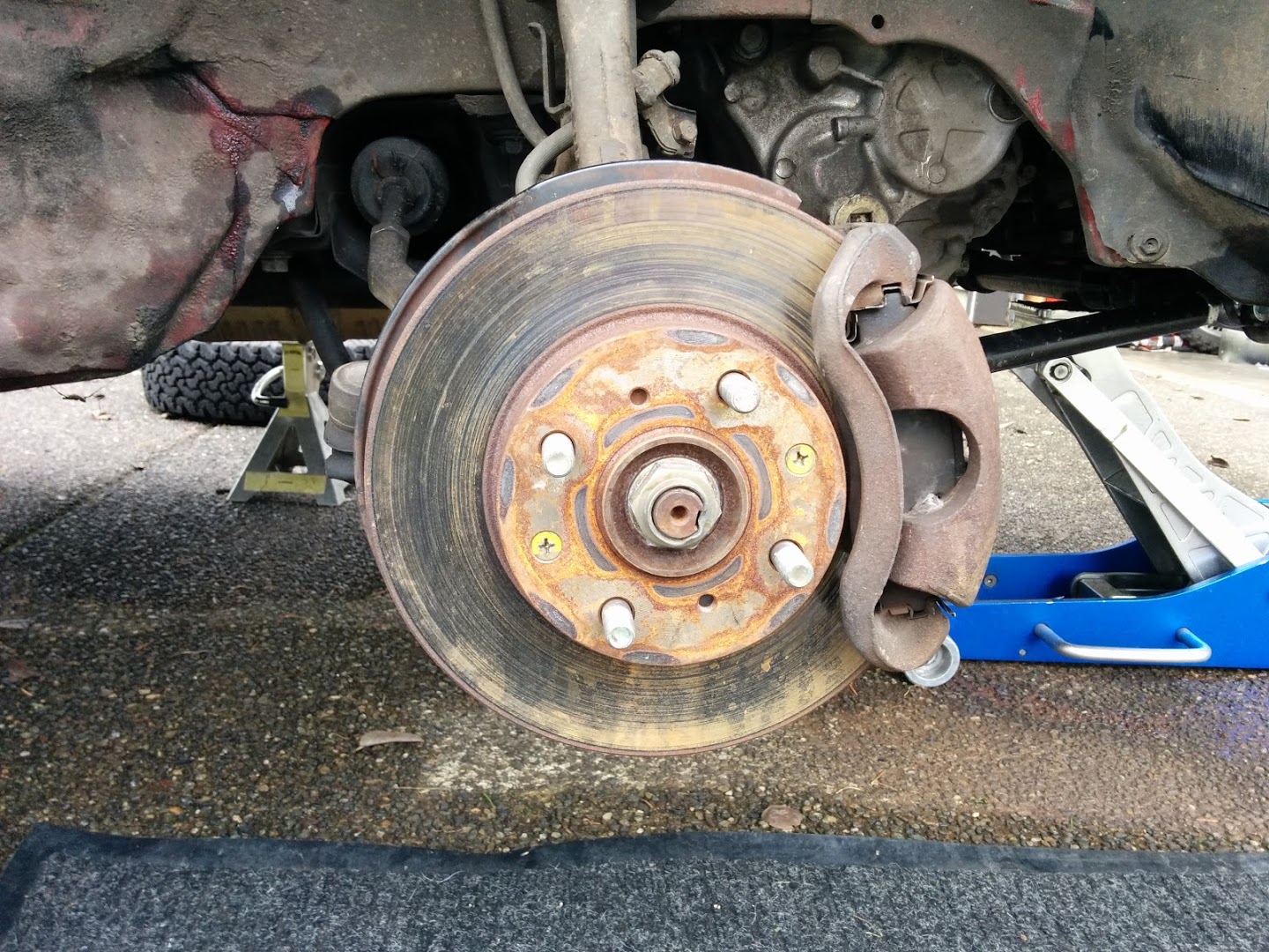

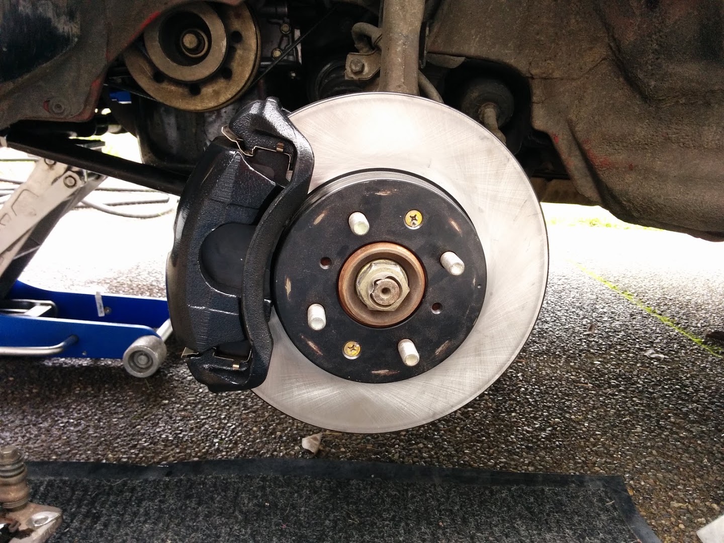

  • I just did 95 Legend Calipers and brackets with DC Integra rotors. So mini Integra Type R brakes on my RT. They fit under the stock 14" steel wheels will a tiny bit of grinding on the caliper and bracket. The outer edge of the rotor also just kisses the inside of the caliper and also needed a little clearancing.
    Did Stoptech rotors and pads, the wagon actually stops now and have the power and modulation to lock up 195/75-14 BFG All Terrains at will on dry pavement.
    Went from this poor excuse for a front brake.
    To this.

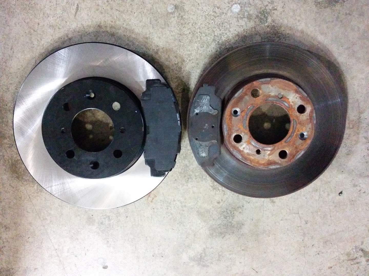

    Rotor and pad side by side.
