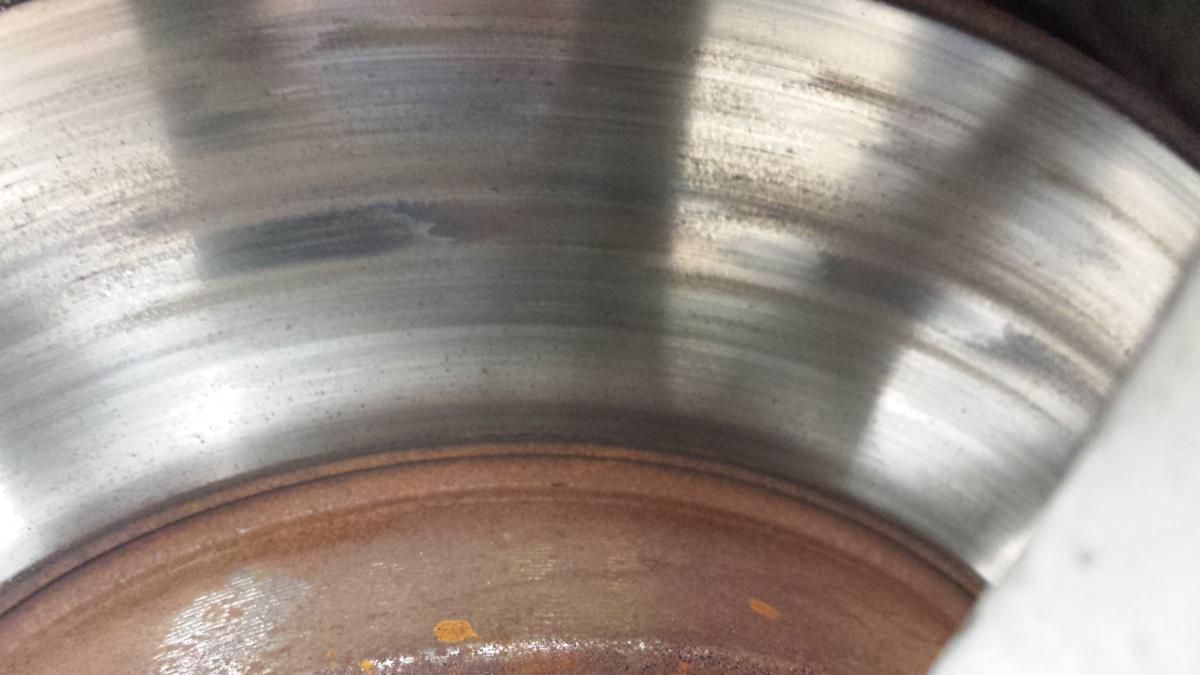

This is what the front left brand new rotor looks like after 2 weeks.
if you look, there is a strange ring of what looks like a grab/release/grab/release. zoom in on the pic, the left of the pic really shows it off.
When I put the new machined rotors on, it was great and smooth for the 1st 100km-0 brake for bedding in the pads, after that it starts feeling like poo again.
What's going on here?

  • Huh that is an interesting harmonic you have there.

  • With the new rotors/machined rotors, are you using the same pads as before? There's definitely something there causing hot spots. Maybe you have a crap set of pads. What pads are you running? Some run hotter than others, maybe the pads themselves are overheating the rotor.

    the replacement rotor doing it's thing again, a bit hard to see because of shadows and it's still on the car, but you get the idea.
  • Yep, at this point I'm with Lowflyin' replace the caliper, they're cheap enough.

    quarters wrote: »
    Looks like uneven pad transfer.
    Overheating the brakes can cause this.
    A stuck/sticky caliper will cause overheating.
    I'd suggest trying a new caliper.
