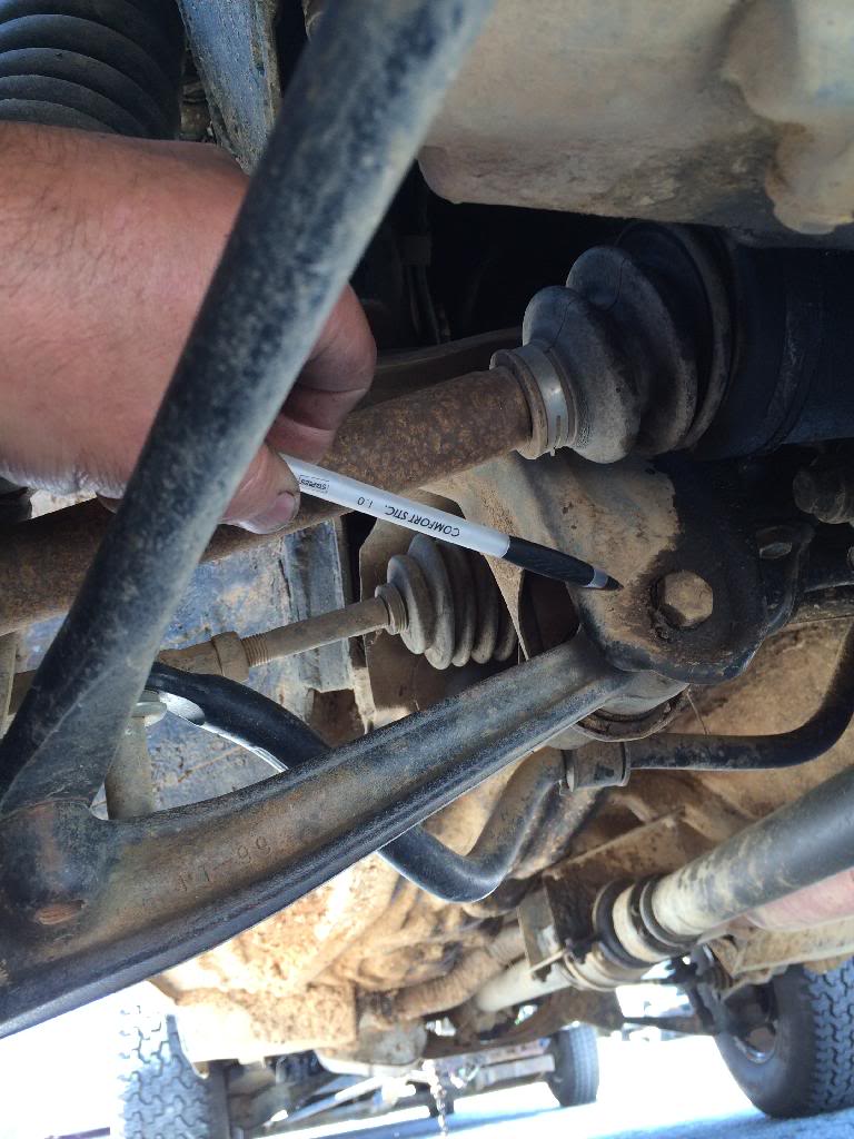

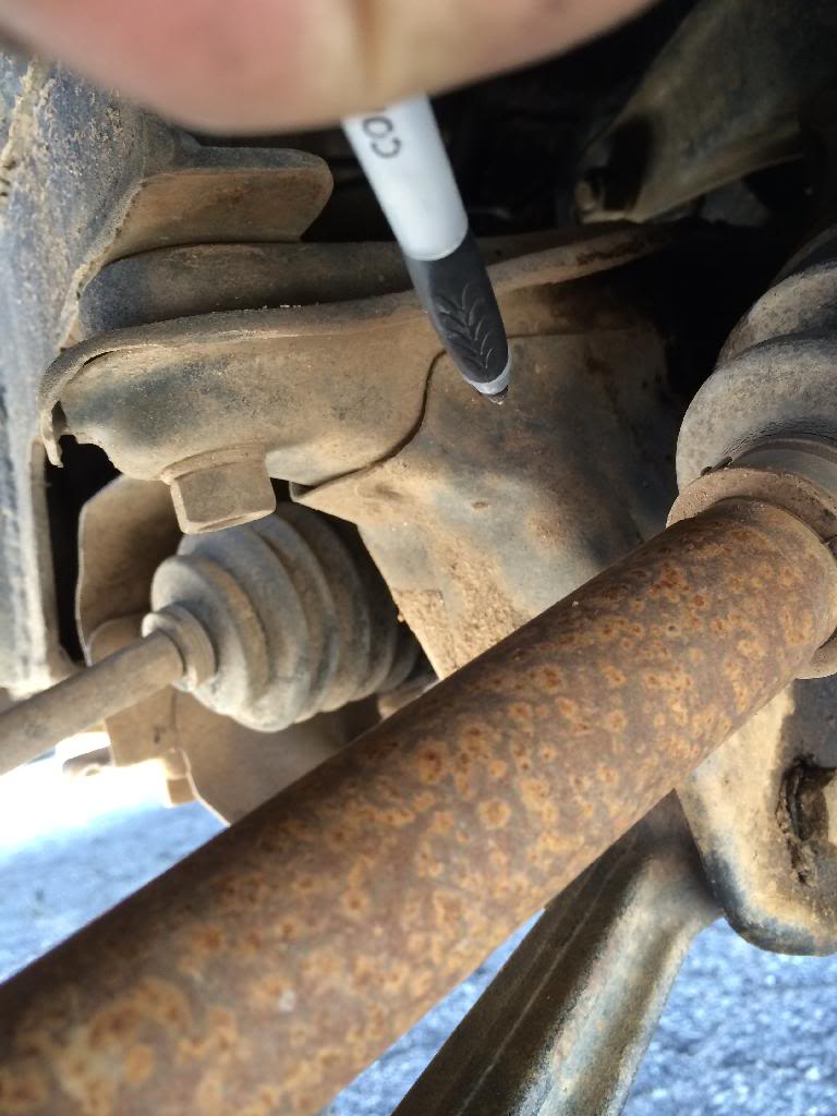

    Here's the album. Me and my mechanic couldn't see anything wrong. But the picture I took from under sure looks weird. What do you think?
    http://s1102.photobucket.com/user/ingirunar/library/dekkjavesen?sort=3&page=1
  • lolingirunarlollolingirunarlol New Wagonist
    Anybody see anything?
  • SkeletorSkeletor Band Wagon
    http://s1102.photobucket.com/user/ingirunar/media/dekkjavesen/20140428_203538.jpg.html?sort=3&o=4
    I don't know, maybe its the angle, but your bushing doesn't look right to me. Is it pushed to one side? or is it just an optical elusion?
    Yeah, it sure doesn't look right. Thanks Skelator.
    Any more feedback?
  • VladiVladi Senior Wagonist
    Is it just me or is your upper control arm bend slightly?
    Looks like it's bend inwards too, which "explains" the positive camber.
    I really don't have an eye for this :(
    Your best bet is to replace the upper and lower control arms, and with that kind of abuse prob the lower ball joint and steering joint too. Def take off the torsion bar (radius rod) and make sure it's not bent.
