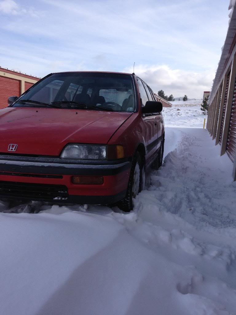

So I scooped this from Austin (Ludeman) last weekend and am in love.
I had to dolly it home in 2WD but it made it safe.
Literally the first day I tried to drive it, the front driveshaft lost 3/4 bolts and was causing a mess. Luckily it wasn't bad and Mr Tire hooked me up big time. Got to put it in 4WD and play in the snow we got that day and made it through about 3 foot drifts. Quite fun. Pics!
