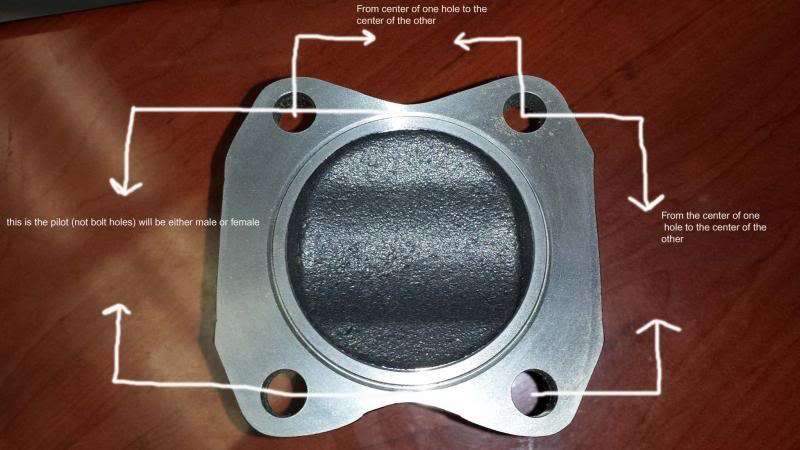

    Yeah, replacing seems easy enough. If I can get a DSS replacement however, I would much prefer that over this fix on a 20+ year old part system. Which leads me to, if you actually have your stuff out, would you mind doing some measuring for me to send to the guy I am talking with at DSS? He sent me the following photo and wanted this info;
    Hook me up?

  • I will bring my calipers home and try to get this for ya over the weekend.

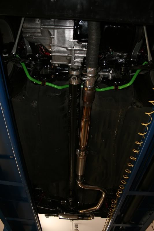

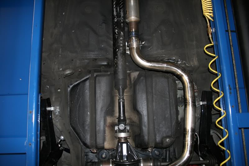

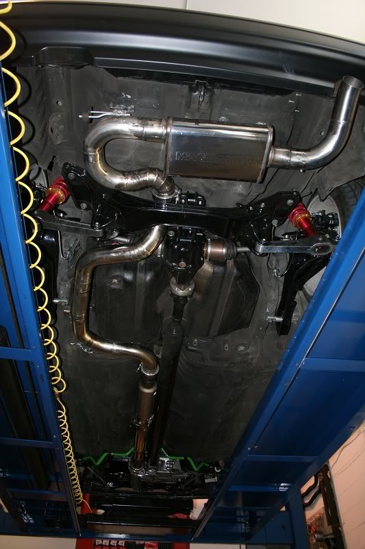

    Anyone have a picture of the driveshaft tunnel with it entirely installed and taken out? DSS wants to know how much larger a shaft we can accommodate for the one-piece design.
  • 503Wagon503Wagon moderator
    thats the best i have.
  • bkmc24bkmc24 Senior Wagonist
    Sweet. Thanks! I sent it to DSS. Hopefully that and one of our members samples can provide enough to get us a one-piece and replacements.
    How did that driveshaft work without the coupler? Did it affect anything poorly or did it work better?
  • If I'm not mistaken, on that particular setup, it was full RWD, with the front axles deleted. I'm really not sure how the car would behave with a solid shaft and 4wd. I've always wondered about this though. Would you get the typical 4wd-screeching-tires when turning sharply? PErsonally, Jaker's RWD was the only one I've seen with a solid driveshaft, and I'd only heard people talk about solid shafts in relation to RWD conversions.

  • bkmc24 wrote: »
    Hook me up?

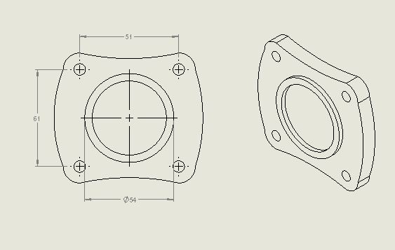

    Here are your dimensions as best I could measure, on a very quick sketch of the part (hard to measure hole centerline to centerline). I would say that it could be +/- ~0.5mm or so.
    When I measured from the outermost edge of each bolt hole, and then subtracted the diameter of the holes (8mm), I was measuring 51.5 and 61.5mm as the centerline distances. But when I just eyeballed the center of each hole, I was getting 51 and 61mm.
    Let me know if ya want any other dimensions...
