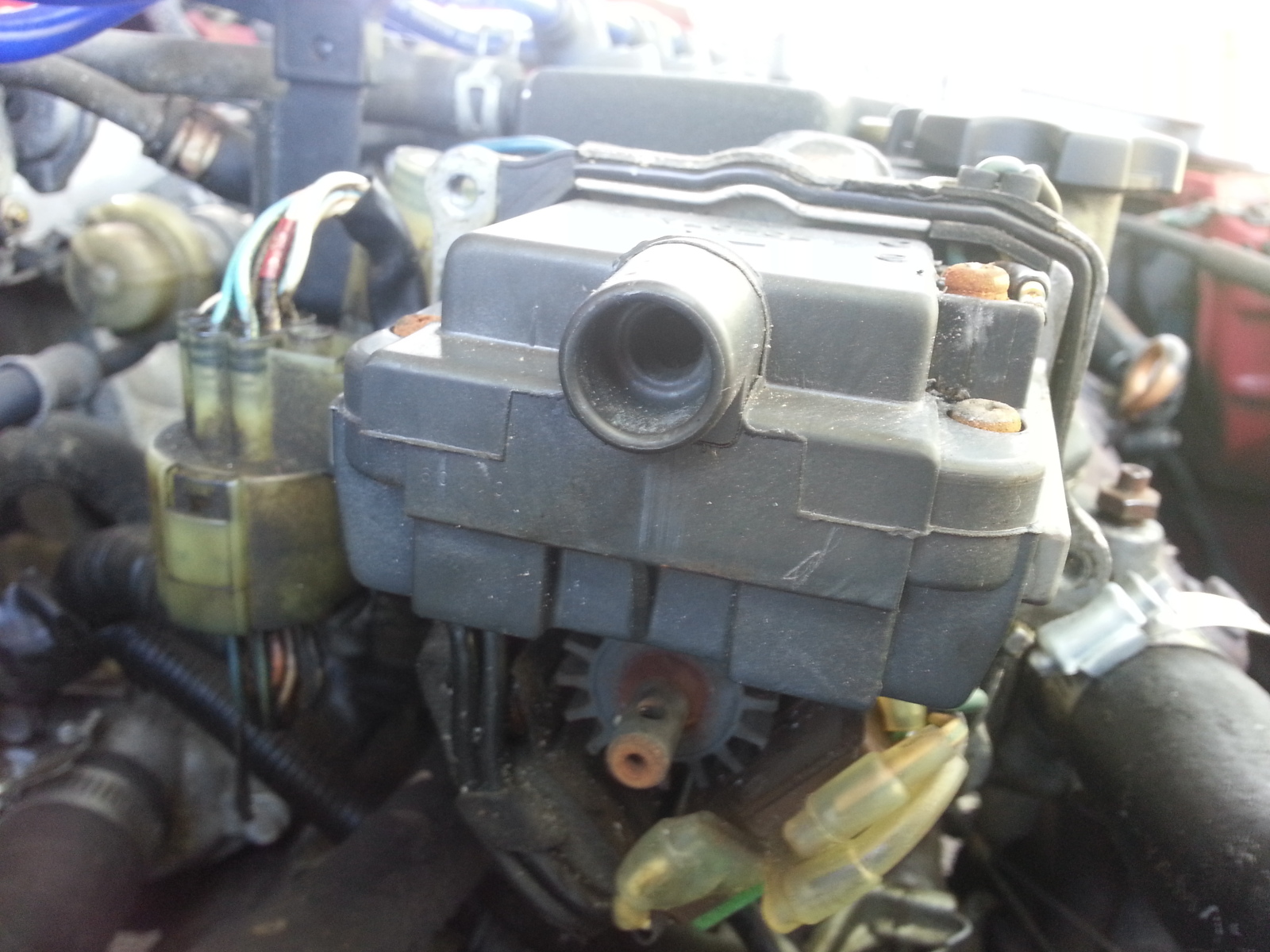

i would also check for SPARK. these cars are notorious for faulty distributors. if you arent getting spark, pop off the distributor cap and take a look inside to see that the rotor is still where it should be. sometimes the rotor screw comes loose and falls out. if its all intact you may have a faulty distributor.

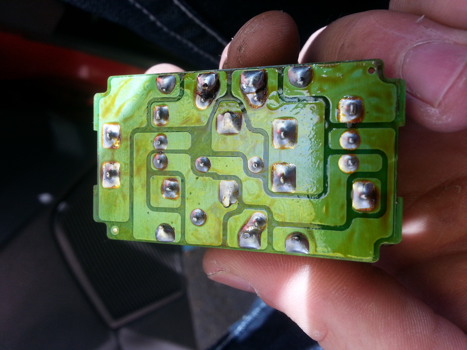

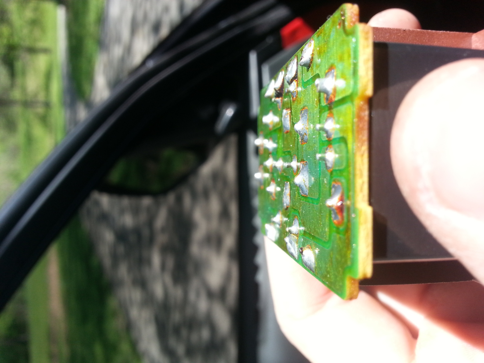

I'm no pro but this doesn't seem right haha
that hole in the top had a piece sticking out and I somehow lost it and that part whrre the blade was had a screw that fell and cant find it could the screw that was not connected cause it?? and is the piece essential
