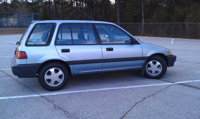

  • thestzathestza Wagonist
    an update -- chit fits... kind of...
    bfgeez, 195/75-14. they rub a little, but i kinda don't give a fudge -- all terrains BIDGE!!!
  • thestza wrote: »
    that looks real good.

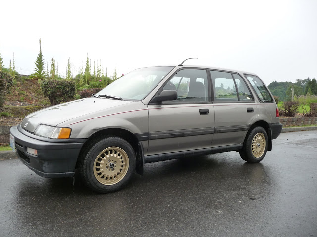

  • yes he is at stock height. thats the pic i wanted to show you.
    BillBoard wrote: »
    who has pix of these tire sizes on there rims???
    I went with 195/70R14s on repainted Mini-Fat Fives. Stock suspension, stock ride height. No scrubbing after the first day (there was some sort of plasticy doohickey in the right front wheel well that rubbed but I removed it.)
    Is this at stock height??? And when does it rub? (while turning or while bumping up n down?) and whats the offset off your wheels?
    hi FullThrottleFreak,
    - the car is at stock height, yes.
    - the rub happens when the wheels are turned to their max (if the wheel is turned to the right, the left wheel will rub on a plastic cover -- it's not hitting the wheel well. same thing is true if the wheel is turned the left -- the right tire will rub). there isn't any rub when bumping up and down.
    - regarding offset, i'm not certain to be honest... i'm running civic hx wheels with no spacers.
    s
