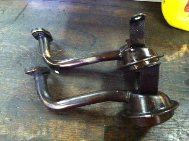

Oil pan:
You have to use the A6 oil pan from the RT4WD wagon, its the only one that will clear the transfer case. You can try to dent up your Z6 pan, but it's going to take a lot of work, and you risk warping the mating surface, and causing oil leaks. If the pan leaks, you have to remove the entire engine and transmission to get the pan off. Do it right the first time, use the A6 wagon pan. It's a direct fit, no modification required. Go ahead and get a new gasket, and pop some gasket sealer on it to be sure, especially around the crankshaft.
Oil pickup:
VERY IMPORTANT! You MUST use the pickup that matched your oil pan! Since we are using the A6 wagon pan, use the A6 wagon pickup. I believe some other pickups can be used, I will look into this. YOU CANNOT USE THE Z6 PICKUP WITH THE A6 PAN!!!! Trust me, the pickup will be pressed against the pan, and will not be able to pickup the oil. It's very easy to swap them, and its a direct fit.

Oil pan:
Oil pickup:
