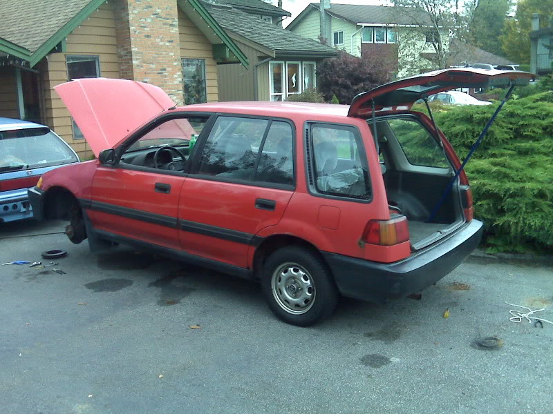

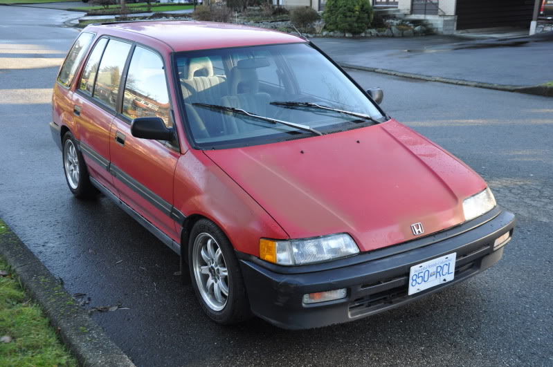

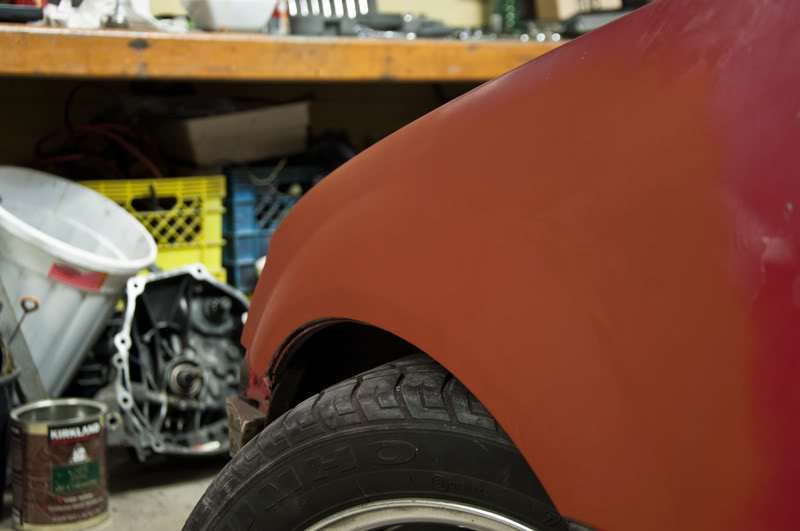

picked up a red 91 wagovan as a new project.a DD for me,was tired of driving the wifes crv.not even 1 hr after i got it i had the suspension ripped out and the koni yellows going in.it has some rust but my buddy fritt is taking care of that.its the 2wd model one w/ a d15b2.slow as shit.i have all the parts for a mini me so i might do that.or i could throw all lowballs parts on it.
the first pic.we started ripping it apart so fast i forgot to take some stock pics.
front installed.notice the rear all jacked? wagos have shorter or longer shocks in the back.(can remember and i did it last week hahahaha)

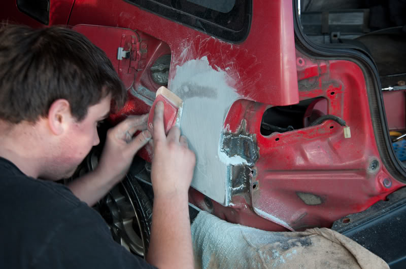

start of one of the rust repairs.fritt hand bent and formed the whole tail light piece.( thanks fritt awesome work. stoked to do more)

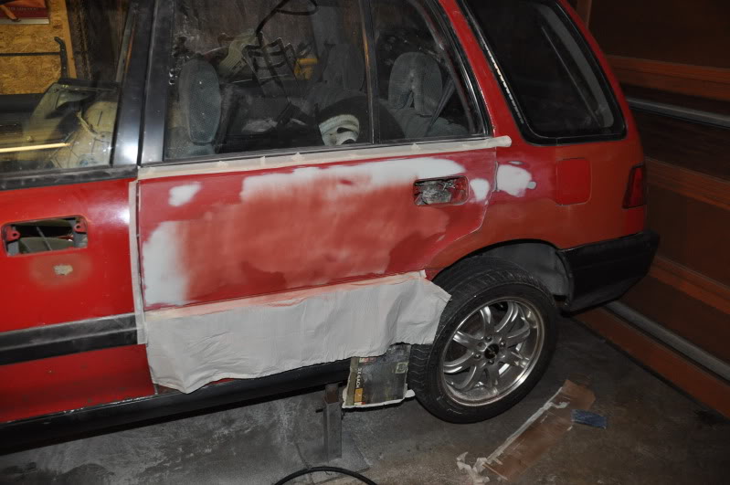

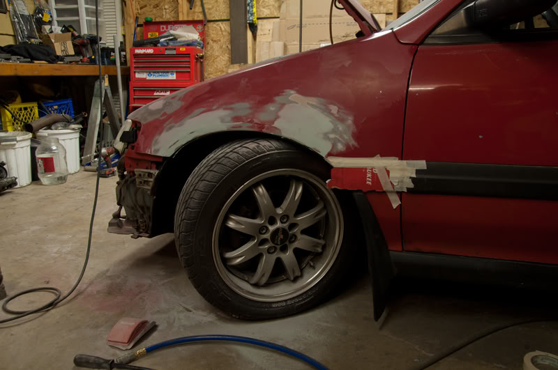

    did some more work last night.its coming along nicely.thanks fritt.
    good sanding and prep work...
  • nice work man
  • sol2vsol2v New Wagonist
    Hey Darin tell you're body man to get comfortable with wagons, he needs to do mine next. :shock:
    Looks good man.
  • ChinojdmChinojdm Band Wagon
    nice came out real good keep it up
  • killer job on the body work sir!
  • Agreed on the body work. I cannot believe you did a patch panel for that rear quarter. Most people would just bondo that rust. Very good work.
  • I envy your rust repair ability. Can I send you my wagon?

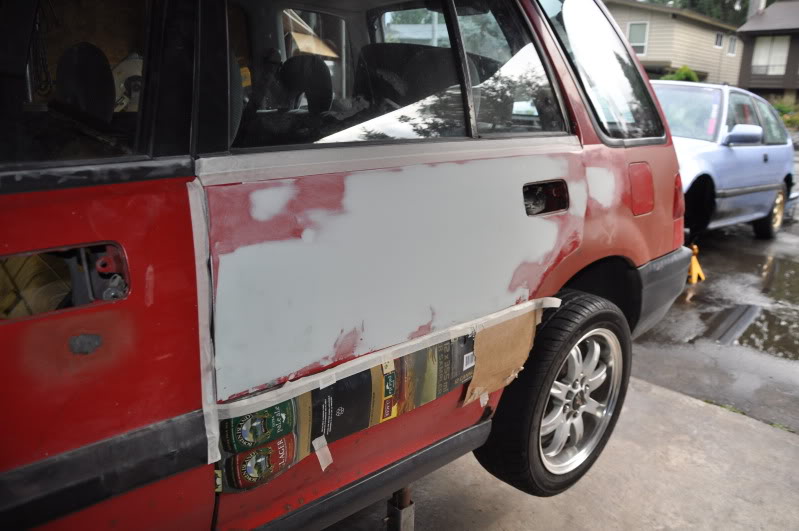

    fritt did a little more work on it.

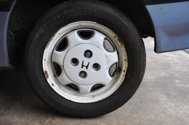

    new pick up.needs a sand blast and some paint.
  • Mr GMr G Wagonist
    So what are ya doing with the sparco's??

    keepin them.they are too rare to sell.lol

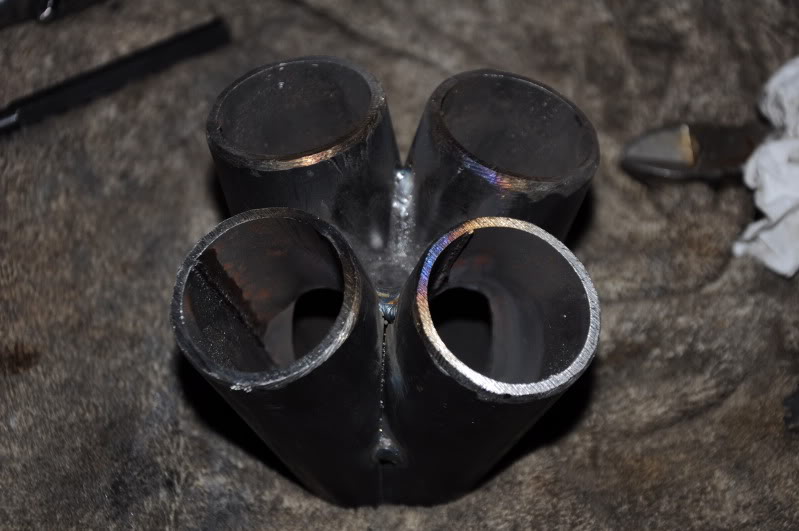

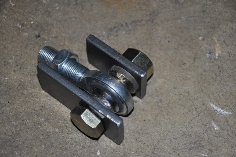

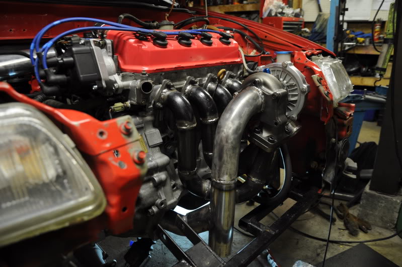

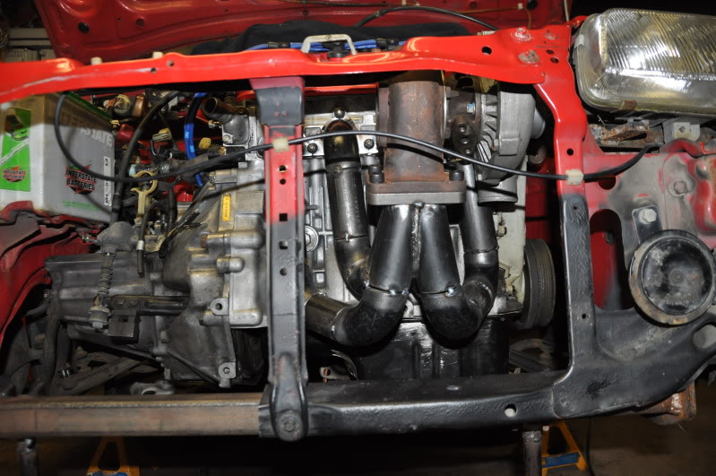

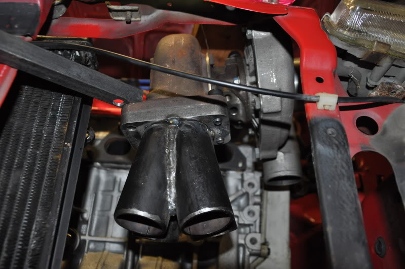

    fabbed this up tonight. getting ready to fab the top mount turb manni.

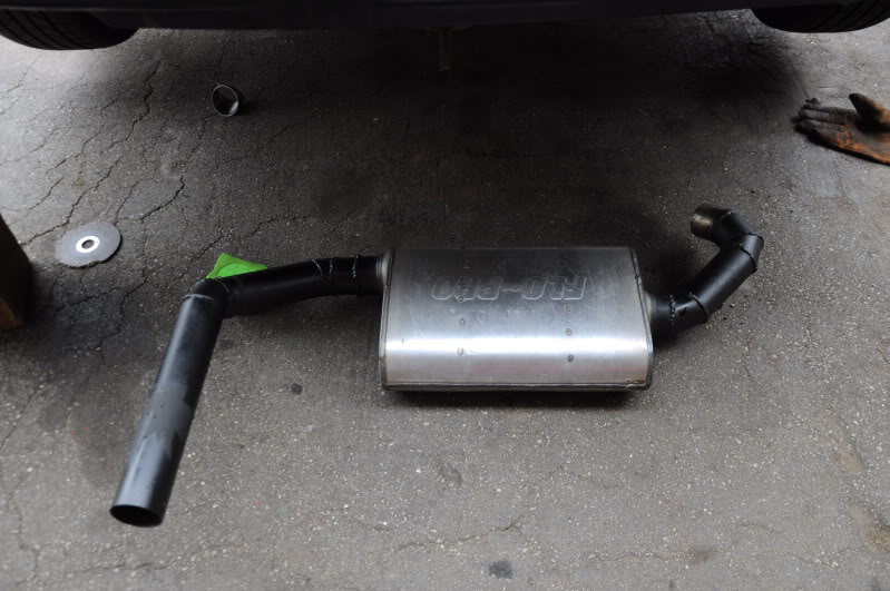

    finally i made a exhaust for my car.the old one was toast.i bought a 6ft piece of 2 1/4 pipe,made some pie cuts on the band saw and went to town.its only a axle back for now
    as i am still piecing my turbo stuff together.
    heres the old one.
    and the new one.will get a better pic of it on the car when it stops raining.

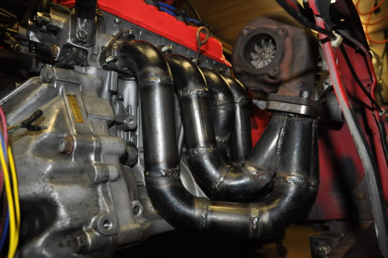

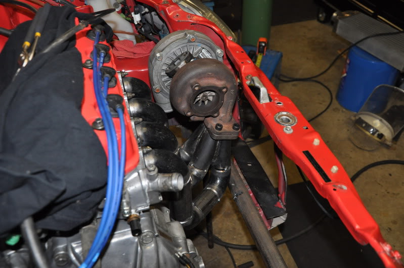

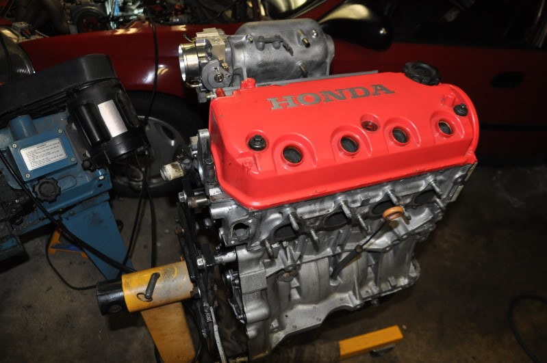

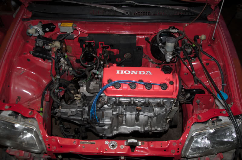

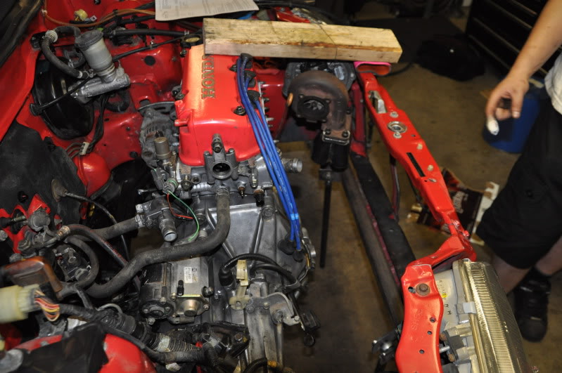

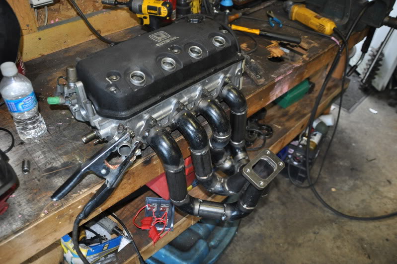

    motor is almost done for the wagon
    75mm vitaras
    ls rods w/arps
    z6 head stock
    dsm 450cc injectors
    farmyard top mount turb manni (in the works)
    still need a turbo and a few other things

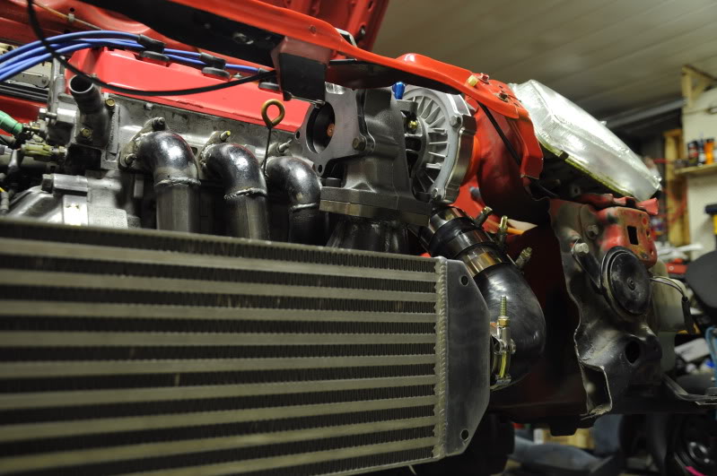

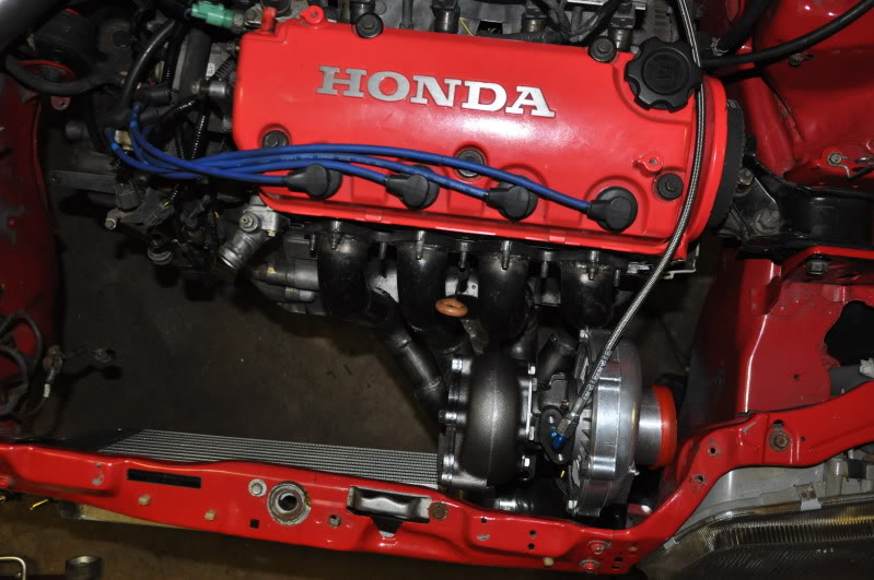

  • DarinDarin Wagonist
    its in.now for the fun stuff like building the turb manny.
