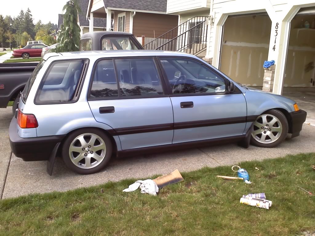

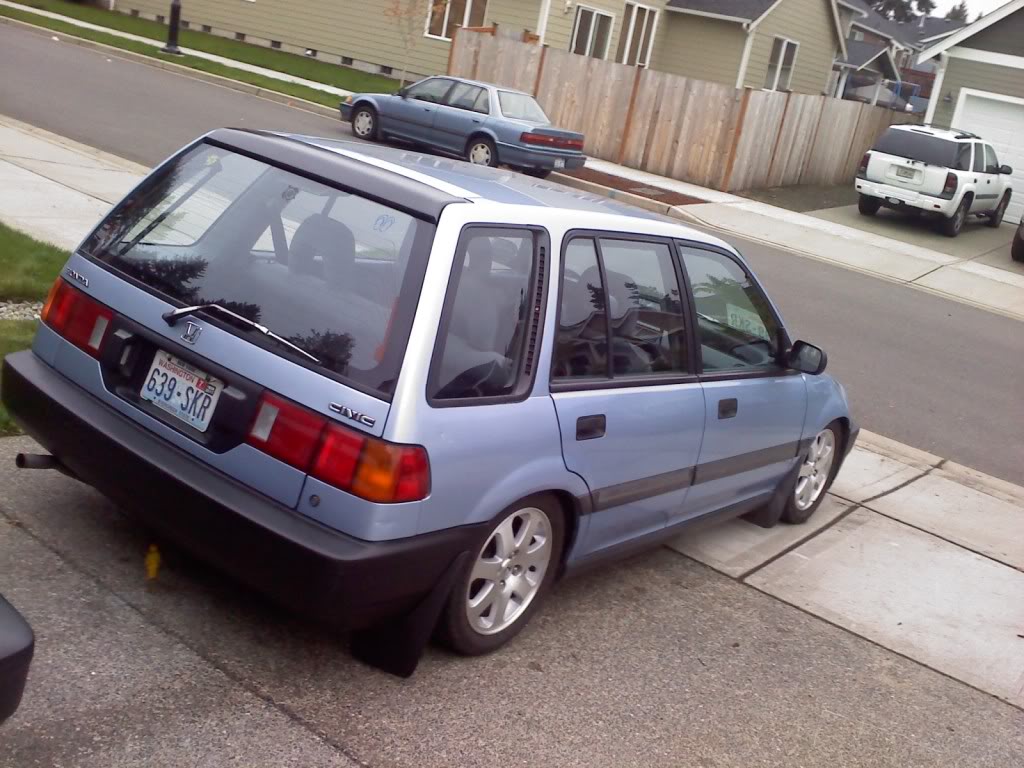

I picked up a stock 1988 wagon today and started going to work, here are a few pictures so far
Dirty
Cleaned up nicely

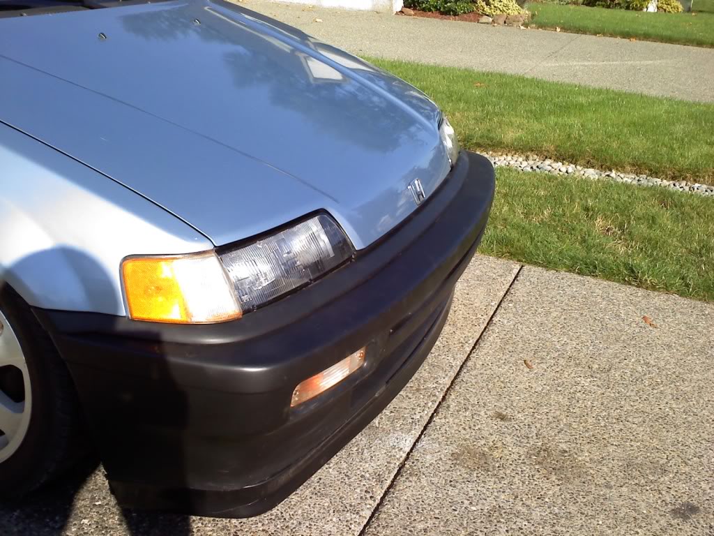

Shaved the plate mounts and painted the bumpers with bumper coating.
1.
2.
3.
4.
5. Ending result I also bought a Volvo lip then sanded, painted, cleared, wet sanded and polished with spray paint.

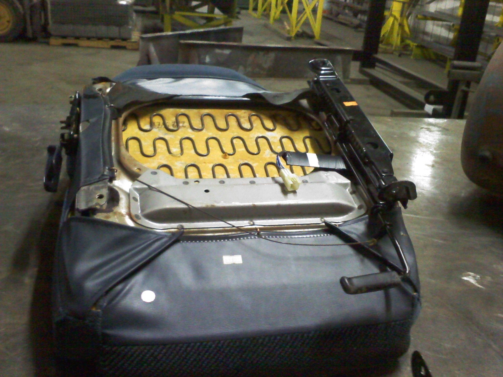

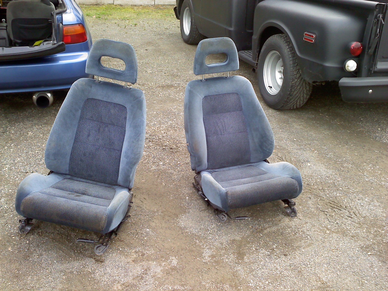

teg seats

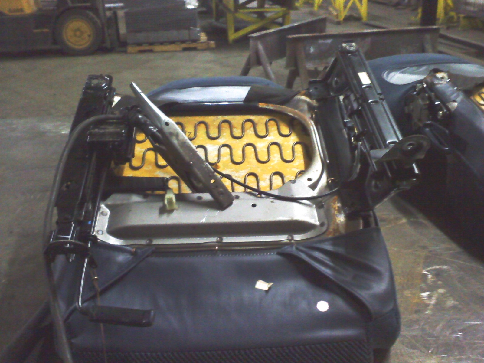

Wagon seat rail.
I took a picture of the wrong side haha sorry! think backwards haha

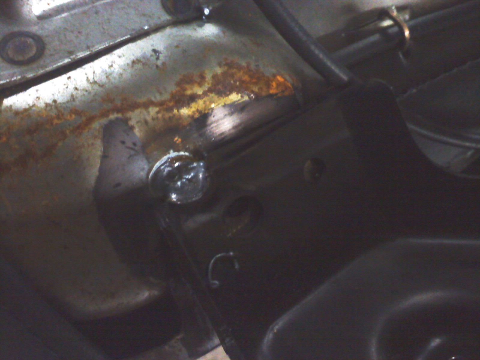

started welding
Wagon rail getting tacked on.
Ending result

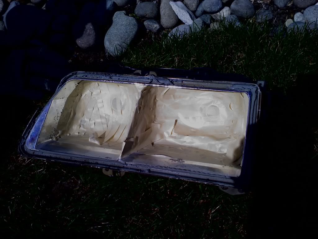

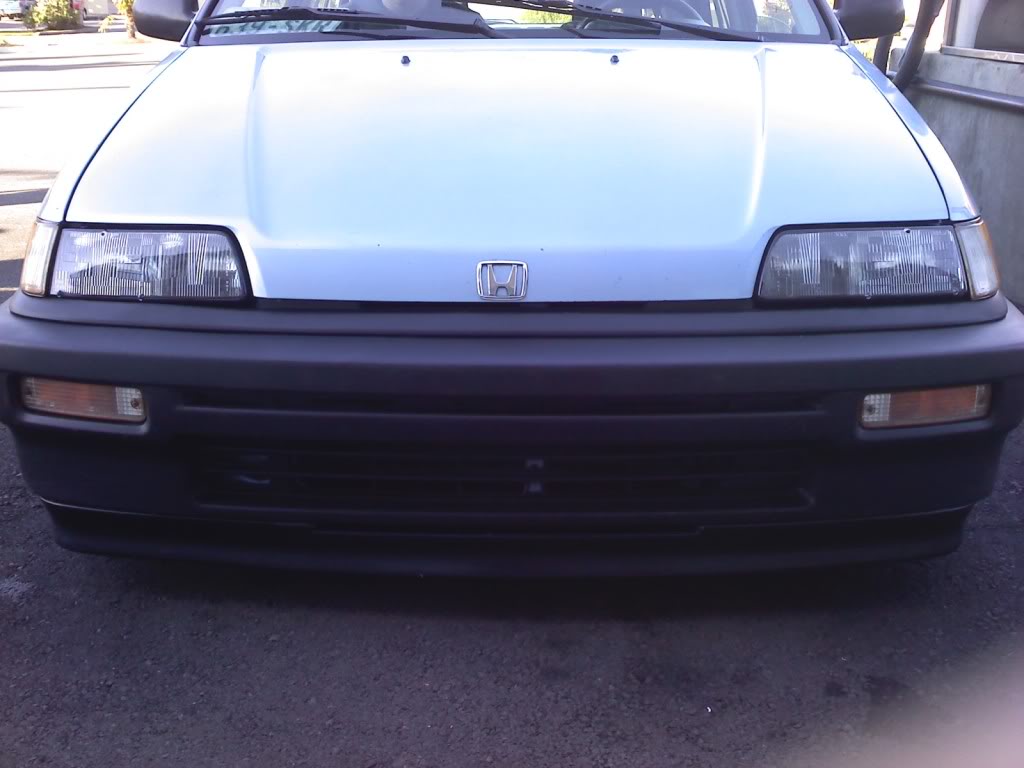

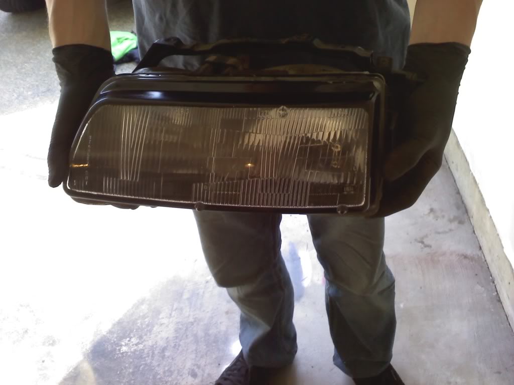

I decided to do black housing headlights on an EF becouse I have never seen it before. So my Buddy brian came over and we do it in like an Hour.

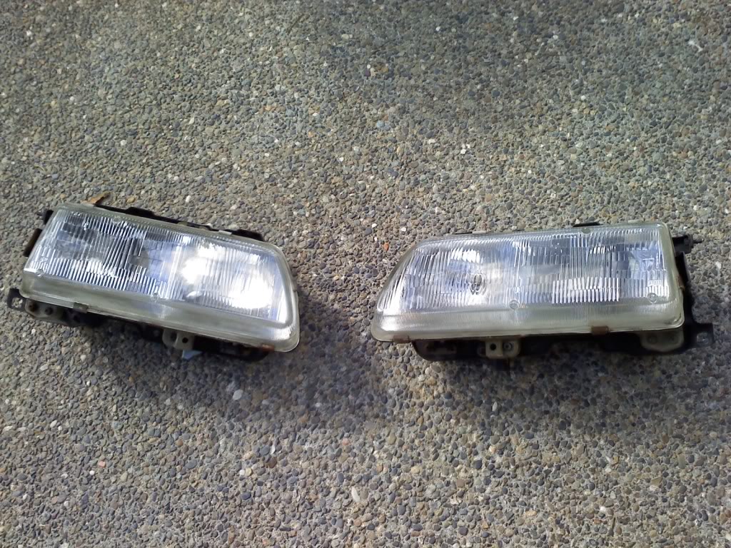

Before (Note that the hood is Popped, Never been Wrecked haha):
Headlights out:

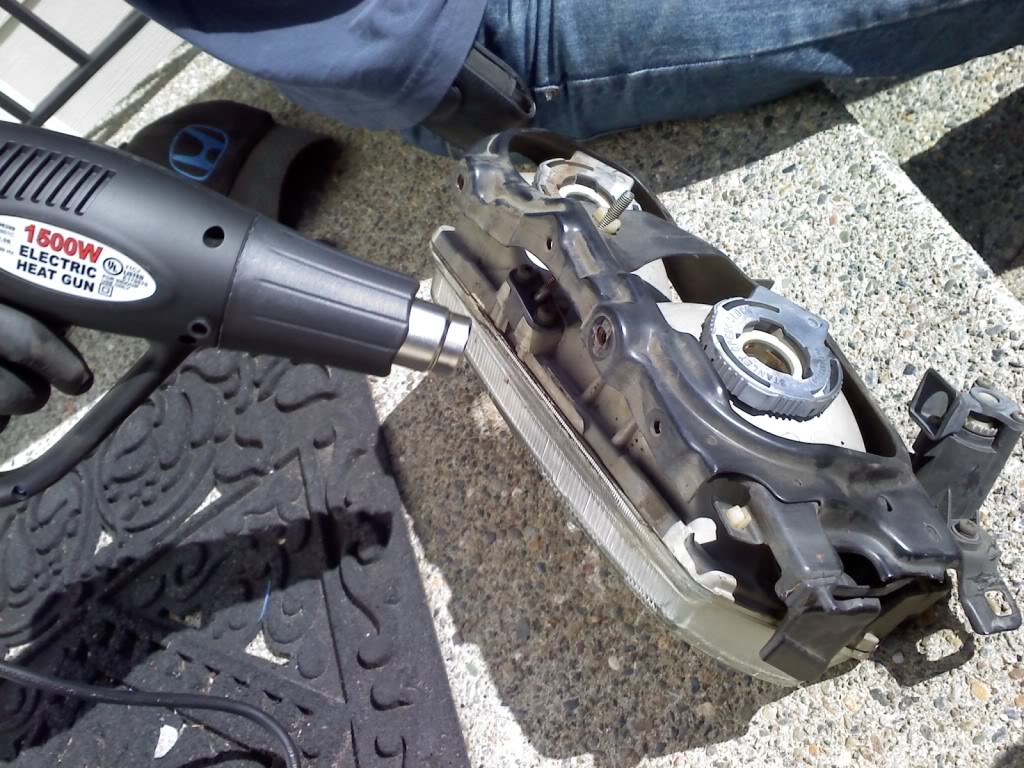

Used a Heat gun to seperate Glass and housing:

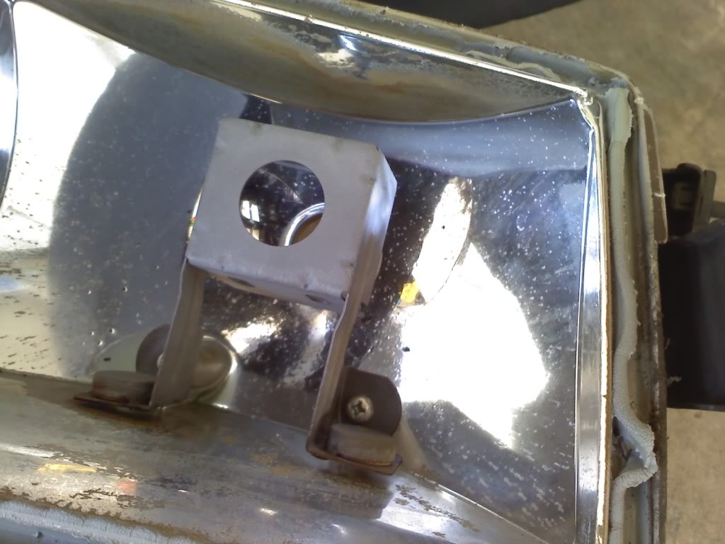

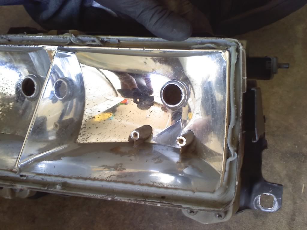

Found this strange box in there, Didn't like it so we took it out, haha (Wee Part):
Much Better:

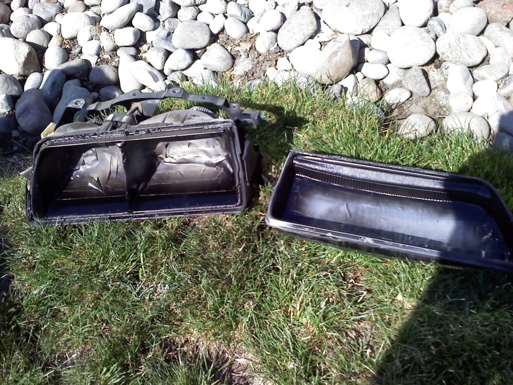

Masking off glass:
Masked Housing:
Both Painted:
Assembled:

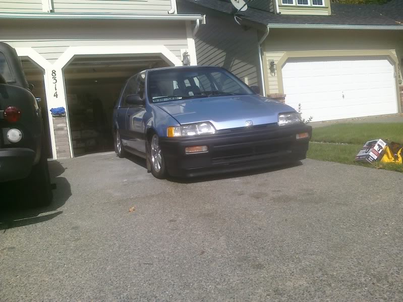

Both Black housing headlights in Wagon:

and also I'm curious how did U take apart the headlight? how did u melt the glue? heat-gun? do tell
Thanks a bunch man I have a ton of parts on the way also and getting a z6 today
I removed the metal clips that hold the glass to the plastic housing with a flat head. (be careful because the glass chips easily) 22 year old lights haha.
Then I took a heat gun and ran it back and worth over the seam. till it got pretty hot (it doesn't take much) then took a flat head screw driver and pried the glass from the housing very slowly (if the glass doesn't come off super easy the glue needs more heat)
What brand of paint did you spray your bumpers? It looks new!
You had me till the head light and corner lights..
Its off of a early to mid 90's volvo.
Thanks man! its a work in progress! I used stuff called bumper coating. you can get it at any parts store
