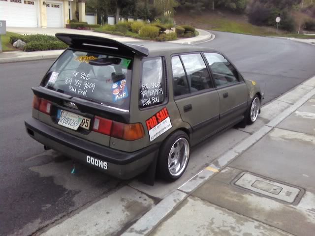

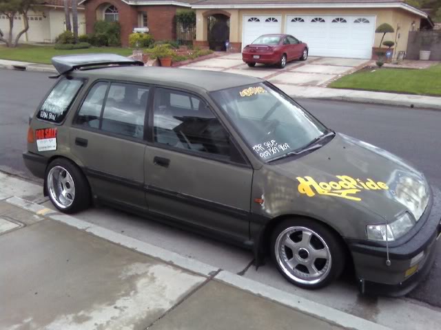

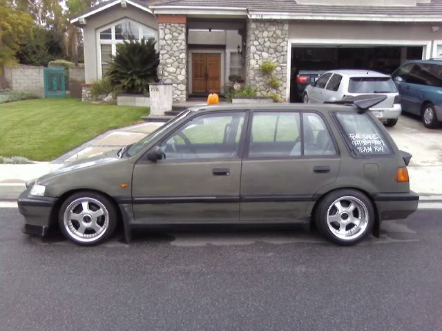

The studs do line up. It's the easiest to use a washer & small metric nut,but I choose to use the OEM Acorn nuts(wider) for a cleaner OEM look.So I had to grind & pound in the Wgn. hatch to clear the nut & socket.I used a flat head punch.It's not that hard.No one sees this area anyway.I touched it up with touch-up paint.NO one notices.

There is NO "unslightly gap".My BAD:If you look at the 5th & 6th pics on the Gray Wgn.There is a ugly gap. :? This was my Prototype spoiler.I had trimmed off too much .My second attempt came out much better. I'll try to get some pics.

None of the Wgn studs were harmed(or removed) in this mod.You do have to cut a 1 1/8" X 4 3/8"(29mm X 111mm) hole into each side ofthe Wgn plastic piece so the EF spoiler will fit thought.That's easy especially with a Makita electic hand grinder.2holes are drilled into the Wgn hatch .The front hole is about 3/8"(10mm) in & the rear one is about 9/32"(7mm).This will vary depending on how you modded the EF spoiler.Hole will be slighly larger than the EF stud.
