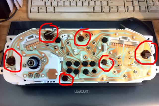

I started by removing the speedometer cluster. After that, I changed the 194/168 regular light bulbs for T10 LEDs. I got them on eBay. Since I am in USA, I bought the ones on United States to get them quicker. You could shop around at your own convenience. They have many different ones but I tried most of them and the best ones were the following (See Picture 1 below):

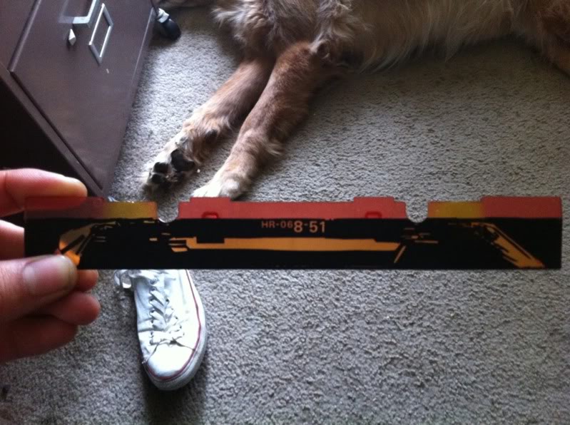

Also, I had to change the speedometer cluster inner top amber needle illuminator panel for a clear blue one from a 1992 Honda Accord one. Of course, it does not fit right up but it would after some modifications. This is a most to give your speedometer cluster a white clean look. Of course, that modification would not be needed if the cluster would have had been changed to hyper amber instead of super white :-) ...

I did not want to change the OEM look in the inside... So I rather went for the LEDs...
Yes, the SIR is a great looking speedometer....
You are right, for some reason, the "unleaded fuel only", "mph", and the "x1000 min" did not change even with the LED upgrade. Now that you mentioned, I will double check if there are separated light bulbs for that part... I will let you know...

Yes, I used 3 of each one. Please note that I ordered some light bulbs from sellers outside of the USA and they took almost a month to get it. So please take that in consideration when placing an order.
Yes, I agreed... However, what I think that gave the cluster that clean look was that change on the needle ilumination upper panel from orange (original one) to blue one (from a 1993 Honda Accord)...

I want to make my tach, speedo and gas/temp gauges green, purple and orange respectively. But I'm concerned about heat and the fact that I can't get a hold of any hyper or single bulb purple LED's. After all, I don't want to burn out my bulbs constantly or start a fire by burning the plastic in the cluster.
I have not felt any temperature change in my dash... They are not hot at all. These LED burned quickly though. I have two burned LEDs now. I may have bought very cheap ones.... I do not know... Do not worry about heat.... :-)

Okay, I understand. In my case, I changed the whole upper part for a clear blue one from a 1992 Honda Accord one. Of course, it does not fit right up but it would after some modifications. This is a most to give your speedometer cluster a white clean look. Of course, that modification would not be needed if the cluster would have had been changed to hyper amber instead of super white!!
LOL, it is not a problem. I am glad that I could actually help. Yes, that strip was the one I changed for the 92 Accord. I cut it up nicely to make fit.
Since the 92 Accord strip is slightly blue, I used the same factory bulbs to light up the needles. So, I did not use a different bulb for those. I used the same factory light bulbs.
