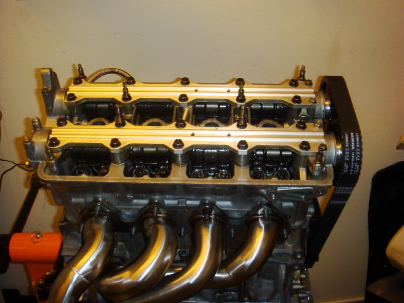

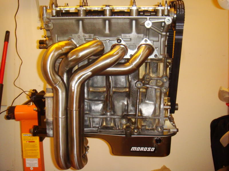

My B20 vtec build
Current parts

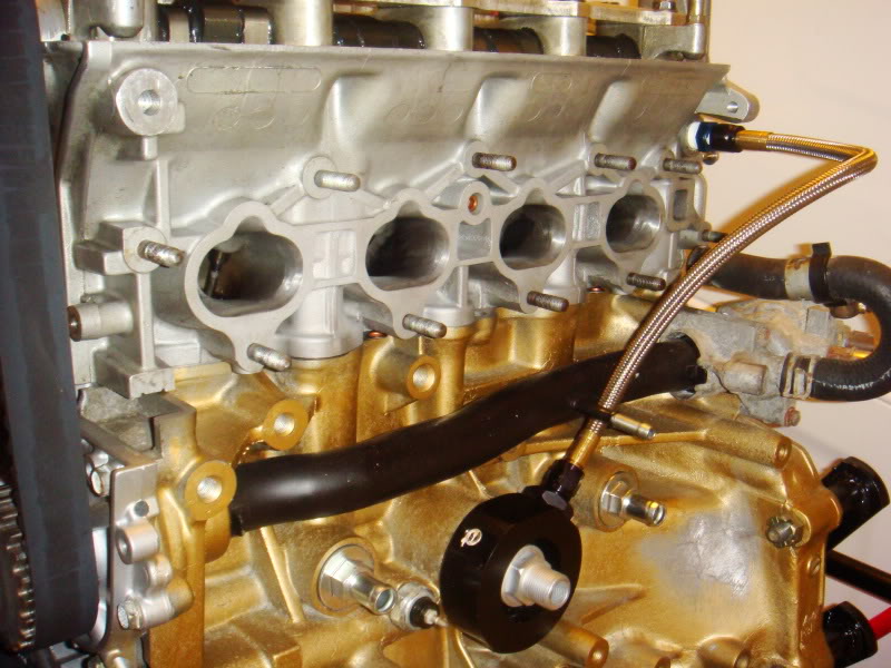

ON B20 Block: je pistons 12.5cr, H-beam eagle rods, ITR oil pump, ITR water pump, Moroso oil pan, golden eagle oil filter b20vtec adapter
ON b16 Head: port and polish/5 angle valve job by portflow, Crower-dual valve springs, retainers, valve seats, and titanium valves,
Bump sticks: Buddy club spec 4's
The Car: 1991 Honda Civic Wagon (EE civic)
My Goals: To have a quick little daily wagon that I can take to the track on the weekend and have fun with. Shooting for >230-240whp. It will have a/c, and no ps.
Parts Needed: 440 injectors, 255lph fuel pump, Hy-Tech big tube header, 70mm throttle body, clutch and TUNING.

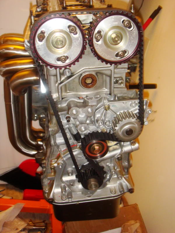

AEM cam gears came in today and just bought a skunk2 pro series intake manifold and a hondata IM gasket.

    Which version RMF header are you going with?
  • kidd racing rmf narrow so that I will have ground clearance.

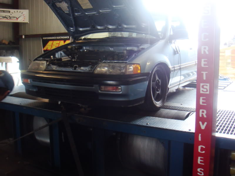

  • I have had some bad luck, the buddy club 4's have such big vtec lobes that they bottom out the LMA's which caused the belt to slip and bending a few valves. I have new valves in and the rocker arm tab was ground down about 1/8 of a inch to keep from bottoming out again. The tune was moved to THIS Saturday.
    I also decided to do a DUAL tune, one tune will be for 93octane and the second tune will be for Q16 (is highly oxygenated, 3-5% more power than C16, 116 octane fuels).
    The Q16 tune will yield about 20whp gain and in a N/A car you will feel it. I am HOPING for about 230-240 on 93oct and 250-260 on Q16.
