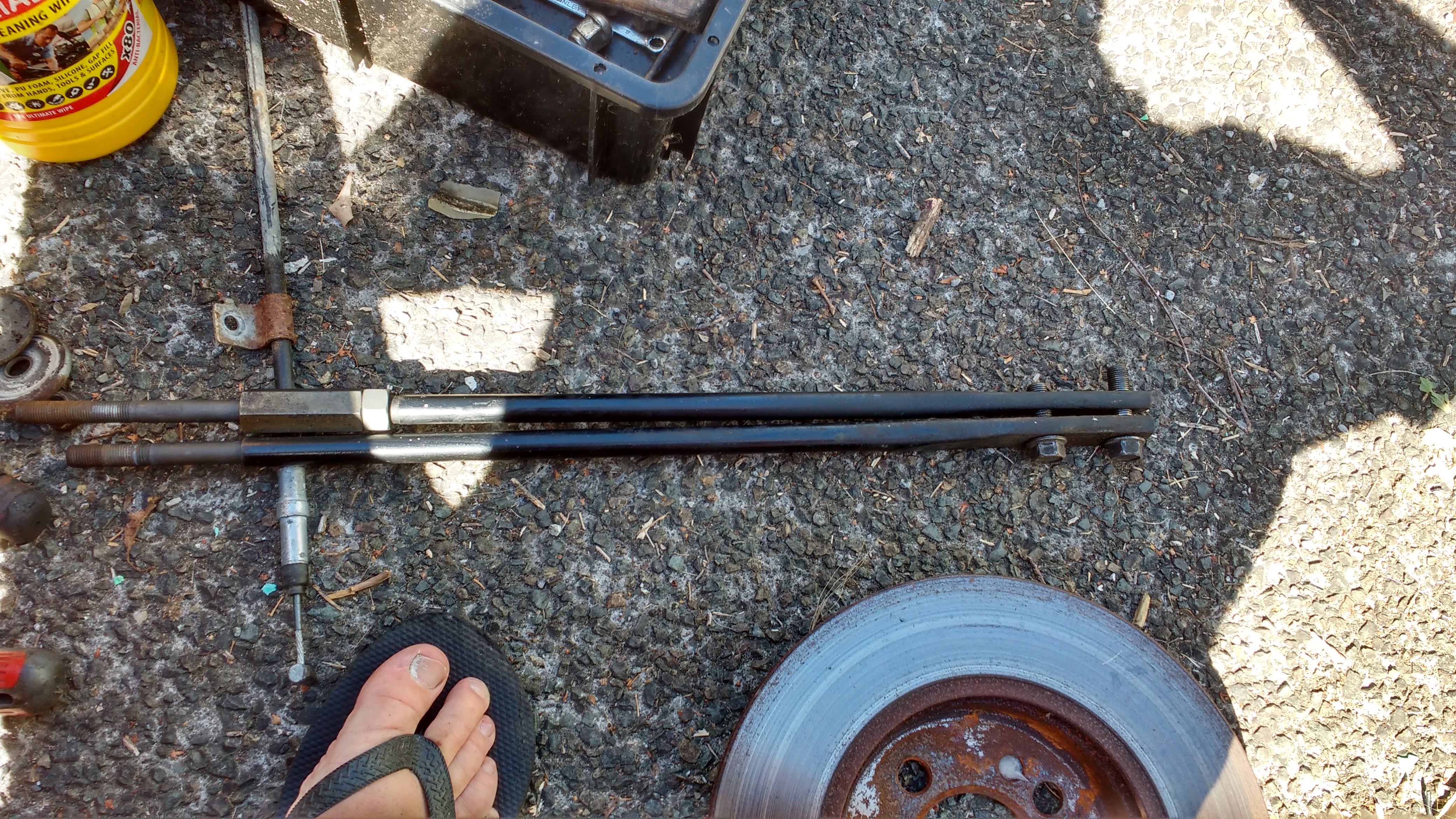

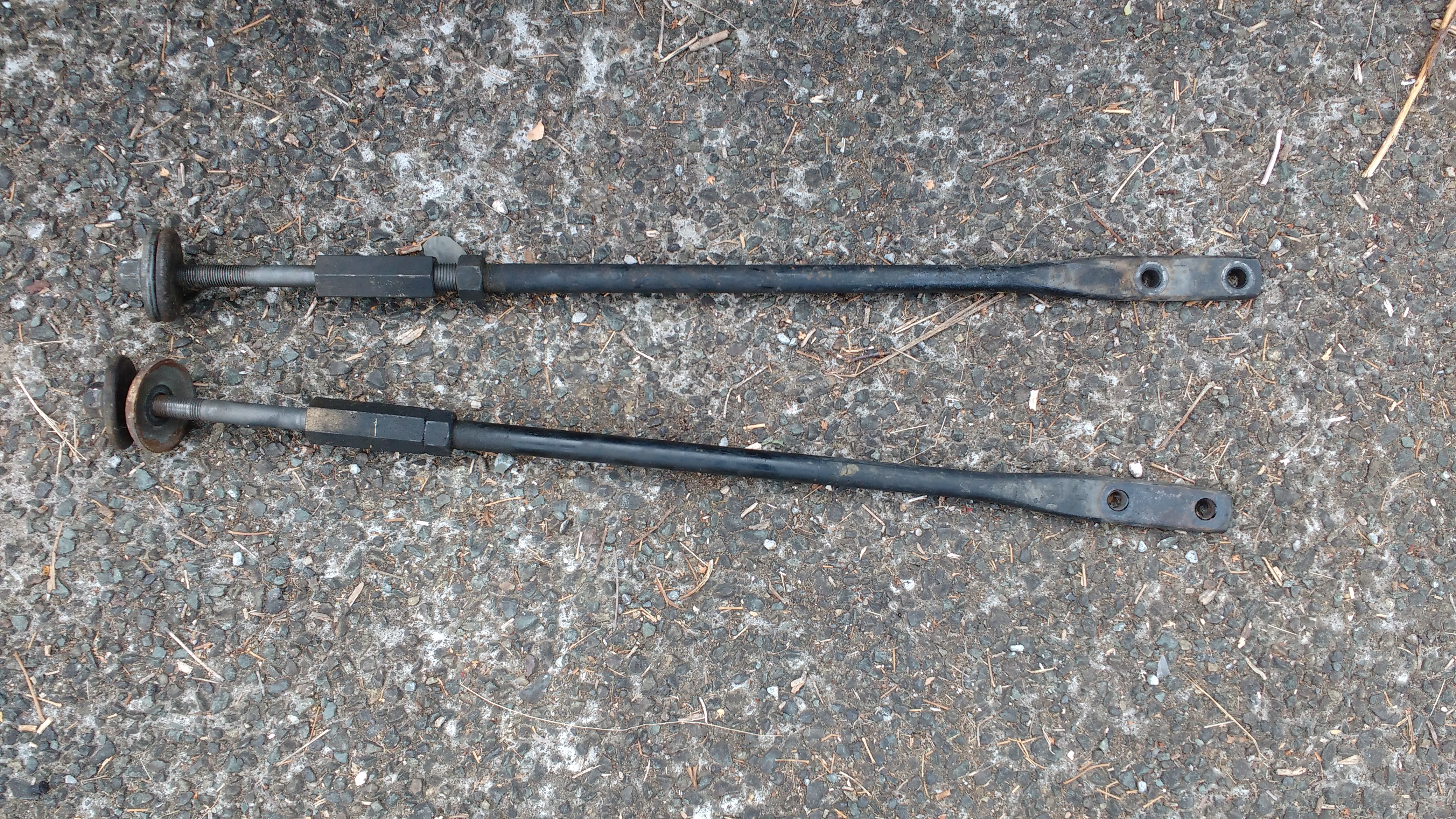

Here is a pic the 3g accord radius arms. Just need to drill the bolt holes so it fits the ef lca

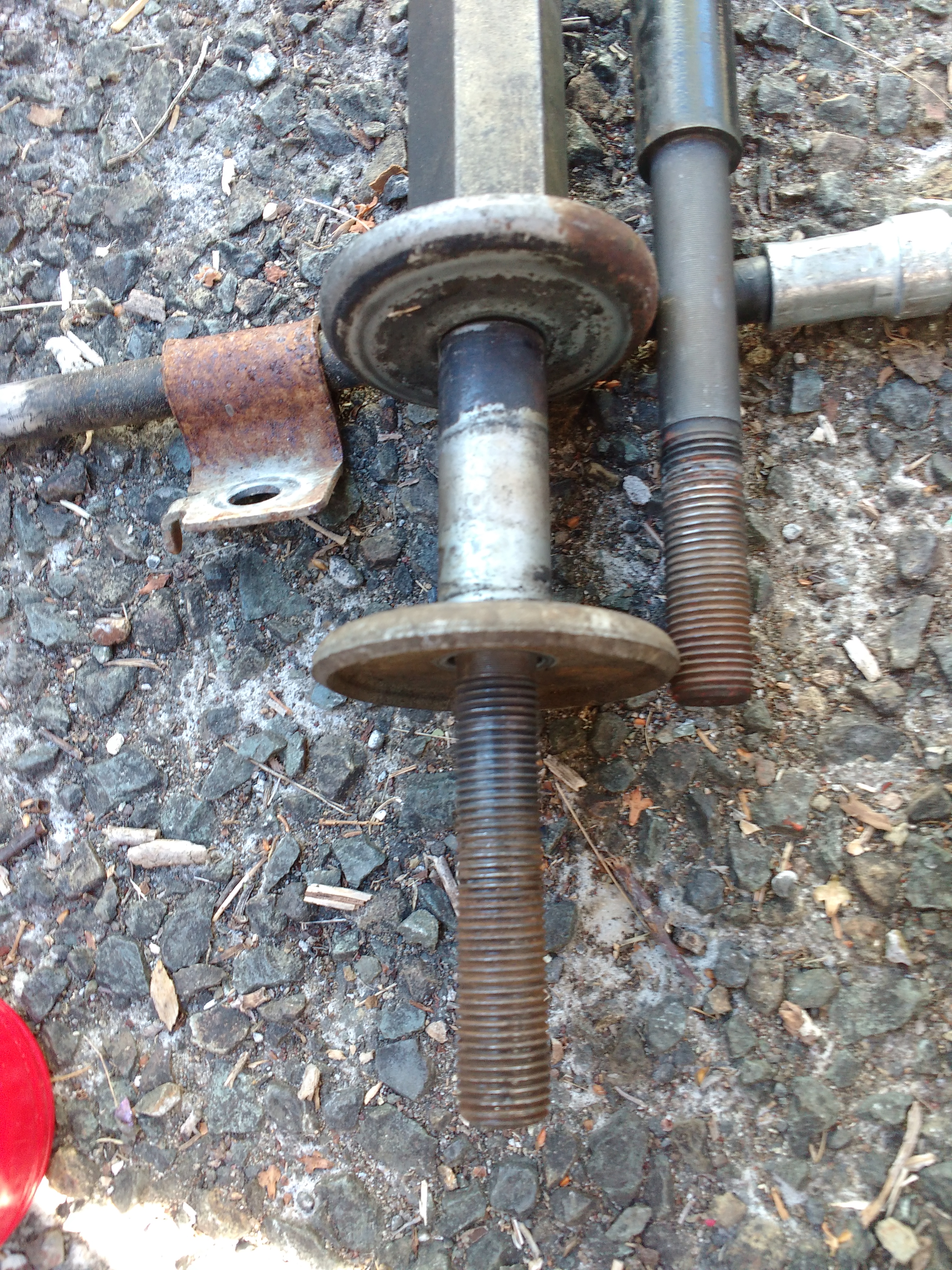

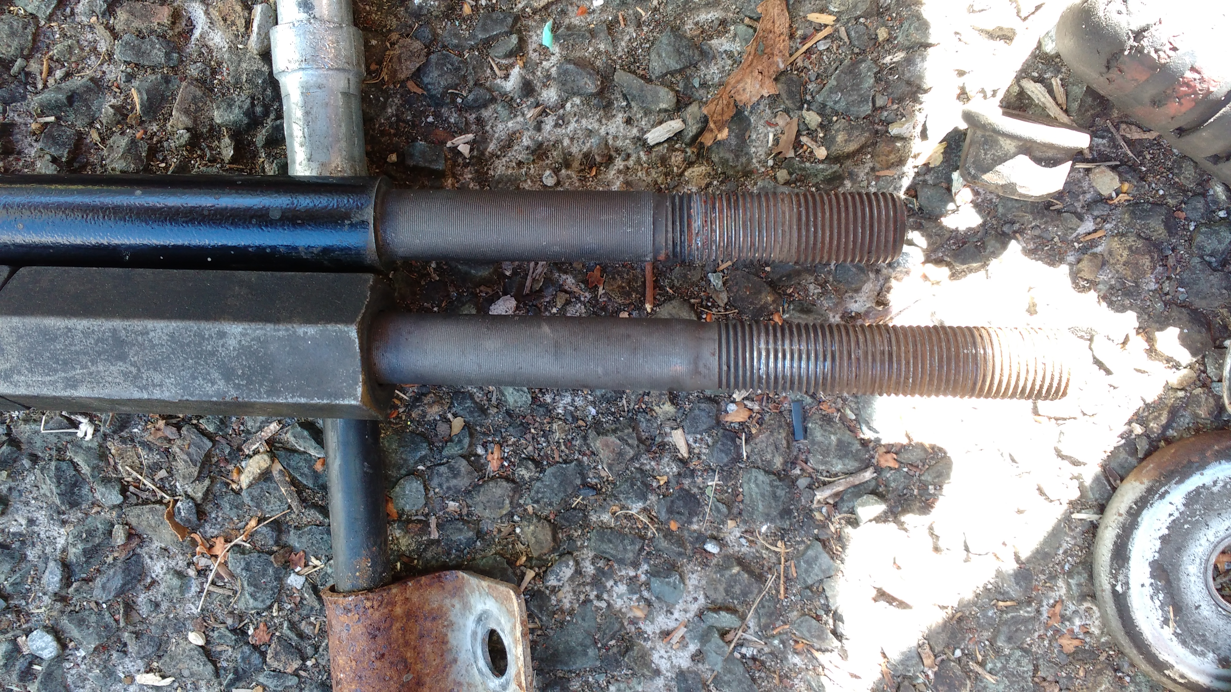

The accord radius arms look like the will work nicely. It look like I may have to extend the thread for the lock nut as the accord thread ends sooner than the ef. A rough option could be using some washers
Edit: now that I put the crush tube and retaining washes in I'll probably get away with only using a washer
