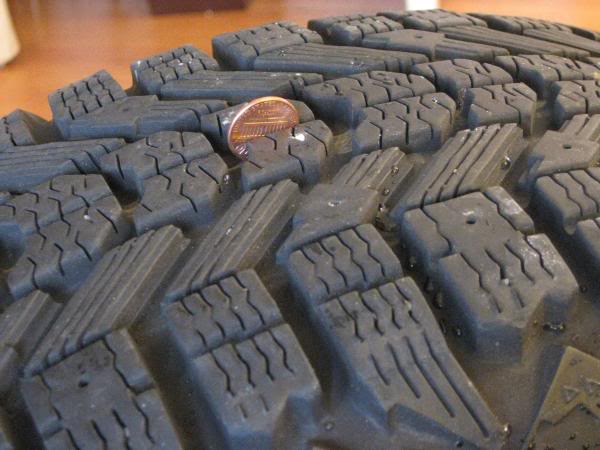

  • i am actually currently looking into some tires right now haha. bridgestone winterforce tires are "off road" tires...
    they come in a ton of sizes.
