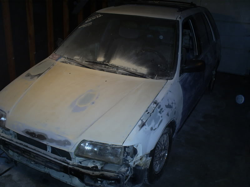

7-8 ****done with body work****
the last thing i need to do is swap out fenders and then bam! ready for primer here are the pics i took right now more to come when there is day light.
under a month on the body work
here are some pics form today pushed her out in the sun to take a few pics
