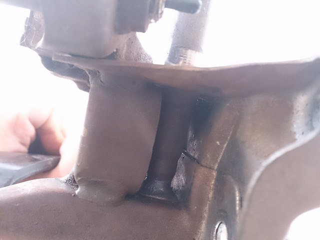

    this is where they eventually snap...
    the red dots are bolts that need removing. and of course all the cables connected to each pedal.

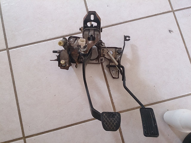

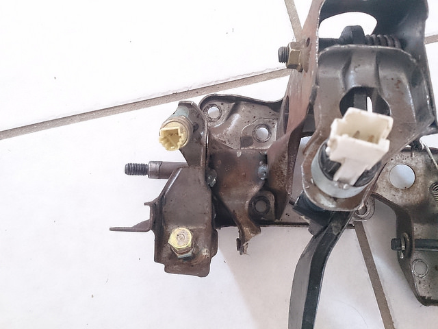

    So, I've been reading this thread for a couple days trying to figure out my clutch issue. The picture quarters posted never made sense to me, I could never actually see this part. I pulled the pedal this morning and I still don't see it, upon further inspection I suspect I don't have the same pedal assembly. I have a plate or bracket, whatever you want to call it for the return spring.
    Everything seems to be intact. What's the deal? I've got roughly 320,000 miles on this guy, I'm suspecting it may have been replaced already. I've read elsewhere that someone installed a 91 CRX assembly? I'll get pictures soon.
    Since it's out I feel I may as well reinforce it, I just need to know where. I found a thread but links no longer work and pictures are no longer available! Thanks

    if the stamp code imprinted on the metal says sh5 its wagon specific
  • HaydzHaydz Moderator
    That set appears to have been hit with a bit of weld in the weak area.

    Thanks for the responses you guys. I ended up just reinstalling it last night anyways since I needed the wagon for today.
    I can't remember what the stamp was, I believe it was SH5. It does kinda look like there's been some work done in the area that typically breaks.
    Well it was a pain in the butt to do but I at least fully understand what to look for and I have an idea on why it would break. I also lubed up the clutch cable and clutch pedal meeting points, as well as the cable/transmission lever thingamabob.
