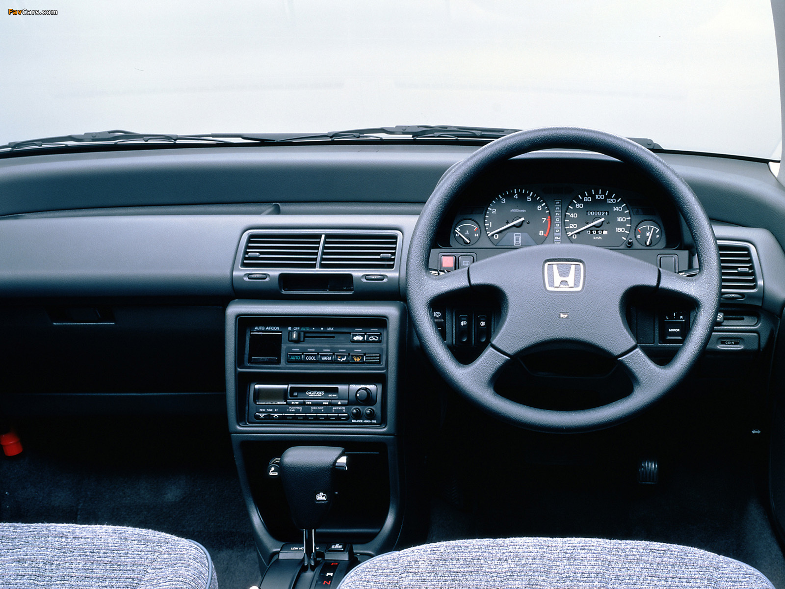

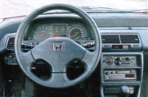

    The lower console is shaped so the driver position has more legroom.
    Let me search a pic for clearing up my poor English:
    JDM/UKDM/NZDM/AUSDM/RHD_DM
    People who drive on the right side of the road.
    As you can see, one side is "straight", the other is slightly curving.
