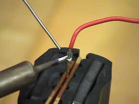

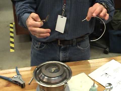

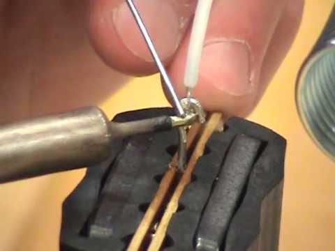

So with regard to soldering technique, I highly recommend reviewing these videos. This guy is a NASA certified instructor and while the cameraman is a hack you get a good idea of what's going on and how to produce a very clean reliable solder joint. One thing that I really like about this technique is how two wires are soldered together. They do not twist them together depending on the spec. They tin both wires and then touch them side by side and solder them together as such. This allows for a good solid joint that if needed can be disassembled quickly. If you have your wires twisted and then solder, if you ever have to take that connection apart for any reason you're likely going to be cutting out the joint.

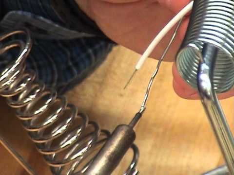

In the below one he does do the twist method and shows how to do it to achieve the best result, this is with thinner gauge wire though (22ga) so this method may not work for heavier gauge. It, like the other methods, involves tinning the wires fully before you connect them to each other.
*EXPERT LEVEL* Solder Splice Tutorial TTC Avionics
