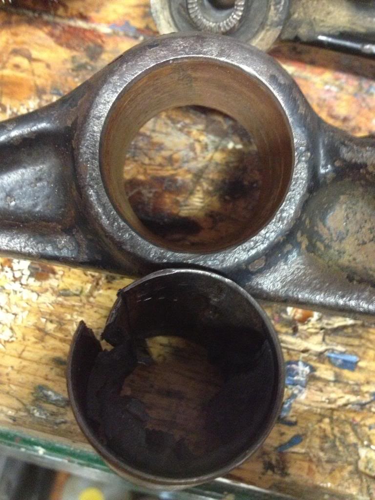

    So i got sick and tired trying to get the old bushings out, i decided to get new LCA's from rock auto. The old LCA were beat up and soo ugly..

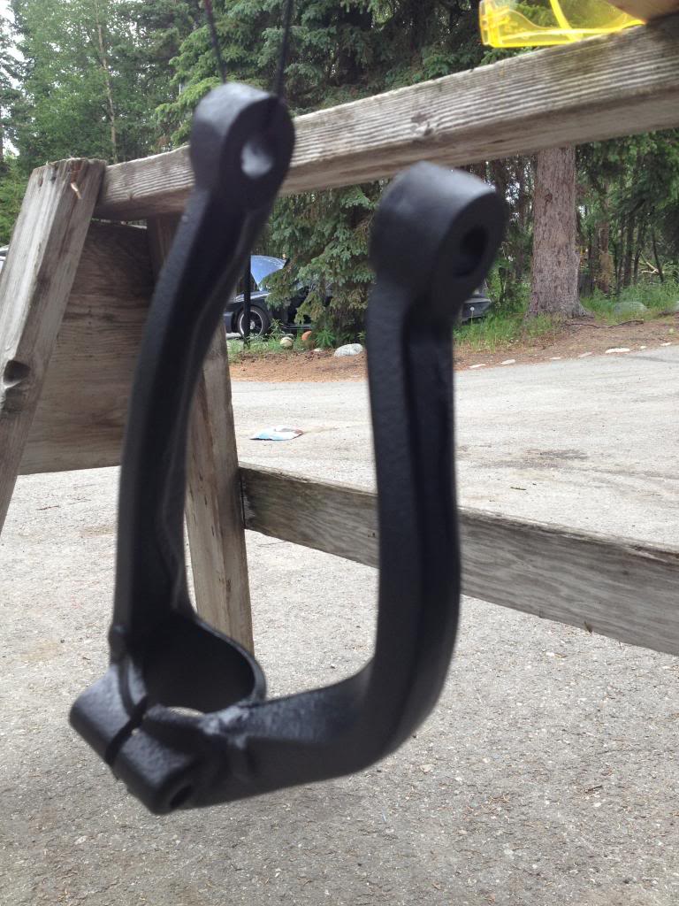

    Painted my forks matte black, the rust protectant spray paint looks good!

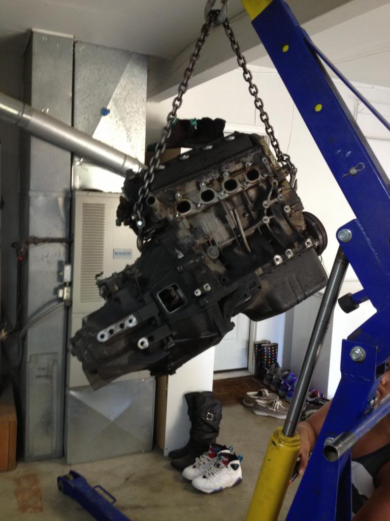

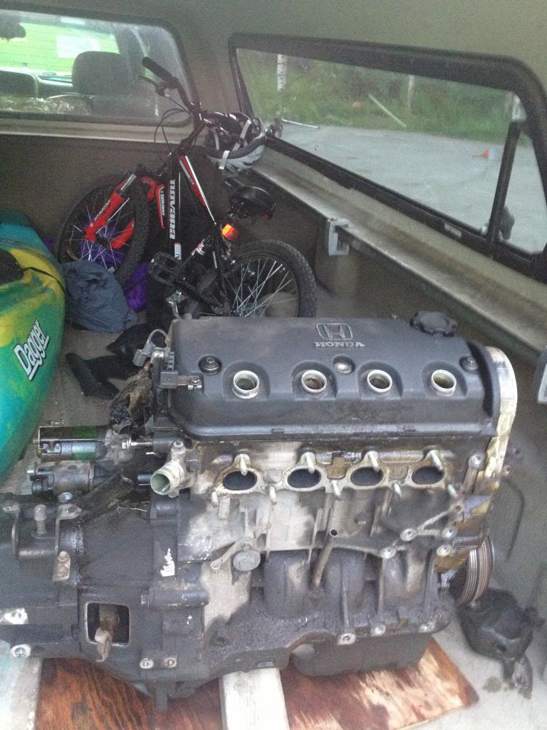

    ANDD for the big finally! I got a D16Z6 engine with tranny for 80 bucks! It knocks though.. I have to replace the rod bearings.. but im most likely going to build the whole engine top to bottom.. then slap a turbo on it... will start the processes this summer but will most likely try to finish it next summer..

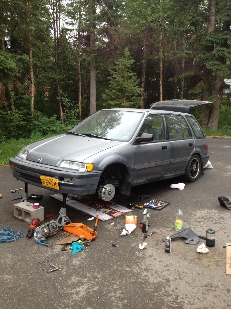

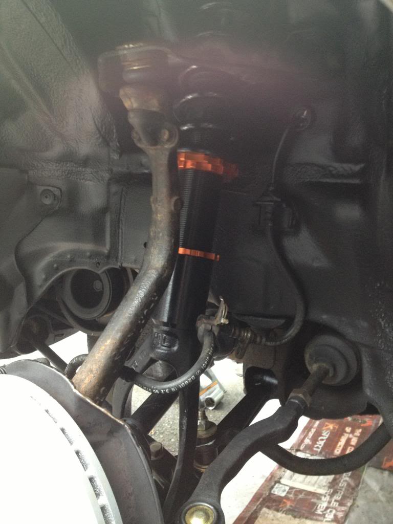

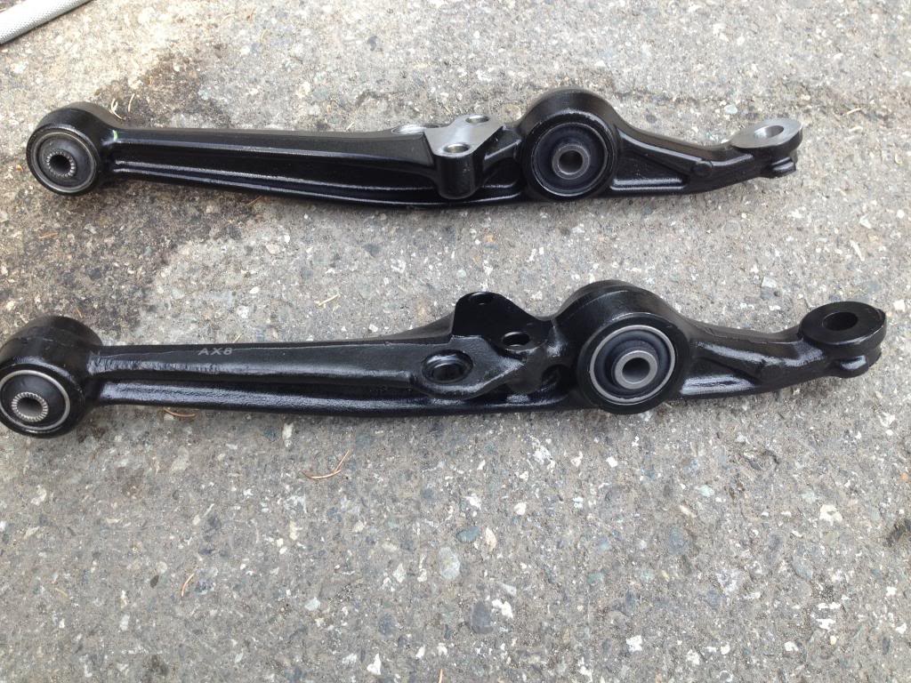

    so i have everything to put the front end back together now... i got the LCA in the mail and they arnt the same!! they are totally different LCA.. different style bushings and looks.. but ehhh F'it...

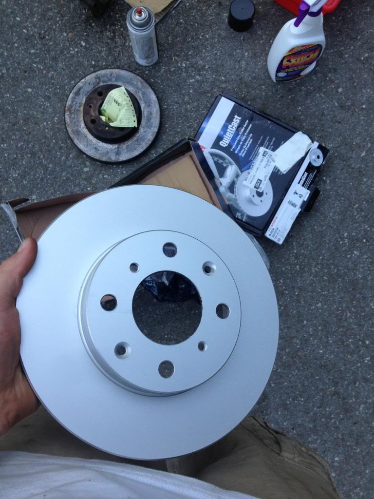

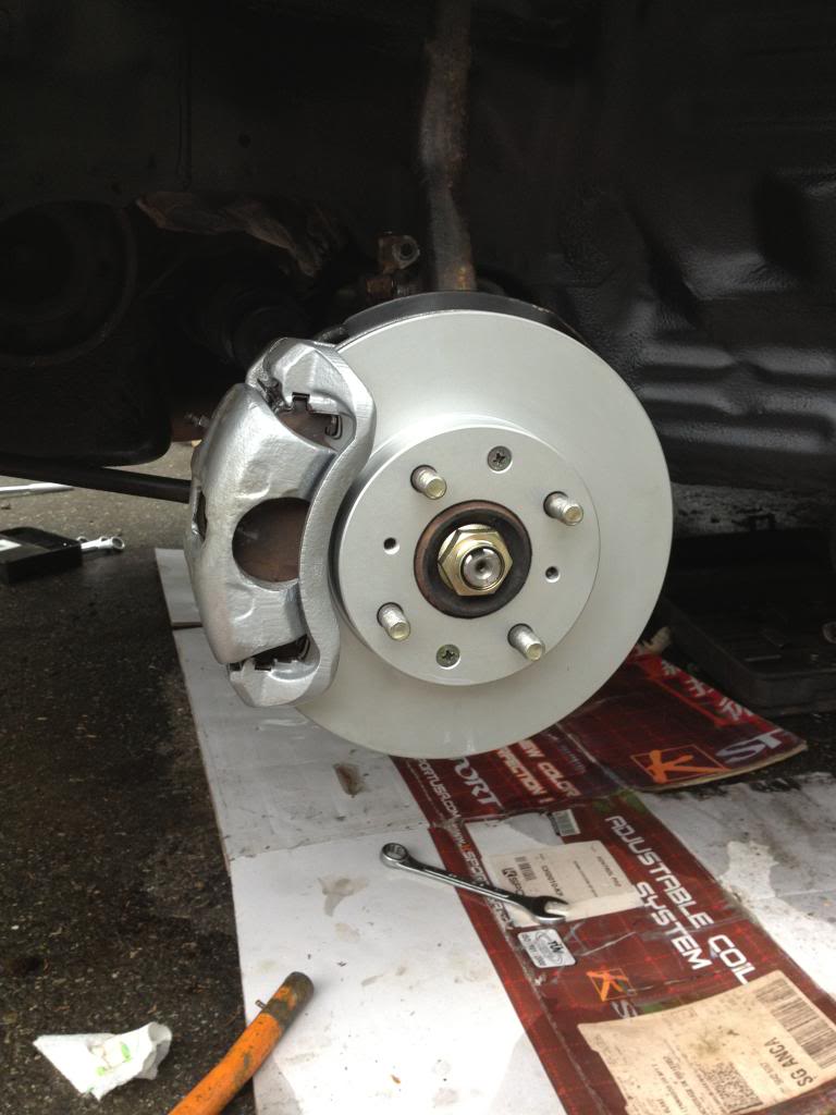

    AND i got new rotors :)

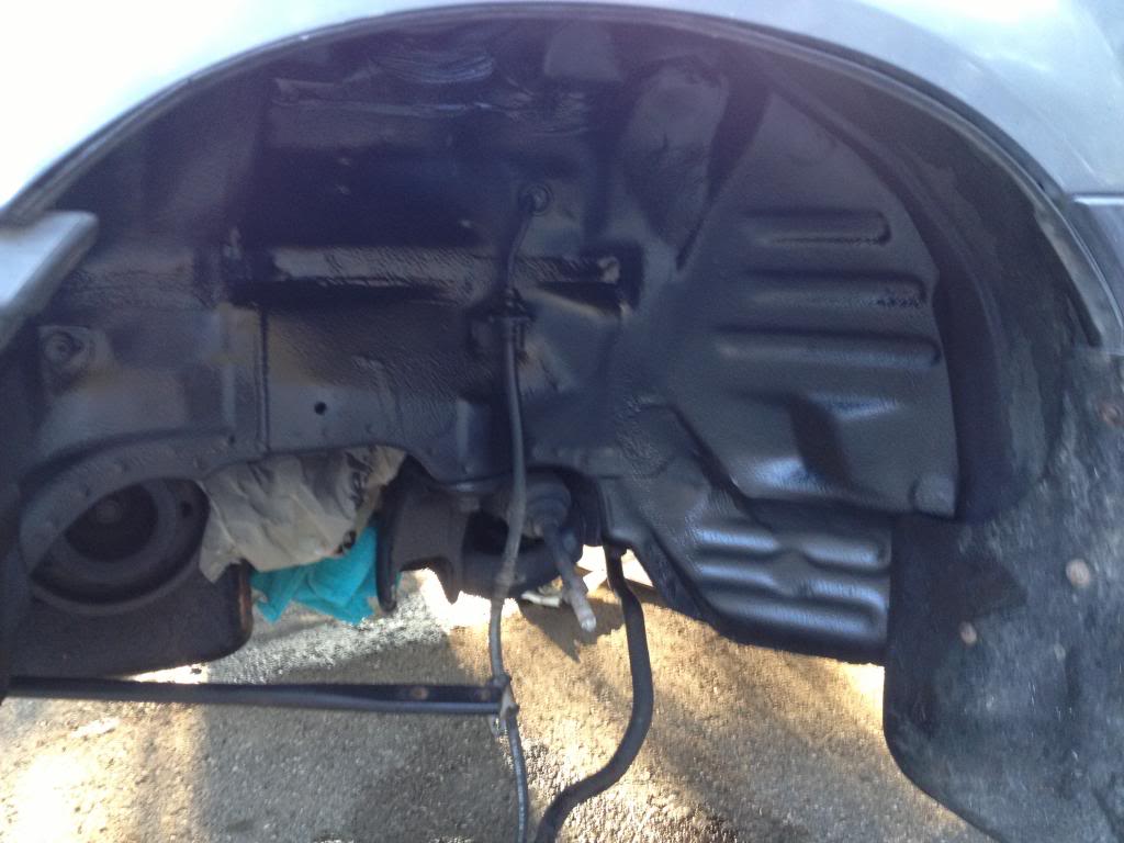

    I started right after work and got most of the prep work done.. I cleaned the fender wells a shit ton more... tried to get all the dirt and grime off.. then painted them..

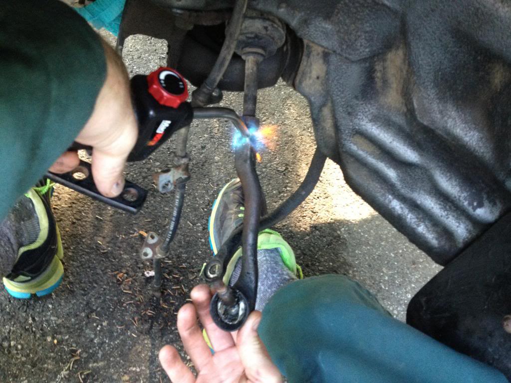

    The tie rod ends were soo stuck same with the locking bolt... so i youtubed and a guy heated the bitch up with a torch and it came loose.. so thats what i did.. had my dad help with this one.. it finally came loose.. thankkk god! haha

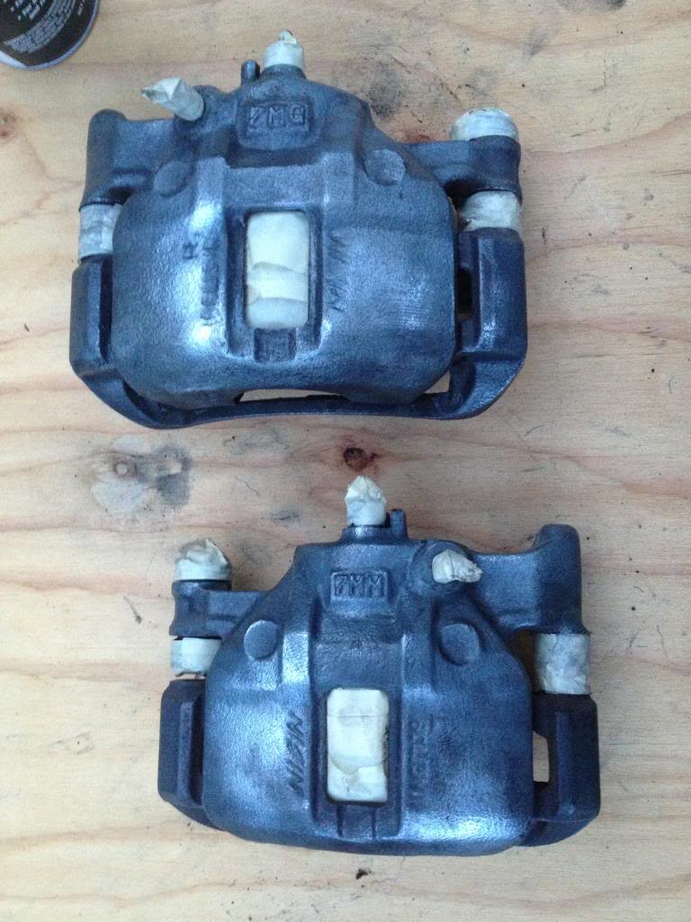

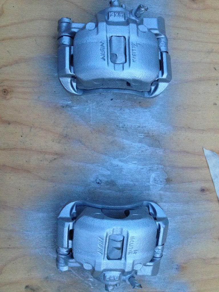

    now it was time to clean the brakes... I went to the store and got some PURP degreaser and went to town with a wire brush and a wire wheel.. shit turned out spiffy!
    Still gotta put everything back together and tear into the back end.. but i need to get some poly urethane for the back differential mount..
    i still need new engine mounts.. it seems like every piece of rubber on the wagon is torn or horribly worn....
  • SWAGOVAN_AKSWAGOVAN_AK Band Wagon

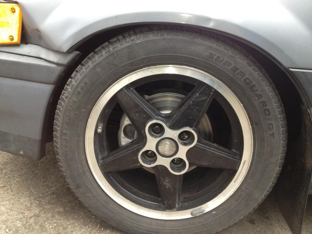

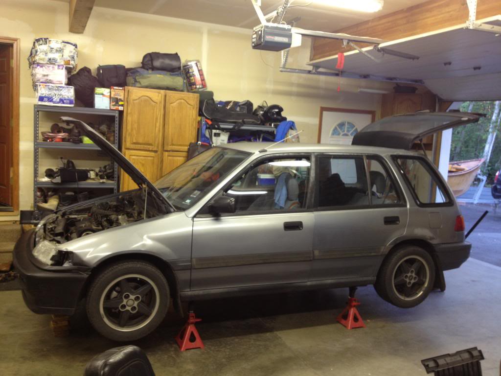

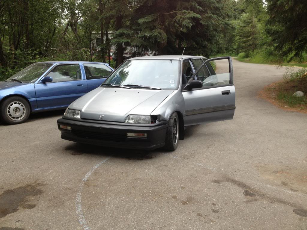

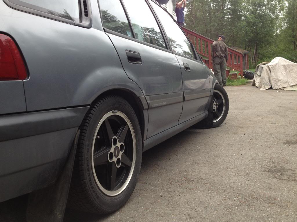

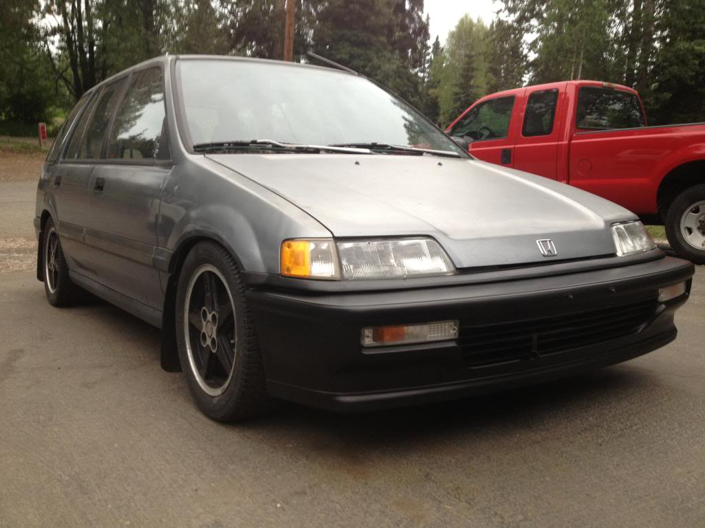

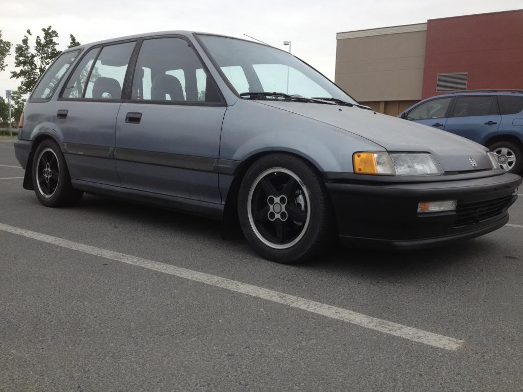

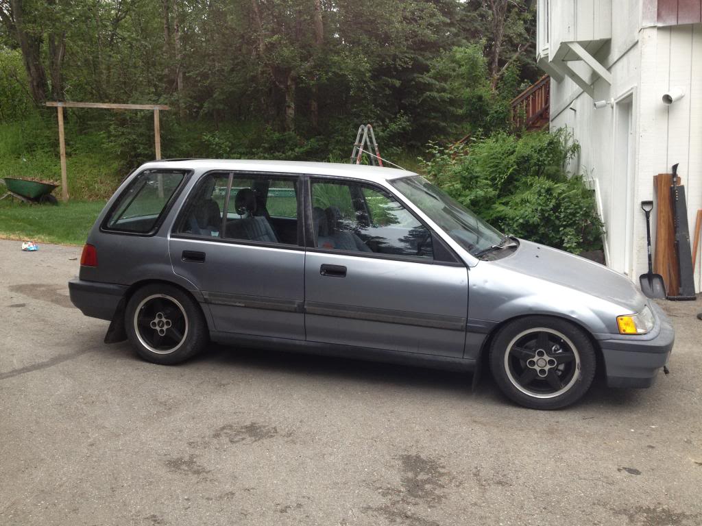

    Shes on the ground and sittin' purrrttyyy! :) the coils are as low as they go and i can say that im pretty please with the height.. i say its just right..
    RUBS!! ahhh have to fix asap..
    now just fix the back end and get an alignment! but im going to try to fix the bumper this weekend and swap out the headlights.

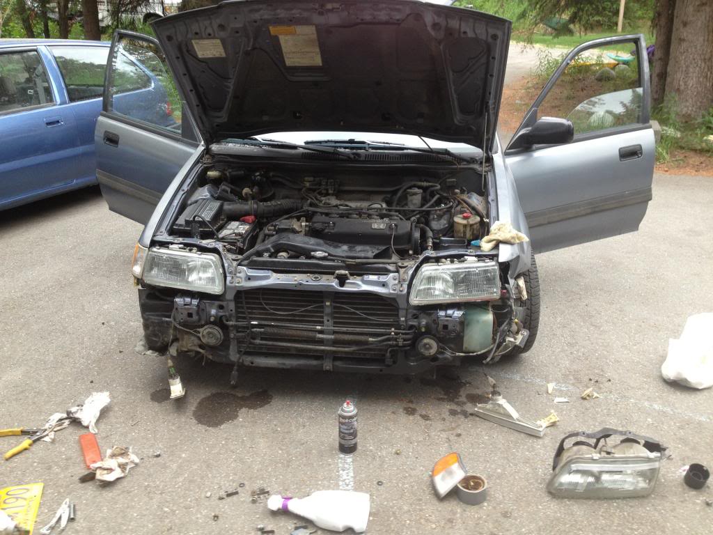

    tore into the bumper today to fix my rubbing problem... the bumper frame was dented in from the front end collision...
    dented side
    non dented
    i searched around and found a guy with a sedan bumper, freshened it up with a few cots of duplicolor trim spray paint. Got two heavy coats on the lip and bumper after a quick scotchbrite and a tac rag, and it turned out very nice! and i replaced my headlights with crystal clear ones while i was at it. :)

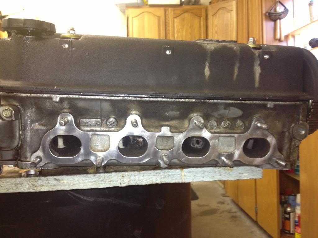

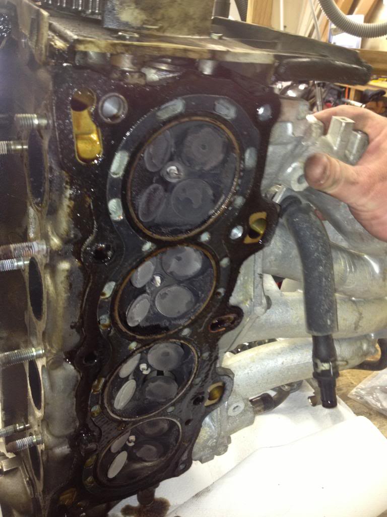

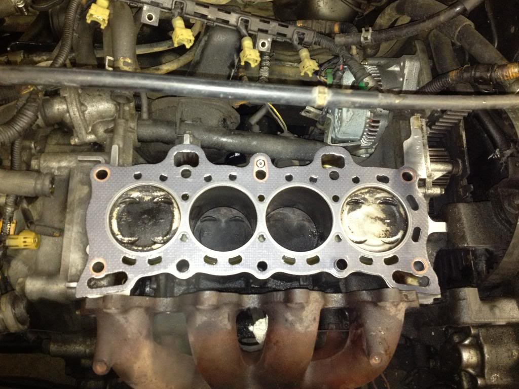

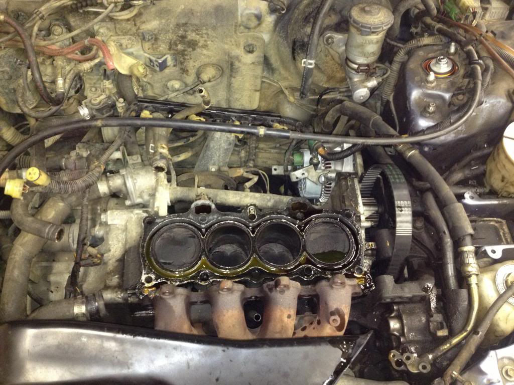

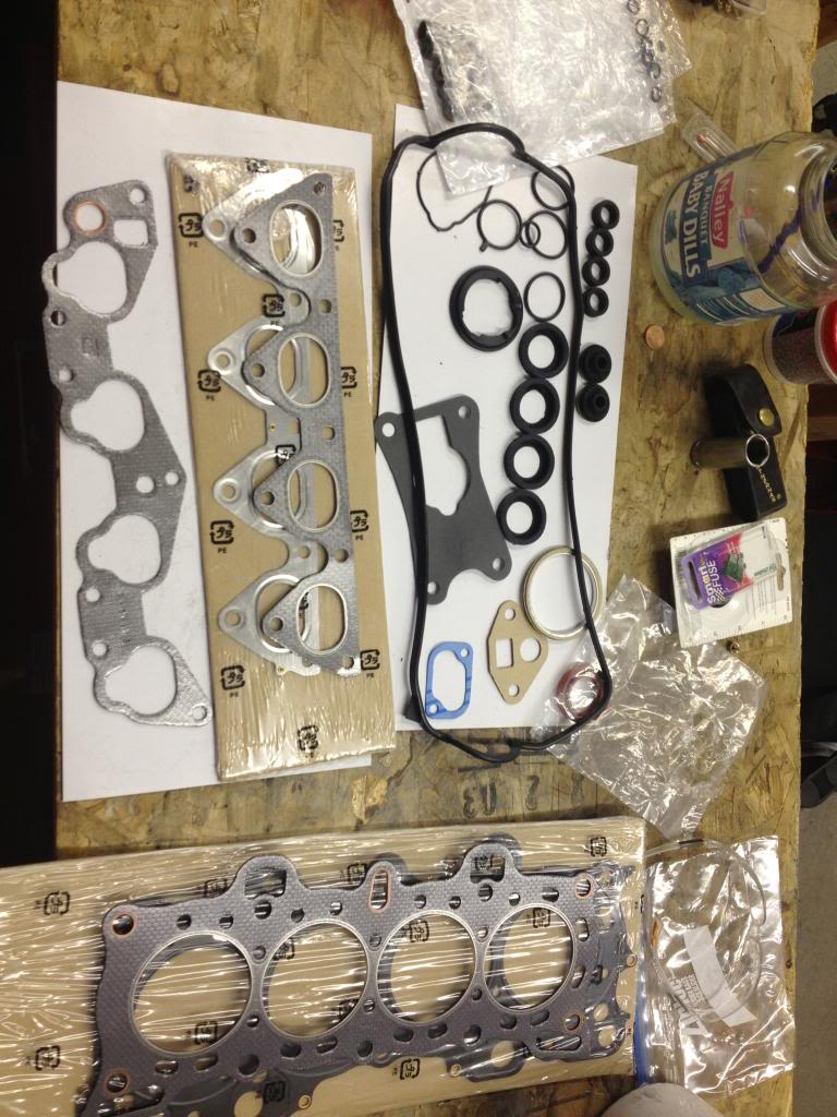

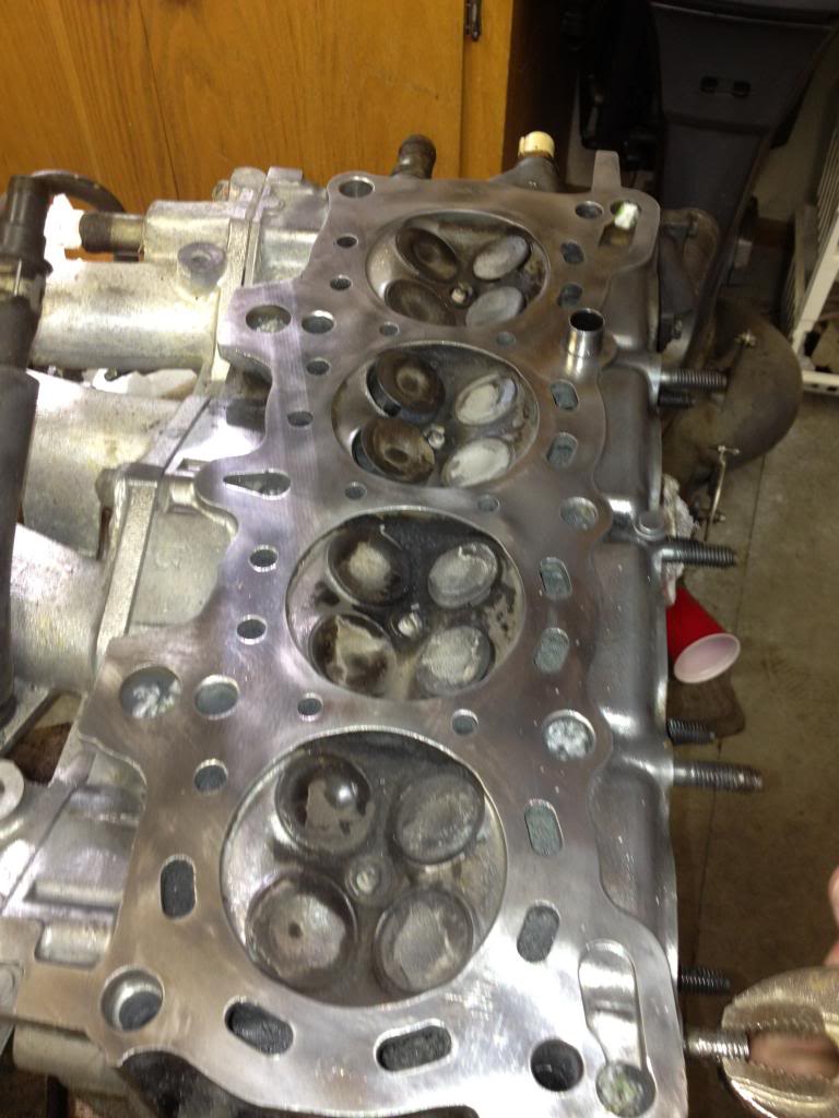

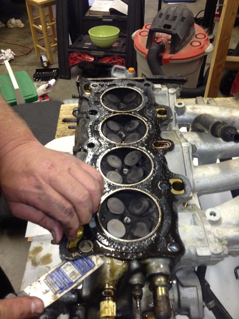

    It all started about a few weeks ago.. the wagon started to blow out plumes of smoke, not that bad but it made me worried... so i checked my spark plugs and i had oil in the 3rd chamber.. this led me to believe that this is why my car is burning oil, or it may be a bigger problem.. so i bought a head gasket rebuild from oriellys and went to town! BTW this was my first time ever taking a head off of a car, and it turned out swell!!
    I bought a Y8 head gasket from the honda dealer, i looked it up to see if it could work on an A6 and i got the gist that you could use it... but when i placed it up to the A6 it was totally different.. so i returned to damn expensive headgasket and went with the one in the gasket kit..
    TDC, marked it..

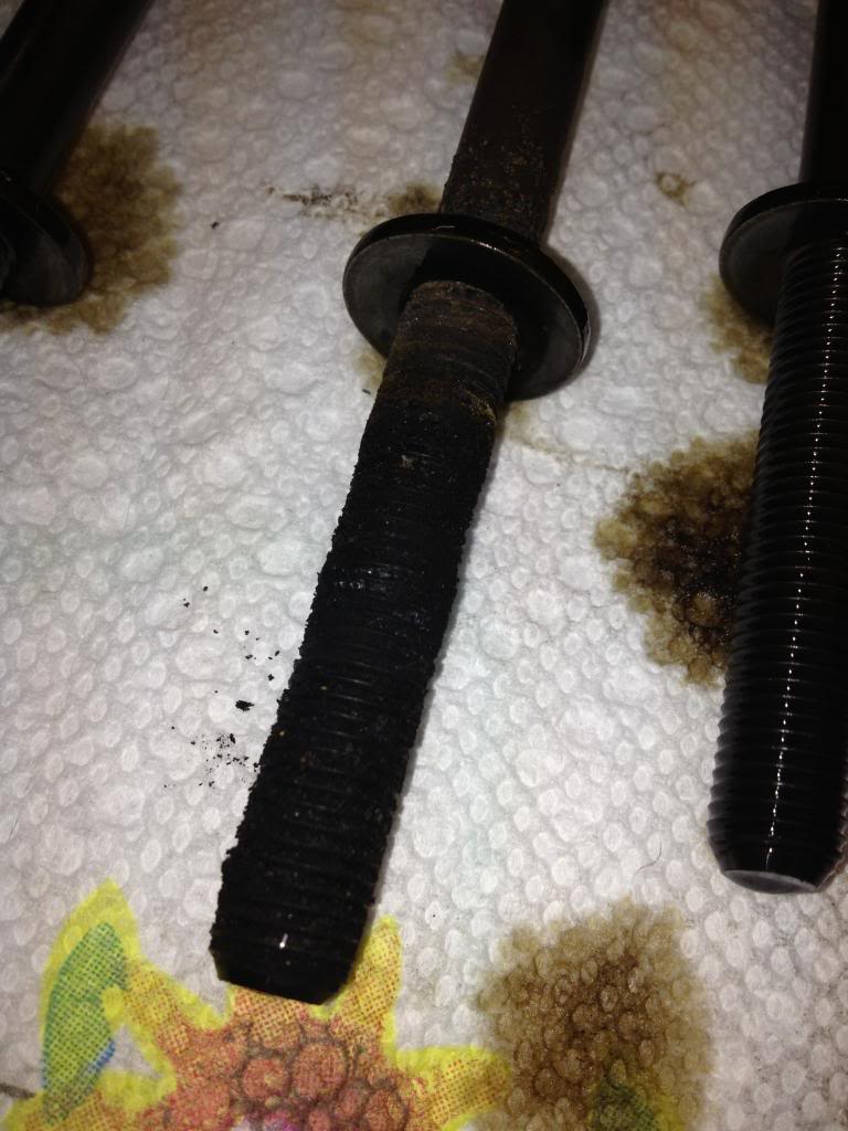

    CRustyy ass head bolt
    the old head gasket was a bitch to get off.. it was caked on there.
    after some good time of a wire wheel, i stripped off all the gasket and made sure i didnt damage the head to much.. and i tested to see if the head was warped or not... it tested out to be fine!

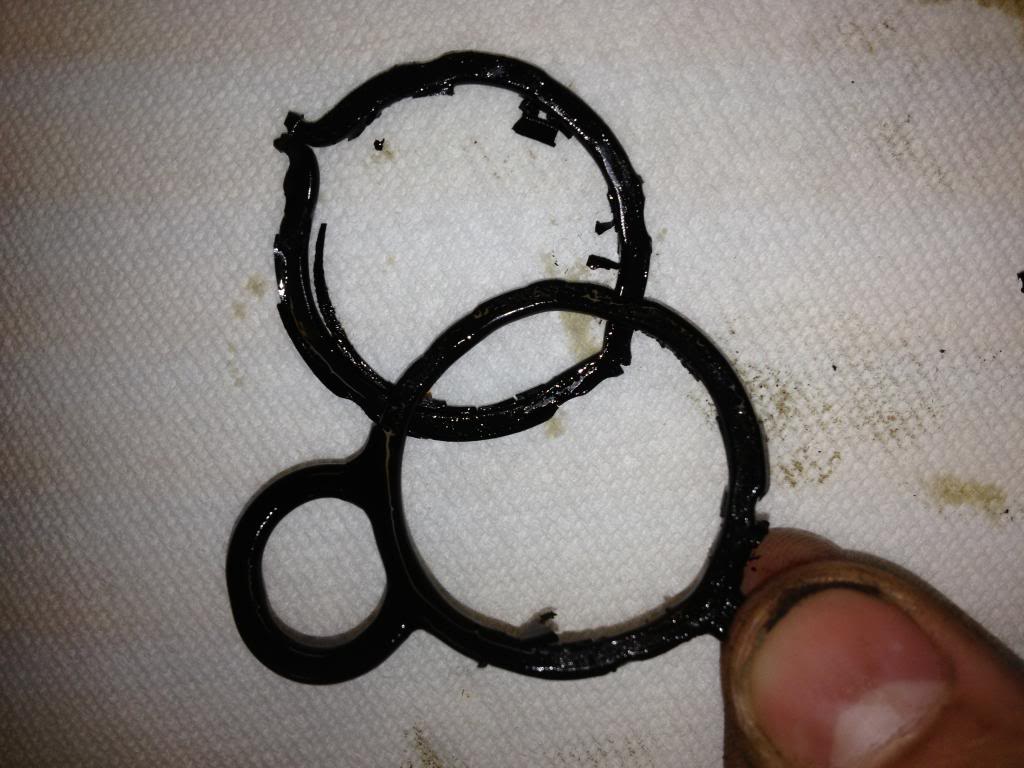

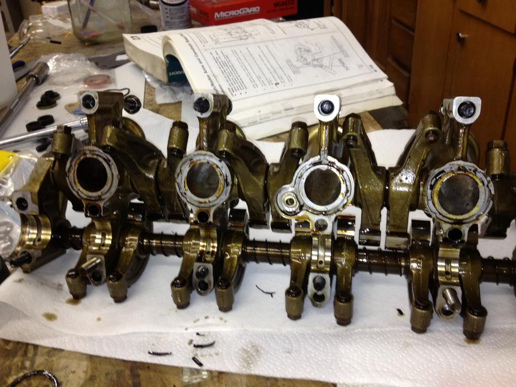

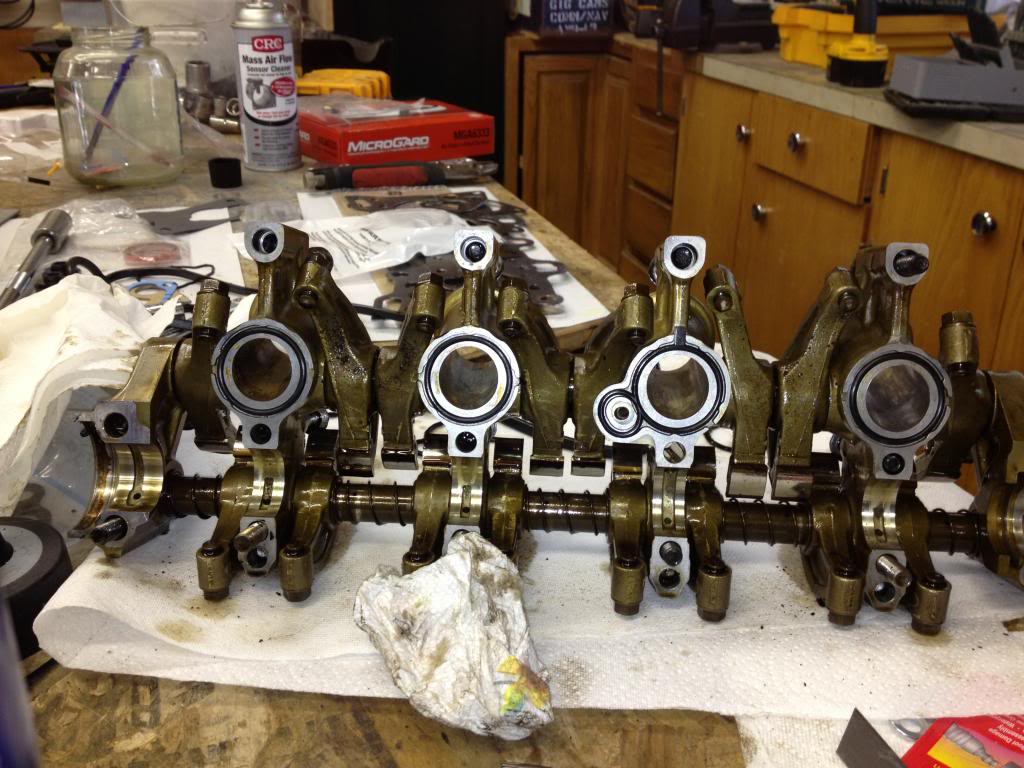

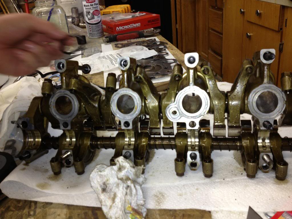

    so the head gasket was in good shape.. it wasn't leaking.. so my next thought was that the bottom O rings on the spark plug cylinders were shot... and they were shot for sure...
    657.jpg[/URL}
    Nastyy..
    the new O rings fitted!

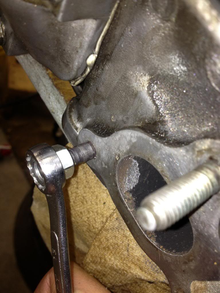

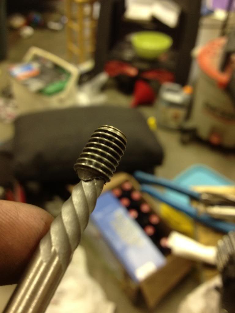

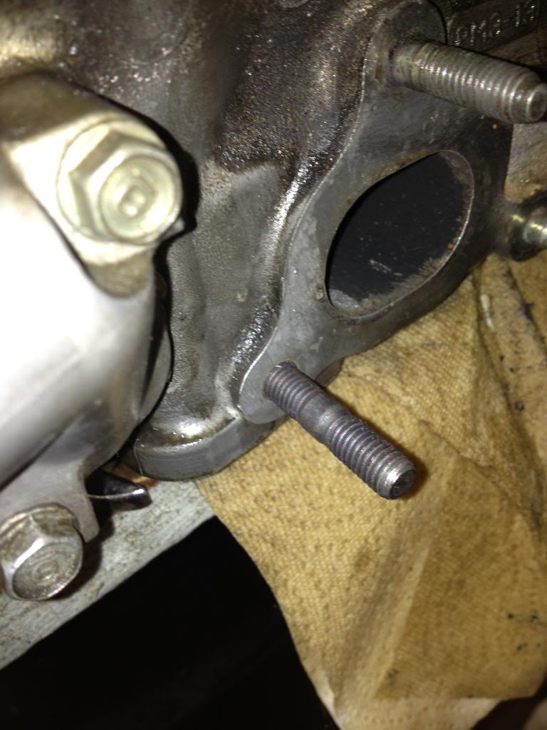

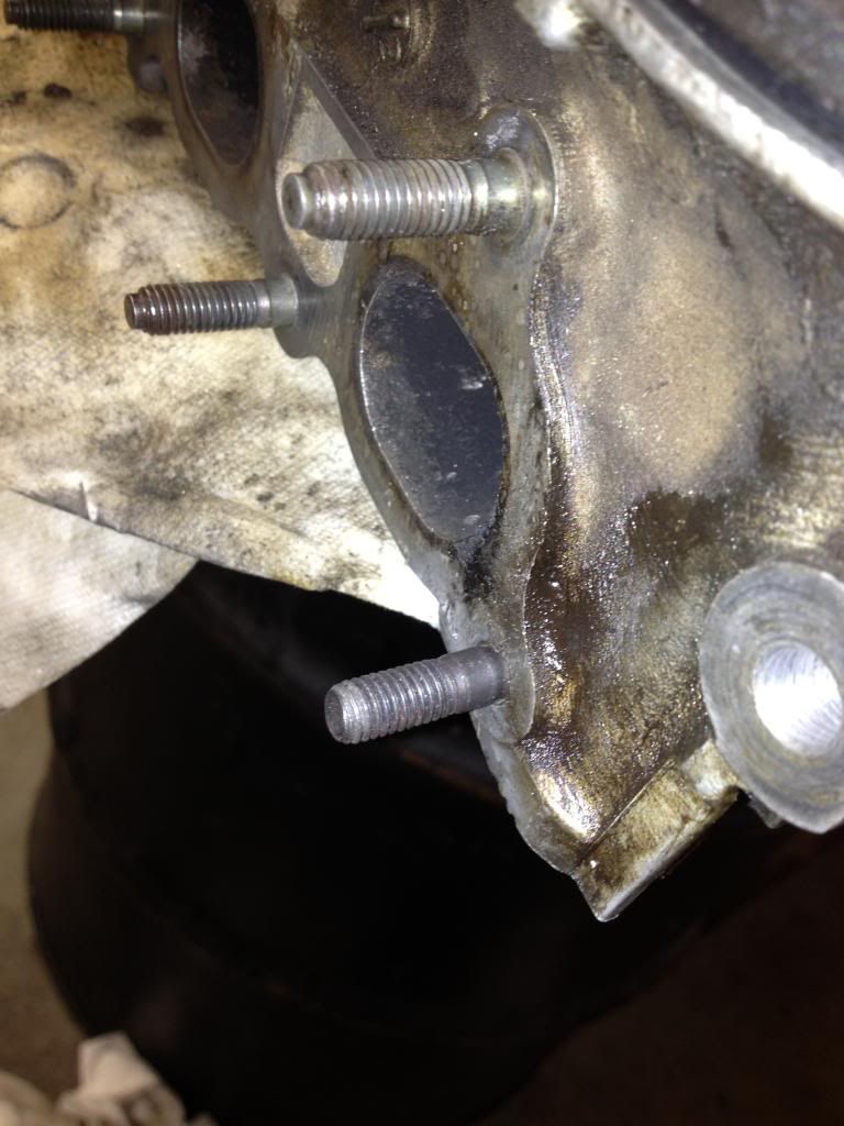

    so when i was taking off my exhaust manifold, the two end bolts snapped off.. and one snapped of inside of the head.. so i went to the store and got a screw extractor, and 2 new head bolt studs.
    almost time to put it all back together!

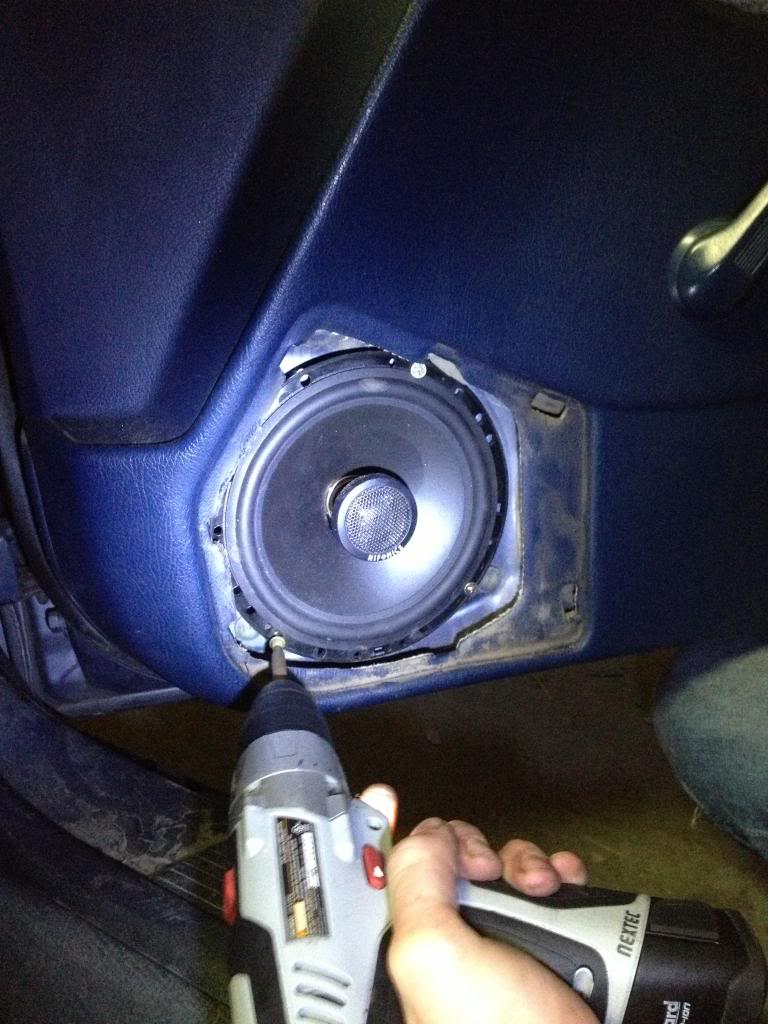

    new door speakers.. the old ones were soo nasty..
    i replaced mostly all the rubber in the head... this was necessary because my car was burning oil and i have to make a 400 mile trip up north to attend another year at college... everything turned out swell..
  • hey what are those o-rings called if you were to go buy them? because I can't find them.
    I just bought a head gasket rebuild kit from oreilys for 100 bucks, and they were in there! and you dont have to take off the head to replace them, just the rocker arm assembly.

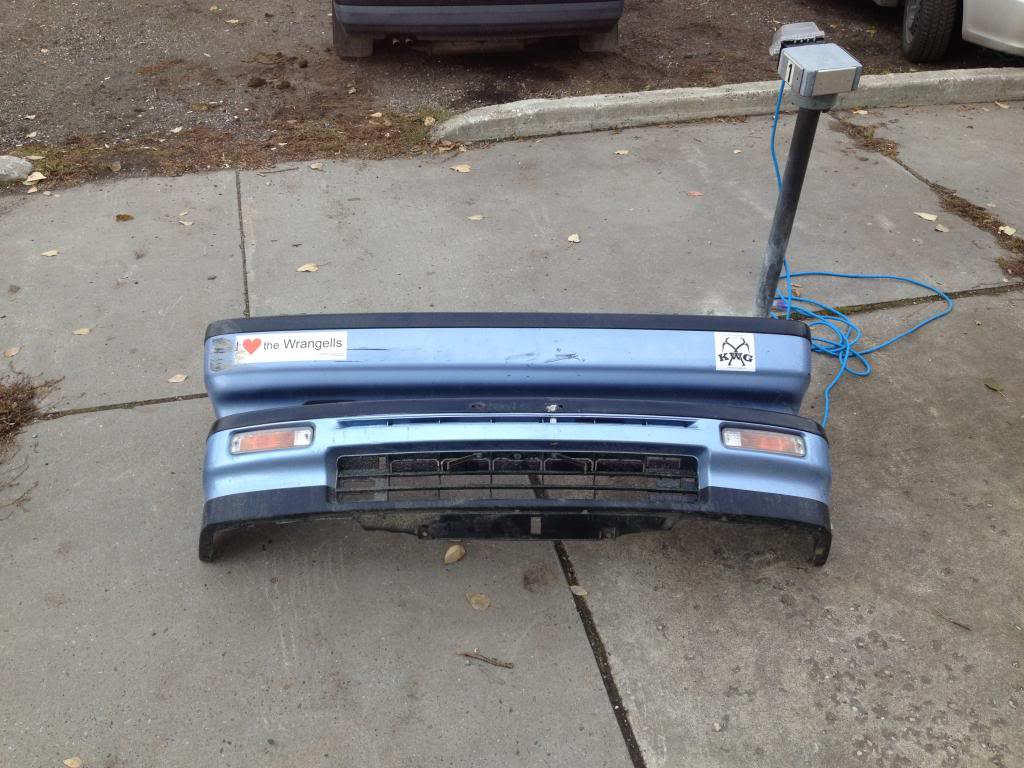

    Bumper looks good! How much modification was needed to mount it or was it just a bolt on type thing? And you use the bumper support of the si right?
  • Great progress! loving this thread..
  • Bumper looks good! How much modification was needed to mount it or was it just a bolt on type thing? And you use the bumper support of the si right?
    there was no modification to put it on.. i used the wagon clips to keep the front lip that goes in between the headlights and the bumper.. but on the edge of the bumper where it meets with the fender, you have to cut the edge flat to make it flush with the lip. ya know?
    but yea just bolted it easily

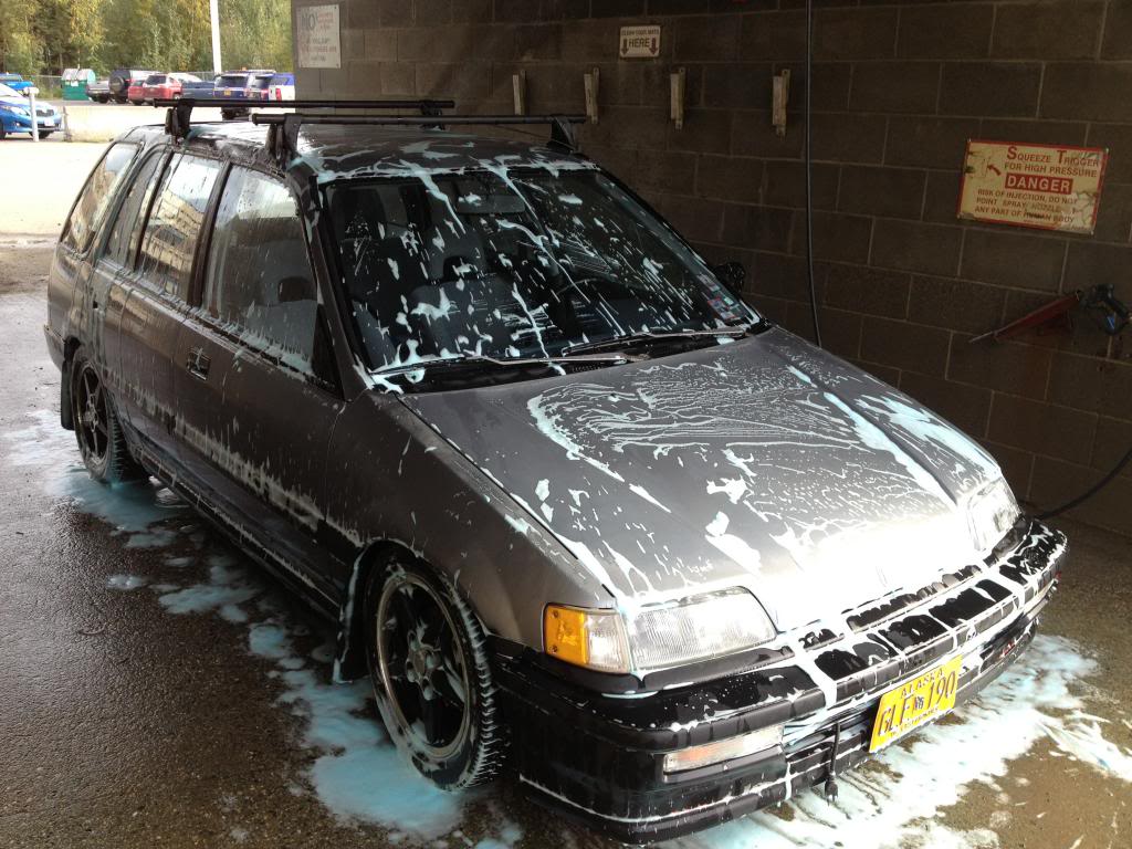

    self washh

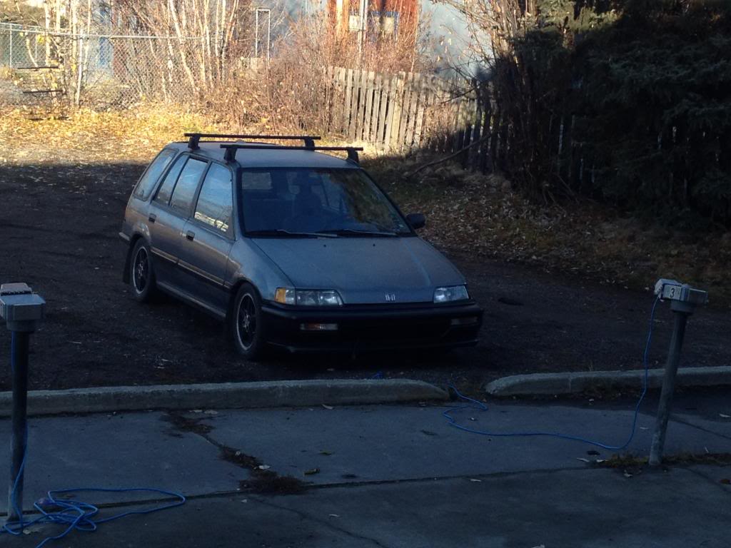

    first snow fall!

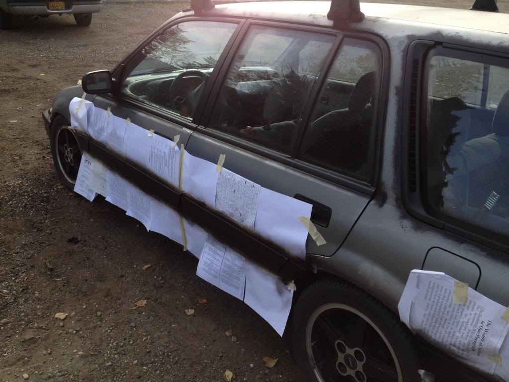

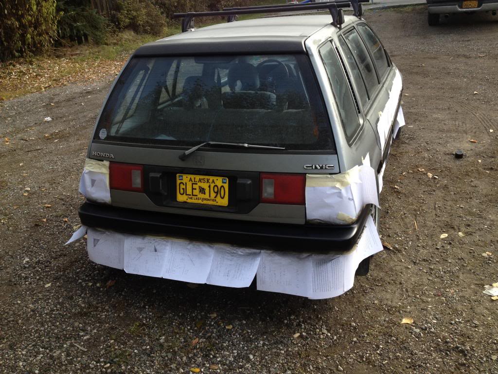

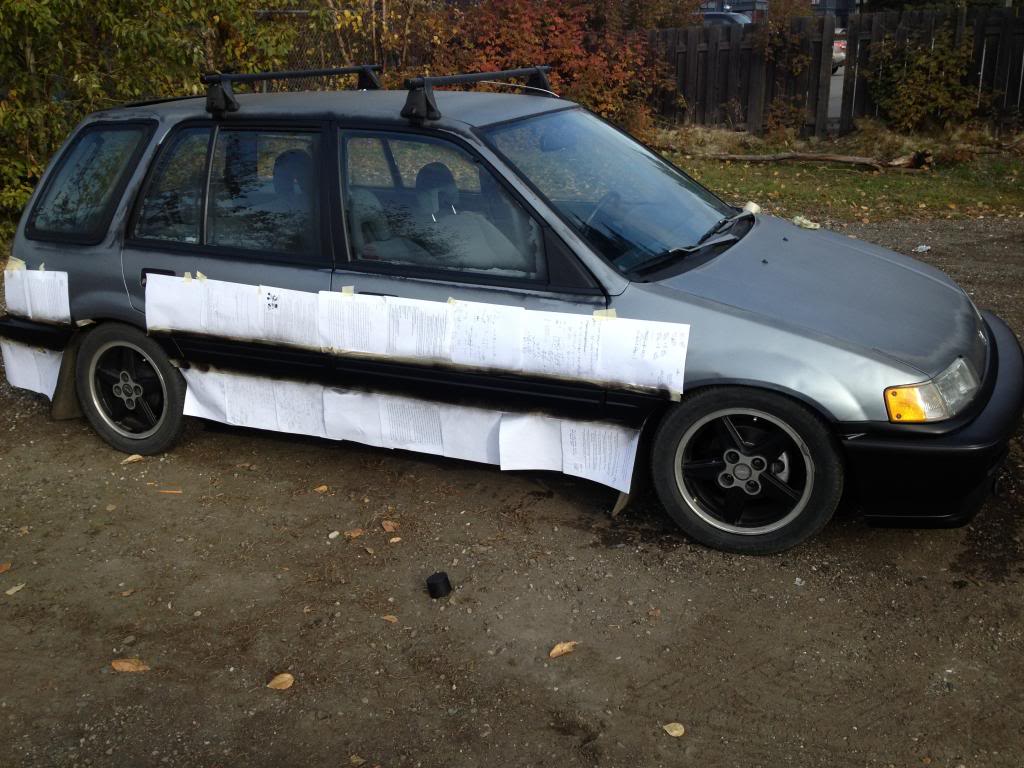

    decided to spray paint my trim all around my windows and trim... i used plasti dip on the black trim around the windows.. i say it helped alot because the rubber was worn away.. then i used dupli color trim paint for the sides.. and did another coat on the bumper..

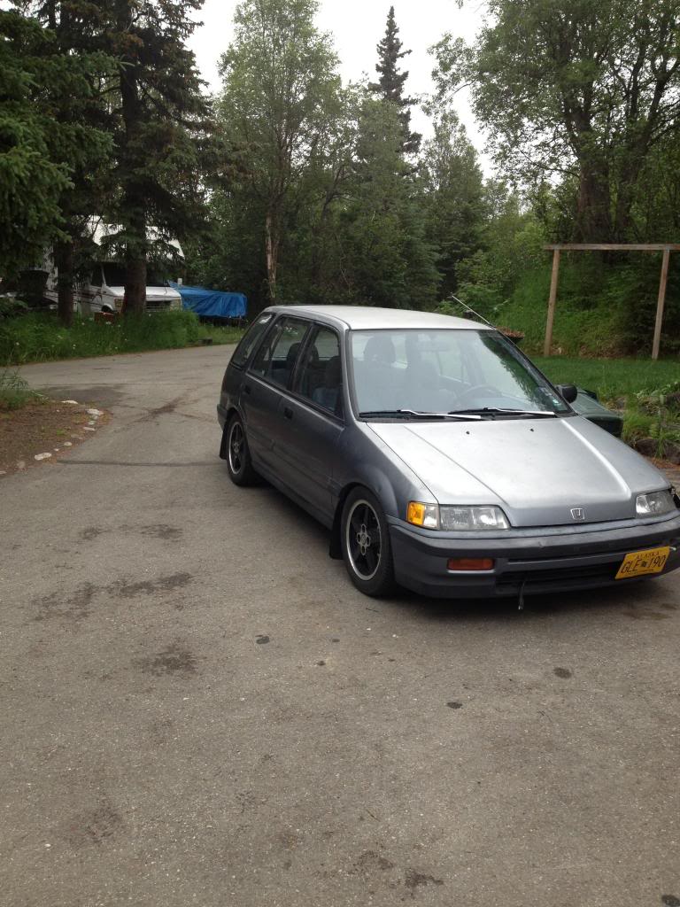

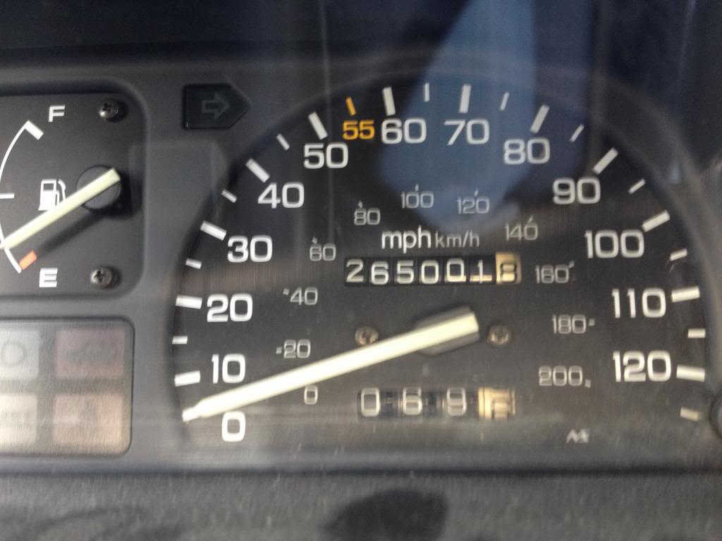

    I missed the exact miles at 265000!! but heres a pic

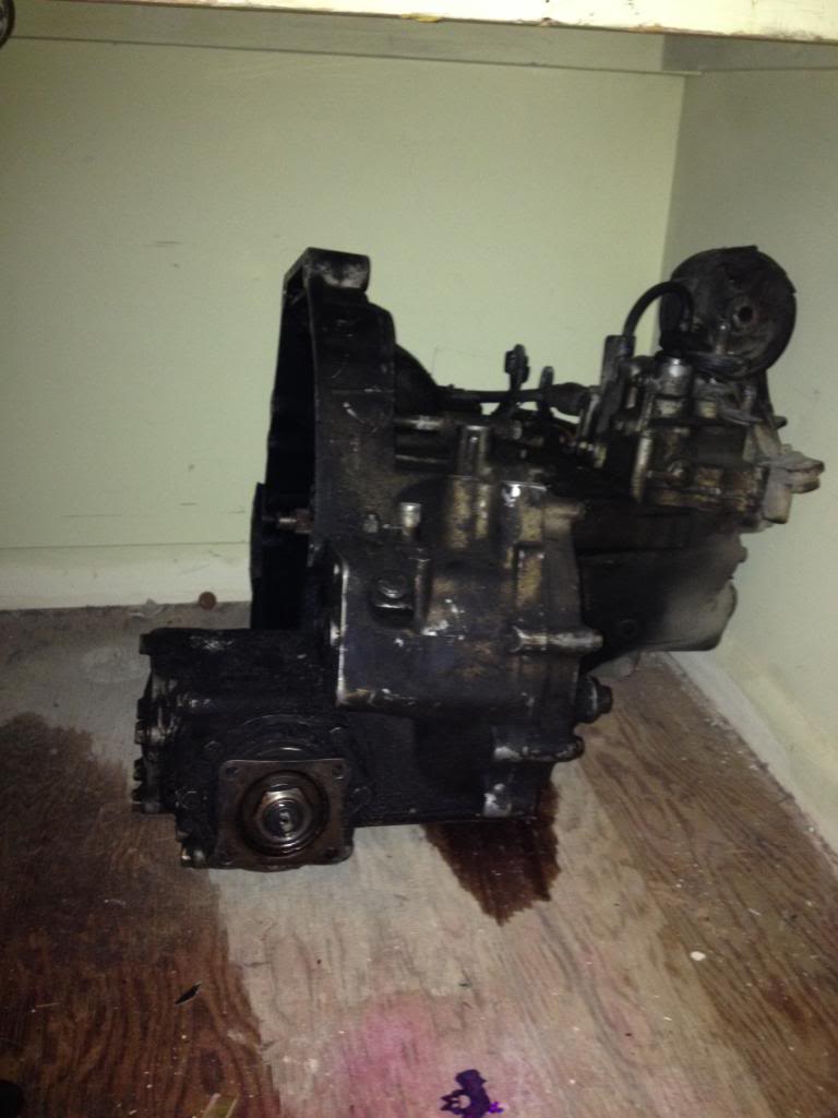

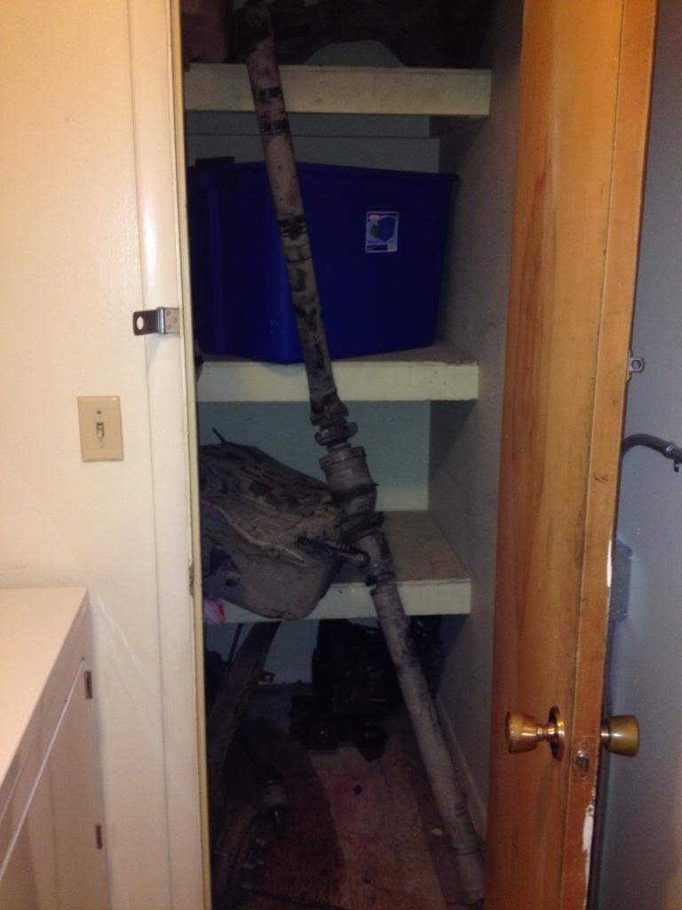

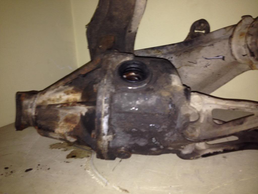

    SOOOO!!! this dude is movin out of state and he posted a whole drivtrain for a 4wd civic on craigs.. talked him down to 400 bucks and i got the tranny, drive shaft, back dif, rear trailing arms, and a gass tank.. and he said he will trhow me a front and back wagon bumper for free! i still have to go pick those up..

  • FREE i tell you FREE! hahah man it feels like Christmas up in here.. well got me extra bumpers.. i dont know if i should go back to the wagon bumper or keep the 89-91 bumper on... either way im still stoked on all the parts i got.. im one happy camper right now haha

    i bought it a weekend when i took off my old dented bumper..

    He had a sedan bumper on his wagon. These 2 new ones were a donation. :)
