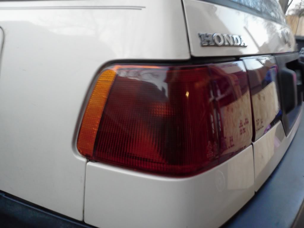

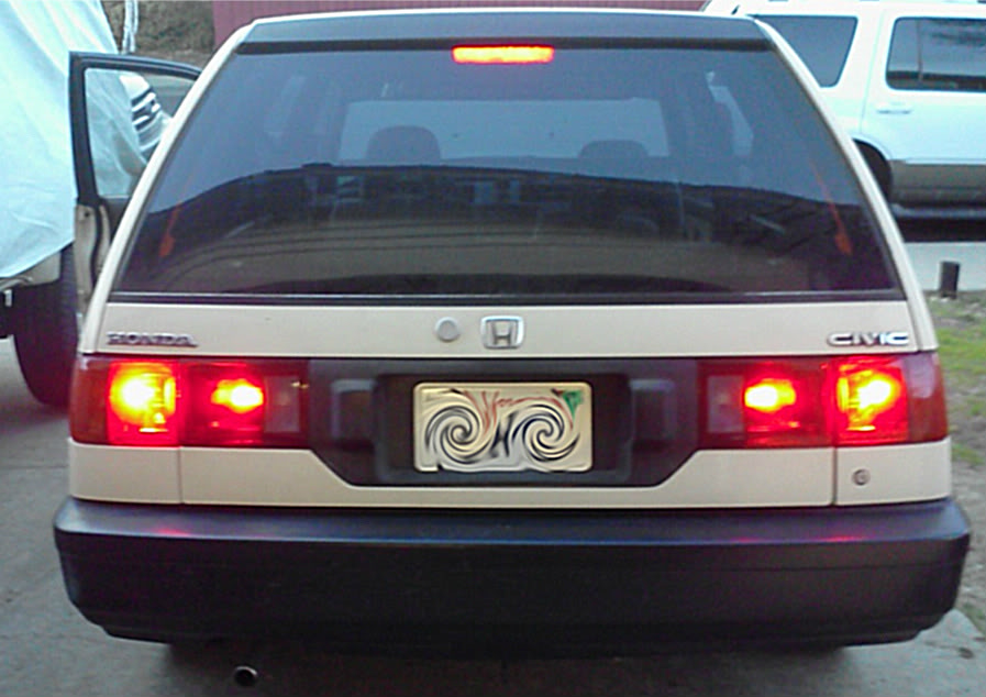

JDM tails(before)

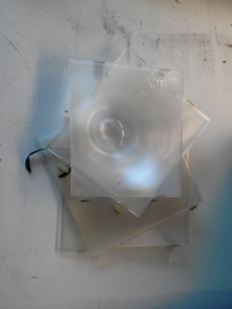

Cant leave good enough alone, make it better or make it worse trying..Bust them open with some heat and patients. Broken edge but fixable.
Black plastic paint after a couple of hours removing adhesive and loose junk.
Ditched these thingys.
Back together with some 3M Sillicone.
Reinstall...
With LED Whites.

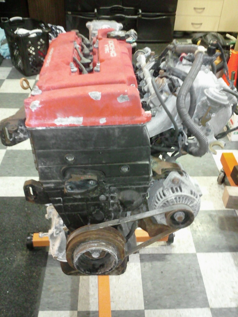

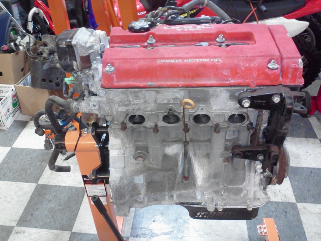

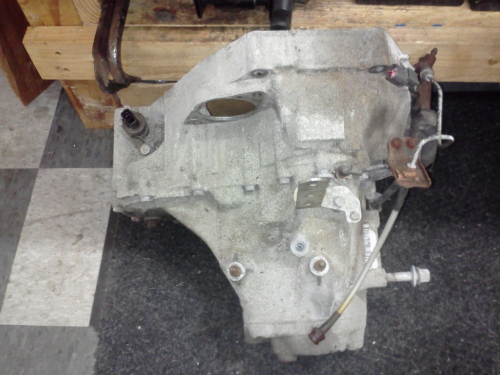

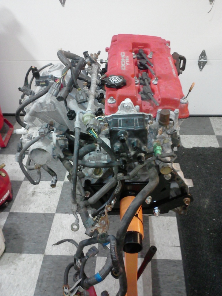

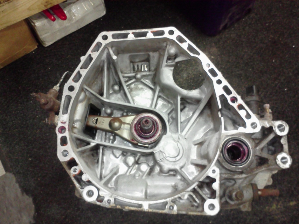

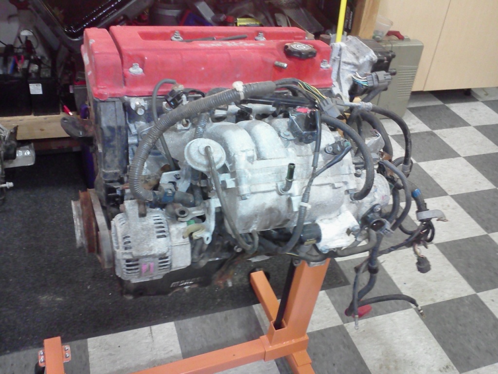

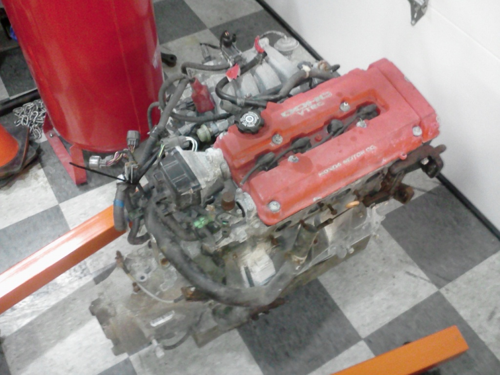

I got the Engine split from the trans and onto the engine stand. So far all is looking good including the trans so I’m crossing my fingers there are no surprises when get into things further. Nuff talk, pics....
