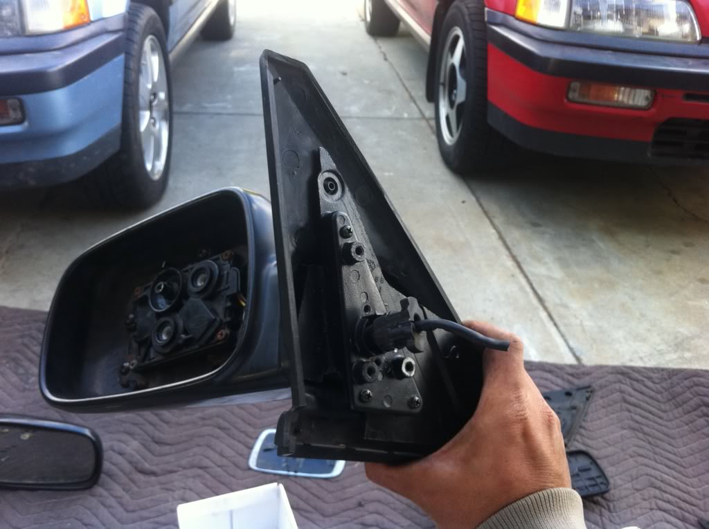

this is what I started on yesterday on a whim....started on the drivers side first because I didn't want to waste a passenger side on a whim...it turned out decent enough. I wanted to make sure I can do this before I the electrical and couldn't come up with the power mirrors lol but here it is! I still need to fabricate a cover plate utilizing the original.
    So I'm thinking right and looking right.
    You took the sedan power mirror guts and put them into the wagon inners?
    Am I correct?

    I took the plastic base from the wagon along with the base of the arm from the wagon. Then I connected the arm and cover from the sedan, I'll be doing the passenger side soon, I'll take pictures of which arm to connect and graft from.
