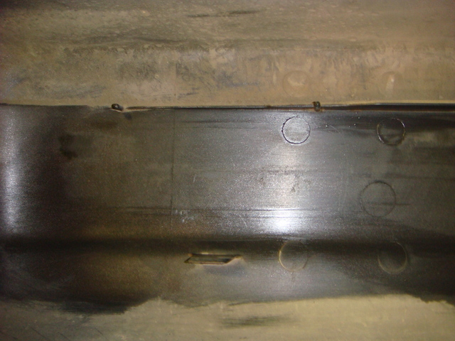

    what i did was first of all take off the rear bumper and separate the cover from the metal reinforcement.

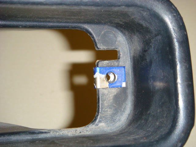

    on the back of the cover you will find a plastic tab and little plastic poky things on both sides, this is where the rear fogs have to be located. if you have brackets, then they will fit into these. if you dont, which is most likely seeing as the brackets disintegrate after a while, thats fine.

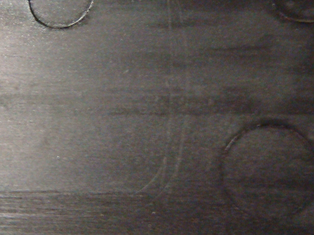

    next you have to cut the holes... be very careful with this. line up JUST THE RED LENS against the bumper cover and draw the outline of it. cut that out. the hole will be considerably smalled then the fog housing is. thats good, this way you can slowly trim away as you need.. to get the fogs centered in the correct place. make sure you dont cut too much!
    now onto the metal reinforcement. line up the bumper cover to the metal. mark off where the holes are to the metal. you will have to cut all of this out for the fogs to fit. so do so now.
    once that is done, you are ready to permanently install the fog units. get some automotive heavy duty silicone glue type of crap.. stick in the fogs in their place and then glue from behind. be generous. after it dries install the metal part together with this. make sure to run wires first!!

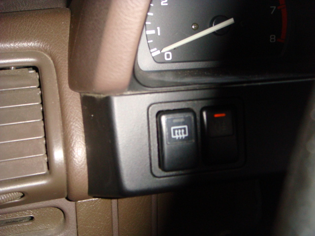

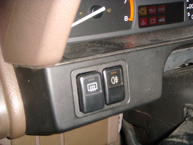

    the EDM rear fog switch takes the place of the dimmer switch in all 88-91 models. JDM rear fog switches go in the lower dash, NOT replacing anything (just adding).
    people with an 88-89 can relocate the dimmer switch to the lower dash (if you decide you absolutely need it) as it will pop into place on one of those block off plates.
    for those with the 90-91, you know that the dimmer switch wont fit on the lower dash. if you were wondering if you can use a 88-89 switch the answer is no. the wiring is different (though the plugs are the same). i tried it and it didnt work. sorry :mrgreen:

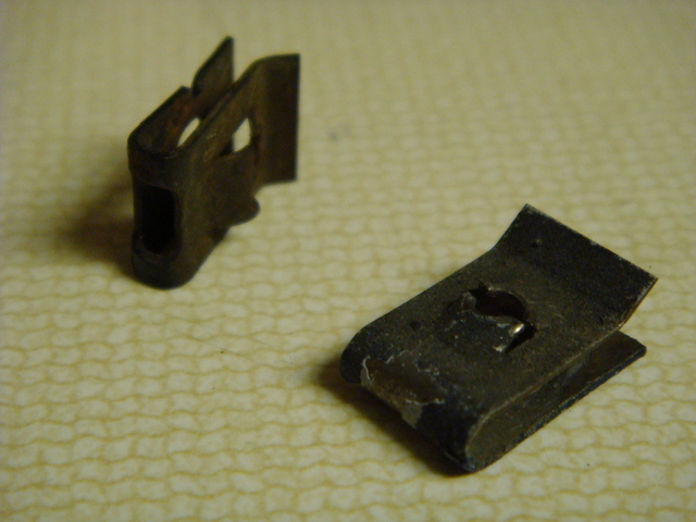

    first remove the bumper completely; take off rear mud flaps etc... then 4
    bolts on the under side/ and 2 in the trunk area- i believe they are 12mm.
    then unscrew all the screws that attach the cover to the support. most
    likely rusty and kind of a bitch... but try to not strip the screws and or use
    some vice grips...

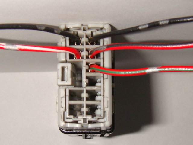

    i wired mine directly to the battery :P not that best way to go but at the time (and still) i dont/didnt know better. the two wires i used were the red and red/green to get the power flowing. so i believe...

    Here ya go:
    Wire diagram away!
    ok its the red/green and red/black wires
  • So what you are saying is:
    12v out<-red/green____|
    12v out<-red/black ____|____red/white->12v in
    ground out<-black ____|____black->ground in
    Voltage out goes to the fogs
    Voltage in comes from a power source (ie. fuse box)
    uhhh i dont think so :P
    red/green --> rear fog red
    red/black to battery +
    black from rear fog to battery -
  • So the wires on the right side(right side of picture I posted) of the switch, red/white black, are for the actual switch lights??
    i guess. those other three are not hooked up in mine. i assume one is to illuminate the display at night.
