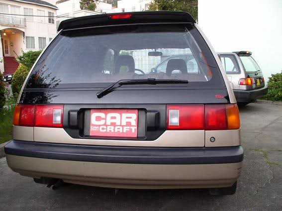

:idea: The vinyl comes in many colours.There's 2 grades of vinyl.1 last about 1-3 years & the other last 3-5 years.The "Carbon Fibre" look doesn't last as long.I went with the Black(longer lasting).On this small area it doesn't matter 'cuz u can do it over if it fades(remember in less than 20minutes). :twisted: HELL you could change the color every other day if u wanted.
Make sure the area is very clean b4 laying down the vinyl.I used a 8"(400mm) wide vinyl about 6"(155mm) longer than the width of the hatch.Started at one end.Peeled the vinyl backing as I went.Pressing the bubbles out w/my hand.It's going to curve up(I think) 'cuz the hatch is curved.That's OK I had to do it twice. :roll: I think I started with about 2"(25 mm) of vinyl at the top & by the time I got to the other end I had 5"(130mm) on top.Now you trim off the vinyl leaving enough vinyl to wrap around to the back.On the top part use a razor to trim it,but eave at least a 1/4"(6mm)+ to tuck it under.
As far as the "Si" emblem . :roll: I cheated.I pressed the vinyl as close as I could to the emblem.Using a X-acto knife(razor) I trimmed it as close as possible to the emblem.Of course the gold showed though in spots.I filled it in with Black touch-up paint.

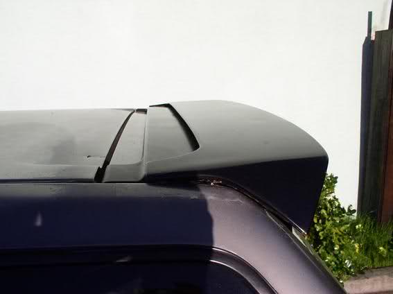

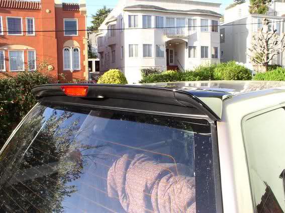

I modded a normal OEM '88-'91 Hatchback rear wing to fit.Removed the Wgn rear 3rd eye & used the HB's .
:idea: A JDM EF SiR rear wing would work too.I thing it looks better.The 1 I saw was plastic . I don't know if it was JDM or a copy.

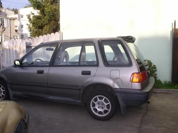

Below '89 w/wing(b4 Wgn was SOLD):

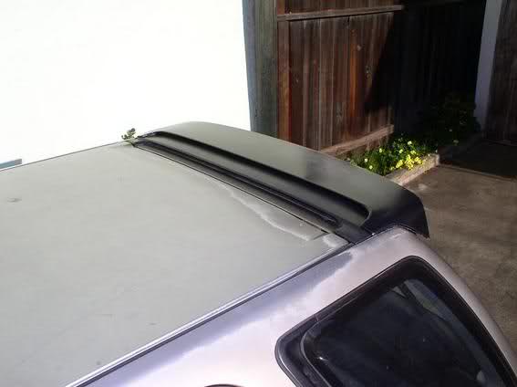

Below:My 1st. prototype.Notice the gap at the lower end.This was eliminated on the 2nd & final piece.

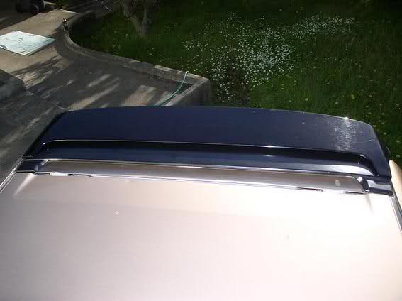

Below: Looks OEM & it flows nicely .
Below:Looks like the NSX Wing.
Now when I look at a wagon it doesn't look right w/o the wing.
