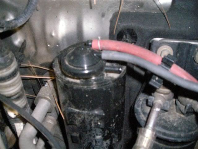

    Here's the drain hose, directly below the purge canister (this thing)
    Here I've removed the canister and its vent hose: That's the hose in question in the center just below the insulation
    This is it removed

    so remove the canister, remove that hose and clean it out?
    i really appericate you taking pictures and doing all of that, it was out of the way but i really really appericate it.
    You really don't HAVE to remove the canister, but it just slides in its bracket and is easy. Makes for better access.
    good luck with it.
